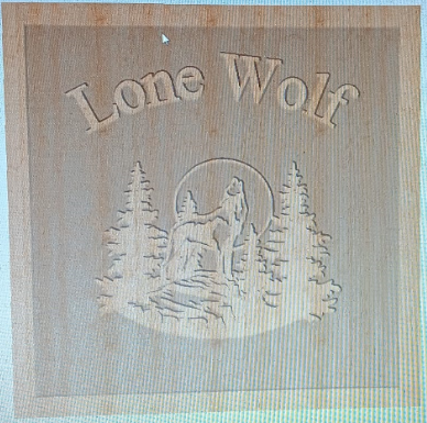

Thank You Guy for responding. Attached is an example of what I am trying to find out. I’m making a sign with raised letters with the background cut out. I have no trouble carving out this sign as long as I use the same end mills bit I start with. I use advance V carve, an 1/8" end mill and a 60 degree V bit. How do I create a toolpath to cut out the background with a larger end mill bit so it doesn’t take so long without cutting away the lettering.

You could draw a border around the areas with the finer details and then do a pocket with a larger bit between that and the outer frame. Or do a separate Adv Vcarve in that area with a 1/4 clearing bit. You may have to have multiple vectors in the middle and alternate which one you use on the inner and outer pocket to keep from having a ridge in the middle.
I think you would need to add geometry to limit how far the VCarve is going (so you aren’t clearing the whole are with a small bit), then create a new pocket toolpath for the larger bit to do the clearing.
Here I’ve added geometry (using ‘Offset Vectors’) 5mm and 10mm away from the areas I want VCarved. We VCarve up to the 10mm boundary, the pocket using the 5mm boundaries, so there is overlap.

I agree with @mhotchin. Do an advanced vcarve on the lettering with a border, maybe offset, and then a pocket for the large space with a larger bit. There are many ways to skin a rabbit but in the end you get a skinned rabbit. Just make your offset around the letters a little larger and overlap the offset with two rectangles and pocket that.

Second, I understand what your saying about the offset. I did that but when I created another toolpath to clear out the surrounding area in my simulation it removed all my lettering too.

If I understand correctly, you want to do a limited V-carve just around the letters, then a clearing pocket with a larger tool…
So in Michael’s example, for the first Advanced V-Carve you select these vectors
And for the second clearing operation you select these vectors

As for the other topic, I have tried and tried and cant seem to get it. I’m still super green at this and when it comes to Toolpaths and layers I’m lost. I don’t know how to separate toolpaths to cut them separately or if you can even do that.
In the example above “Some Text” the red is the selected first correct. Are you saying cut this out at this point or is this a separate toolpath? If that’s the case, can you have more than 1 toolpath. I have been doing everything with a single toolpath.
At this point, if you post your file, we could show you on that. Then you could look at something familiar, and see what has been added.
To your last point, yes you can have multiple toolpaths, and the toolpaths can operate on completely different sets of vectors.
I’ve included the example I created above so it’s easier to see what is going on with it. I actually re-created it, so it’ll be slightly different than the examples above, but it’s the same idea. I also grouped the vectors that are used for each toolpath, so you can easily see what vectors are being used together.

There are 3 toolpaths in this file now. The first two are the VCarve+ Pocket (in Group 1), the third is just using the VCarve to do everything. You would EITHER use the first two toolpaths, OR just the third toolpath.
You can enable and disable toolpaths by right clicking on them. CC estimates that the VCarve+ Pocket saves about 1/3 of the time of just doing VCarve for everything (183 minutes vs 309 minutes). CC feeds and speeds are pretty conservative, I have no doubt that you could save quite a bit more time by increasing the feedrate and DOC for all the bits.
