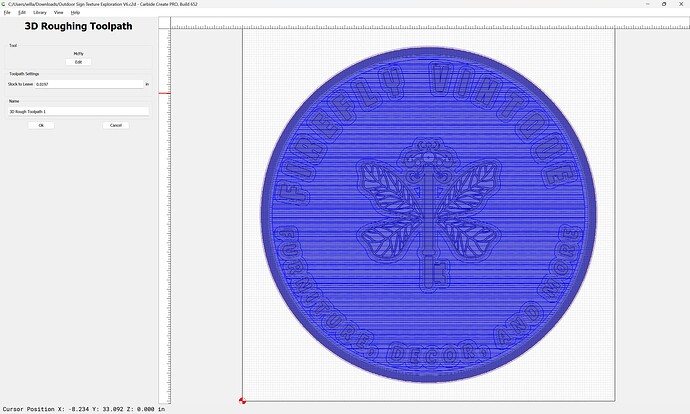

Hi folks! We typically do indoor items, but a friend asked us to do an outdoor sign for them. I created it using 3D modeling in CC. When I work through the toolpaths, they seem way longer to run than I would have expected. Any suggestions for how I could adjust?

First off, the McFly is intended for facing, not material removal:
What material are you cutting?
Second, if the field has been machined down to 0.5 inches:
You will need to change the Texture toolpath to start at that depth:
Lastly, if you’re cutting the entire surface in 3D, why not make the texture part of the 3D model and cut it all at once?
We played around with the Mcly versus a 1/4" ball nose just to see the timing differences. I don’t think the McFly would do well with that kind of workload, either.
Thanks for the tip on the texture; I missed that part. I didn’t include it in the 3D model because I couldn’t find a picture to use that I liked. From the videos I watched, it looks like you have to upload a png or jpeg of the texture. Any recommendations or a similar look? I’d imagine that using it in 3D would make it quicker.
Draw in geometry which describes the regions you want cut away and remove them w/ appropriate settings from the 3D model.

I just cut eastern pine (3.5 " deep) and I needed to remove a lot of material to get to the real model. I used the McFly @ .06 DOC @ 200 ipm for a 6 cu inch/min rate.
For Pine it was faster than I would send a 1/4 bit.
If it was hardwood, this story would change.
The big steps were cut with the McFly first to save time for a 3D Pocket.

If I change the 3D Rough with the McFly to 0.3 DOC at 100 IPM, the cut time is reduced from 700ish minutes to 301 minutes.
You have a choice of design time vs. machine time — either is valid.
Note that for machine time, our feeds and speeds in Carbide Create are very conservative, and you should be able to push them quite a bit, see:

My inclination for speeding up roughing would be to get an 8mm endmill w/ an aggressive cutting flute geometry.
Your DOC of 0.3 is 5X more than my 0.06 DOC.
I don’t know if the cutters are that tall.
I tried 0.1 at 150 ipm and the spindle sound was different. When I ran into a knot, it definitely slowed down. I backed down.
