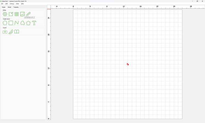

Start by setting up the job:
For more on this see:
Set Background
and adjust as needed:
then begin drawing…
