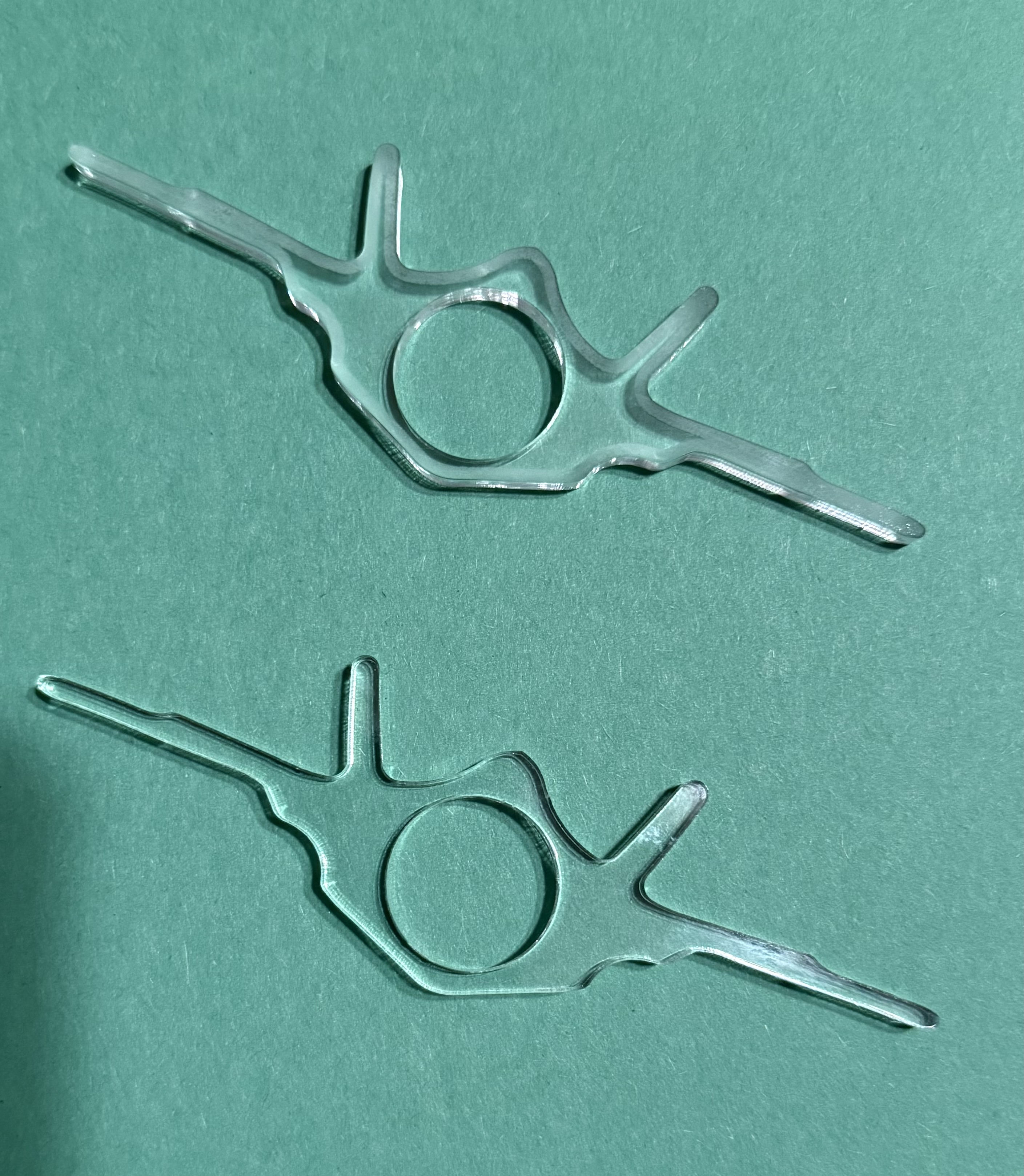

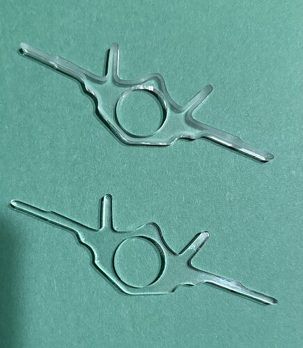

I am cutting a bunch of page holders in the approximate shape of an F-35 for an upcoming event. It is 1/4” cast acrylic and I am doing it on a laser. Nice clean cuts there. I am not sure if my laser would have the juice to tackle 1/2, at least not at a reasonable speed.
There were some design accuracy sacrifices for the sake of usability.
