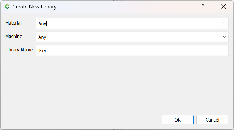

I am looking for the Tool Library file. I found the folder as specified ( About - Open data folder ) but the folder is empty. Any words of wisdom ?

To get a library generated you’ll want to copy the tool library within carbide create itself. That will generate a ā€œuserā€ tool library which will show up in the folder. (The defaults are builtins so they don’t need to store the config…that’s my assumption anyway :person_shrugging:)
My poc is written in my native language of powershell :stuck_out_tongue_winking_eye: but I’m thinking of writing it in ocaml as some fun practice. DM me if you want the poc or the resultant fusion library to see how I approached it :slightly_smiling_face:
The default libraries don’t show there — you can duplicate them:
and then the duplicates will show up in that folder.
