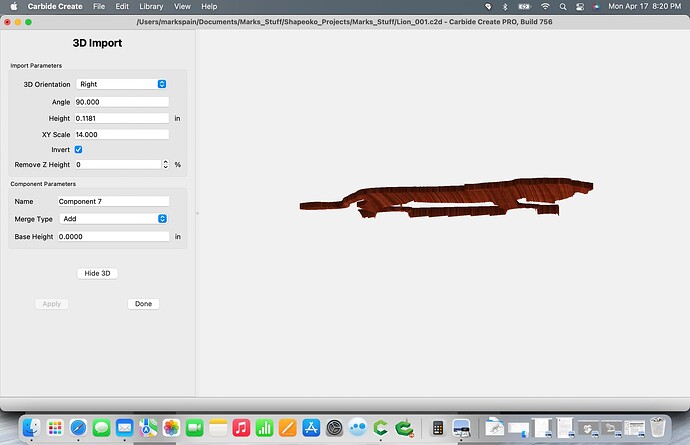

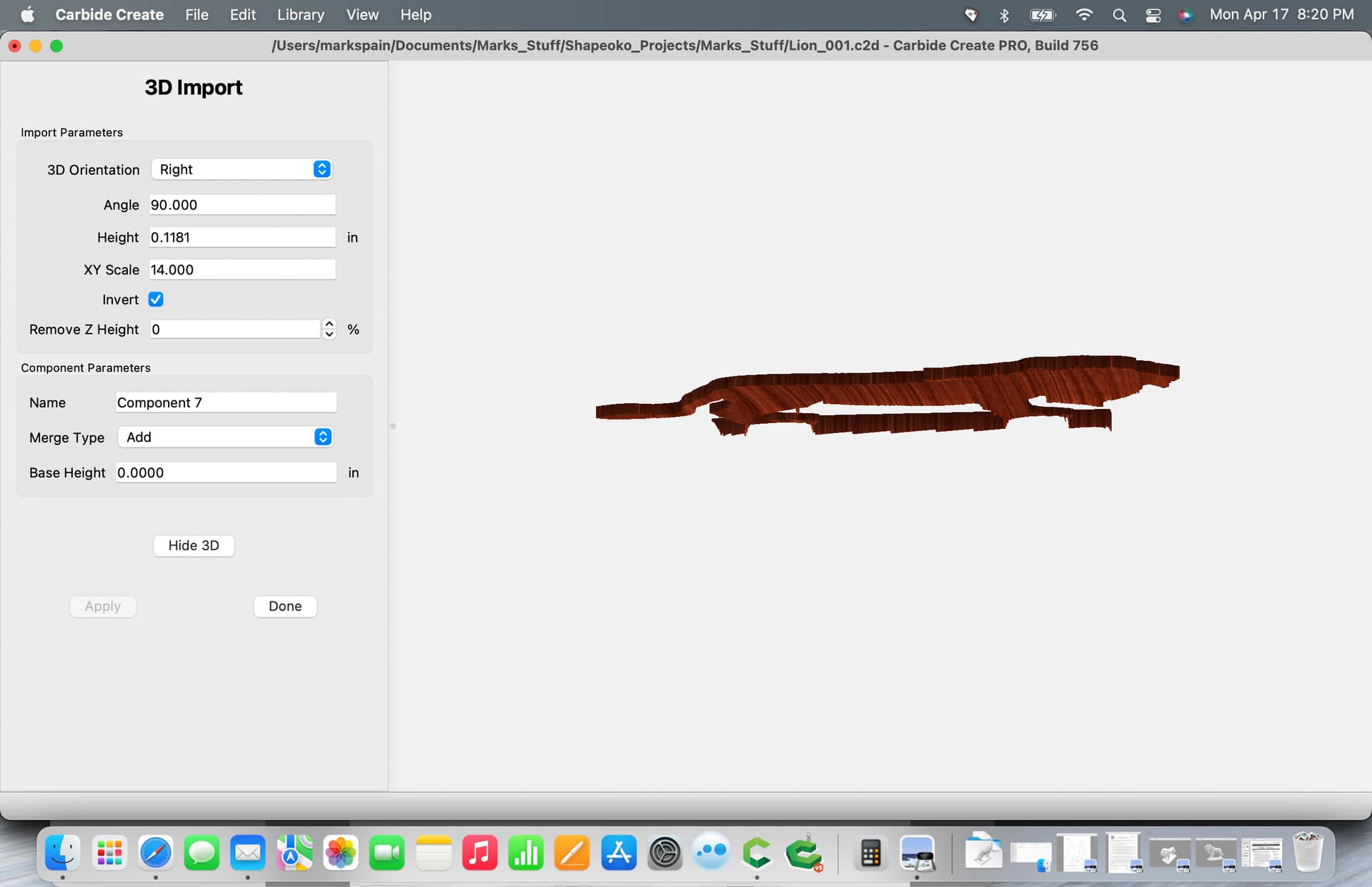

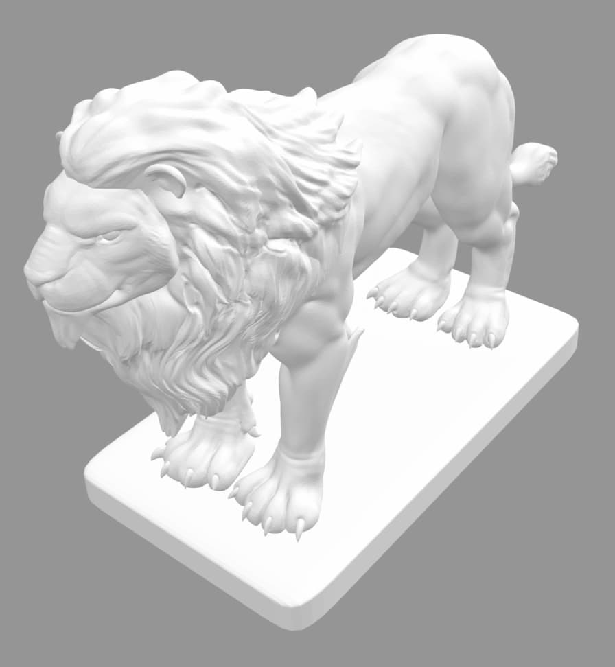

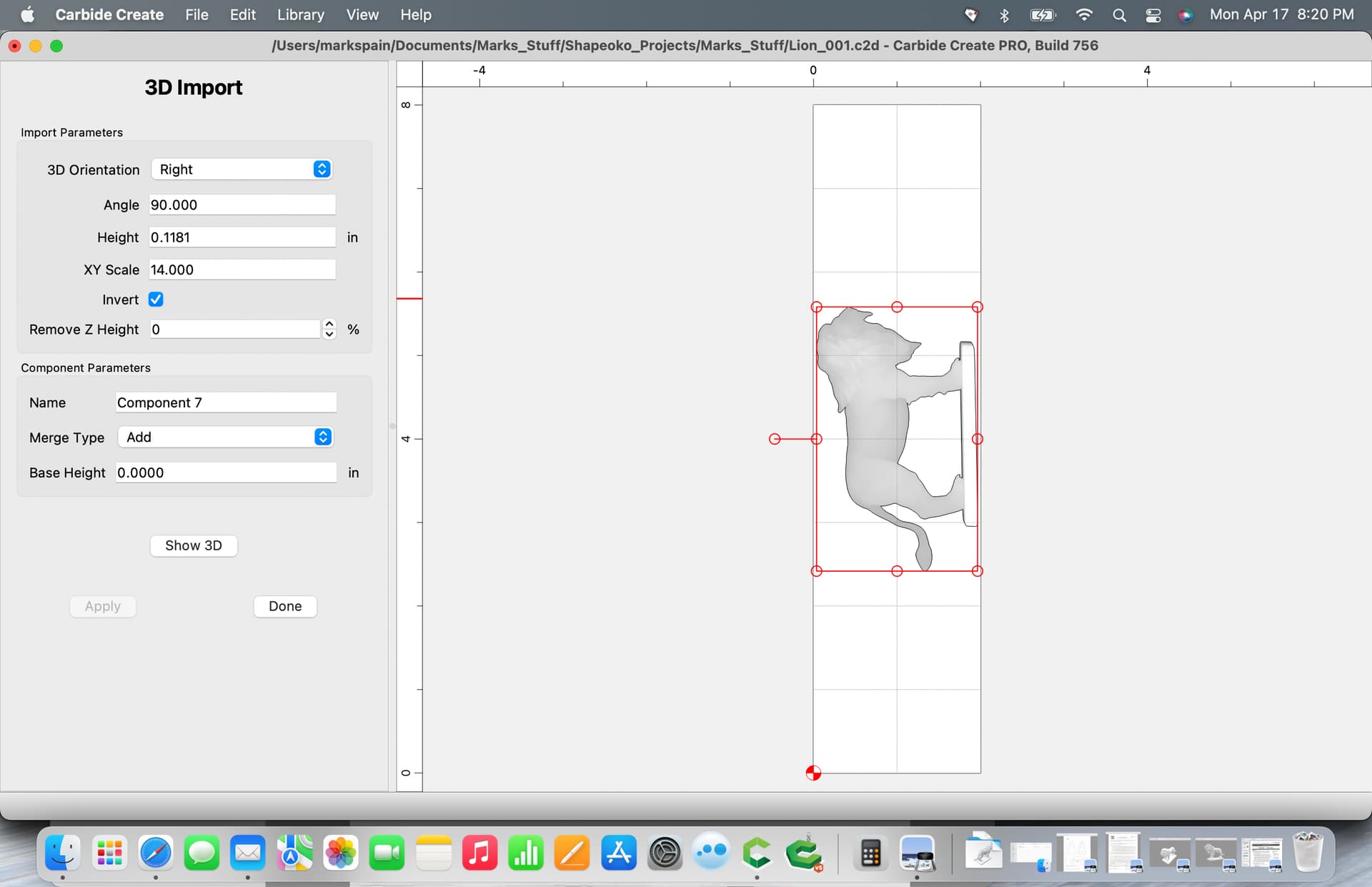

I am trying to come up with machining 3D animals with 2-sided machining. I found a nice STL file of a lion. I imported it but it comes in flat. Can you direct me to a tutorial on how to do this properly? The only one I found was kinda flat, not a real 3D model.

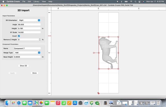

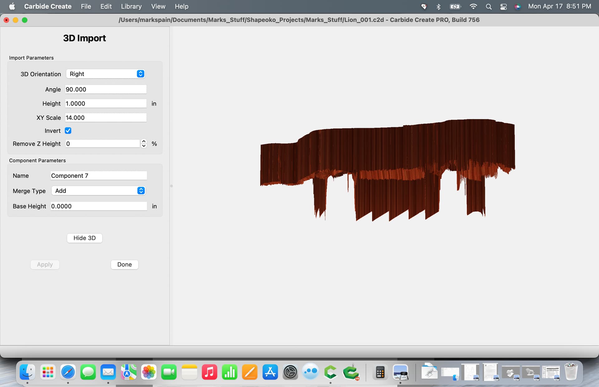

Change the height from 0.1181 inches to half the width of the model.
This is what I get.

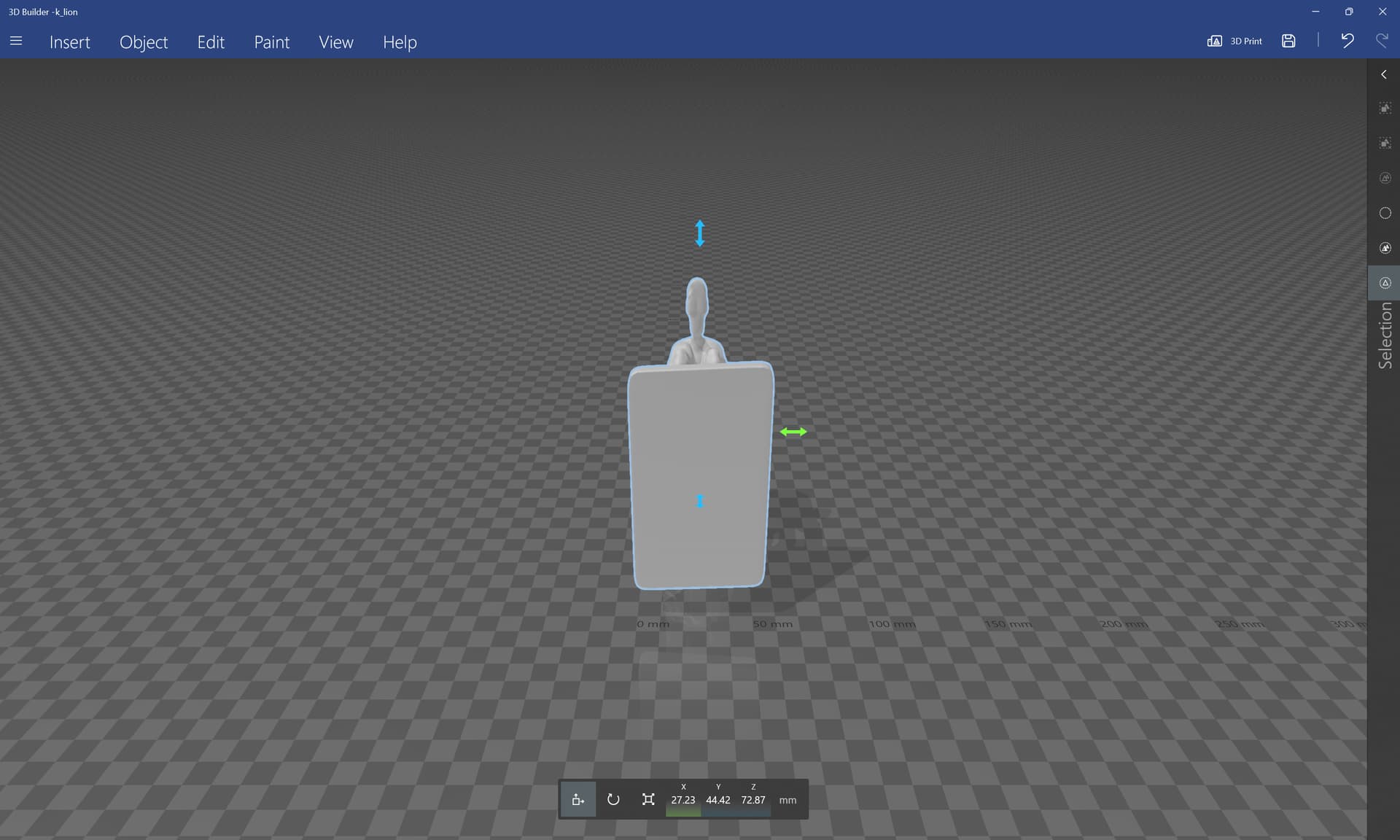

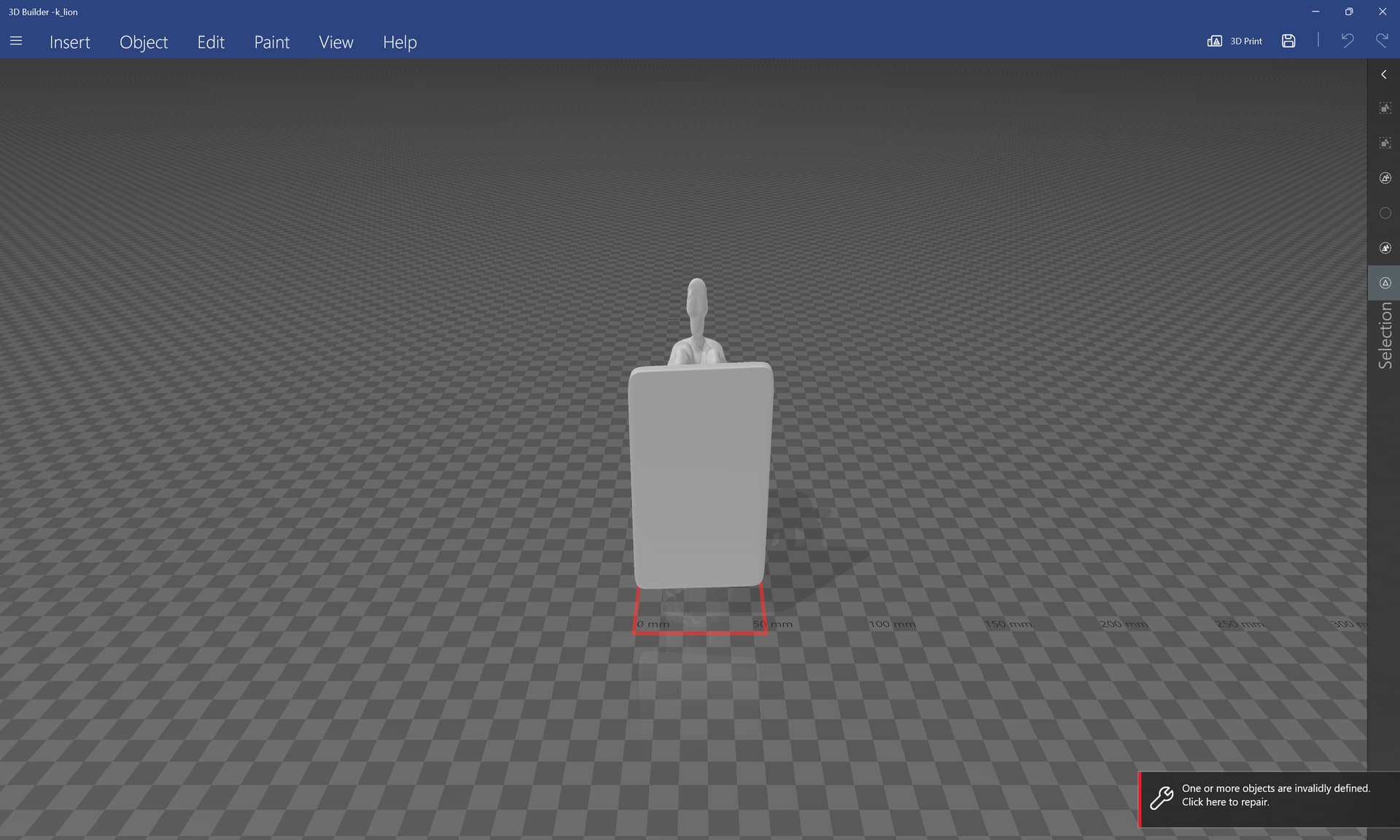

The file seems to be invalid in terms of its mesh — opening it in Microsoft’s 3D Builder app warns of errors:
Once they are repaired and the file is re-saved:

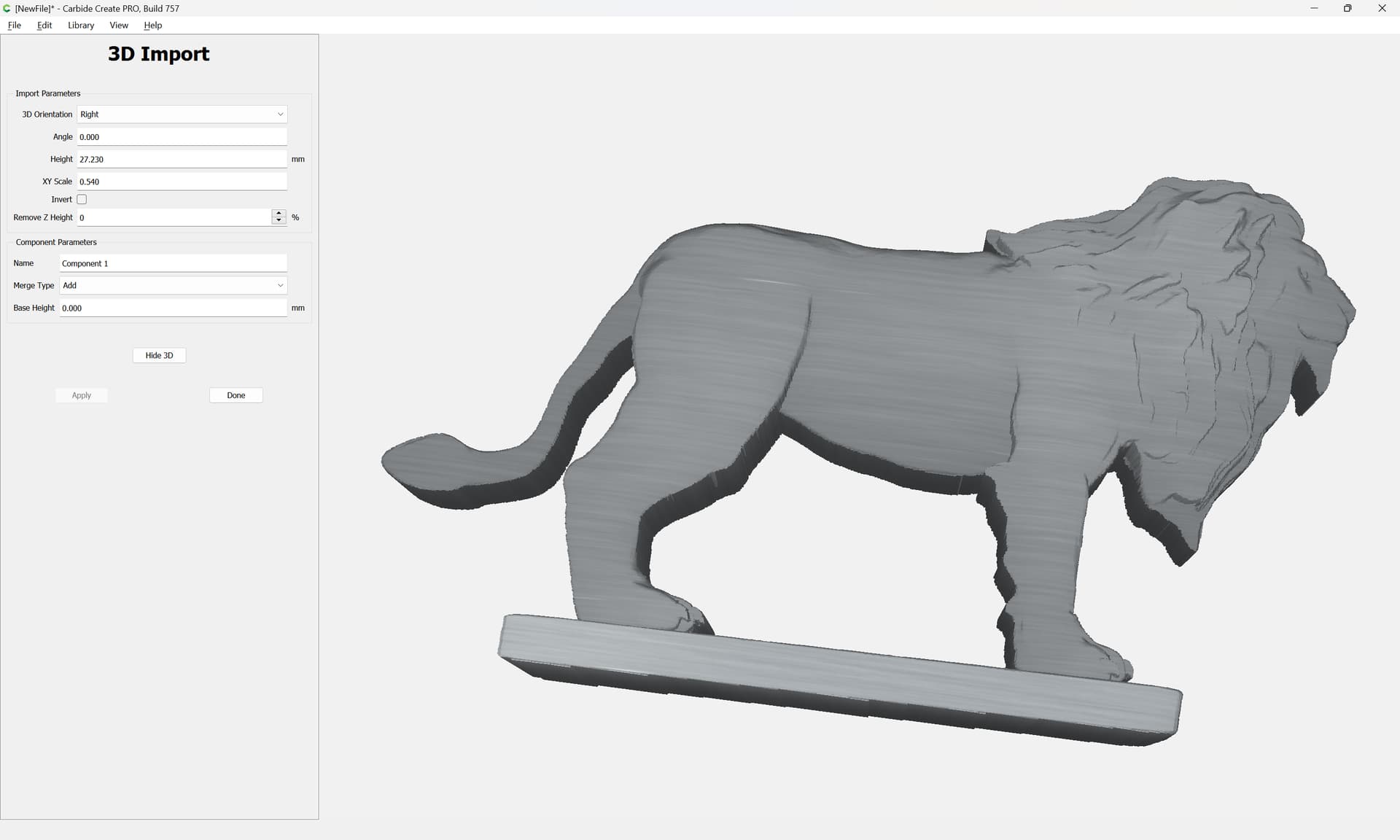

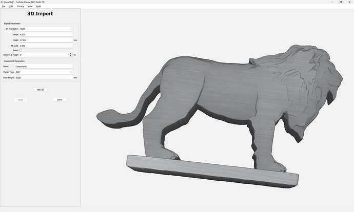

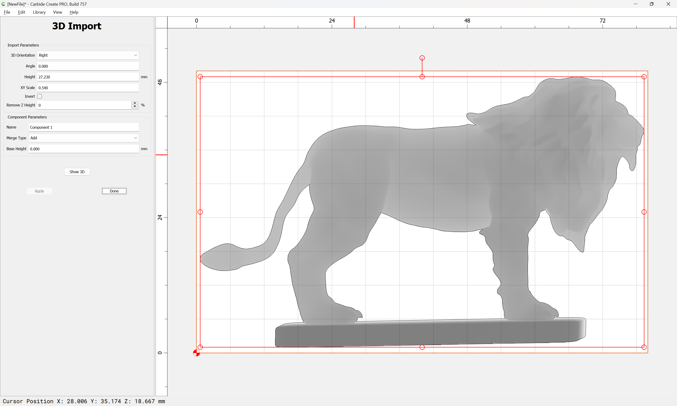

take note of the dimensions and try importing at that size:

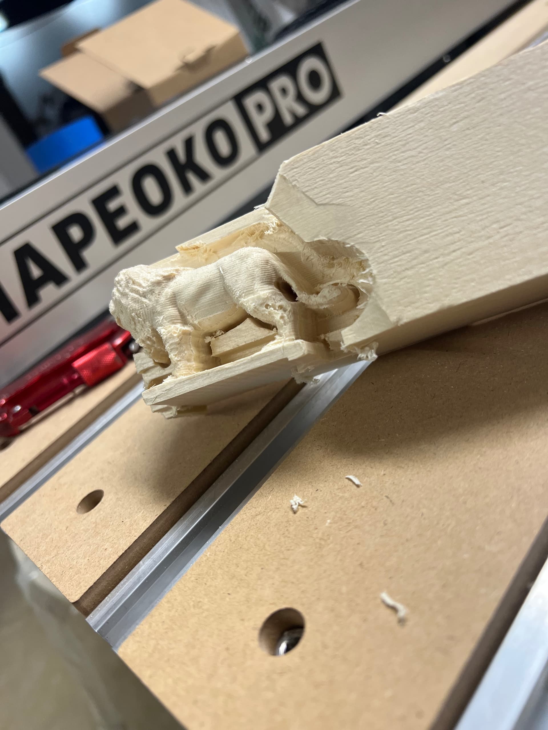

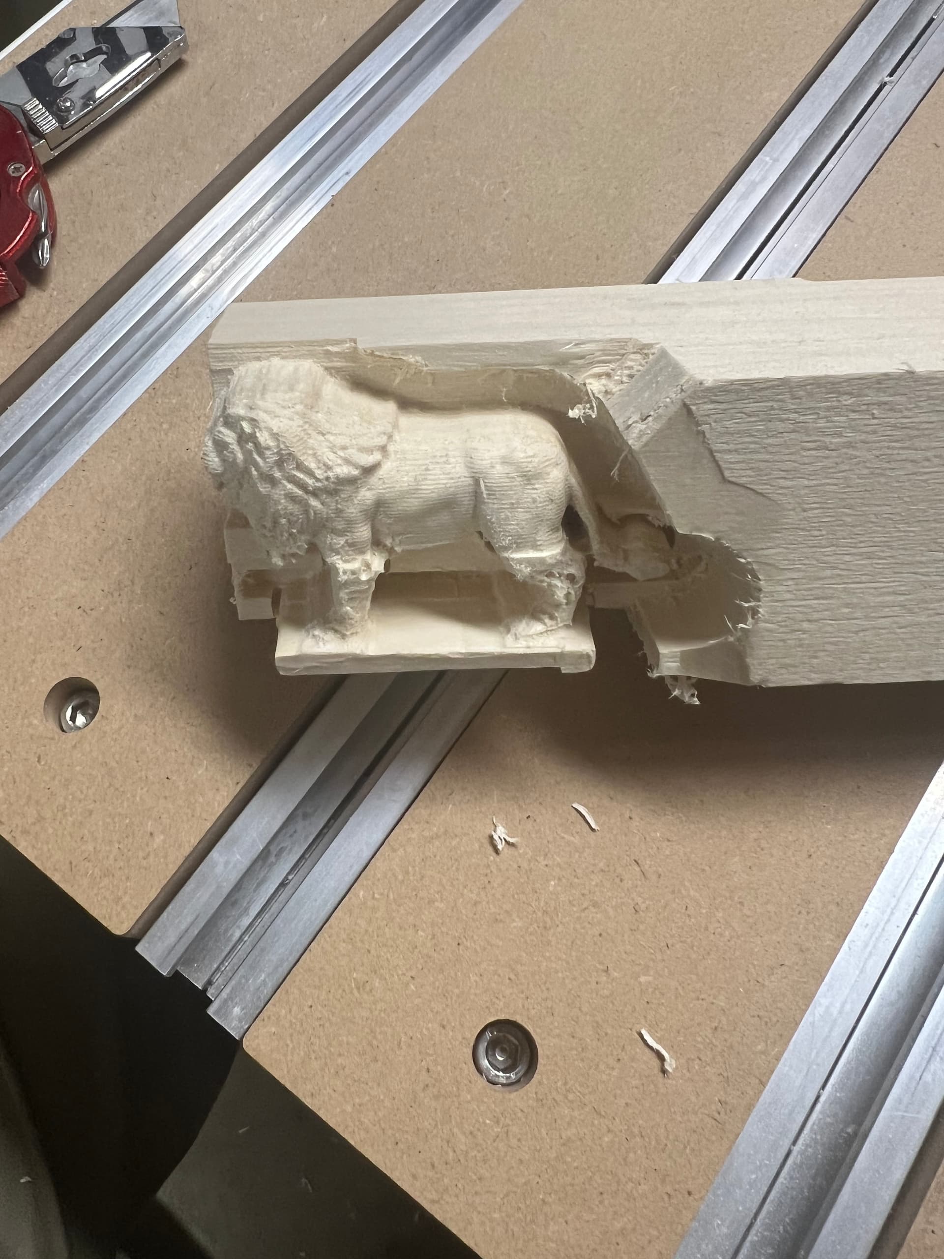

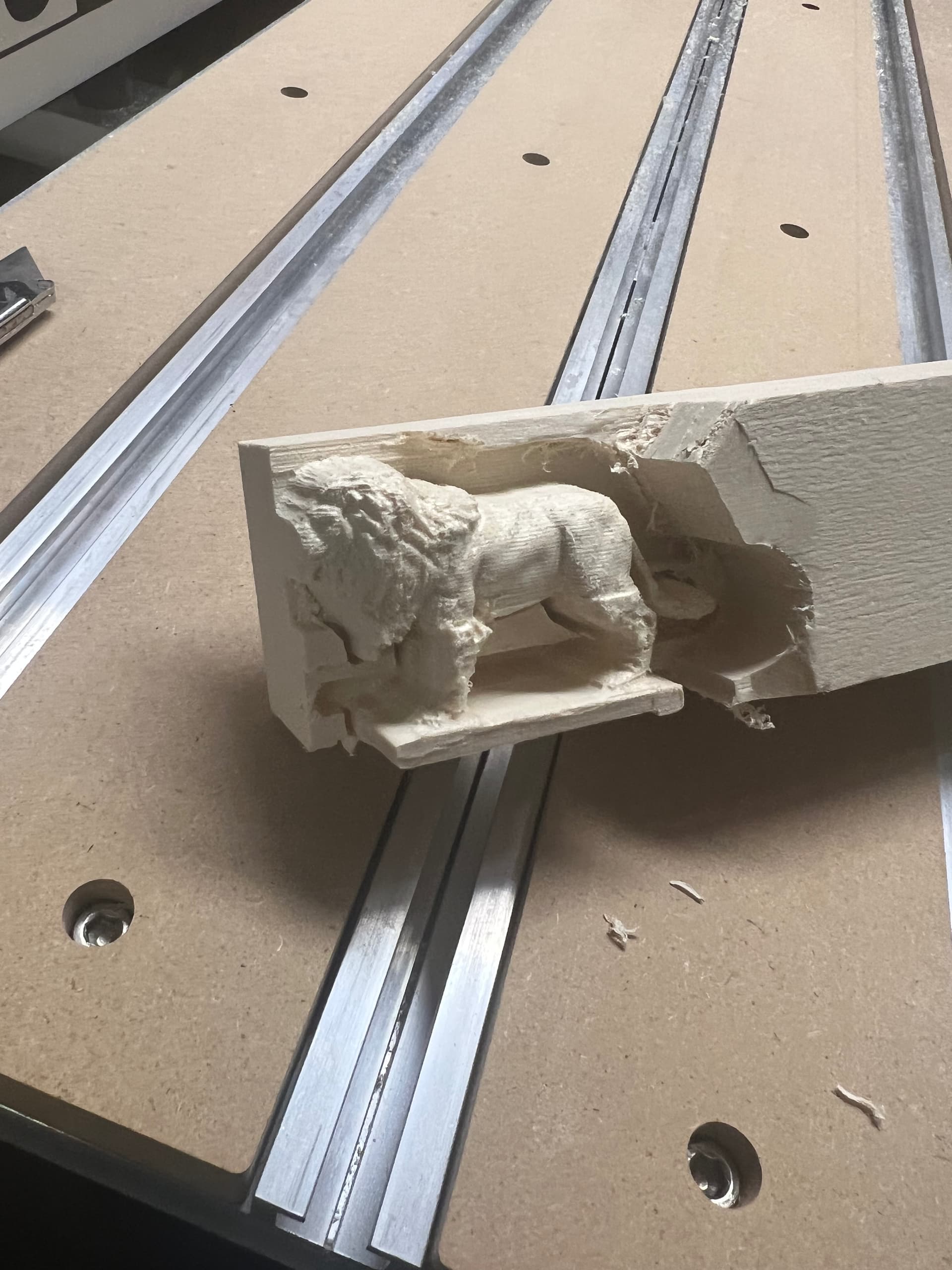

Thanks for all the help! Meshcam looks like the solution to my problem! I didn’t have a long enough bit so I had to take it out when it tried to machine deep. This is very encouraging!
