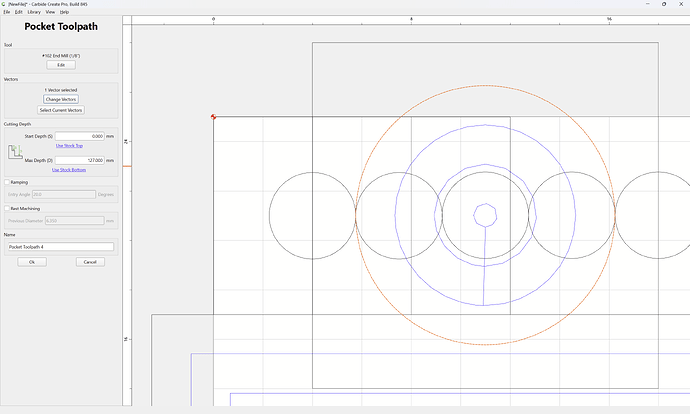

If you haven’t, please update and try the new beta:
In the current beta version, while it’s not indicated, the Edit (Tool) button has focus, and if one immediately hits the space button, will be pressed.

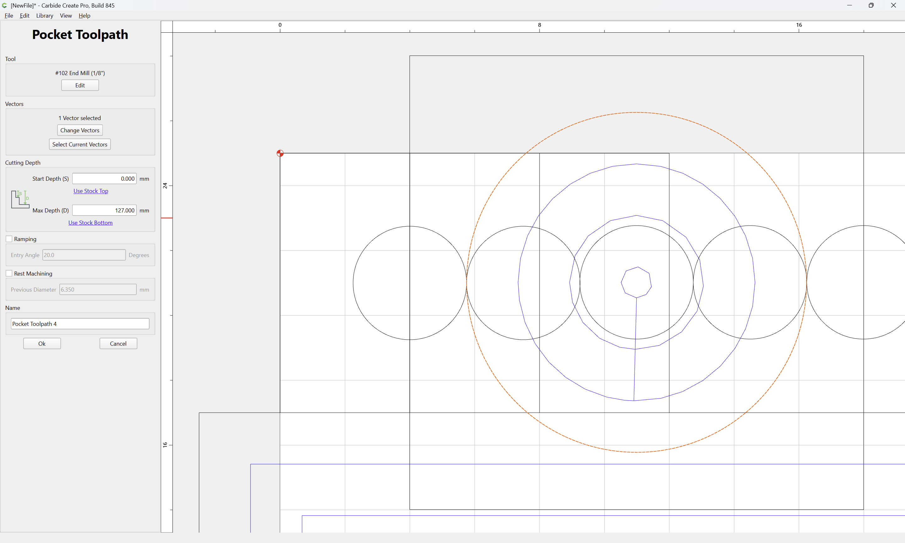

hitting tab once will shift it to “Change vectors” and in the new QT version actually has a subtle highlight:
From there, tabbing works as expected until one tabs out of “Start Depth” — I believe the focus goes to the main drawing area, then hitting tab again continues at “Use Stock Top”:

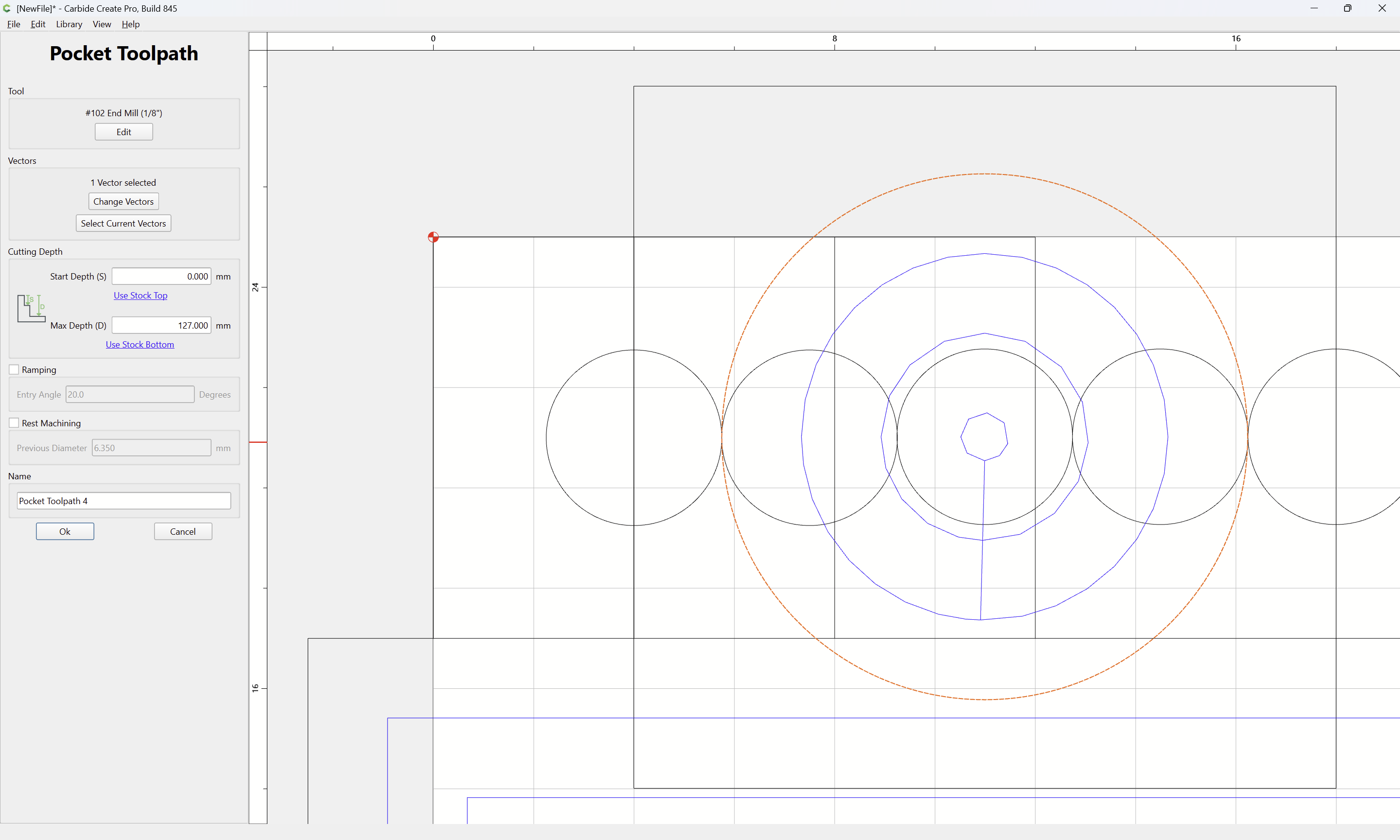

At Max Depth it goes back to the main drawing area or somewhere, and “Use Stock Bottom” never gets the focus.

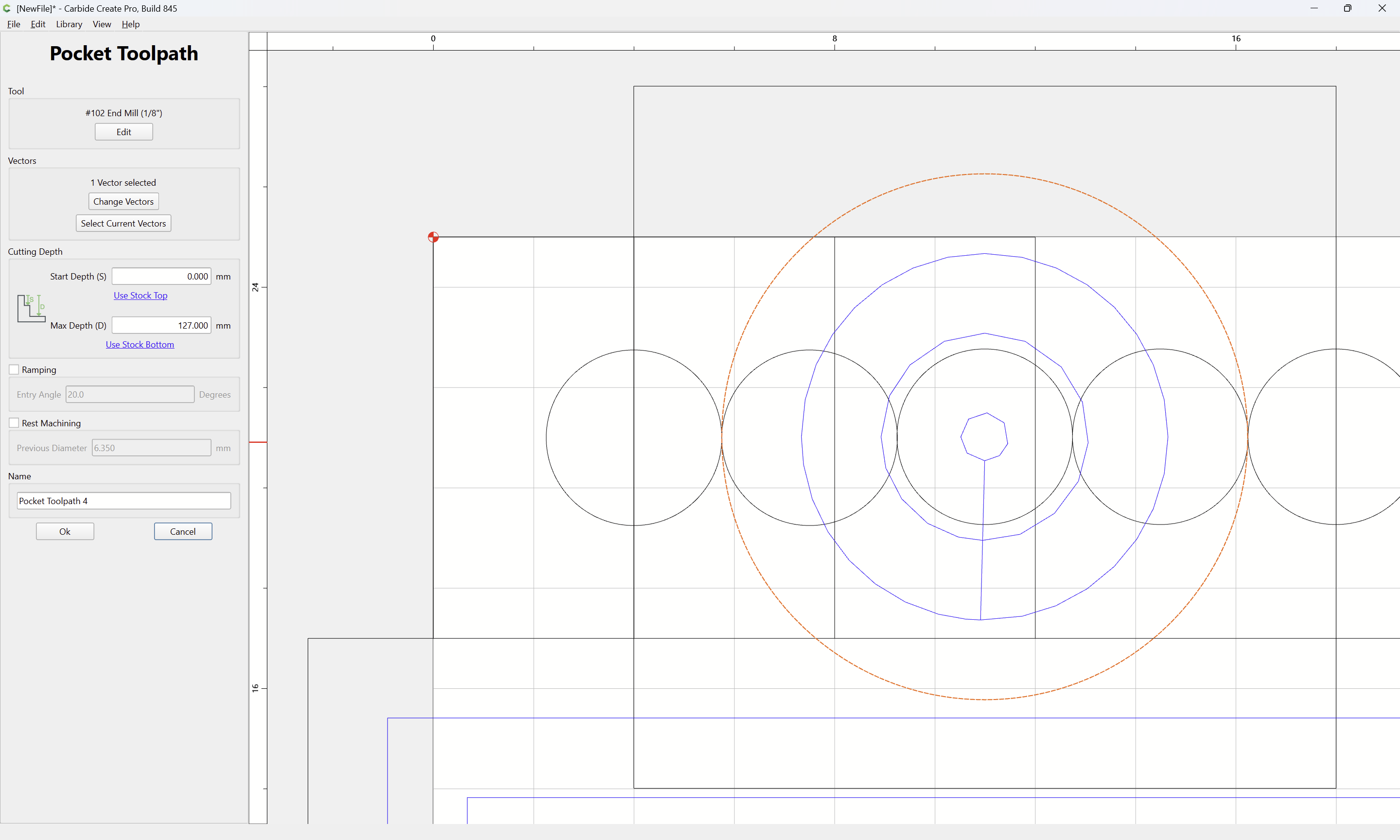

At the end, the button “OK” and “Cancel” get focus:
