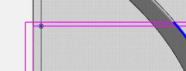

It starts with an accurate left-side fence…that runs the entire length of your bed. Cut it with the gantry, so you know it’s dead accurate to the Y axis.
Then, the key is to lay out an extra piece of geometry in a waste area, exactly the tiling distance from zero - and drill a hole using any bit (I always used the first bit of the toolpaths) and a Drill Toolpath.

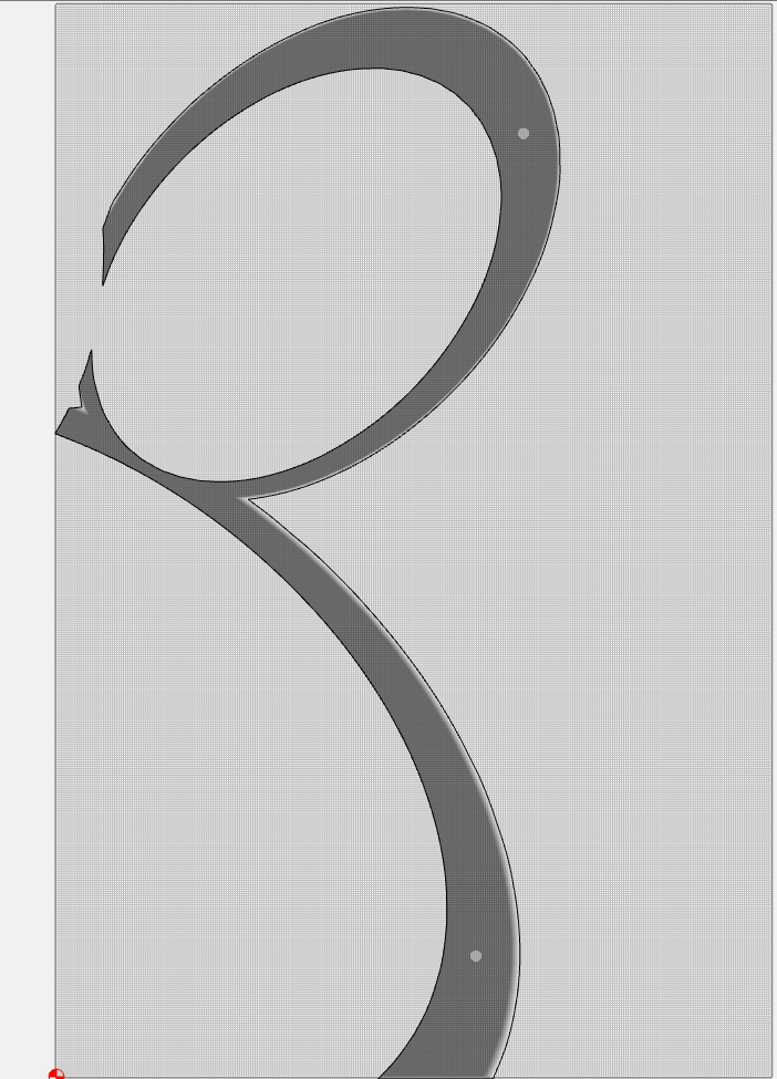

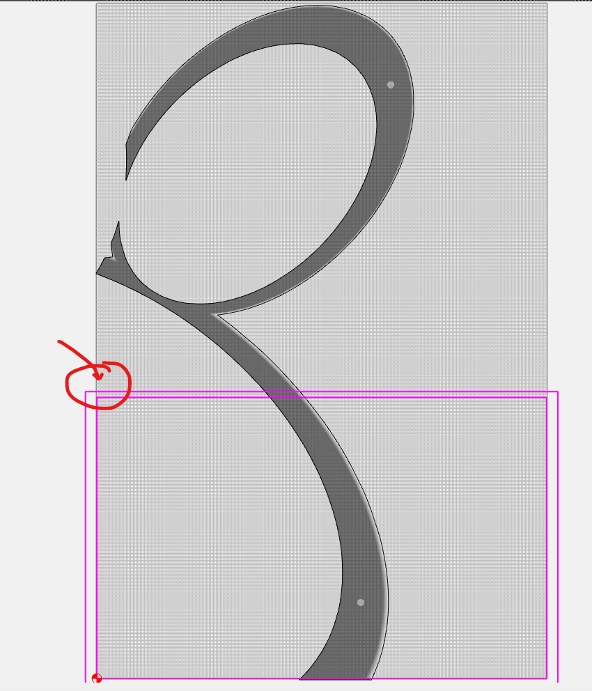

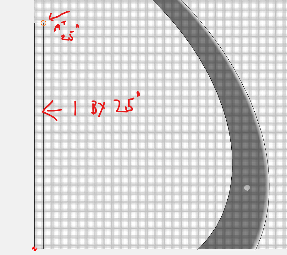

Given a geometry larger than the bed of my XXL (that has complex curves and plenty of them):

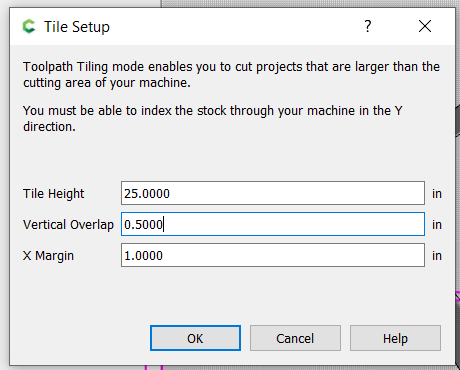

Now…do a set up of the tiling. Select a tile length that will allow you to place geometry in a waste area. For this example, I can choose 25"
Which creates “Tile Zeros” where there is no other geometry - Here:
and Here:

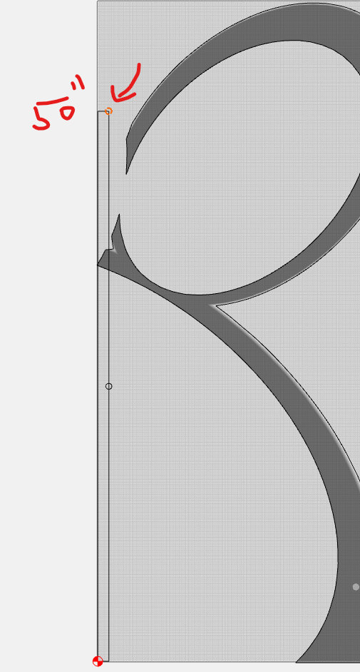

Now…just measure up 25 inches (my Tile length) and put a circle centered on the 25" mark
Do the same at the 50" mark (if you have 3 tiles):

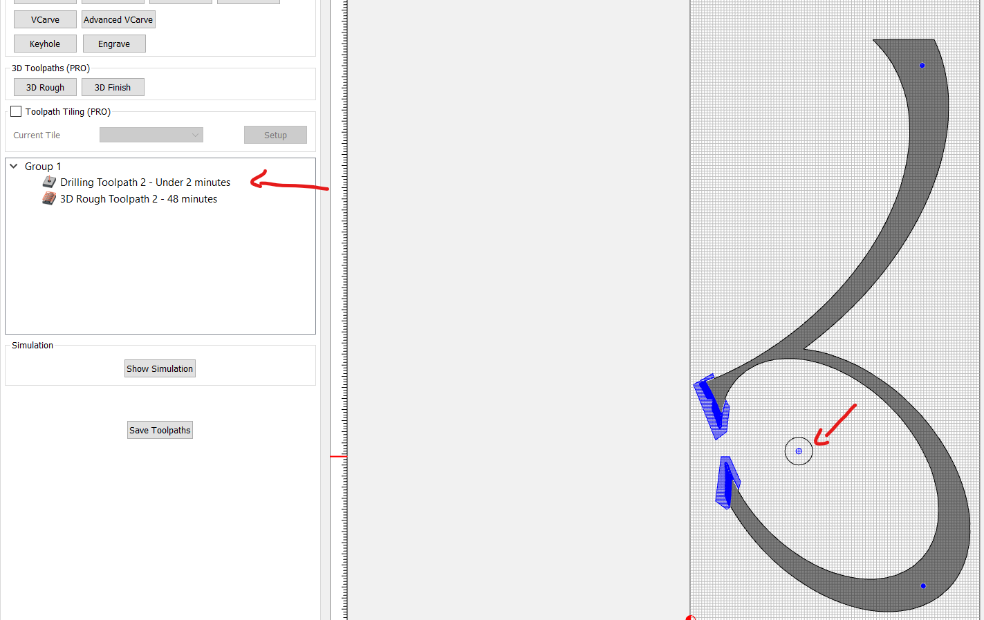

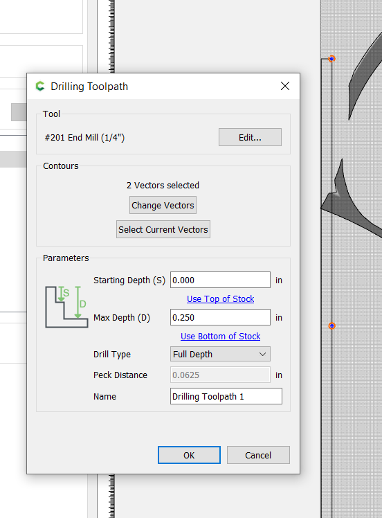

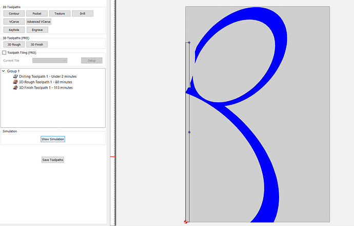

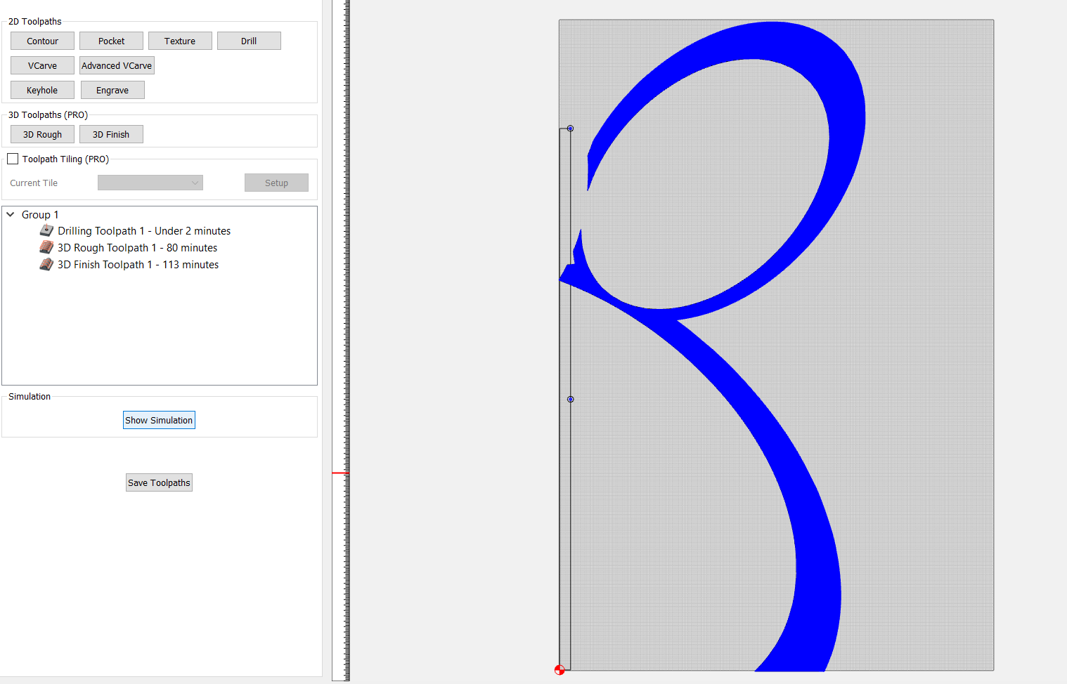

So…now we’re ready to make toolpaths. Just put a drill toolpath as the FIRST toolpath in your job for the two circles:
Then, do the rest of your toolpath work for the design:

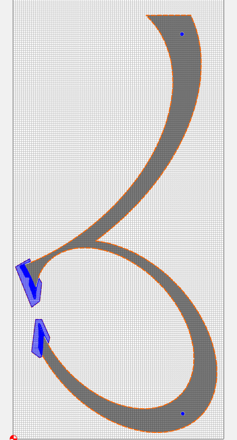

Now…when you Tile your toolpaths, you’ll notice that the circle will always be cut first. And here’s the important part - because the drill toolpath is within the OVERLAP area of the Tiling Setup, it will be cut, in its entirety, for the the first tile…AND it will ALSO be cut (again) when the second tile is cut.
Tile #1:
Tile #2:
So…Cut Tile 1 - the hole is created…then, the rest of the toolpaths will be cut.
Then, move the piece, so that the hole is aligned with the Zero of your table…approximately - it doesn’t have to be exactly at zero…but it does have to ride the fence perfectly.
Now…here’s the trick: When you cut Tile 2, the job is going to try to recut the hole first. I pause the job as soon as the spindle starts to drop towards the hole, and STOP the job. Then, I go to JOG and drop the bit down from that location until it gets close to the hole. Then I start to jog around until it fits the hole, keeping track of the distance and direction of X and Y, thatI need to move the bit until it sits directly in the hole. Then I raise the bit, jog to zero, and adjust the spindle location by that same distance and direction and REZERO. Then I restart the job and let it go. It descends into the hole (very satisfying and reassuring when it does that) - and then goes on to perfectly continue all of the rest of the toolpaths.
It’s an extra step - but I have NEVER had the bit come down in the hole accurately…no matter how precise I try to be in relocation - even with physical keys and lines and all sorts of things. Turns out, the simplest thing - a hole the size of the bit - is the perfect alignment aid…and spending a few minutes getting things aligned and rezero’d is perfect for making sure lines continue correctly after tiling.

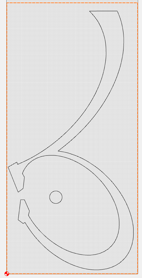

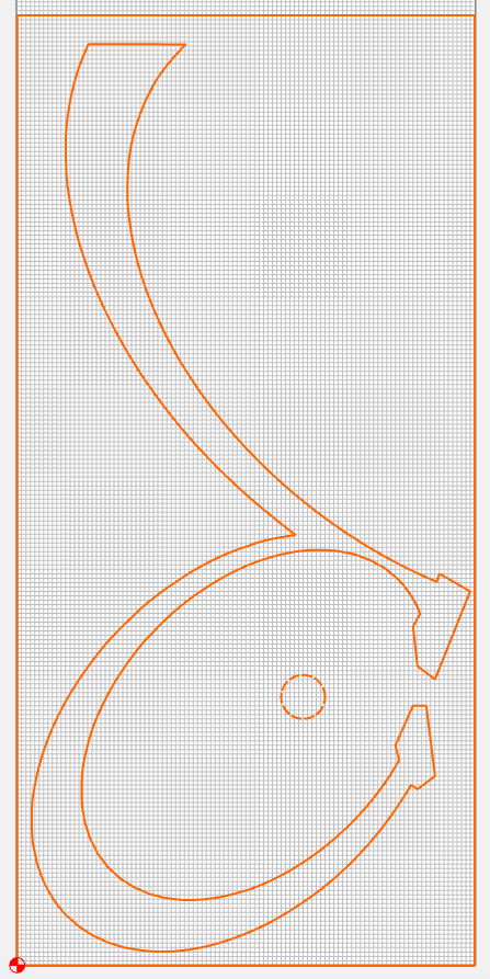

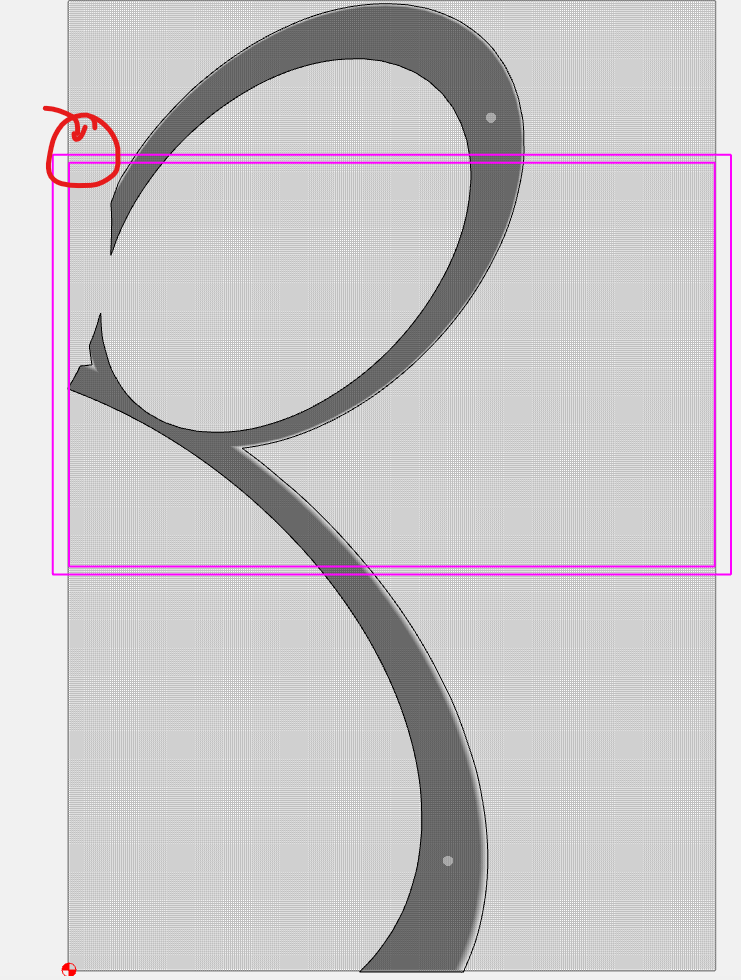

I started by importing the TOP side of the STL file:

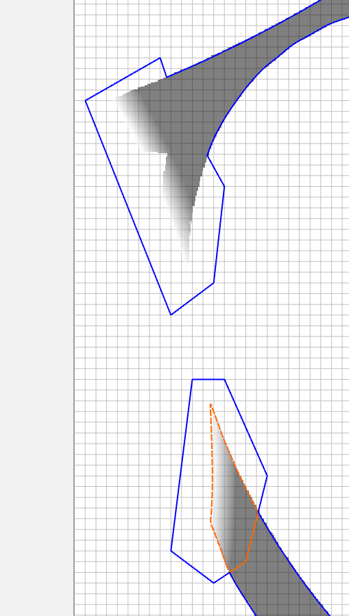

In this case, those white spaces on the tips of the forked sections are COPES. In order for the cope to be cut all the way through the wood, and to minimize the cutting time, I found the need to add some geometry to increase the deadspace for the cut…beyond the width of my cutter…so I added geometry to the tails (the only place it was going to be cut…You’ll see what I did when the cutting was throughout the design in a second). So I added geometry to the tails and Boolean WELDED the shapes to create a new shape:
Then I modeled the resulting geometry:

First, I need a reference point. So I draw a circle somewhere on a waste area on the piece and then add a toolpath for that circle that drills ALL THE WAY THROUGH the piece. I make that Toolpath THE FIRST toolpath in the job:

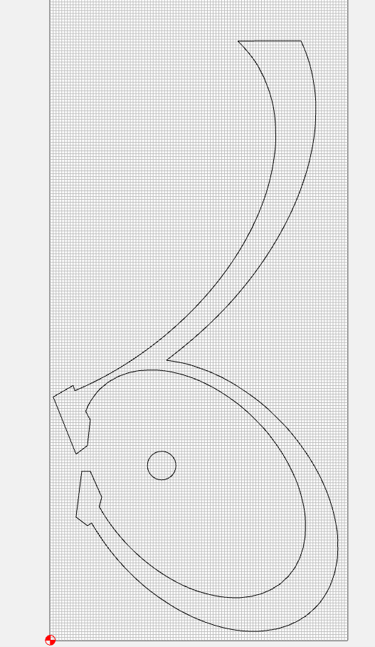

Now you’re ready to work on the flip side…the BOTTOM of the STL:

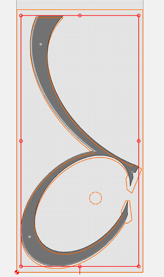

Start by deleting ONLY the model of the imported file - LEAVE THE OUTLINE.
Then… add a rectangle, the full size of my stock (the actual stock…not just the size of the bed). This does not have to be precise, but the closer you get, the better you’ll be. Align it to your bottom left corner:
Select the rectangle, your imported STL traced outline, AND THE CIRCLE. GROUP them as a single unit, and then MIRROR HORIZONTALLY. Then UNGROUP THEM.

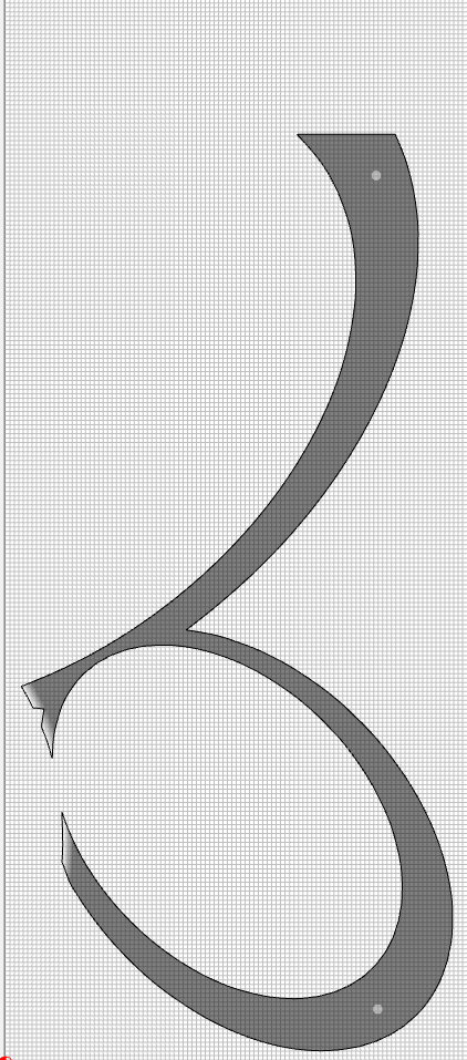

Now…import the STL again…this time, using the BOTTOM perspective:
NOTE: You will need to ROTATE the imported file 180 degrees so that it orients like the flipped image you already have:
Now…nudge the new model until it snugs in perfectly with the outline. Accept the import. And you can delete the old outline.

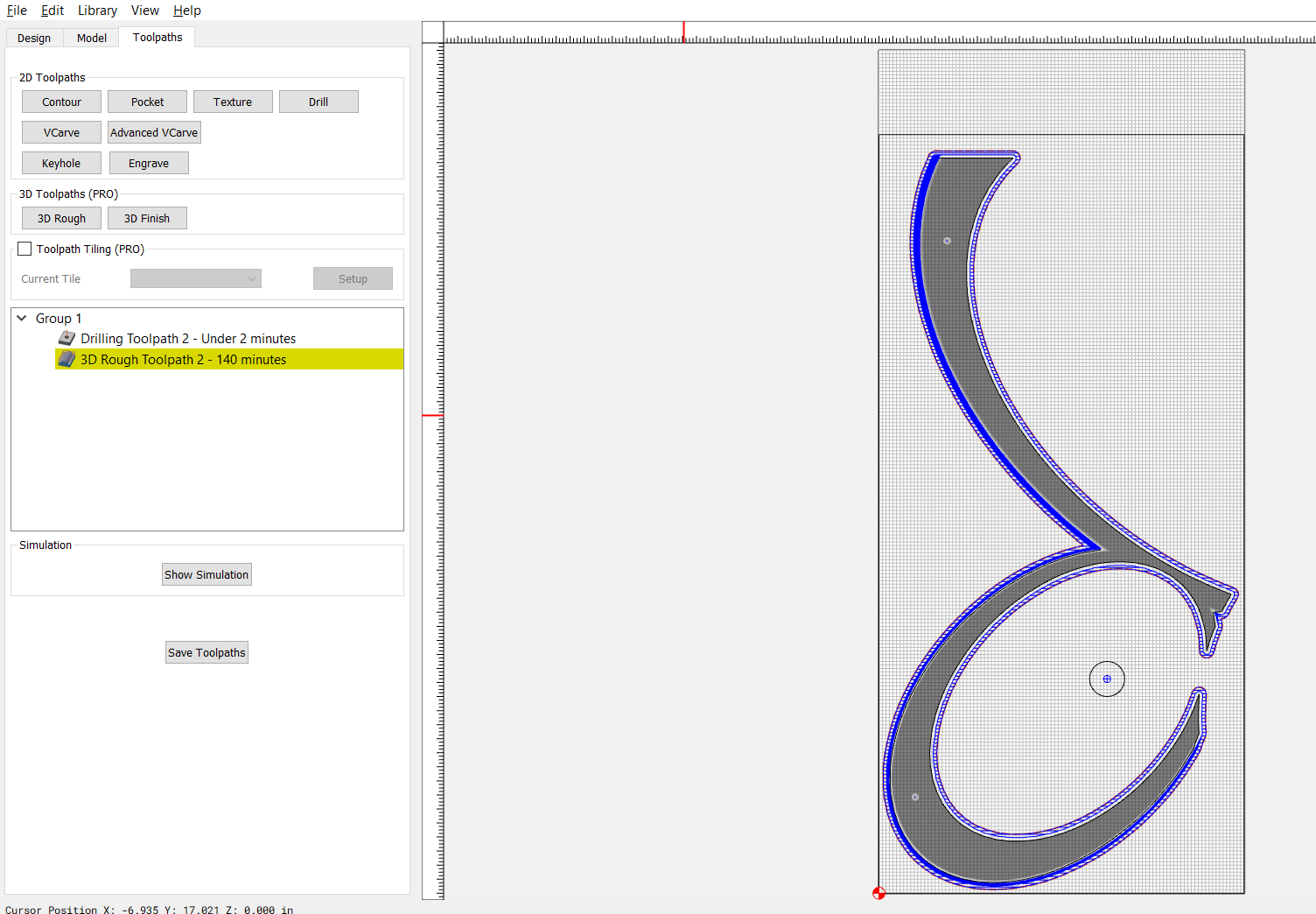

Now you’re ready to set up the toolpaths for the new layer. I have found that, to get the full cut of the bevels, all the way through the stock, you need to create an offset to the traced STL file wide enough for the bit that you’re roughing with…so I put an OUTSIDE OFFSET and that’s what I use for my rough and finish:
NOTE that the circle toolpath is STILL #1…only the circle is now in it’s flipped location - and correctly aligned to the newly imported file.
Save the BOTTOM c2d

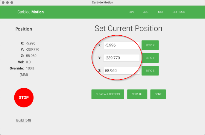

Hey Tod, that does sound easier! I’ve never “Typed in the location”…where do you do that? And can you just then restart the job to make it run? If you don’t mind, maybe take me through the steps that you’re taking?
In the “Set Zero” dialog, next to the “Zero X”… buttons you can just type in a value. Make sure you hit “Enter” after typing.
So the whole process would be to note the position of the hole after mirroring / flipping.
Cut your first side, flip it, align it with the fence, clamp it down.
Jog to the hole position & center the tool/probe over the hole.
Move it down into the hole & fine tune it.
Then hit “Set Zero” and type in the known values. Z should probably not change, unless you changed tools with the flip.
Now you can rapid to zero XY to check it. Or you could jog to the previous zero point, which would be at X48.0 Y0.0 (if your stock is 48"), and it should be at the exact previous zero point.
Ah…Got it. So instead of “zero-ing”, you’re telling CM that this spot is this specific location and then it determines the rest.
Would I need to know the location of the original hole at all? I’m guessing all I need to know is where the design says the flipped hole would be. Correct? I do think that would be simpler (and better). Thanks!
No, you really only need to know where the hole is after you flip it. But that is determined by the original location, so you either do the math, or mirror & pick the object to get the new center.
Definitely a better way to do it. Thanks. I guess it would work for the tiling situation as well…particularly since the hole is always going to be a specific distance from the tiles zeroes.
