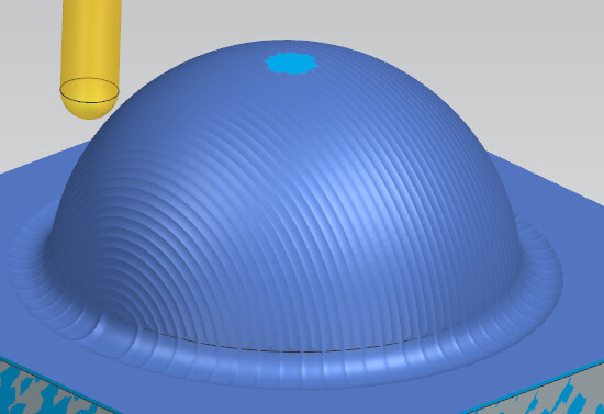

He’s talking about removing the peaks (Red) to get closer to the finished surface but still leave some stock. Kinda like a semi-rough or semi-finish operation.
This is 1.75 tall, 0.75 base, 1.0 curved contour
If I copy the rough operation, change the stock to leave to something smaller, and set the DOC on the tool to 2", it cuts nothing. If I set the DOC to 1", it only cuts the top of the flat (Blue).
If I set it 0.5", it cuts one pass 0.5 deep, then the top of the flat area only.
File too big. But you can duplicate this in a few minutes.
Ideally, what he wants is a new toolpath type, “Semi-Rough” that would do a contour on each level instead of a pocket. Then you could set the depth of cut smaller, still have “Stock to Leave”, and not waste time cutting air. (Z-level profile in NX)
What he’s asking for would be more like a semi-finish, that just adds some stock to leave to a finish pass. You could run this with a larger stepover, but still remove the steps from the roughing pass.

Rough path for reference…
Here’s a semi rough
And here’s a semi finish with the same stock & stepover
Both get the stock down close to the finished surface.
For giggles, here’s a mixed cut that uses the semi-rough (Z-level) for steep areas, and the semi-finish (zig-zag) for non-steep
