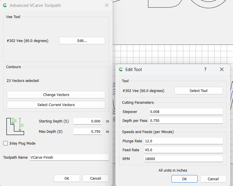

There are 3 types of areas/regions
Wide: uses the clearing tool
Medium: clears full depth with the V bit
Narrow: no clearing and variable depth
If you separate the narrow area from the rest you can rerun that path without cutting air
For the medium/wide area you can regenerate the toolpath with the clearing tool disabled

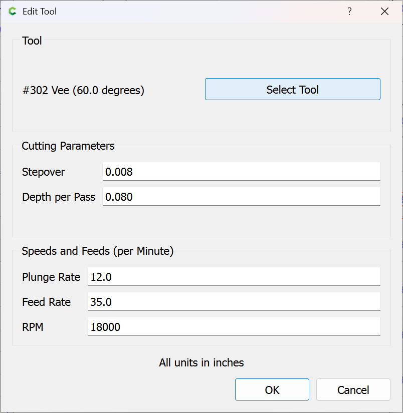

Click on Tool | Edit
Then change Depth per Pass to the max depth which the tool can cut as noted on the Specifications section of the web page for it.

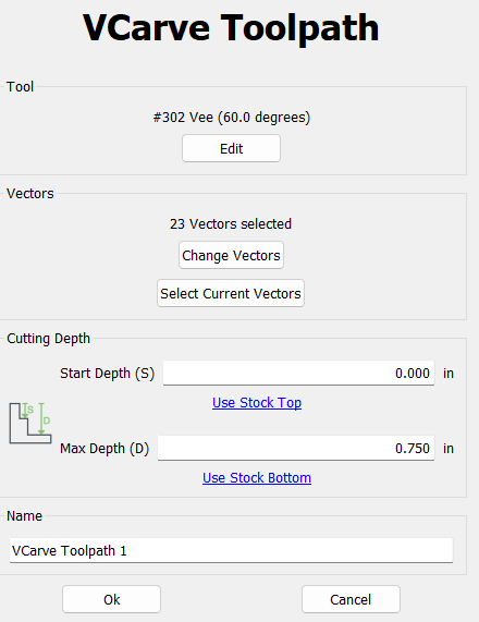

Just a couple questions before I run this program -
You’d normally run a standard Vcarve program for the rough-in carve and then have a separate finishing program that runs right after like below, right?
I double checked on the C3D site for the max cut depth for the #302, and I don’t see it noted, but I may be looking in the wrong spot:
However, it appears as though the program side of things in CC may be calculating things for me behind-the-scenes. I set the pass depth for the stock thickness that I’m using, and the simulation appears to be fine. Let me know if the settings below are how you’d normally handle this, or if there’s a better way.
Thanks for the help on this, I really appreciate it!

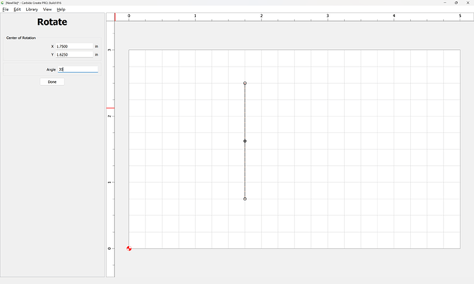

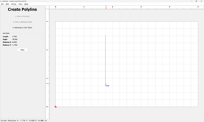

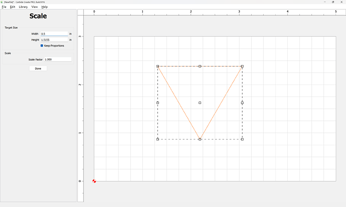

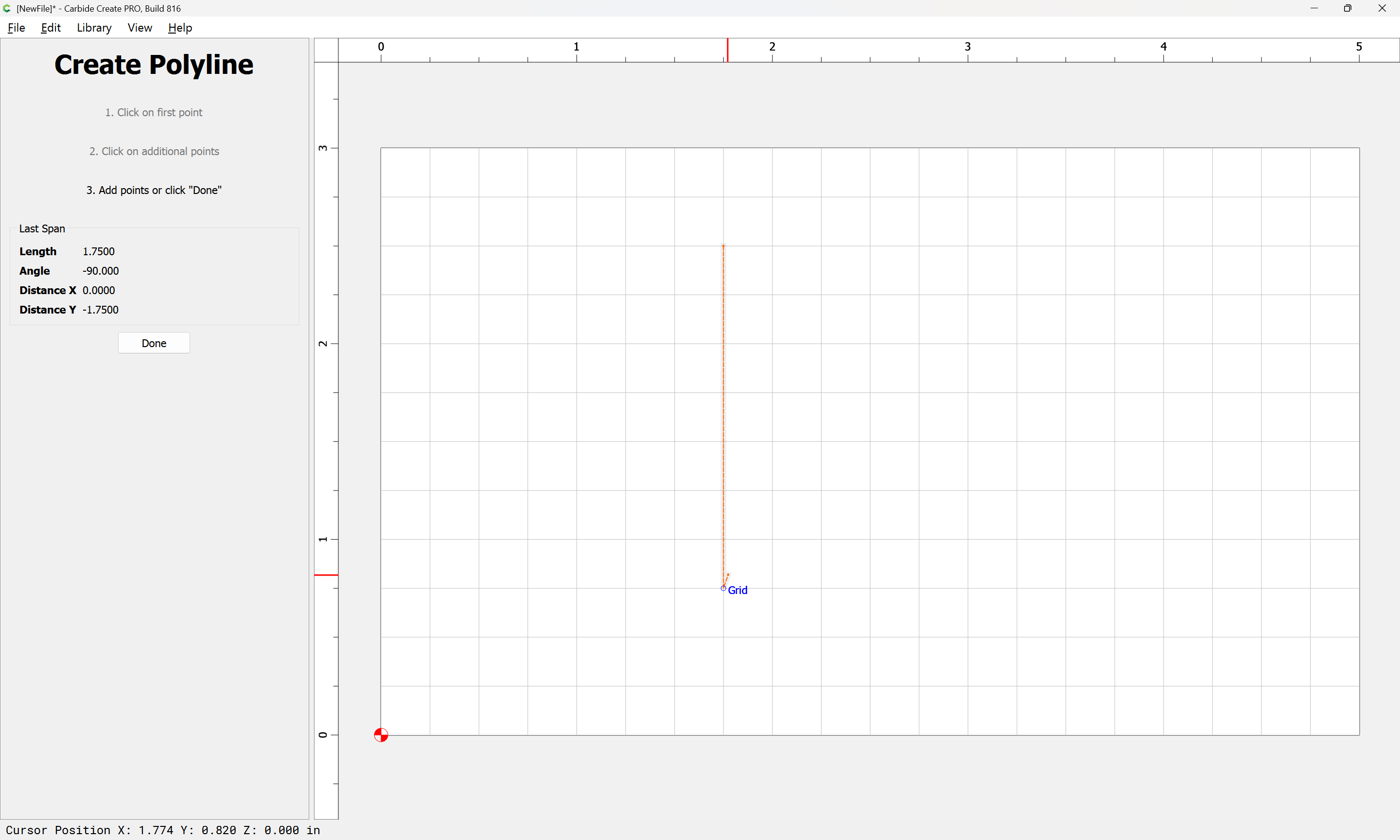

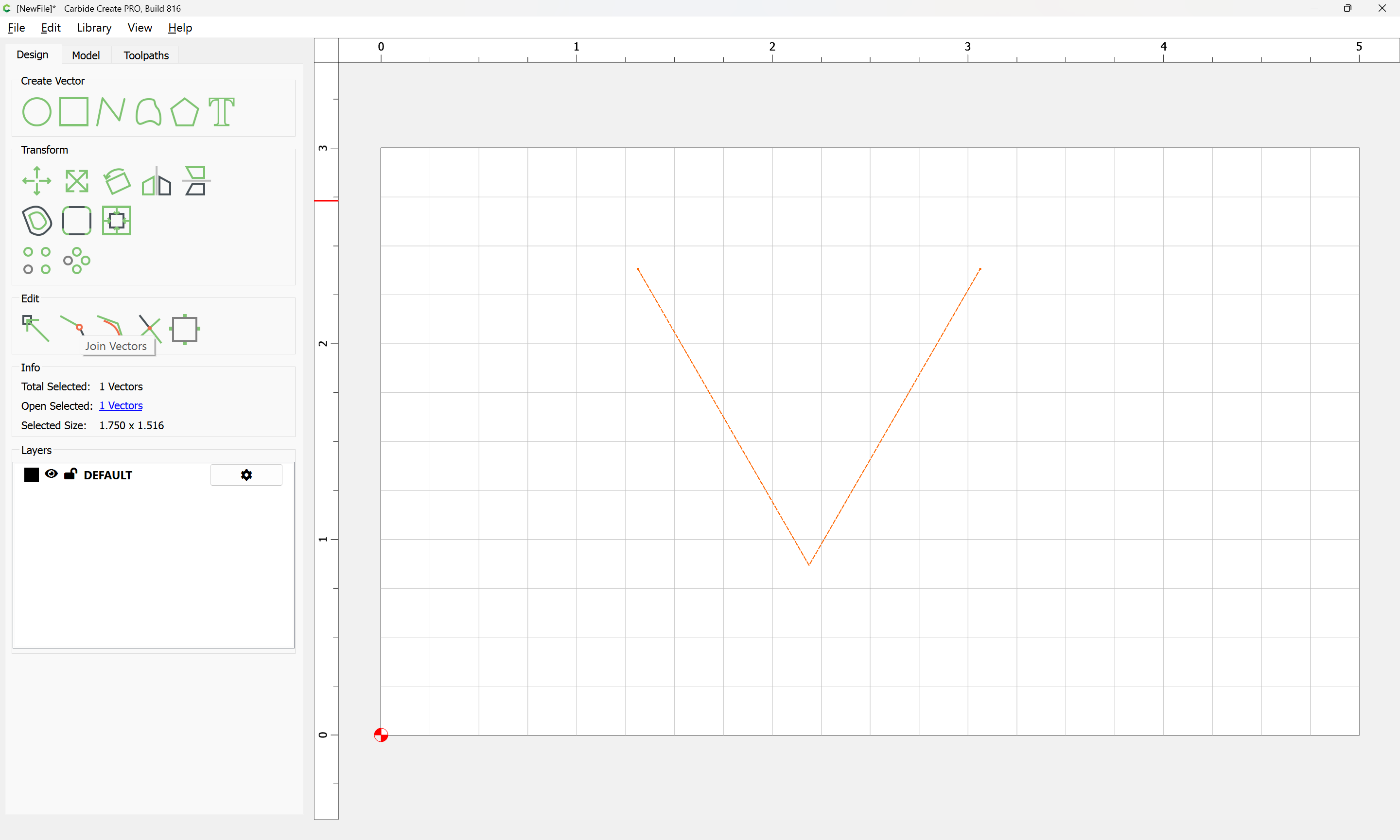

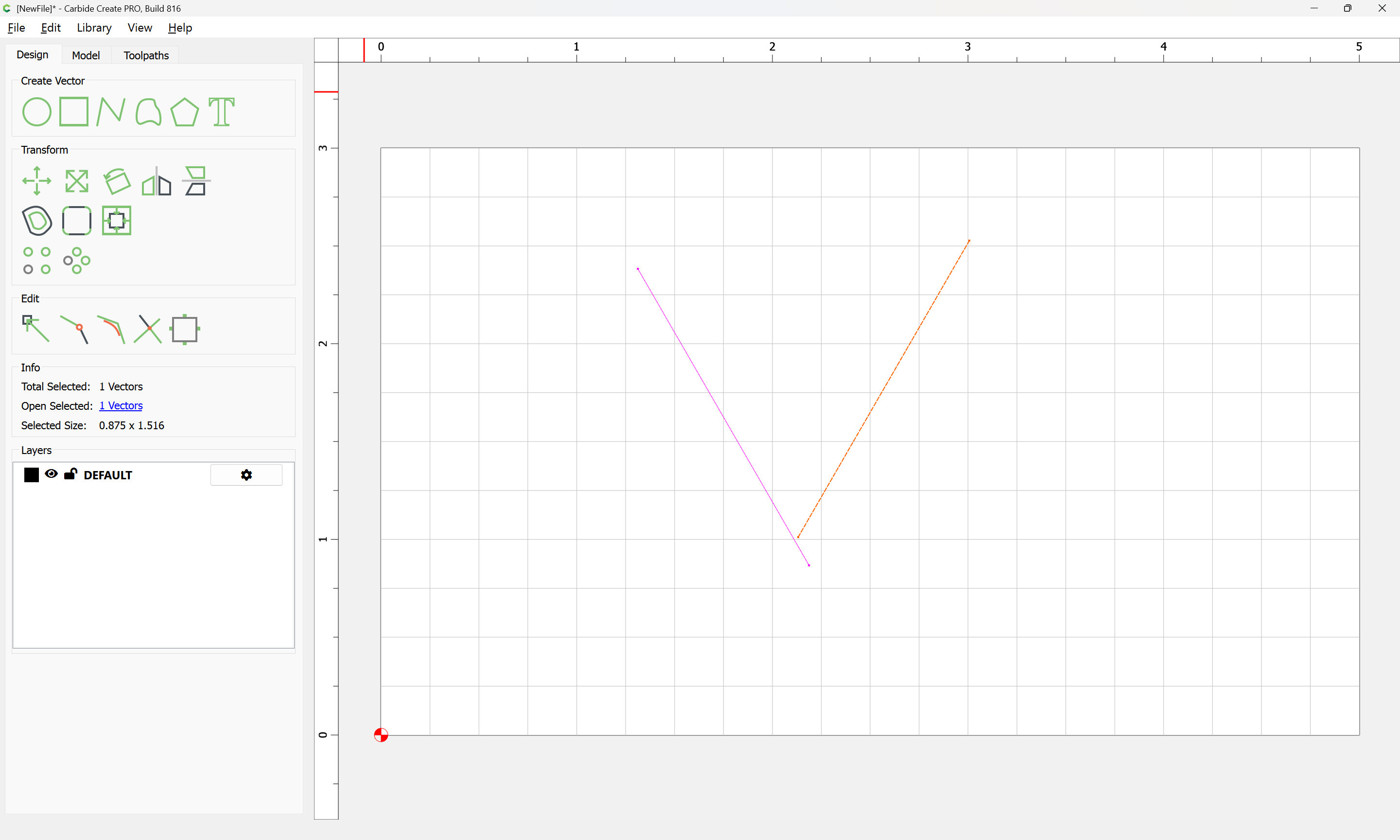

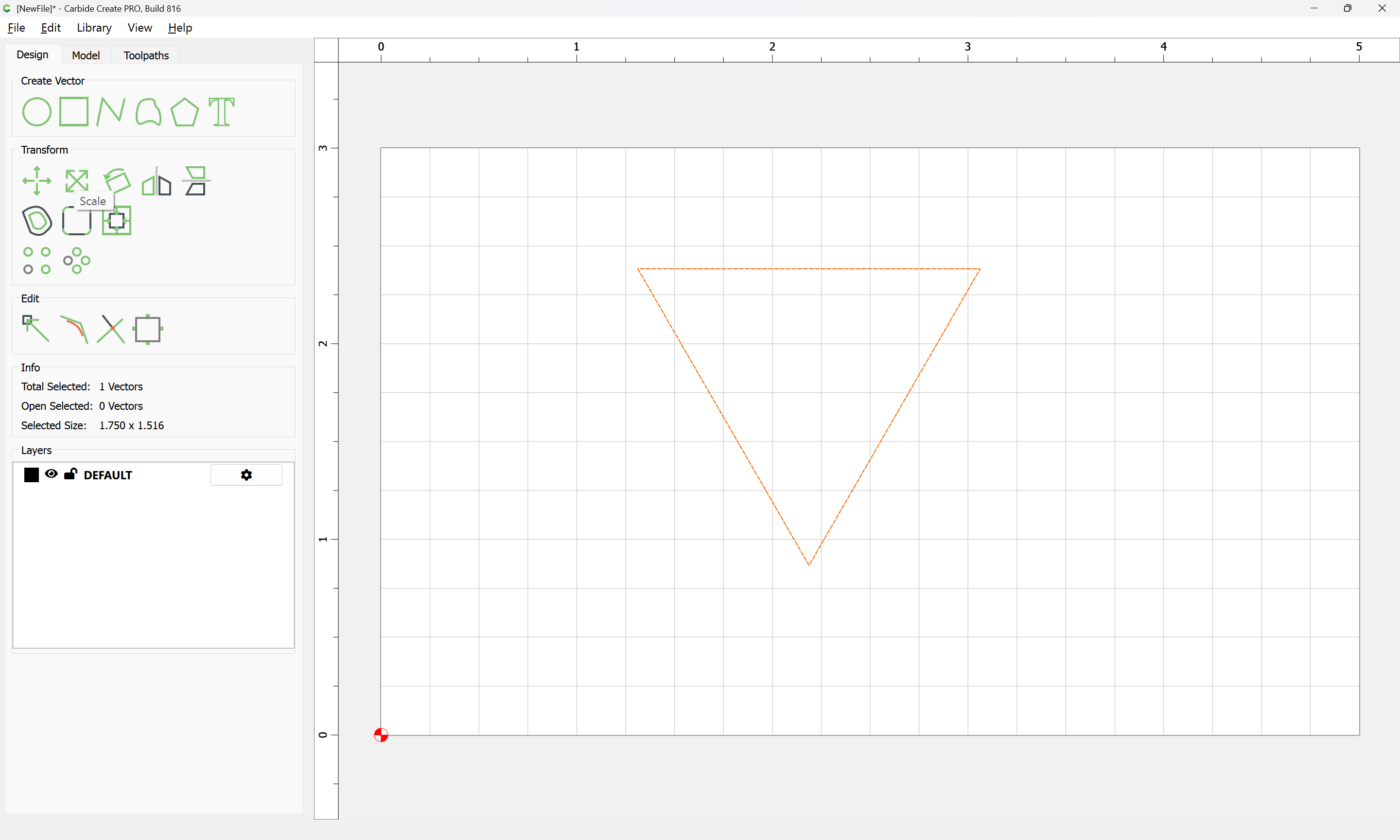

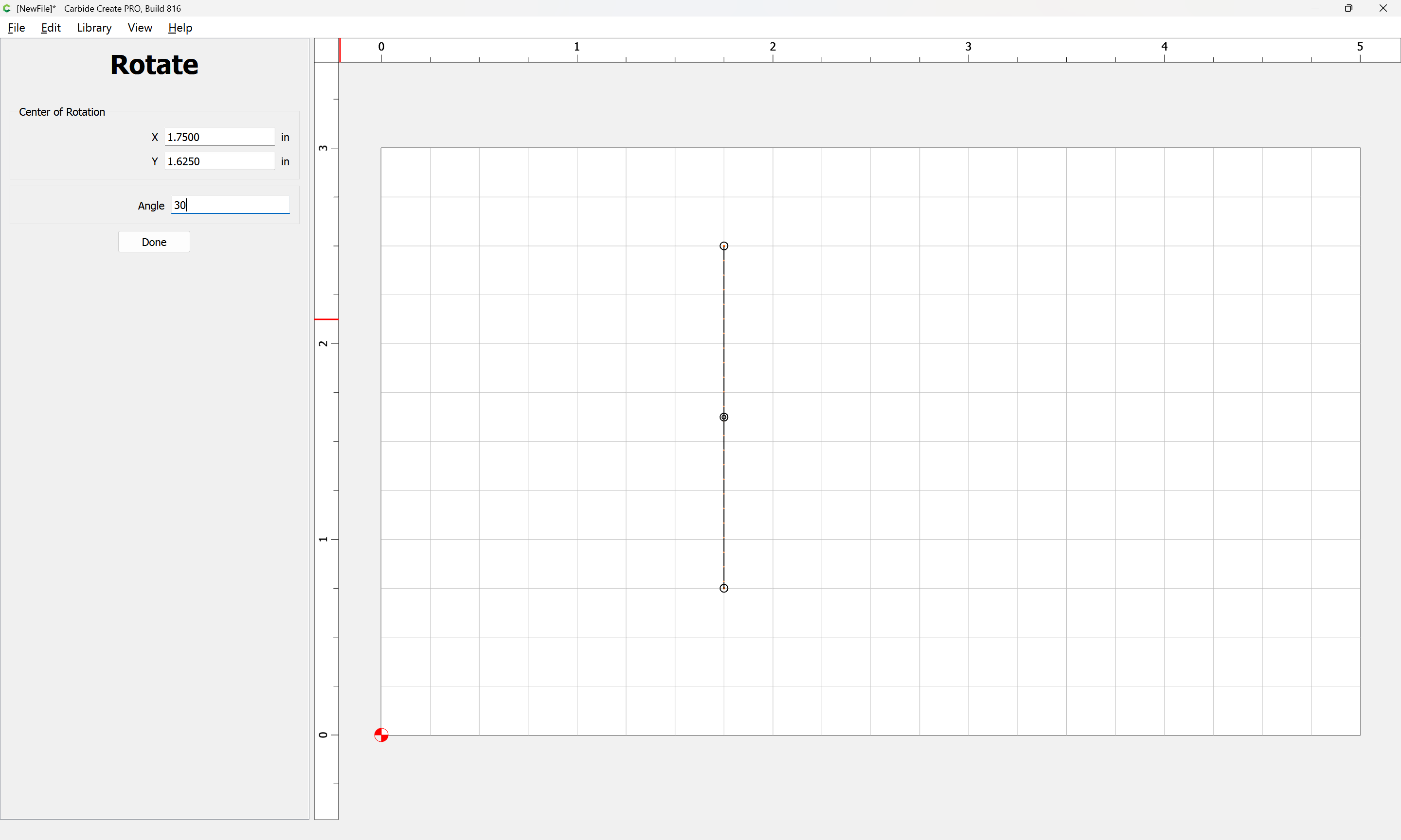

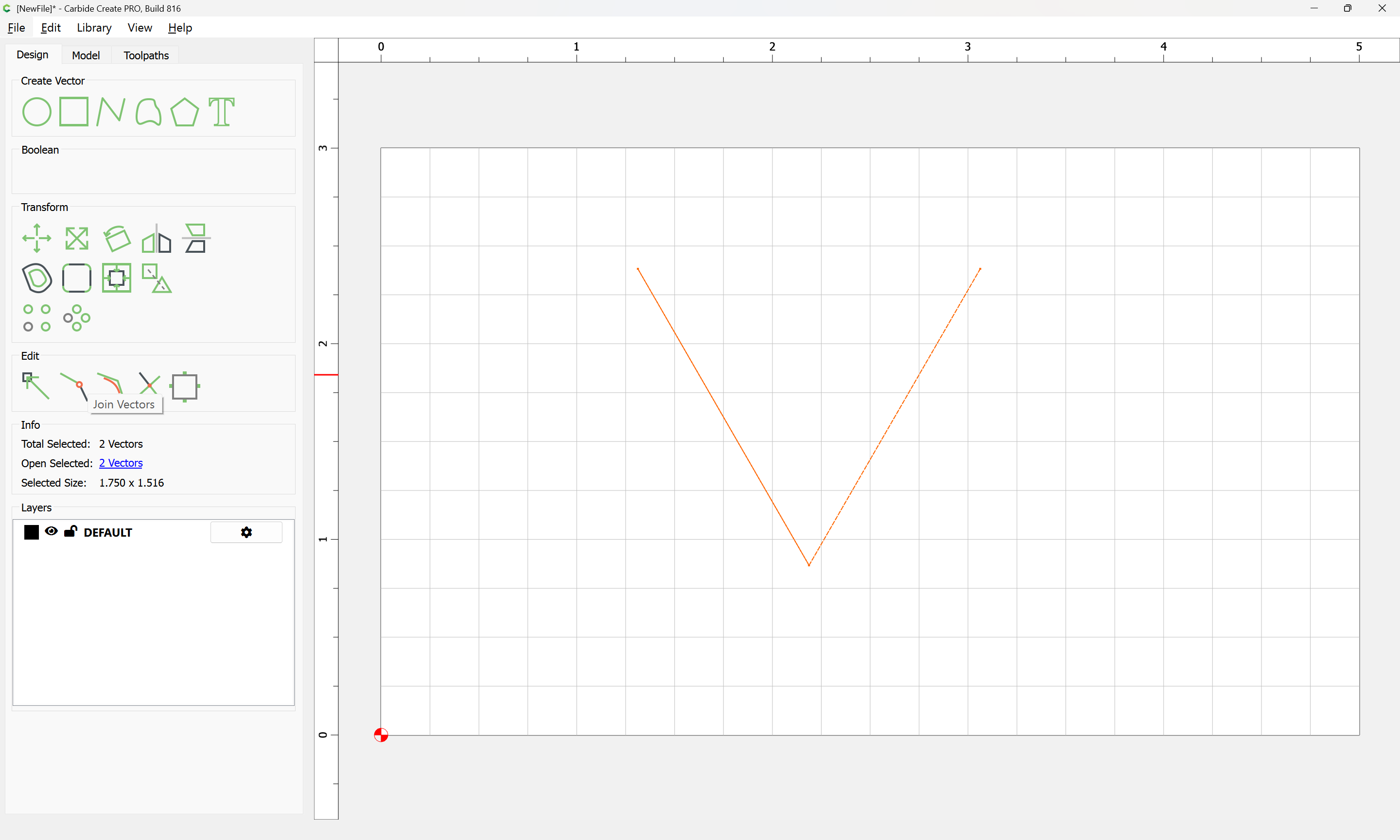

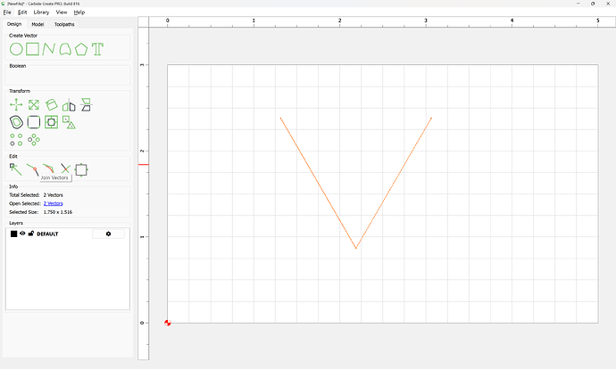

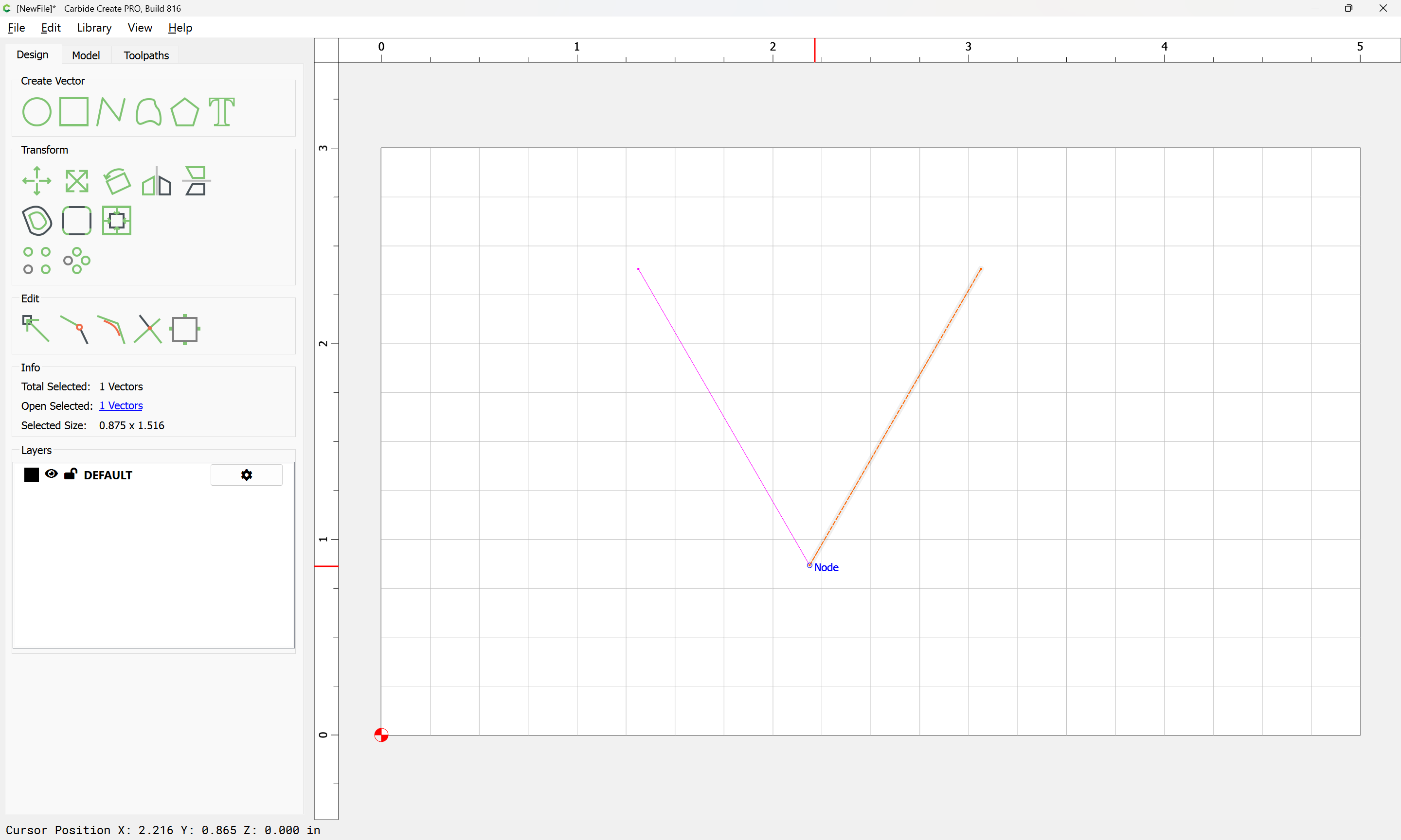

In the absence of a specification, draw the tool up in profile:
Rotate
Done
Duplicate:
Mirror Horizontal
Drag into registration:

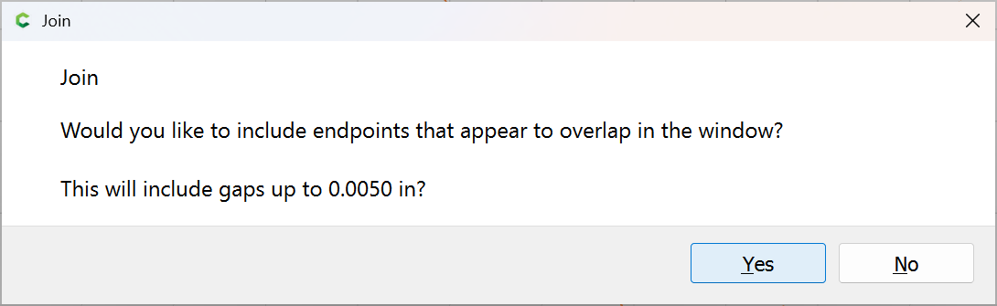

Join and close
Yes
again

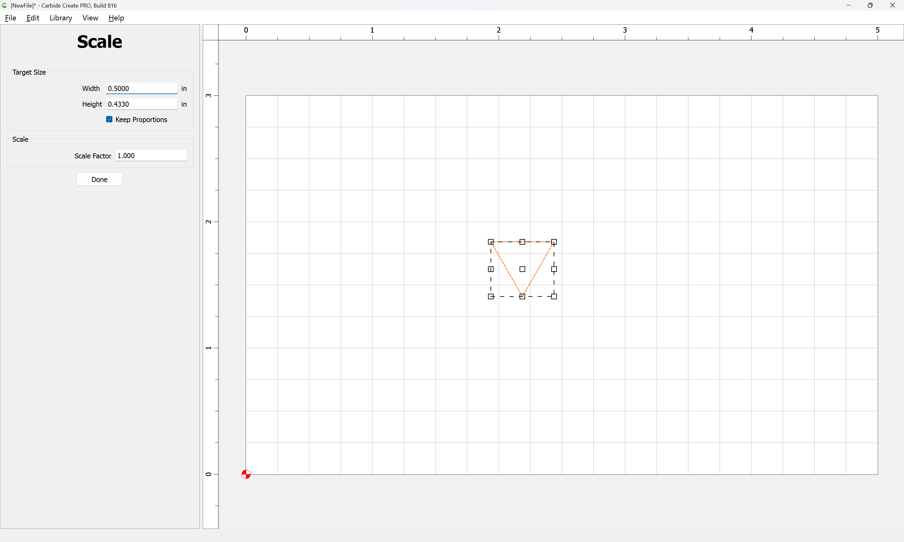

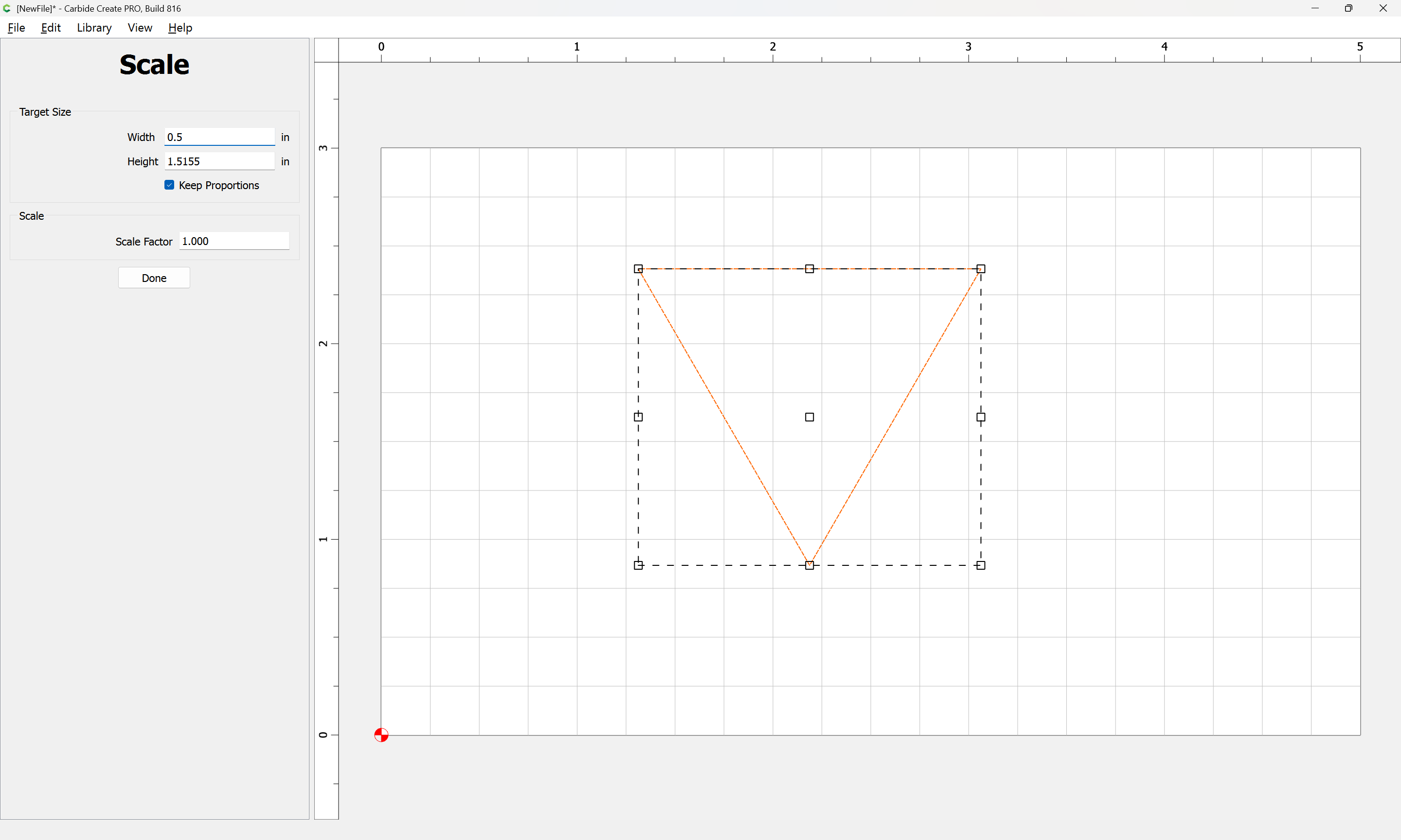

Scale to the diameter of the tool:
Done

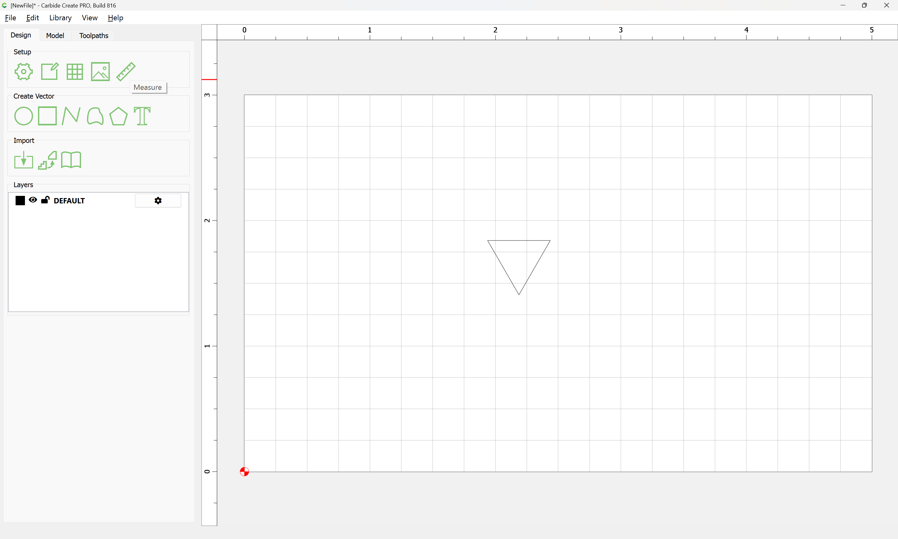

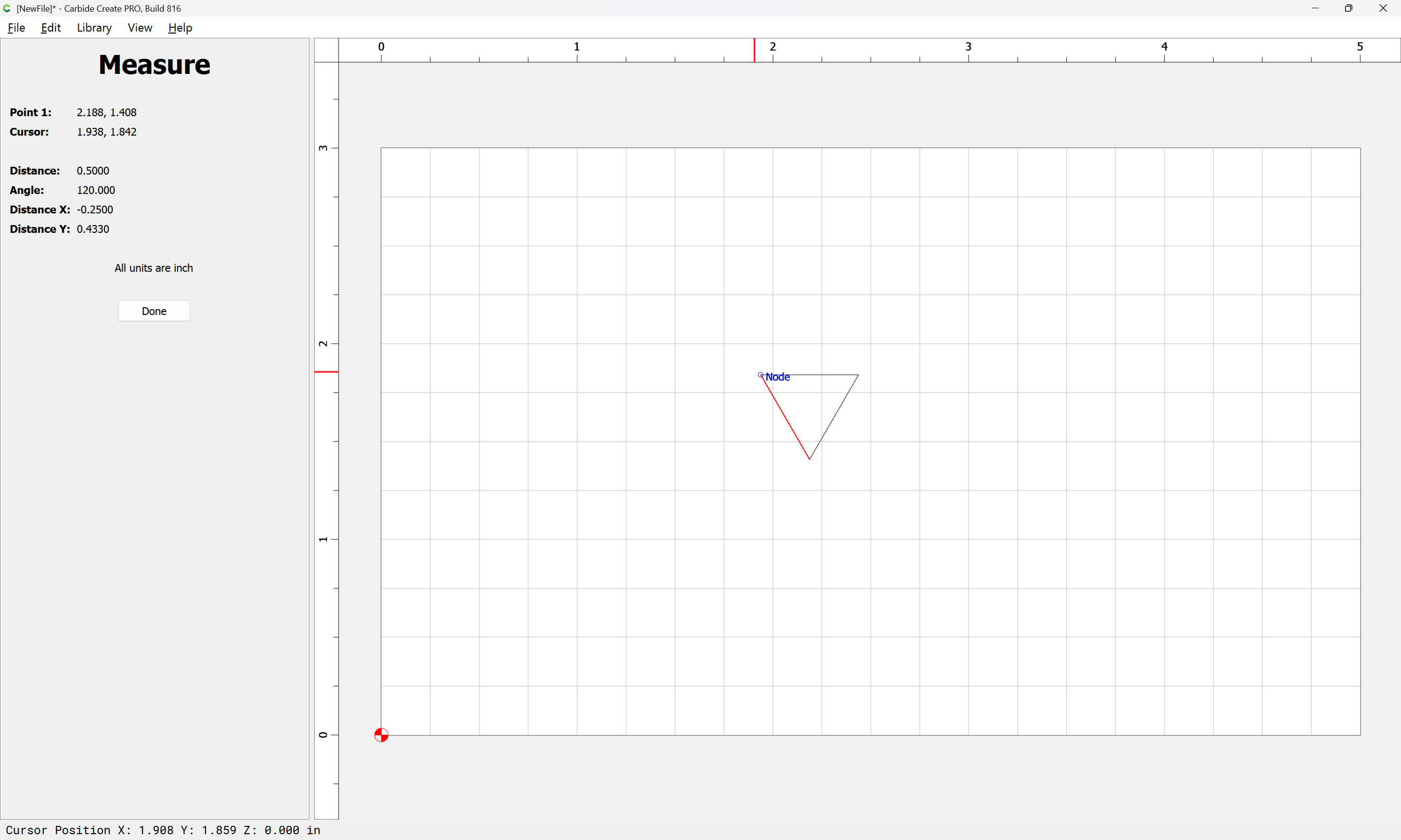

Measure:
Max Depth is Distance Y: 0.433 inches.
