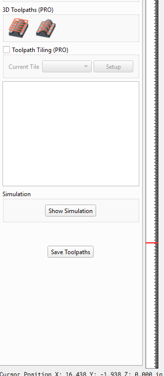

CC853: Increase Toolpath List Window

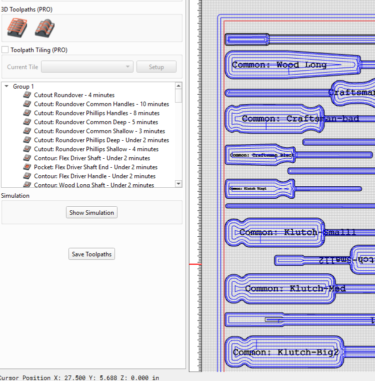

Recently updated to CC853 and found that the Toolpath List Window size was reduced and now there’s a large blank area under it with just two buttons–no need for this much blank space at the expense of the actually usable area in the Toolpath window, looking to avoid constant scrolling and get more usable info on screen.
Exacerbated by my recent overkill project of a screwdriver drawer insert with 103 toolpaths as a result of each driver needing it’s own depth (again, overkill–I’ll never get those 4 days back).
Thanks!

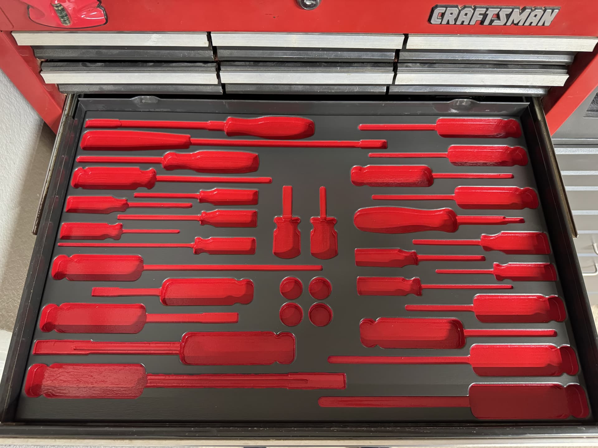

For those interested, here’s the final board.
You forgot the words to remind you what goes where :joy:
What material is that?
I have used foam which is problematic because it moves with pressure from the bit.
I have also used the cheap insulation boards from Lowes which machines well but isn’t really pretty.
Material is 1/2in Baltic Birch, spray painted the entire board with multiple thick coats of red then sanded the top surface and rolled the dark grey topcoat.
Thanks.
