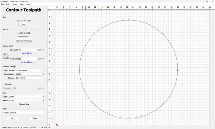

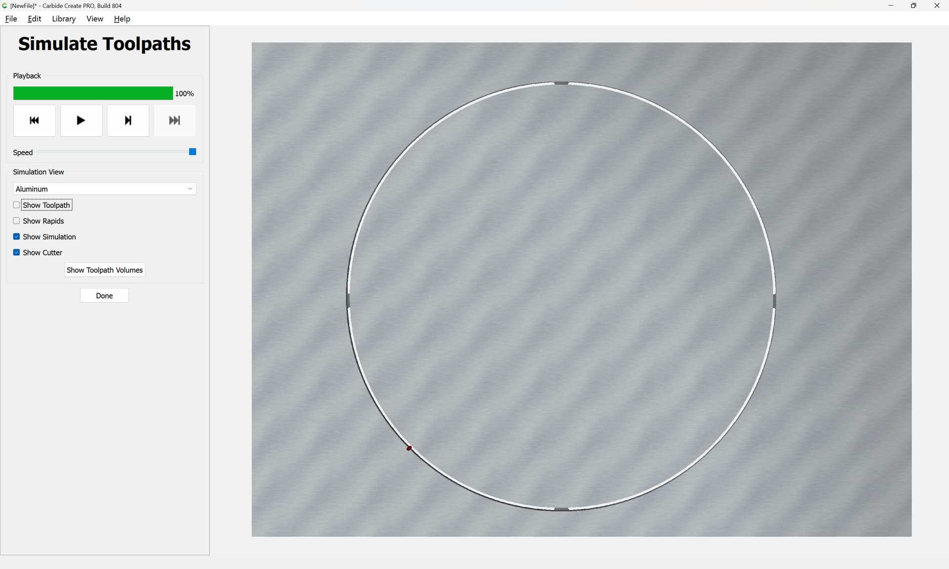

I have updated the software to recent version (carbide create and Motion). How can I make Tabs (taller and longer) for my work piece. Recently I have had my work piece get slung out off of my Shapeoko 5 Pro, I am assuming I was trying to run too fast of a job… (90) inches per minute on 1.5 inch stock. Once I slowed everything down and sped up the Spindle all went fine. Except, my tabs are still too shallow and too short… Any advice as how to increase to 1 inch long x 1/4 inch thick would be much appreciative…
Vr…

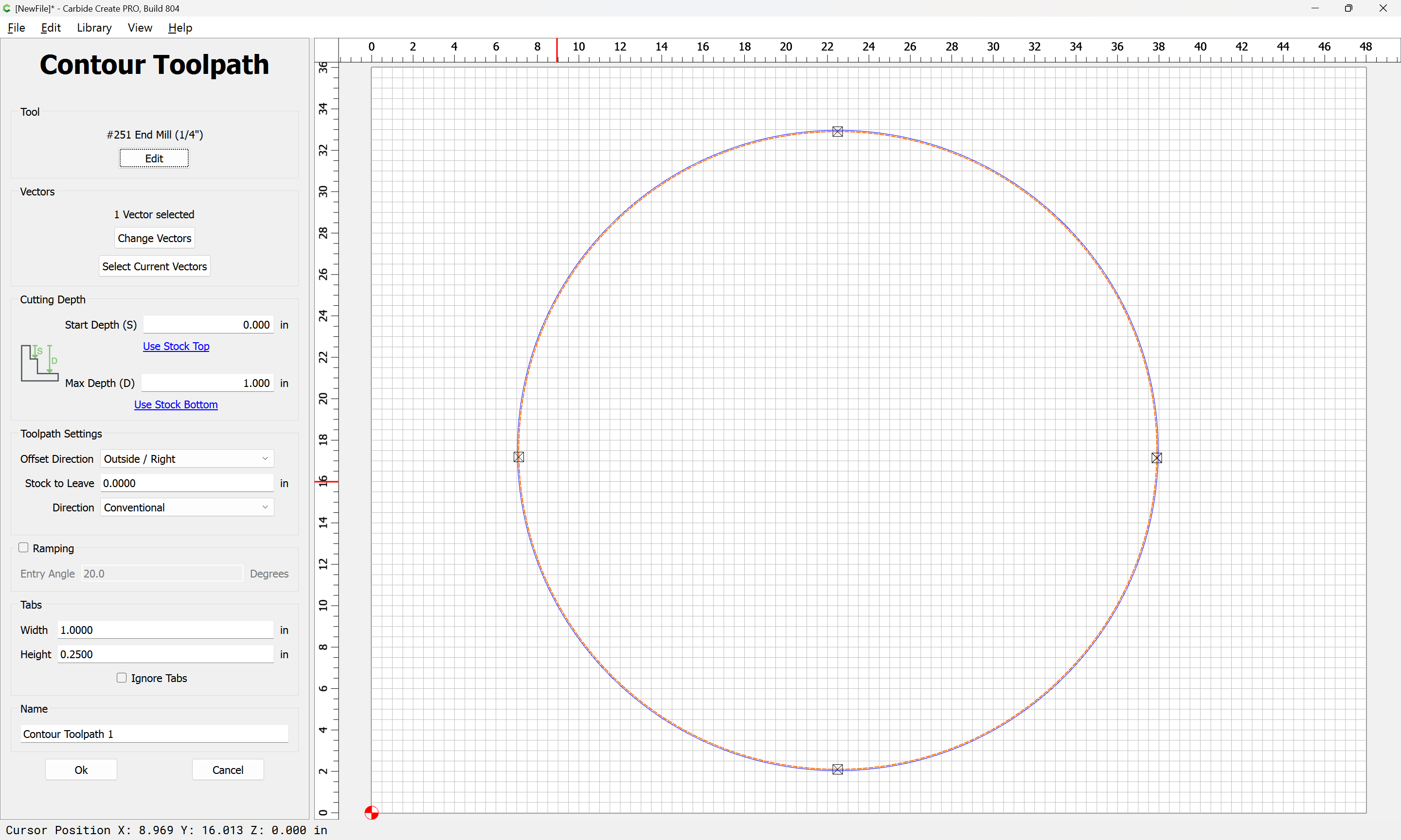

Edit the tab size in the Toolpath pane for the Contour toolpath in question:
See:
https://carbide3d.com/hub/courses/create/tabs/
