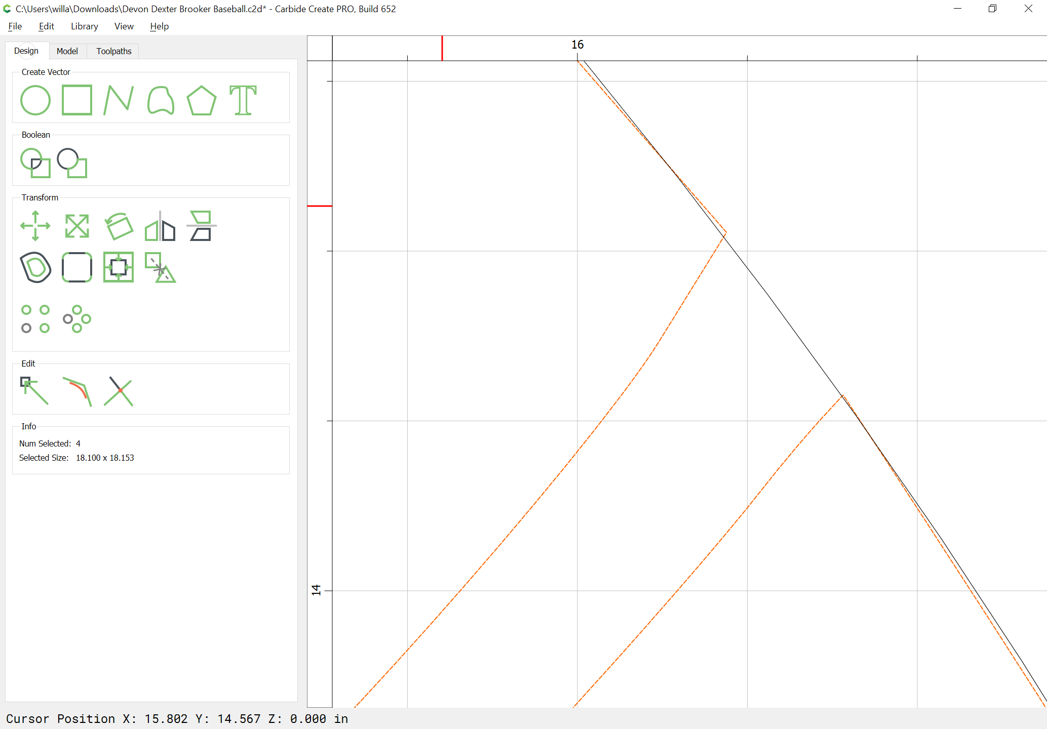

Okay, using 652 we start by loading your file:
Then we zoom in on a region which we wish to fix:
While the line could have been used, it’s better to have the arc, esp. for a larger area, so select and delete it:
Then, select the circle and adjust its radius:
The copy it, move the cursor off the screen, and paste it in place:
Repeat this for the geometry you wish to work w/:
Select one copy of the circle and the geometry which you wish to modify:
and select the Trim Vectors tool:
and click until all the geometry around what you wish to work w/ is removed:
OK
Select the geometry which you wish to fix:
and Join Vectors so as to close it:
Repeat this process at the other areas
Note that it may be necessary to adjust the circle radius/placement:
at some points it may be expedient to edit the geometry:
to arrive at:
The original circle is on a separate layer:
