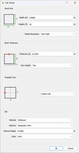

For the flip, we go to Job Setup:
and double the height and set the origin to Center Left.
Then, we move the current geometry up to the top half — this will allow cutting it as it is currently defined, w/ Lower Left as the effective origin:
Note that the move is easiest if the Dogbones are reverted to Square:
Then we copy the letter and the surrounding geometry:
and duplicate it, removing the Toolpath links:
Done
and move it into position:
and Mirror it Vertically:
Note that this means that each half has the same origin point when the stock is flipped.
