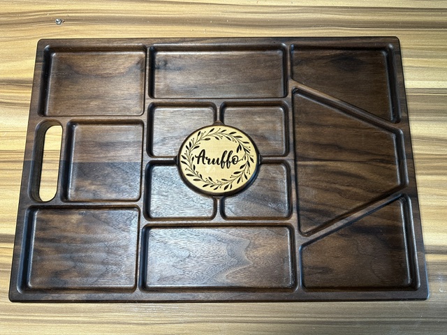

My most requested item. I sometimes layer a piece of hard maple on top or underneath to give a two-tone effect. Designed in VCarve Pro and sent to a Shapeoko 5 Pro via Carbide Motion.

Nice design. What are the measurements.
Anthony
Finished dimensions are 17" x 12" x 3/4".

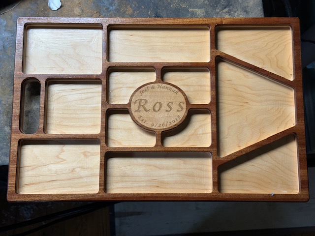

That looks like a piece of zebrawood under it.
Do you have a picture of what that looks like? Do you glue the two wood layers together first and then run the carve, so that the bottom of the board is of a different wood than the top “section dividers”?
Here you go @NYC_Woodworker_17, Sapele over Hard Maple. The two panels are glued into a single panel and then run through a thickness planer. The top (Sapele in this case) is machined to 0.250" and the bottom (maple) is machined to 0.500".

Karl, I for one would like to see your file. I also use VCarve Pro. It looks great. I was trying to find a way to get that custom emblem in the middle of one. You’ve solved that.

I should have mentioned that the center part is a piece of very thin veneer cut on my Co2 laser and then glued to the center before I start machining the tray.

No, the center is laser (Co2) cut from a thin sheet of veneer. The cut oval is a little larger than the finished size. I then run the “Veneer Outline” toolpath and that gives me a guide for gluing the veneer. I glue the veneer to the center and then run all the toolpaths. I’ve tried many, many different iterations of getting the center looking really nice and I think this is the winning recipe.
