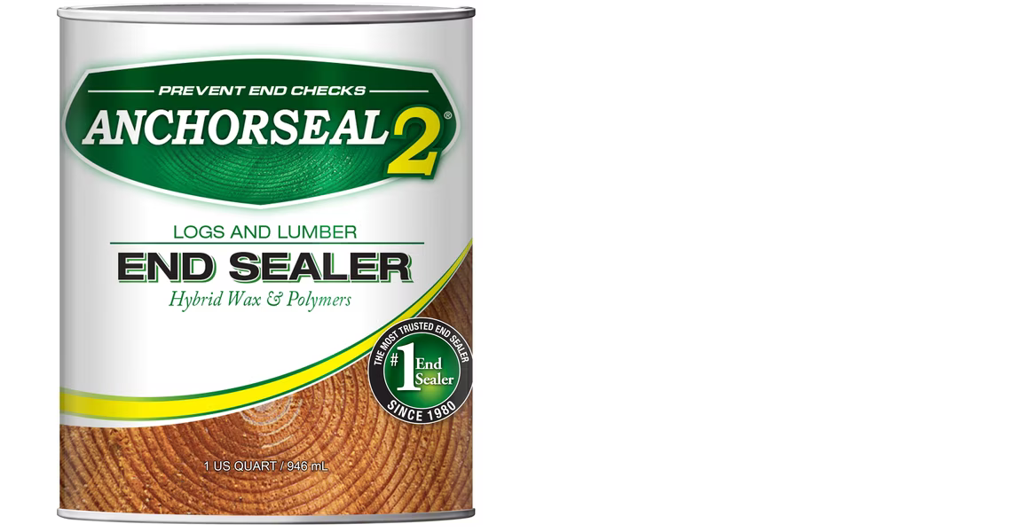

If this is freshly cut wood then with 8/4 it will take up to 2 years to air dry. You can get it kiln dried but air dried wood behaves much better. Cherry is a beautiful wood and machines well but does tend to burn easily as @WillAdams indicated. Also as he indicated over time ti turns a darker brown when exposed to UV light. One reason cherry burns so easily is it is full of pitch and you can find little pockets in the wood.

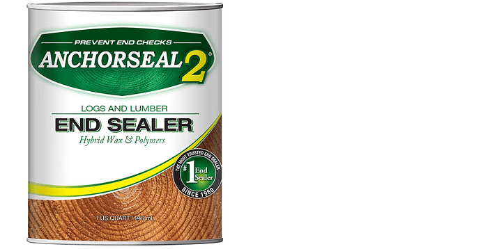

If air drying be sure to sticker the wood and tie it down with strapping to help keep it from warping. There are several sealers available to help the ends from drying too quickly and cracking.
Not as good as the waxed based sealers just some latex paint will work if you dont have anything else. Just paint it on the end grain to help slow down moisture loss and help prevent checking.

It will be stickered and sealed with AnchorSeal.

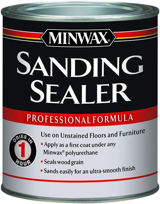

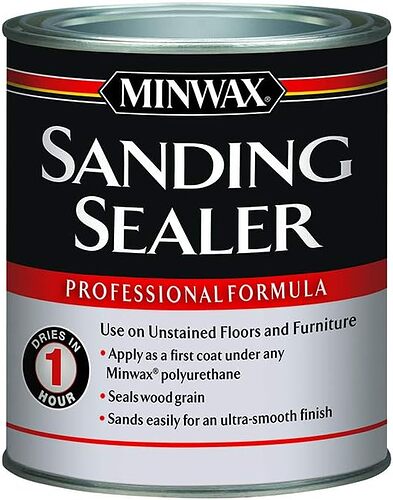

Using a sanding sealer usually need 1-2 less top coats of a film top coat. The sealer helps keep the top coats from soaking into the wood and taking more top coats to get a smooth even surface. Plus the sanding sealer helps harden up the surface during machining and also helps if you apply the sanding sealer on a vcarving you are going to paint to keep the paint from soaking into the wood fibers and giving you a halo effect around the painted letters/images.
There are other sanding sealers and you would need to research their compatibility with top coats. I use lacquer sanding sealer on turning projects and cellouse sanding sealer on some projects that are going to get an oil finish.
The bottom line is the sealers help with several things effecting wood like the hardness and the ability to soak up finish and/or paint.

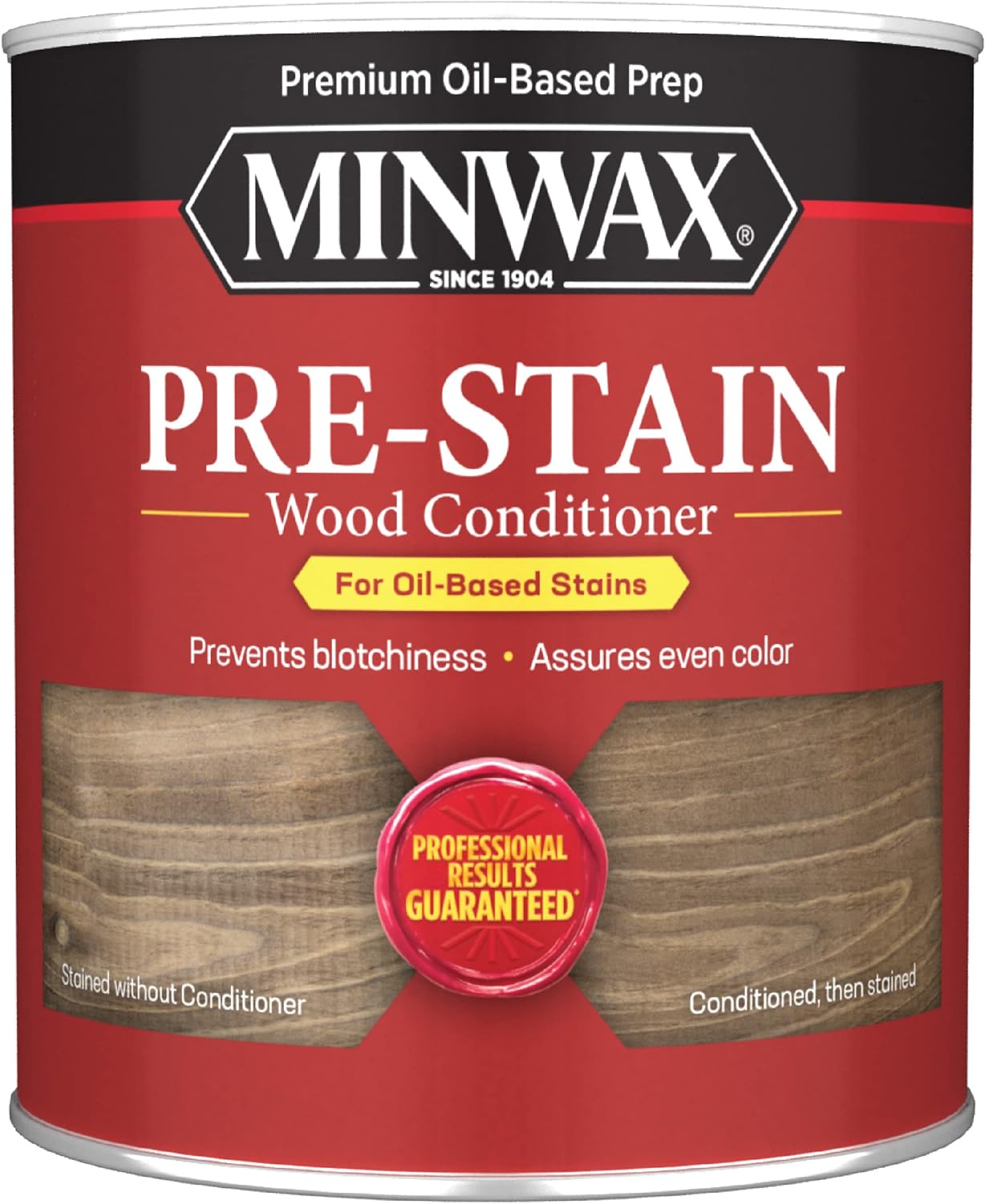

There are some other types of products like the Minwax Pre Stain but that is specifically for oil based top coats but hardens up soft woods so your stain does not blotch but also helps harden up the surface for machining.
