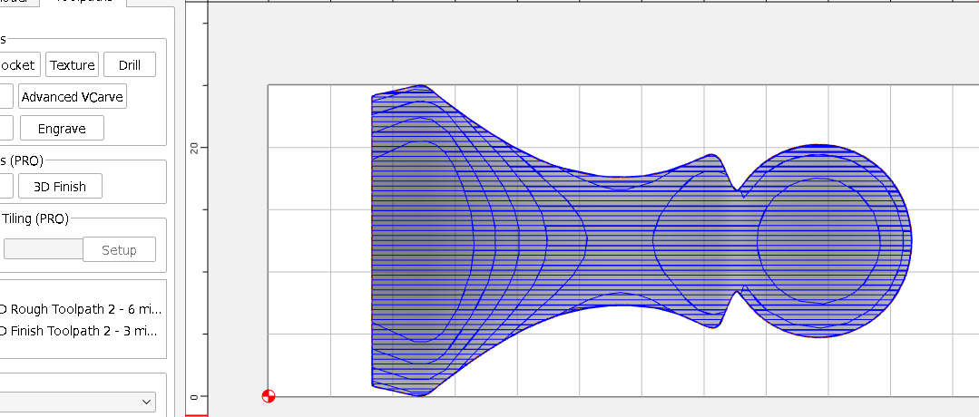

I think the dxf was supposed to limit the area that was worked on so that time wasn’t wasted - without it, CC thinks it’s going to take 595 minutes for the roughing pass. It’s 206 min for the finish pass. That’s just for one side, so after flipping it’s the same again. Seems like a very very long time.

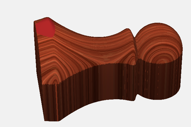

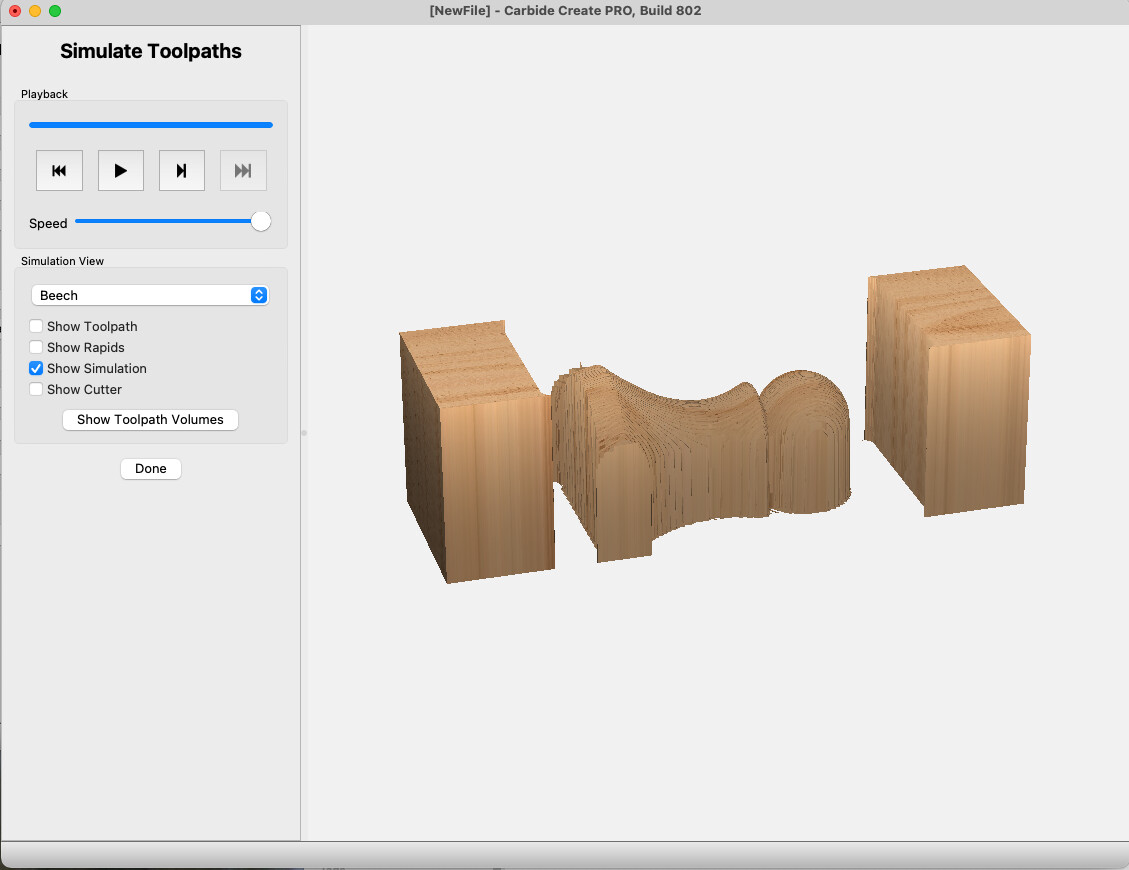

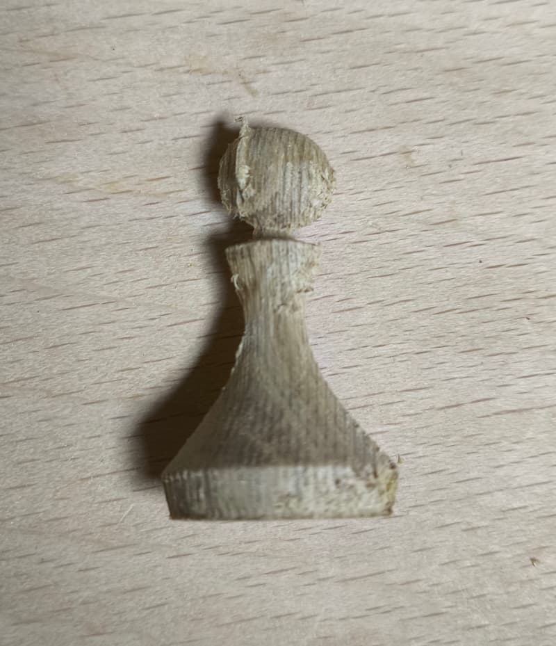

Ok, so I decided to come at the problem from a different angle but I still have issues.

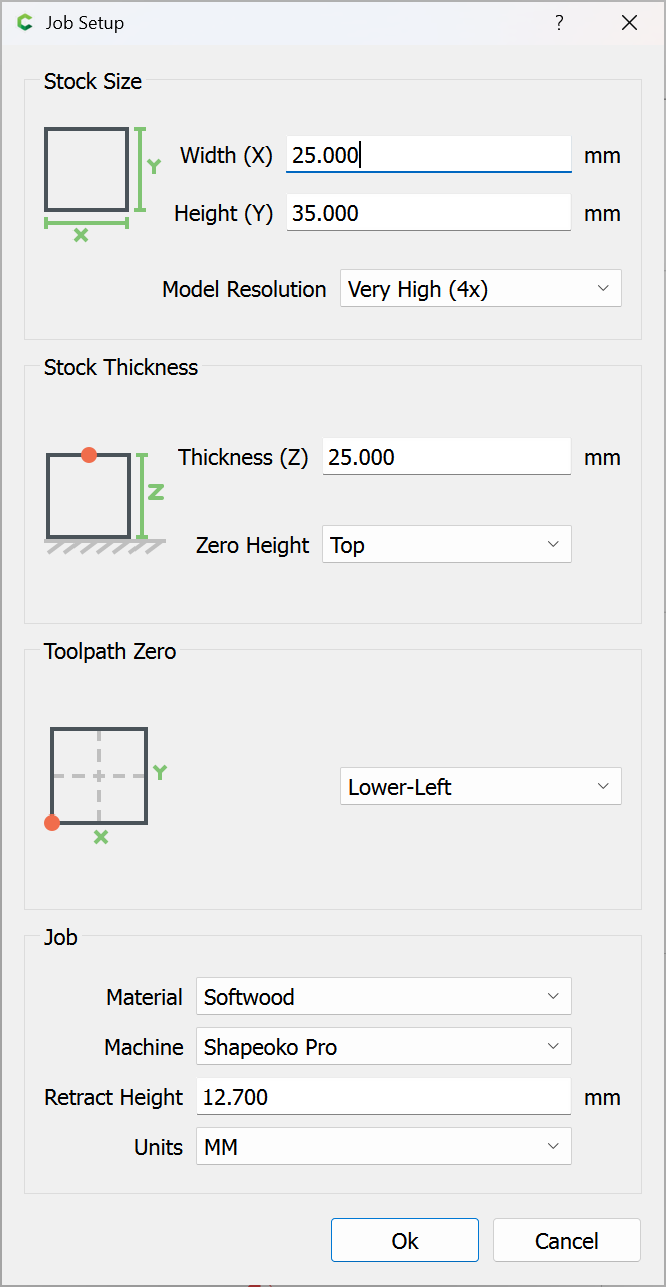

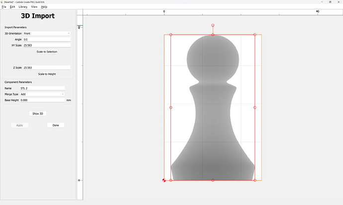

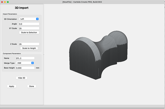

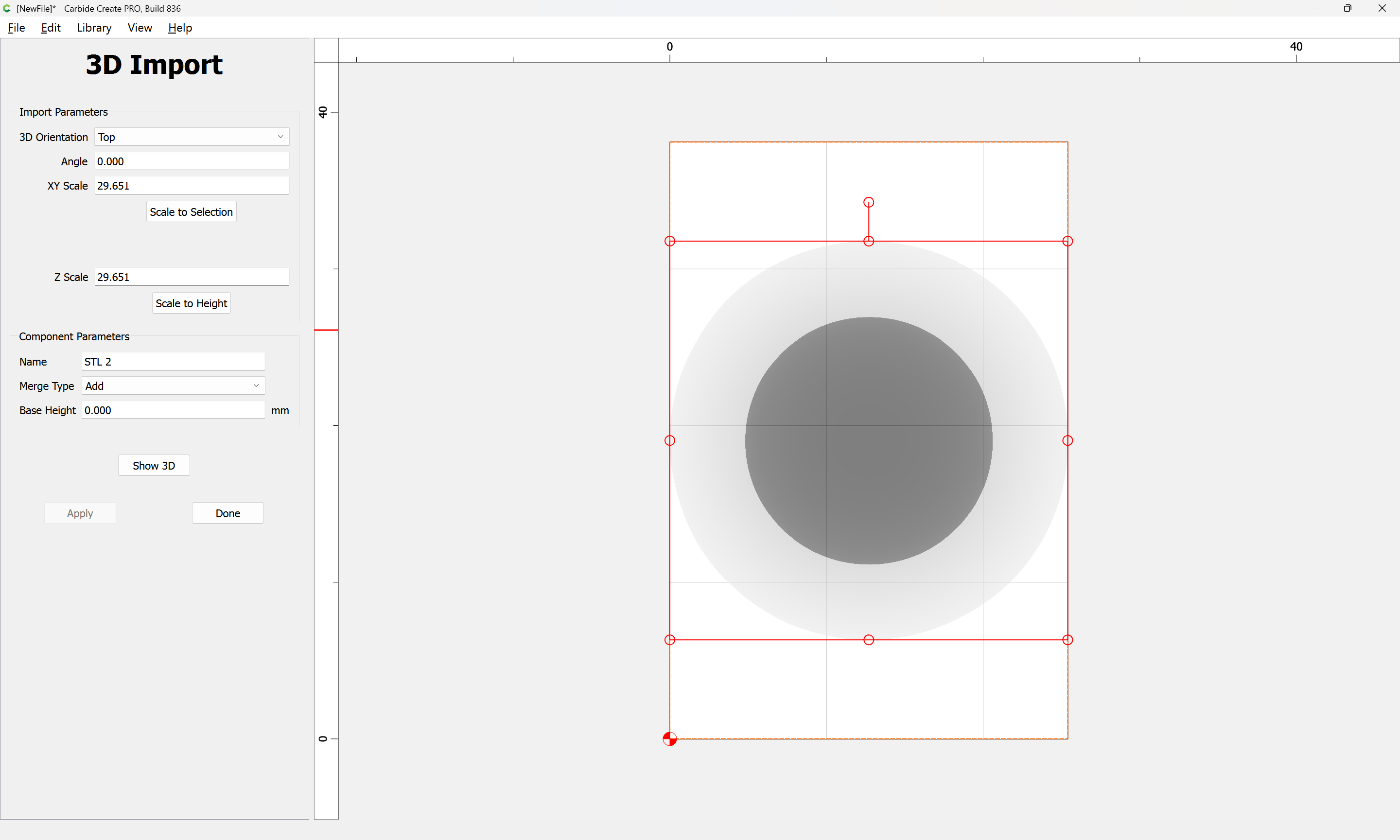

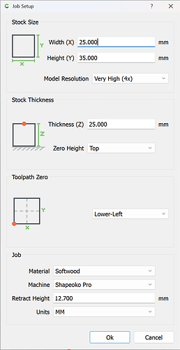

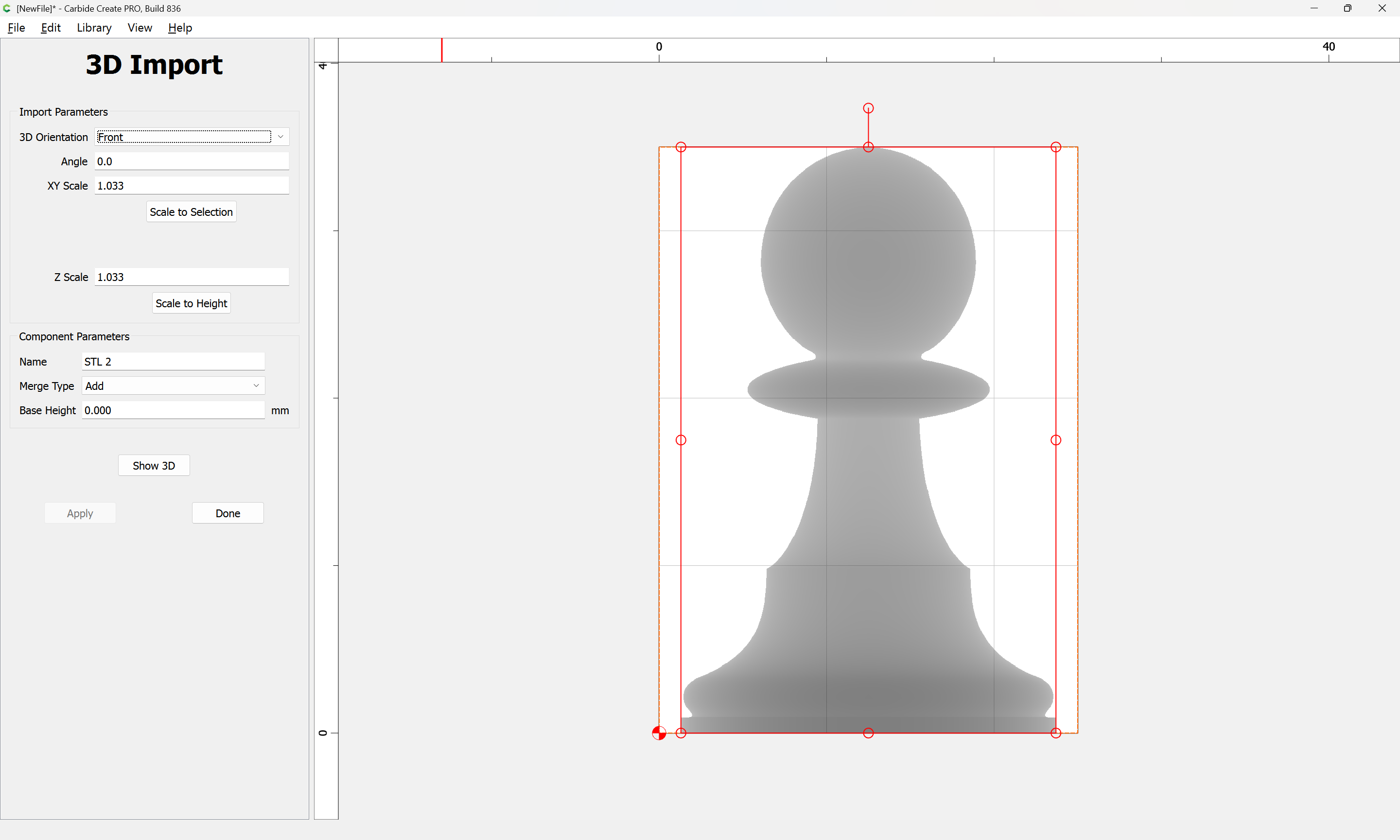

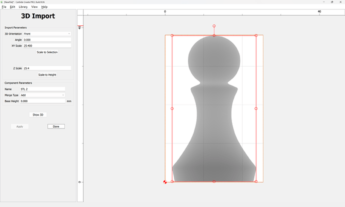

I’ve imported an individual stl. My stock is 25mm x 25mm and the imports settings are:
This seemed to work, flip it over and rerun the process for the other side

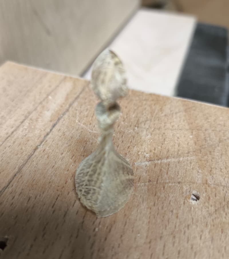

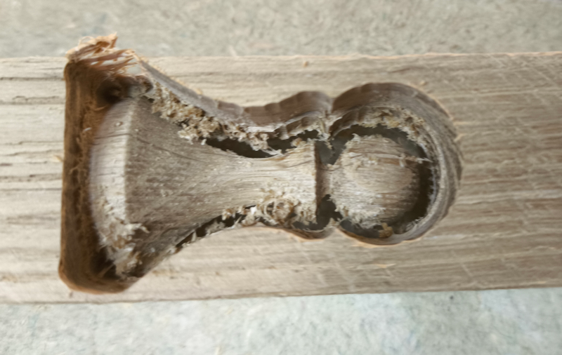

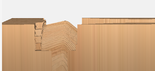

although I felt that the start depth was too much, this played out in the final piece.
What have I missed ot? why has my pawn come out all skinny? Should I be setting the Z scale to 12.5? What are those units, mm?
You gotta think 4th dimensionally when doing double sided 3D carves - the smallest shifts basically get doubled by the flipping. Looks like you need to surface your stock material first to ensure it is at spec thickness before you carve the first side. Then the flip-side toolpath needs to have a stock thickness to match with the STL correctly located within. Unless your stock is perfectly symmetrical with the depth of the STL perfectly centered within it, just flipping it & using the same toolpath won’t work properly.
My stock is the correct size, 25mm x 25 mm, the object is scaled to that.

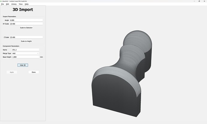

Why is is starting so deep? How do I reduce the depth it starts at using the import parameters?
Looking at the produced item, the start depth is the problem, becuse the width (skinny side) is 15mm, 6mm out from what it should be in final form (21mm), 3mm on each side which is about how far it mills into the surface before it starts cutting the shape. Are you saying my 25mm sqare stock needs to start off at 31mm and if so, why? Why is the starting depth +3mm ?

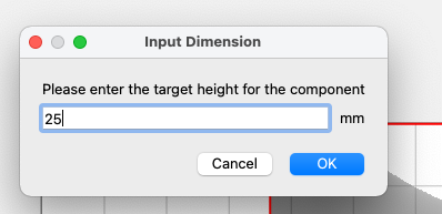

If you click, “Scale to Height”, what is the height? It should be 25mm, and whatever that converts the Z Scale to, the XY scale should probably be the same.
The “25” you’re seeing in the Scale fields is 25x (the original size).
It pre-fills with 25mm
Z and XY are just off 30

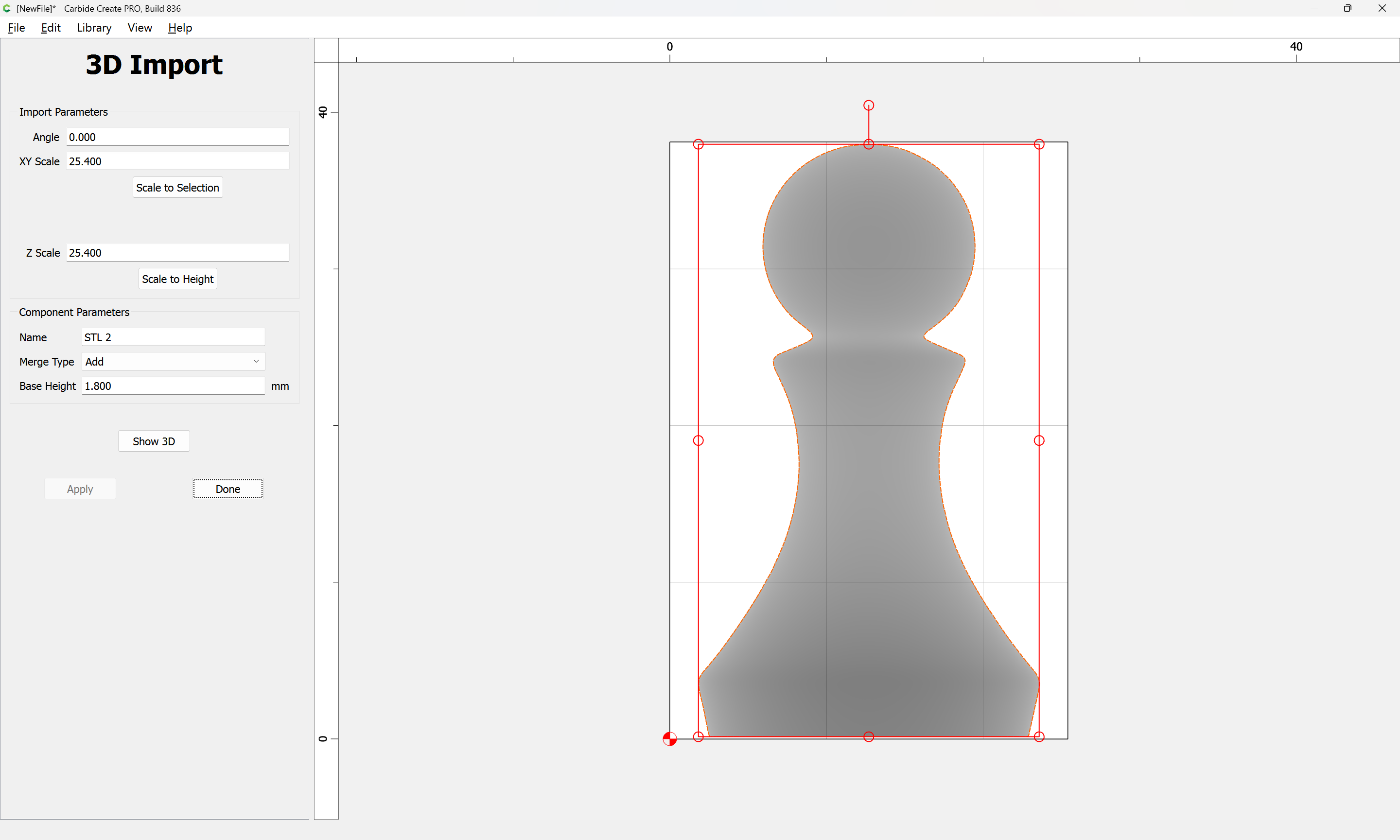

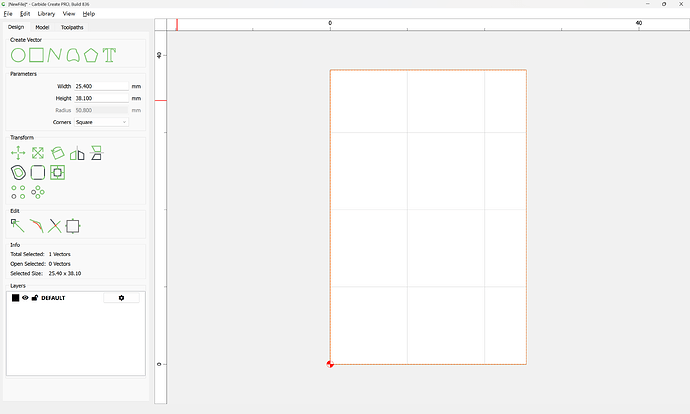

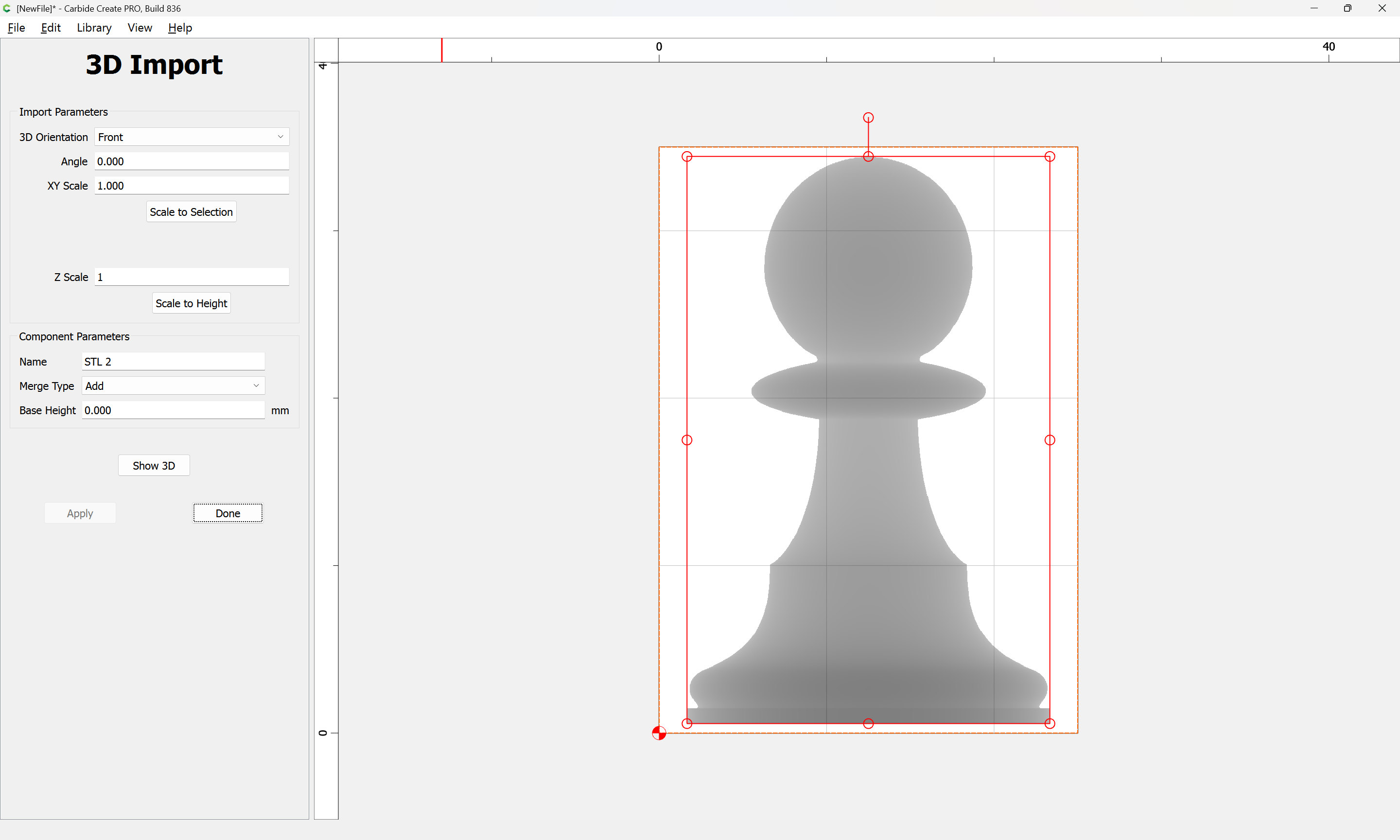

Given a file:
If one wishes to import it at those dimensions, then create a suitable file:
Draw some geometry to define the center of the imported file:
then one sets the options for the import:

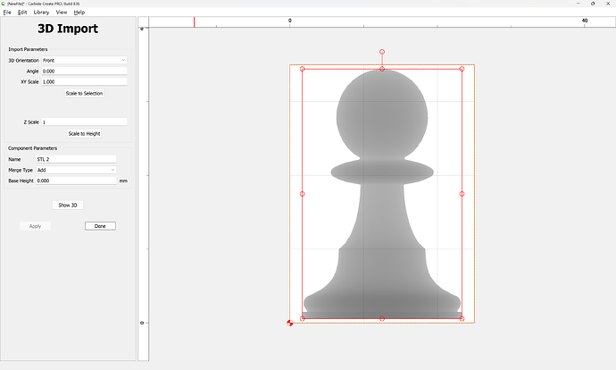

If one sets the XY and Z scaling values to 1:
Then the object will be imported at the original dimensions:
However, note that the Z-extent falls short, so in order to get things to line up it will be necessary to add to the Base Height:

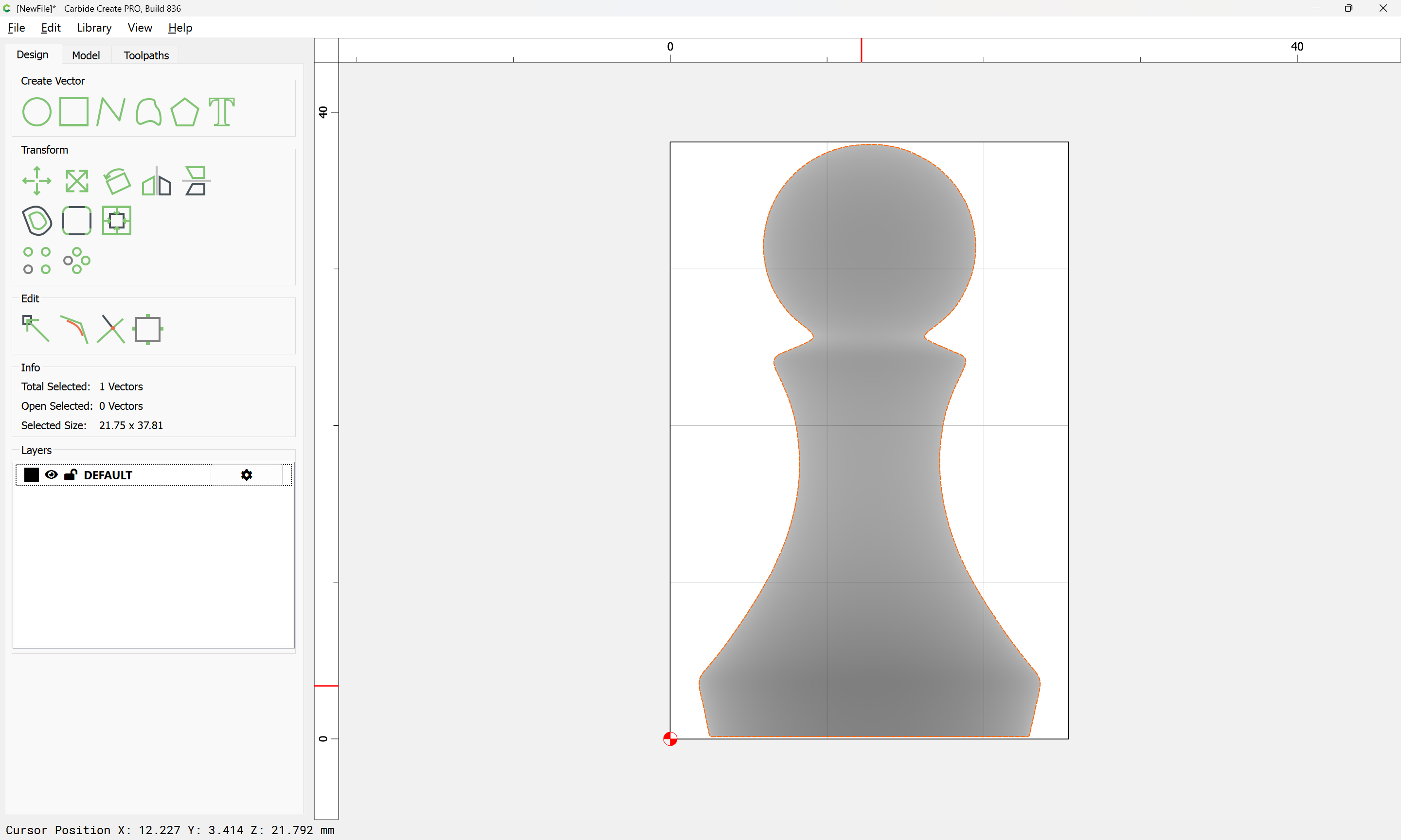

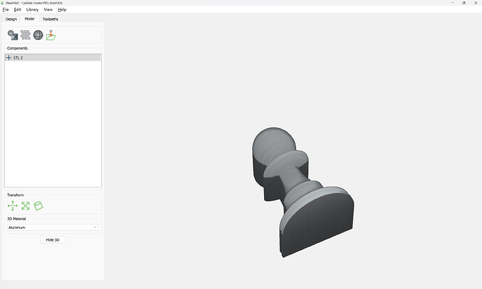

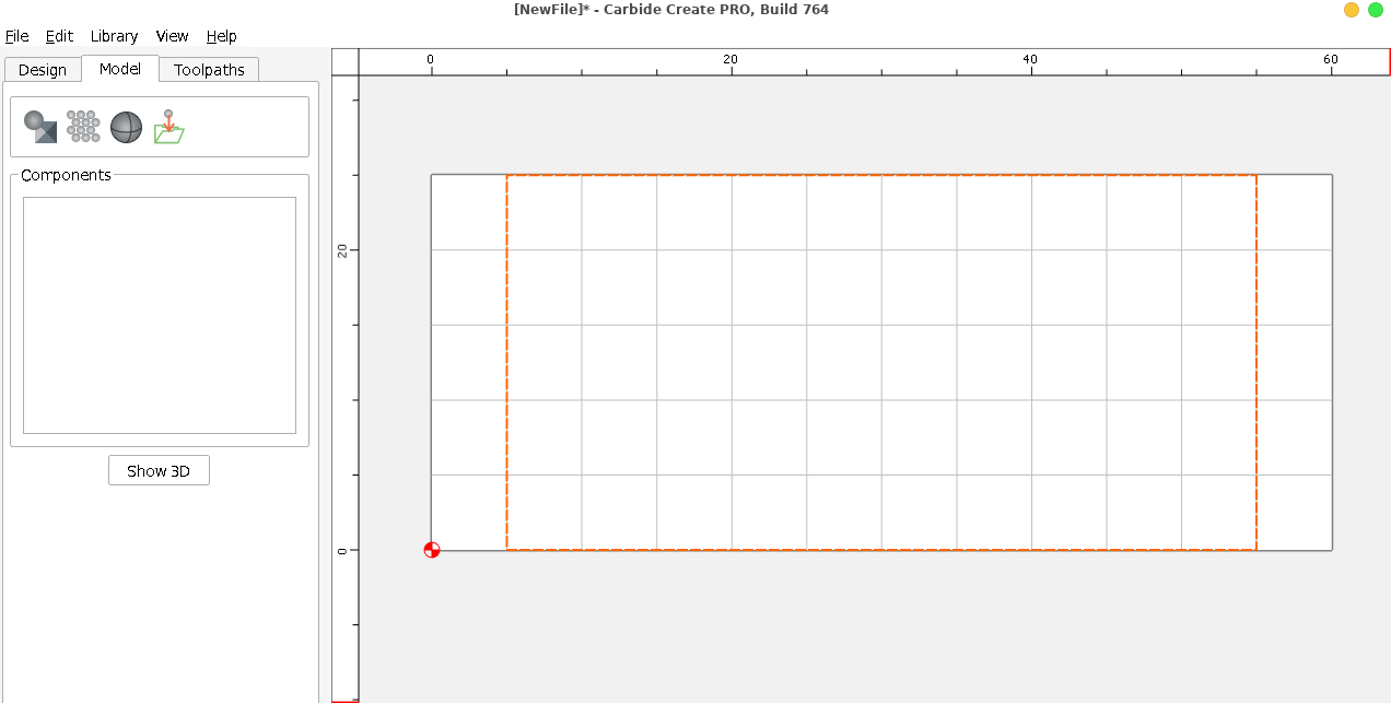

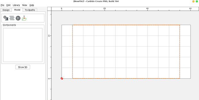

I initially set up a bounding box for the the import
then once I’d imported the stl and rotated it,

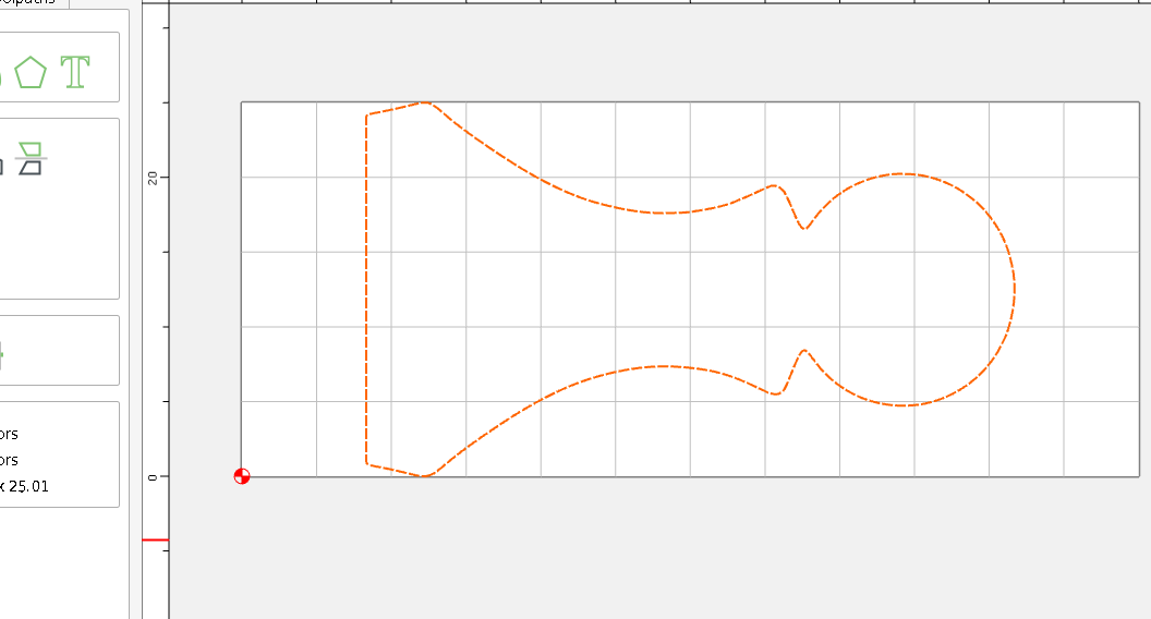

I removed the stl,
and bounding box

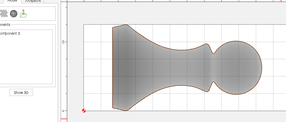

leaving the outline of the pawn. Reimported the stl ‘into’ the pawn shape,
and added my roughing pass, and finishing pass to that outline…
Looking at the simulation the base of the pawn is much closer to the surface

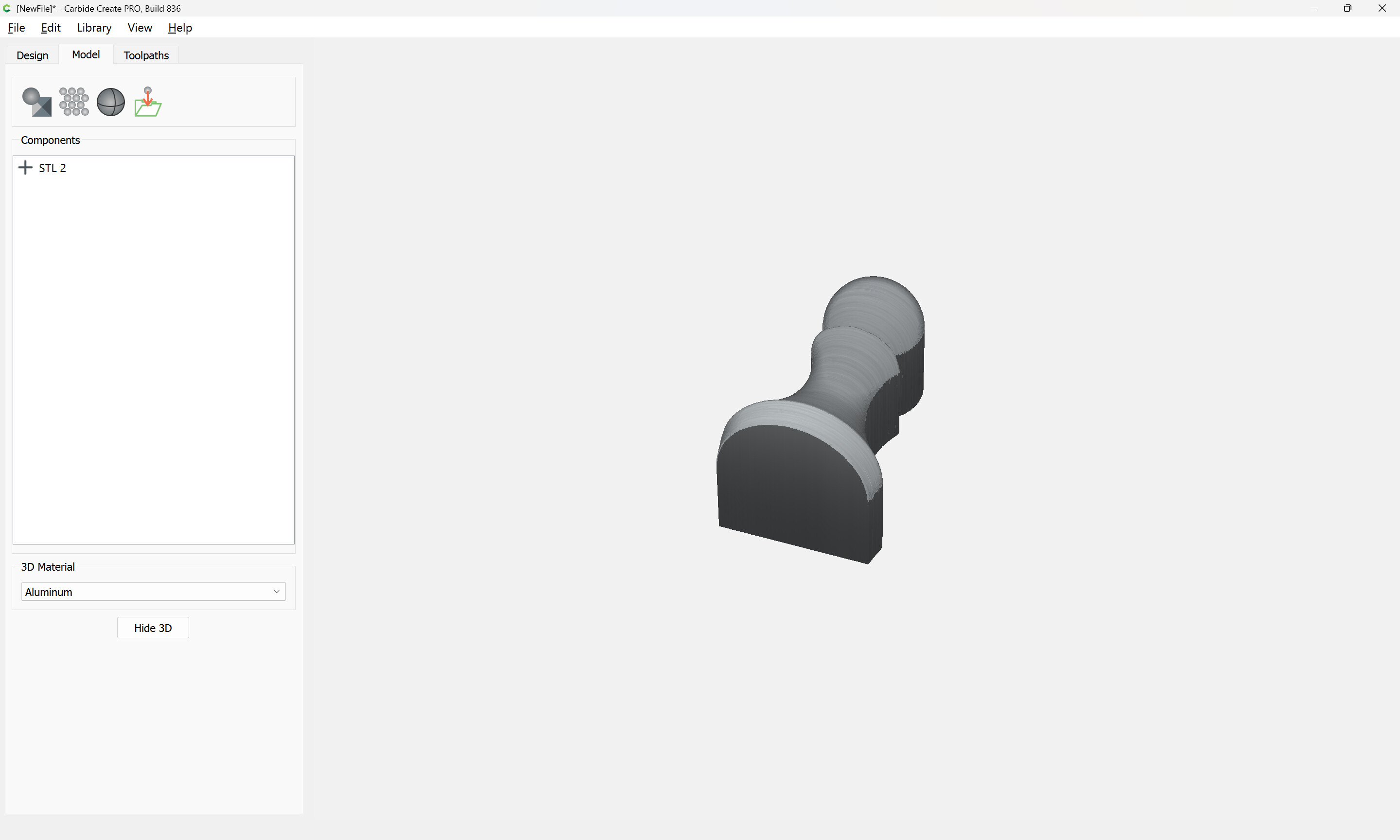

The big step you need to do is to take note of the vertical position of the piece, then add to the Base Height so as to get it centered in the stock along Z.
If I add even 1mm to the base height I start getting red on the 3D model, which I presume means it’s not going to cut that part because it’s out of bounds. Can the base height be negative?

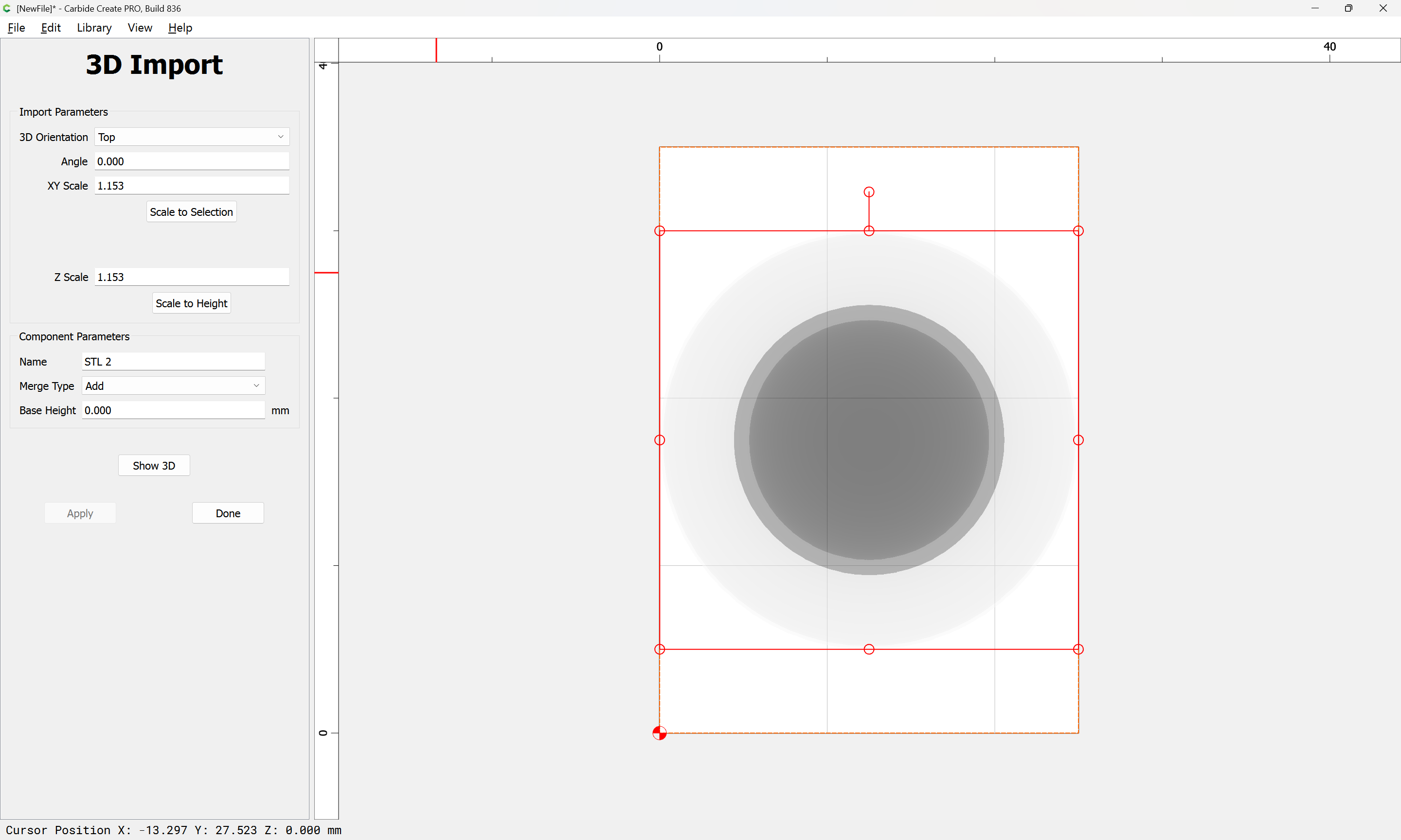

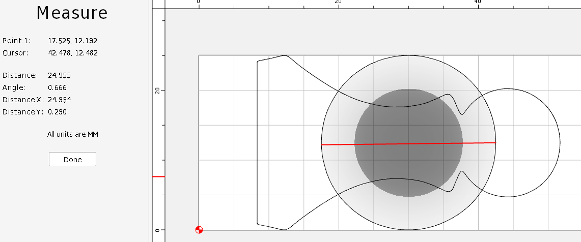

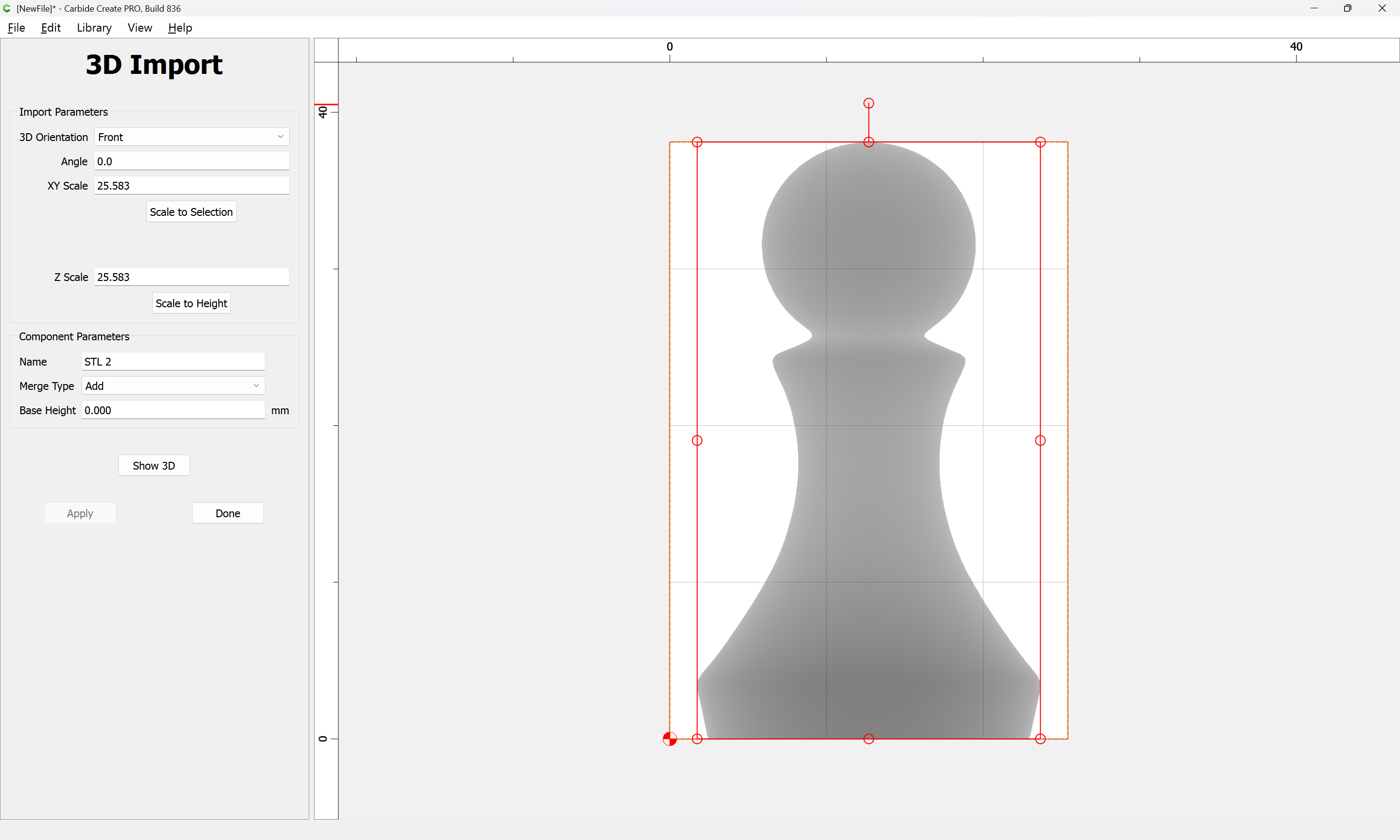

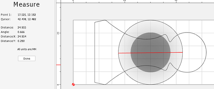

If I import the stl (top view) and measure across it’s 24.954mm
I feel like I must be misunderstanding a crucial part.

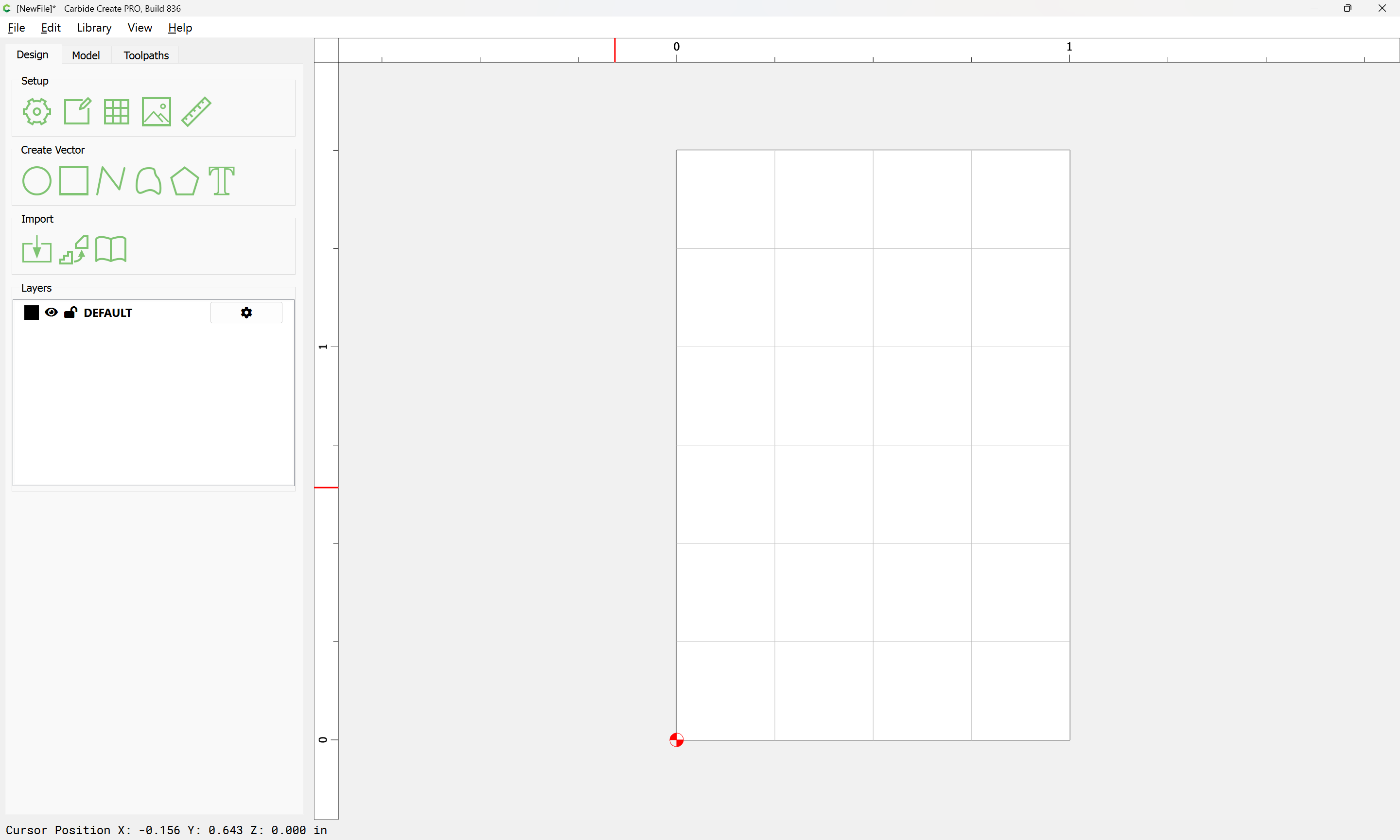

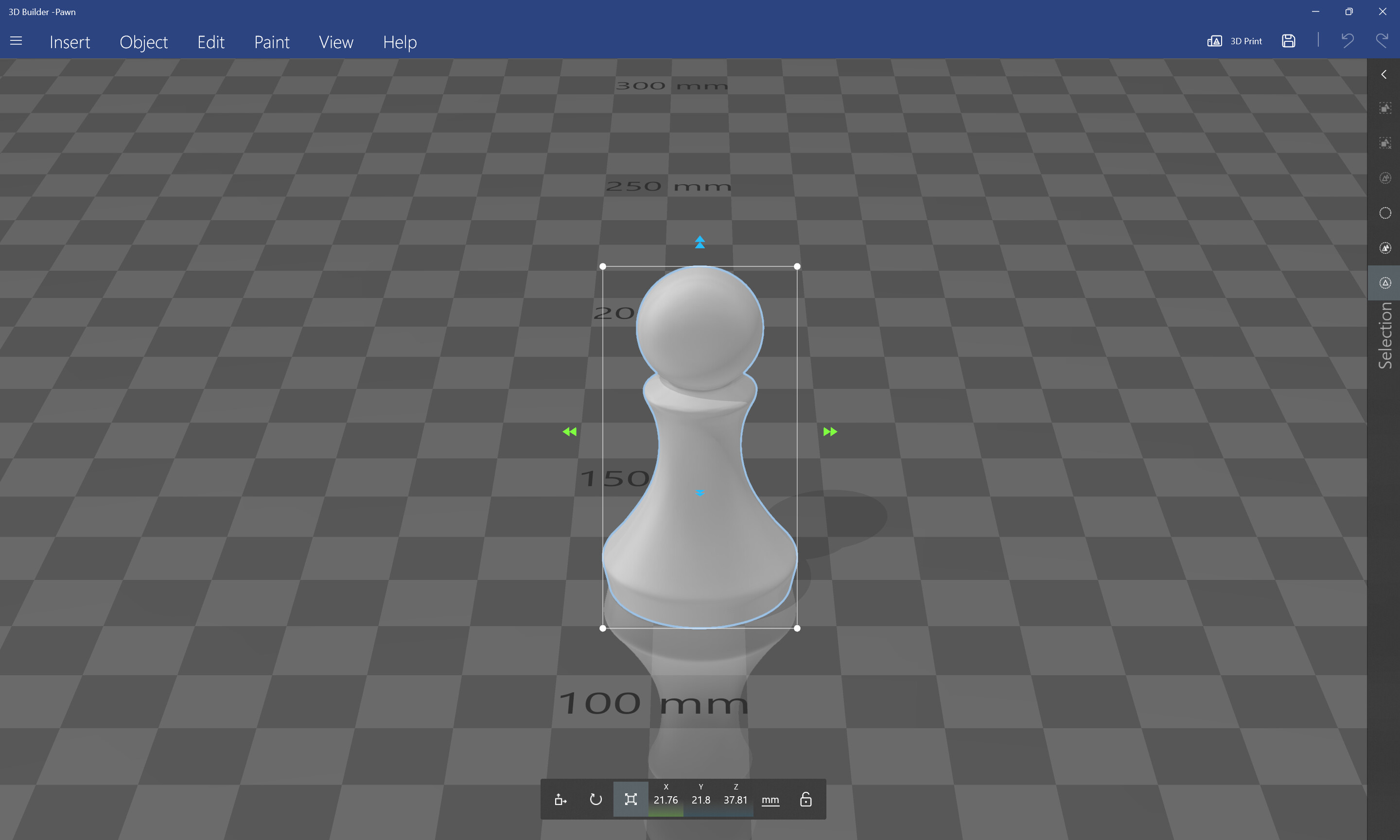

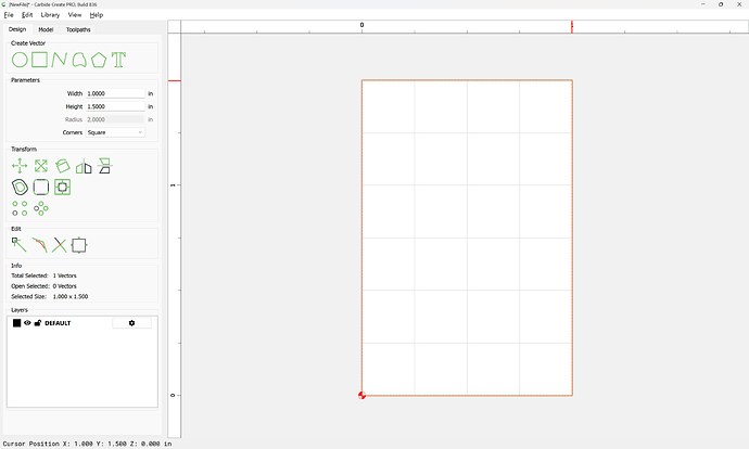

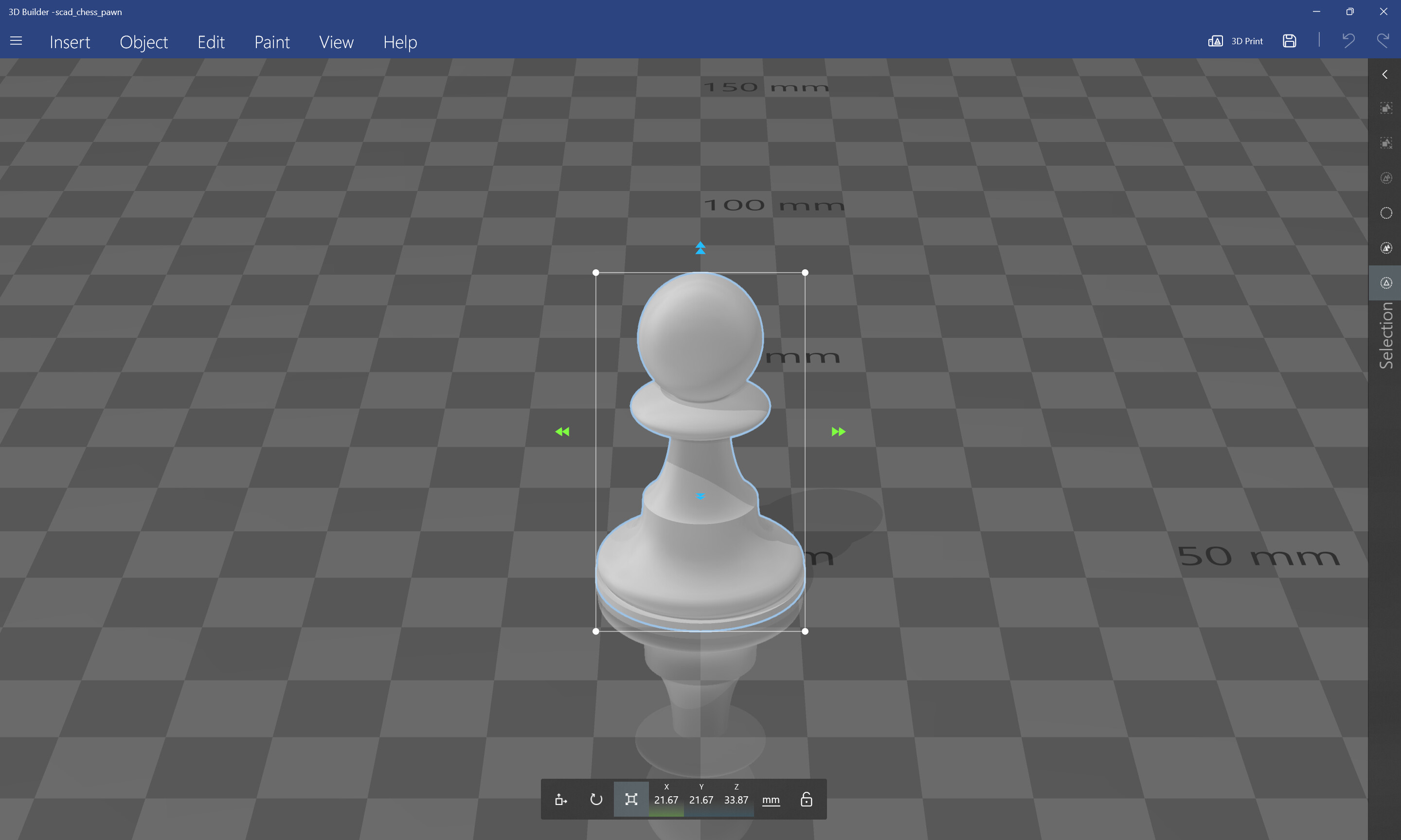

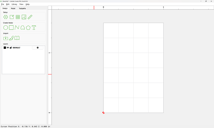

Importing this file we get dimensions of:

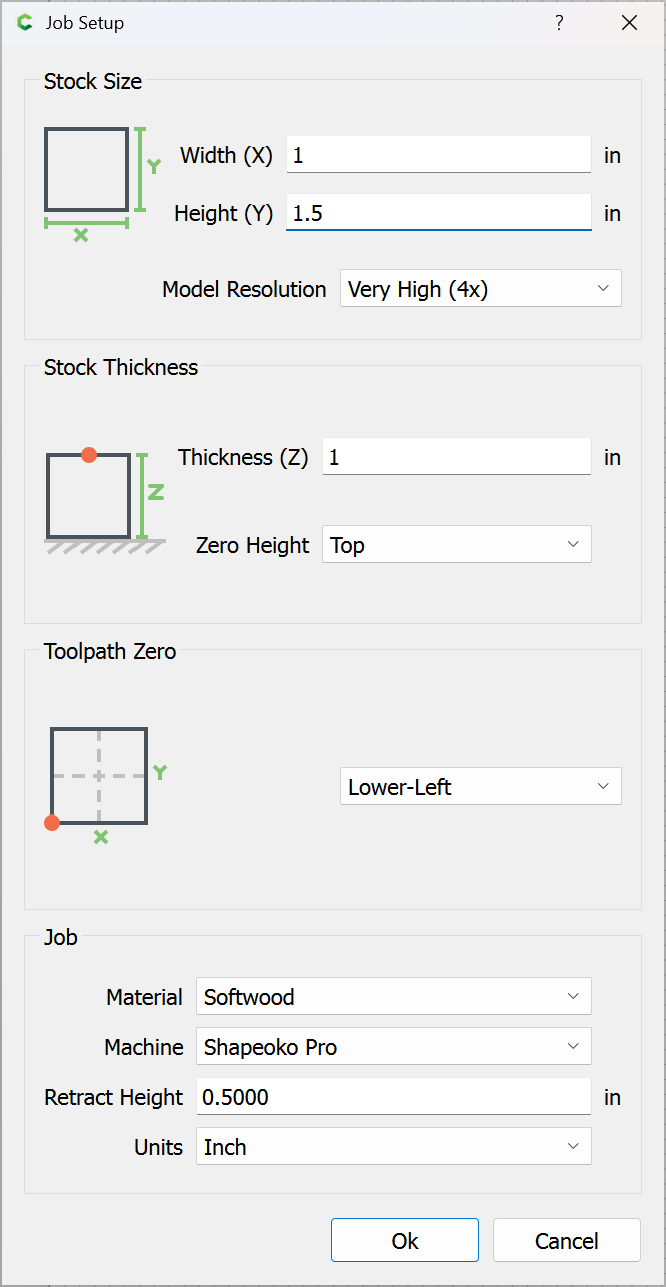

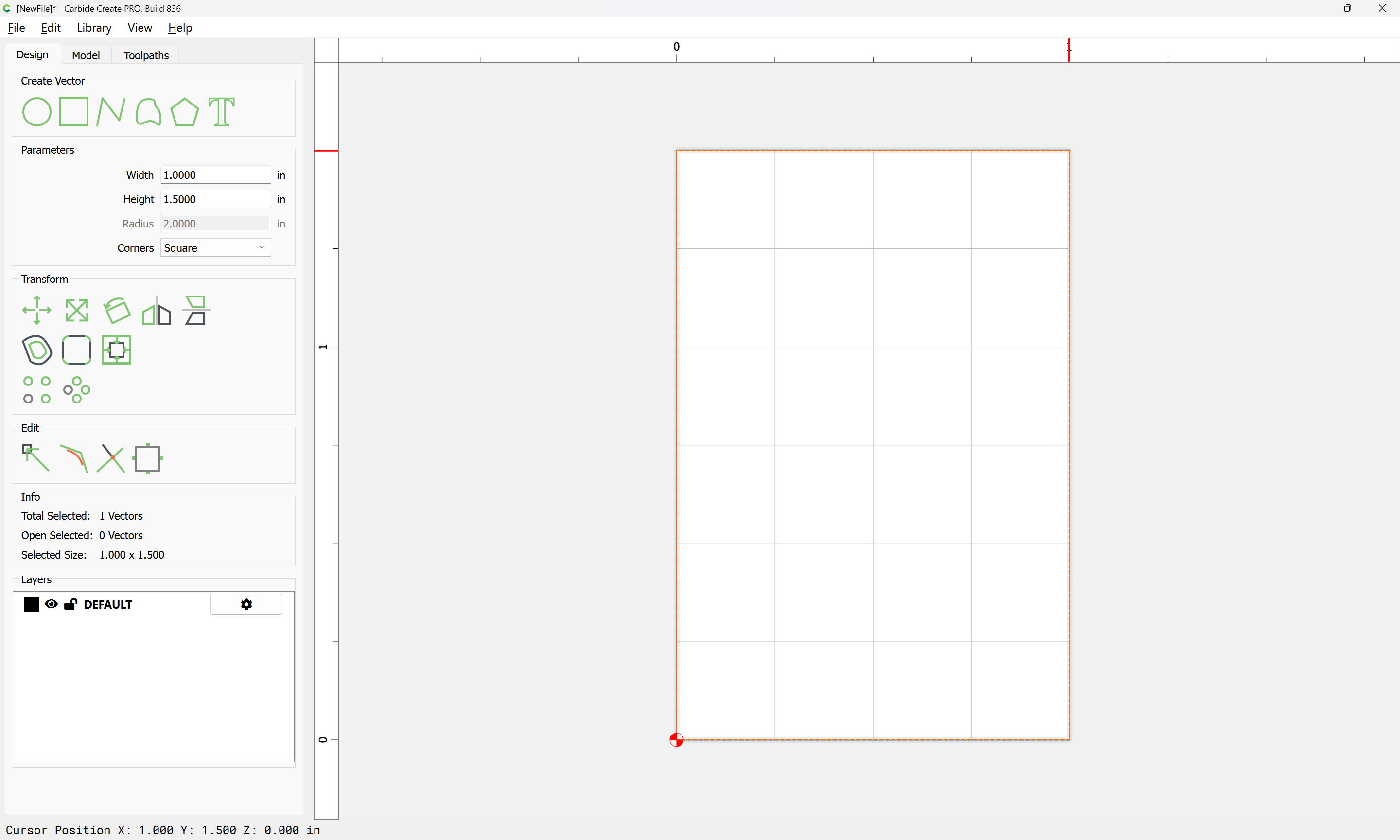

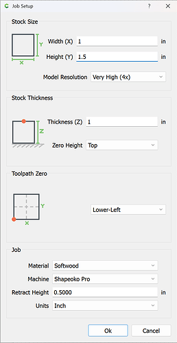

Assuming we want to use 1" thick stock, we set that up in Carbide Create:
t

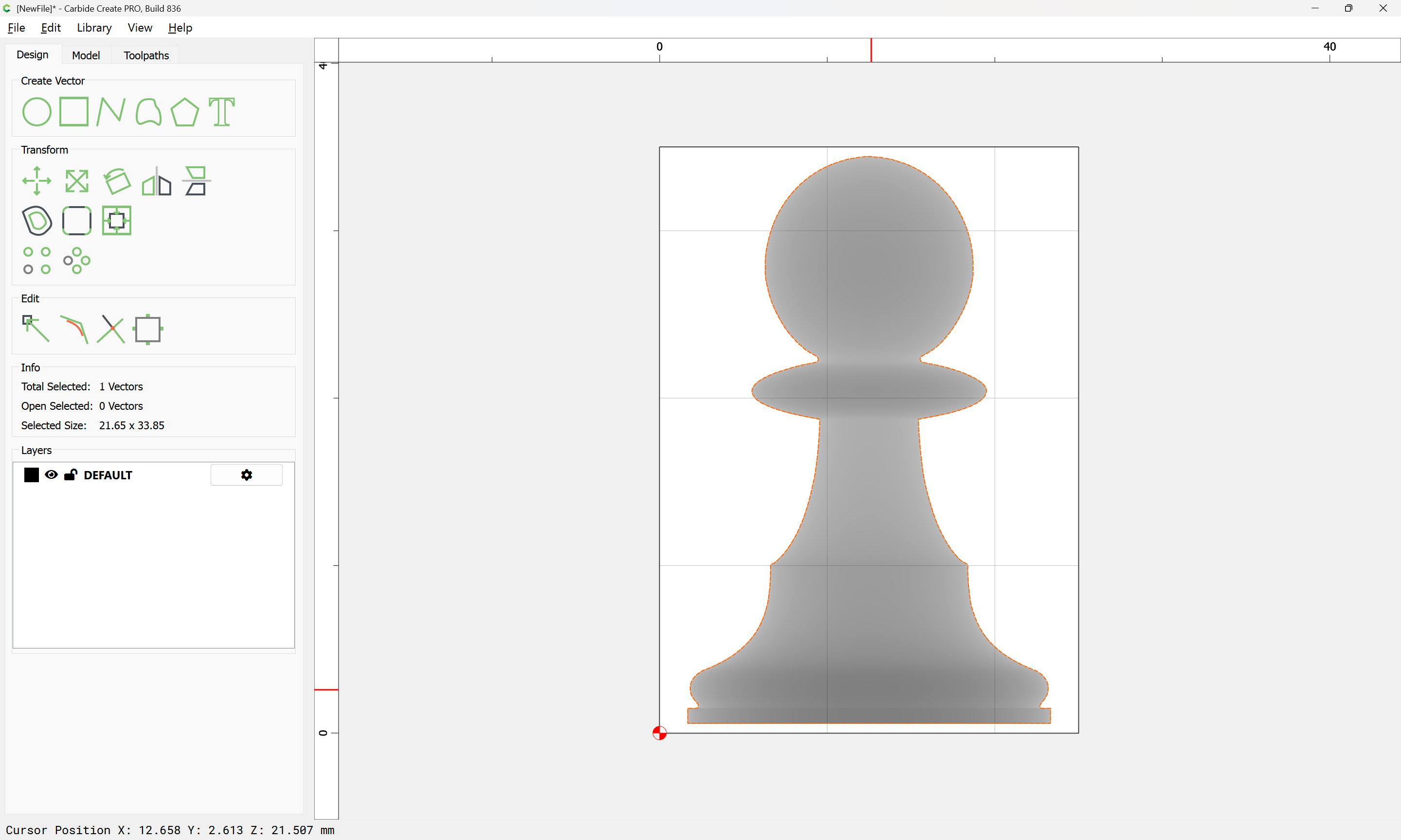

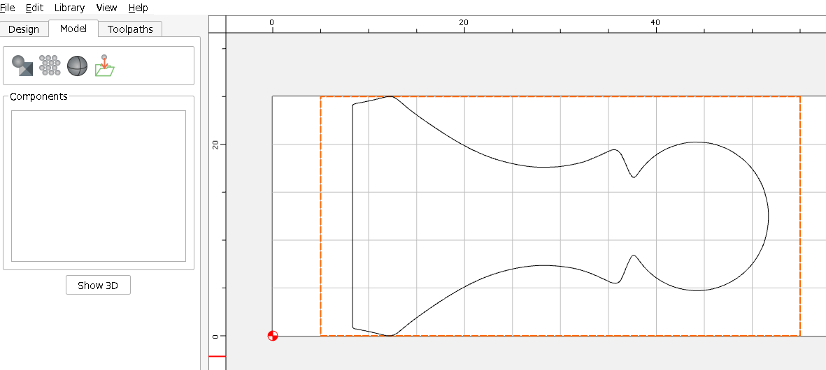

We then draw geometry to import the part:
and toggle over to metric, since that’s what the 3D Builder app shows:

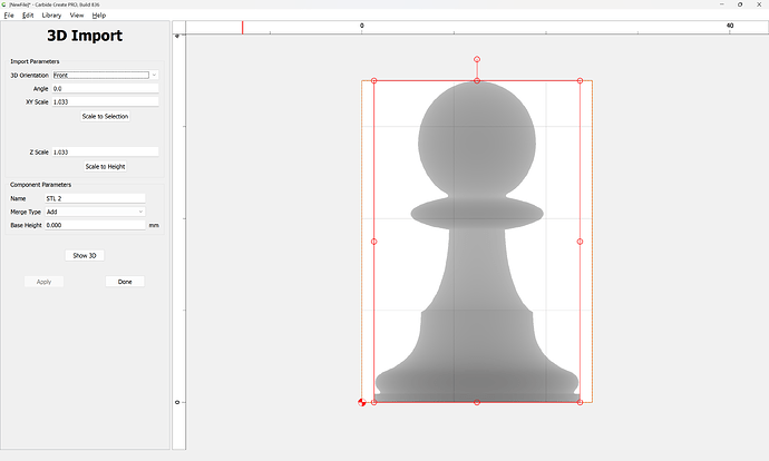

Importing the part:
it is again necessary to choose a face:

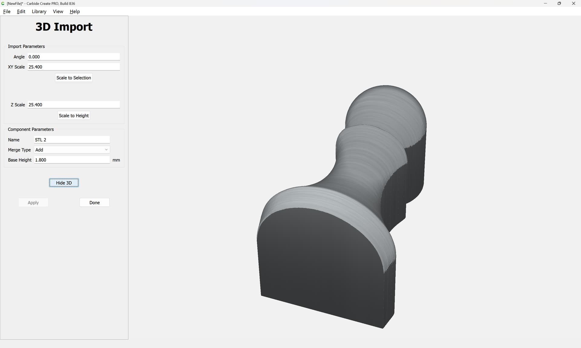

Interestingly, the scaling does not match up — at a guess, the unit is set to 1inch, so we try 25.4:

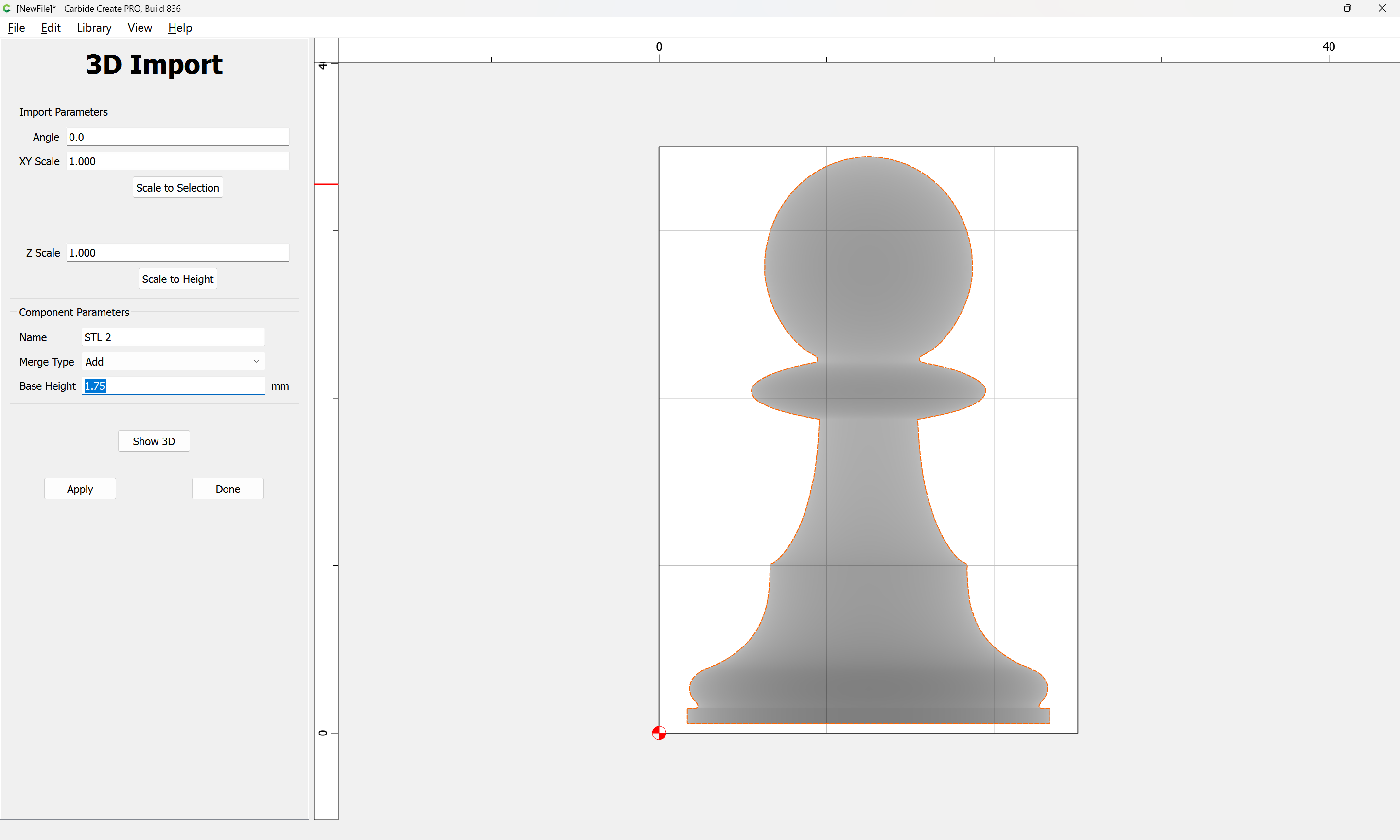

Done | Show 3D:

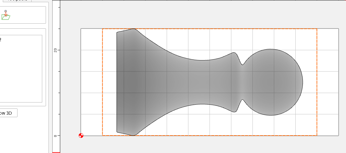

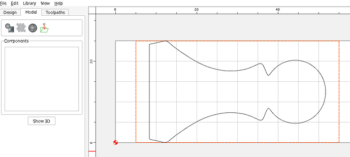

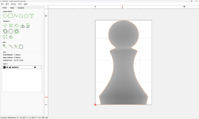

Trace the outline and switch to 2D view:
where we see that it is quite close to the expected 21.8mm height (check the Status bar which shows “Cursor Position” at the bottom — it also shows the Z-axis height of the 3D model at the cursor position)

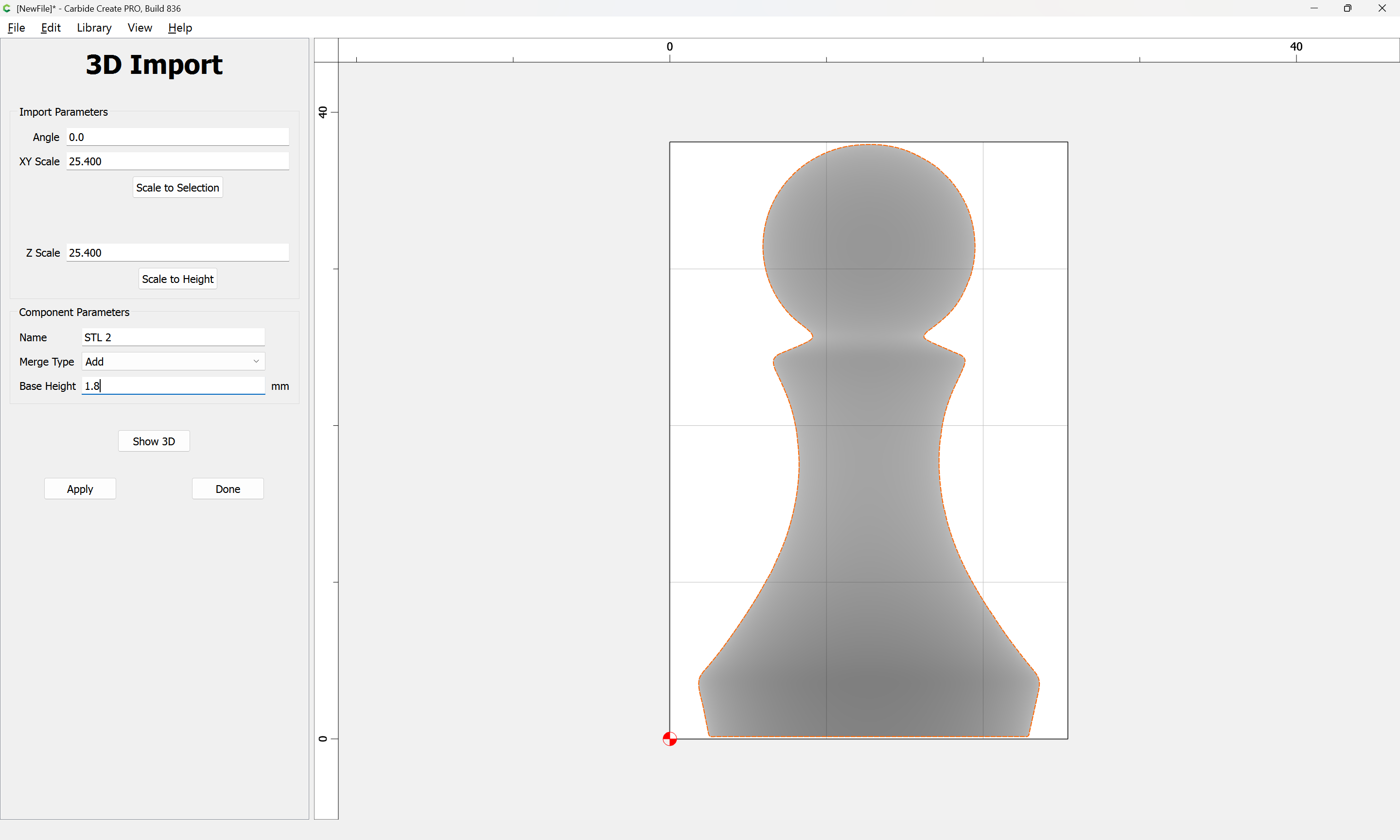

We want the center to be at 12.7, so using half this thickness, (10.9) we need to add:
12.7 - 10.9 == 1.8
so we add that to the Base Height:
Apply
Show 3D
It should now work to cut both sides using this 3D model, and so long as the flip is accurate and the stock thickness/Z-axis height setting match up, the result should be as expected.
