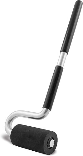

I use some cheap adhesive shelf paper I get at Walmart. It is Easy Liner Adhesive shelf paper or sometimes I use Oramask. This helps eliminate chip out because the wood fibers are more supported. With any masking you need to use a J roller to make sure it is adhered well to the surface. Just applying it and using your hand is not enough.
