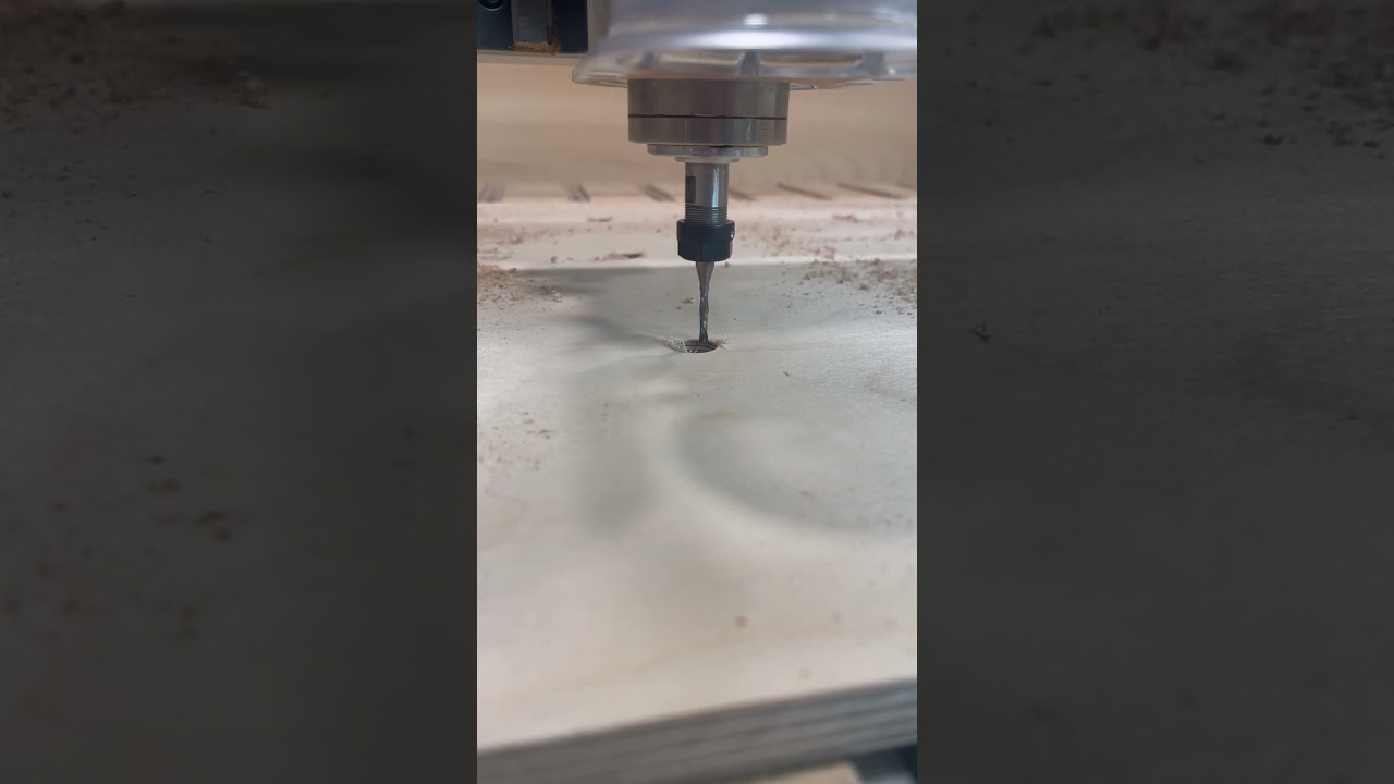

It’s been a minute since I last powered on my Shapeoko Pro, and was excited to see some new versions of Carbide Create and Carbide Motion, so I updated everything today. Might have been a mistake.
Now, when I cut, the path is awfully choppy. Almost as if there’s a quarter of a second of movement delay between every direction change. It’s never done this before.
For instance, I’m cutting some small round counterbores (5/8" wide pocket, 1/4" deep in soft plywood… with a 1/8" compression bit. The cutting path sounds like "chunk chunk chunk chunk chunk chunk… "
Here is a link to a video that shows the cutting:
It does end up cutting a round hole, in the end but it’s never done that stuttering before… paths were always smooth.
I’ve checked over everything mechanical, found nothing. Checked belt tensions, obstructions… happy with everything. I’ve gone through the new reinitialization steps multiple times, and over all the settings in CC and CM, restarted machine, computer, vfd… path is consistently choppy.
Have also noticed that the z axis will now sometimes not stop spinning and retract when the program is paused. Sometimes it does, sometimes it doesn’t.
Using CM 635 and CC 764. Shapeoko Pro with HDZ and VFD.
Appears to be related to the new software - but can’t tell if the problem lies with CM or CC.
Any ideas?

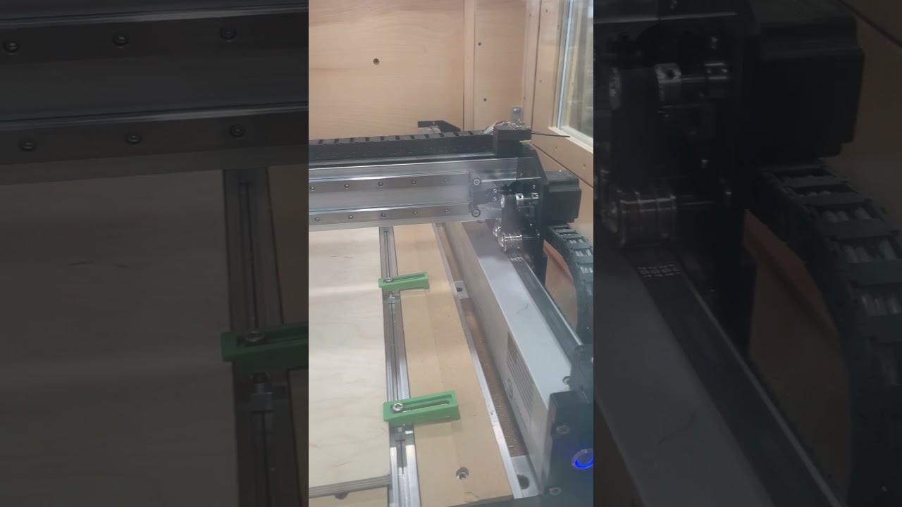

Here’s another video that really emphasizes the path issue - same path, but turned off spindle so no cutting, just isolating the stepper jerks.
This is just a small circle pocket and the cutting head should be moving continuously and smoothly.
