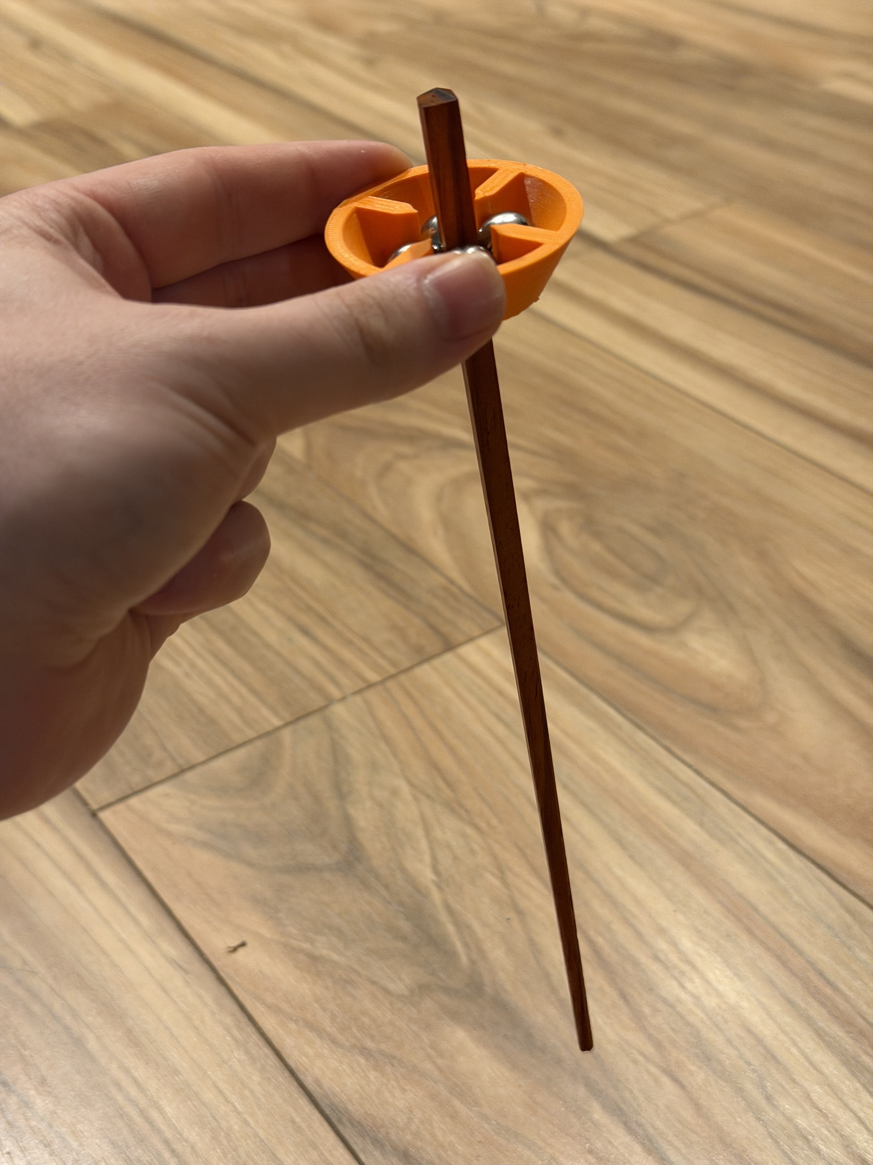

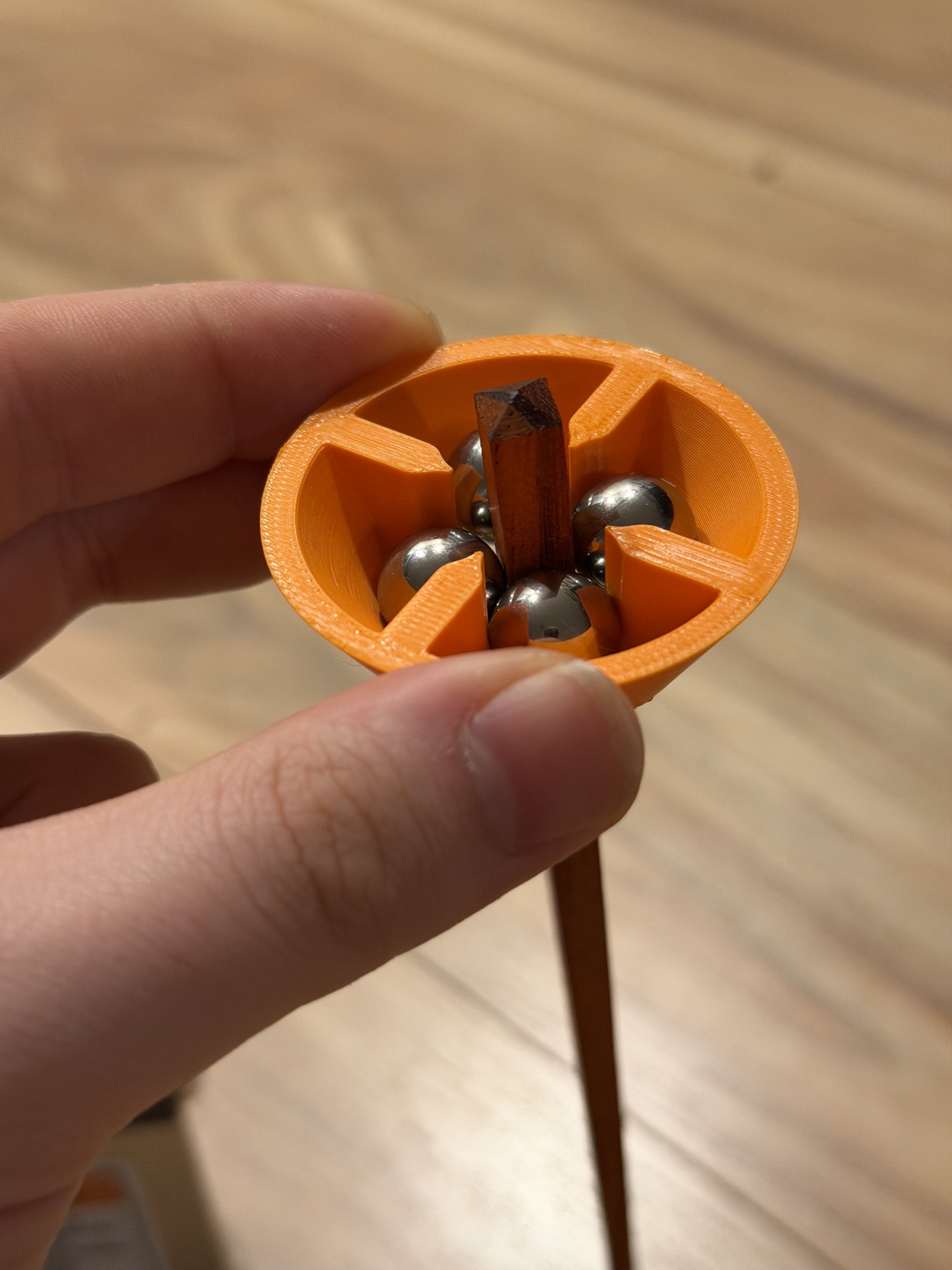

Last night I tried a small bowl with a hole in the bottom and ball bearings.
The idea being the ball bearings would provide a bit of weight and pinch the chopstick to keep it held upright. The interaction being similar to those “ploosh” knife blocks where you just shove the knife in anywhere.
In theory this would be very easy to insert/remove from the bottom or the top and I could just 3d print a bed of them.
I 3d printed a little test for 1 stick and…my dumb design had the curve of the bowl tangent to the ball bearings at the point of contact with the chopstick
This meant the chopstick was literally just pushing the small balls out of the way, turns out ball bearings roll pretty well. Who knew :upside_down_face:

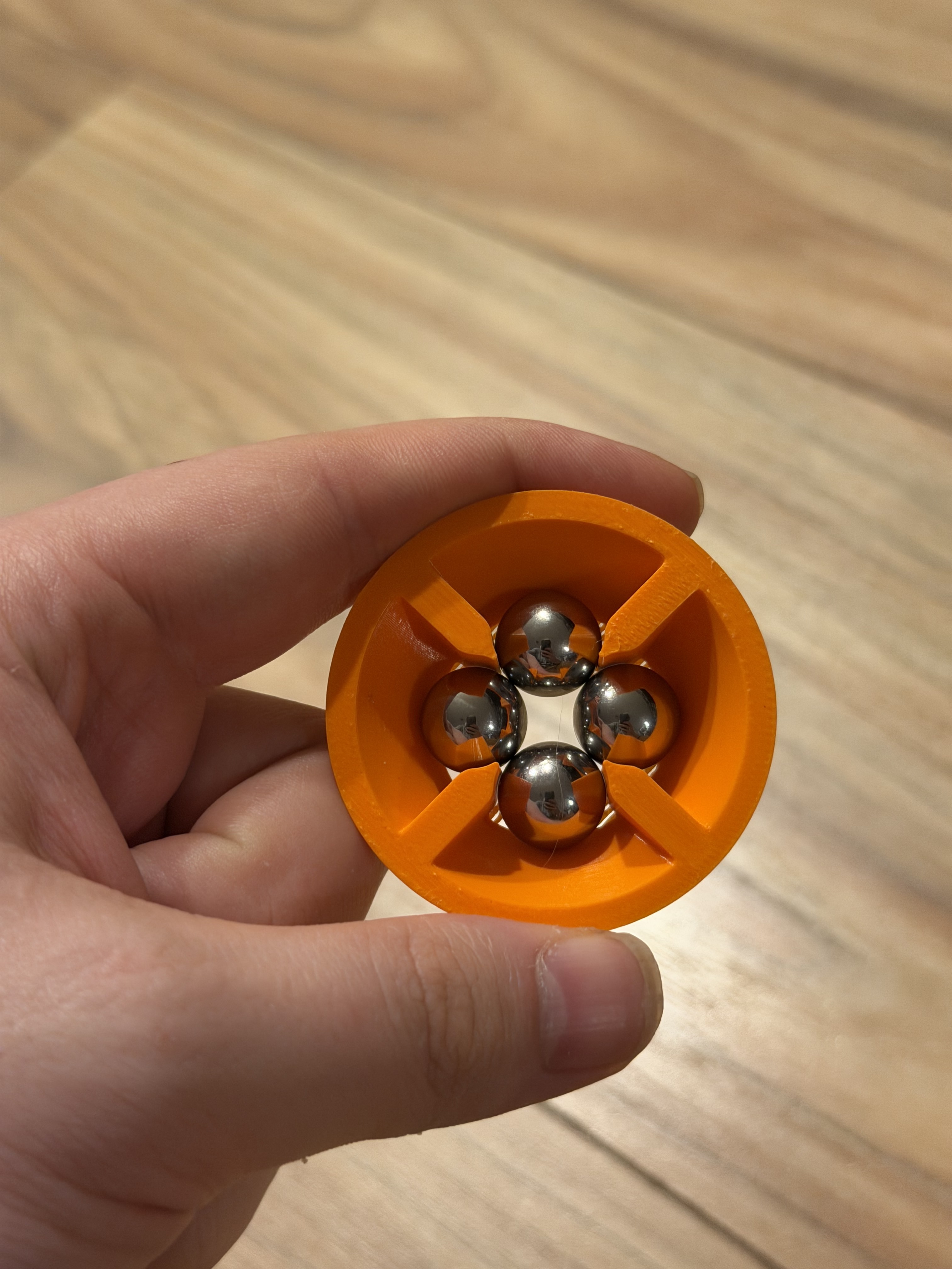

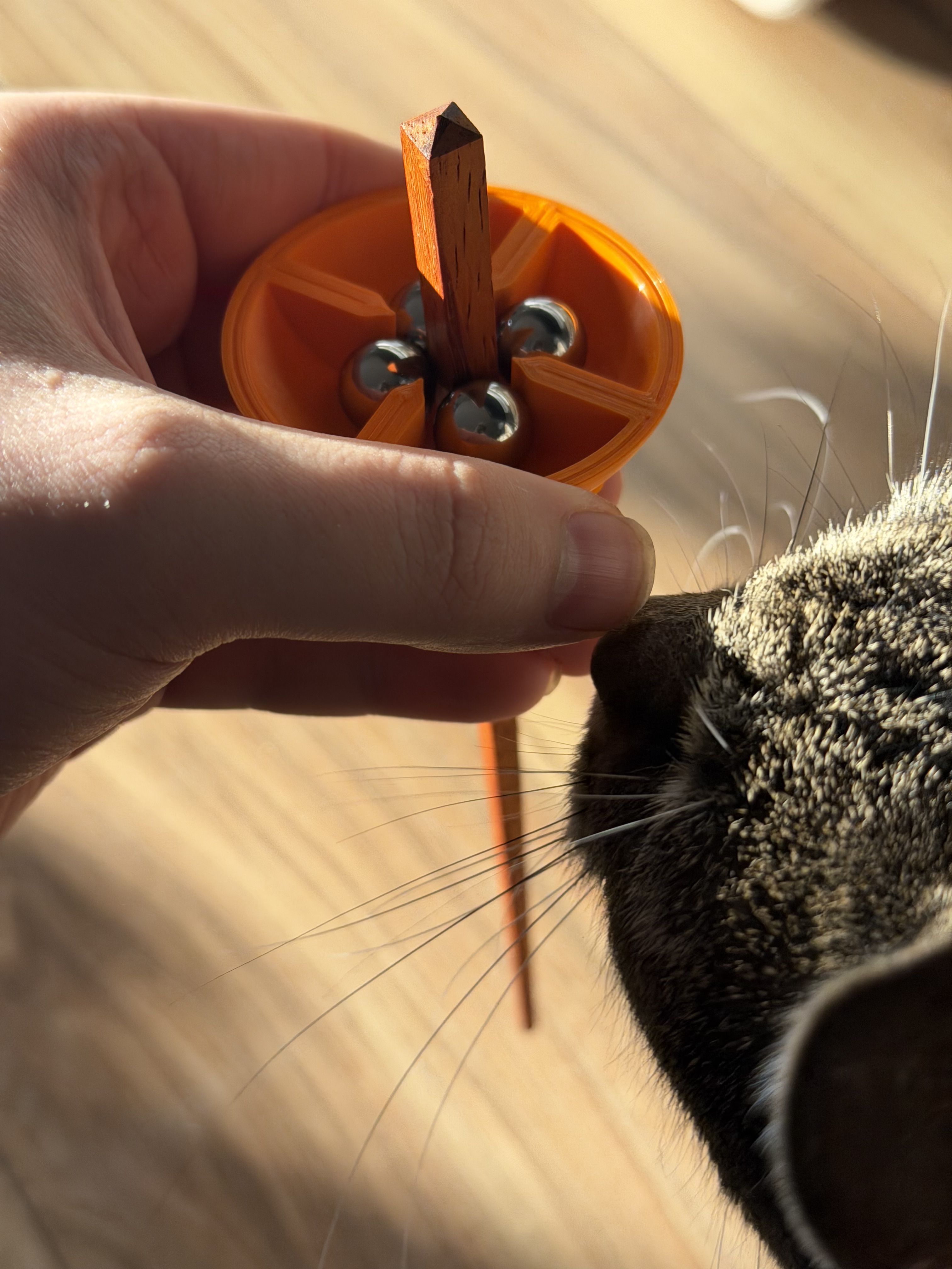

A promising little revision. Once I get a few moments of free time I can think a bit more about some slightly annoying aspects…but for now it’s looking good.
Very easy to interact with, very light pressure hold with minimal contact on the stick.
Relatively small footprint (which can be much smaller than this prototype) and it can be 3d printed in one big array.
Same idea, just with a steeper angle on the interior cup:
Here is a quick video to show the interaction. Quality of life is something I optimize in my jigs and such, I don’t want to be annoyed using a tool. I think this will be nice and easy to use even with a bunch of tung oil everywhere while wearing gloves. I’ll post the finished jig in the not too distant future if all goes well:

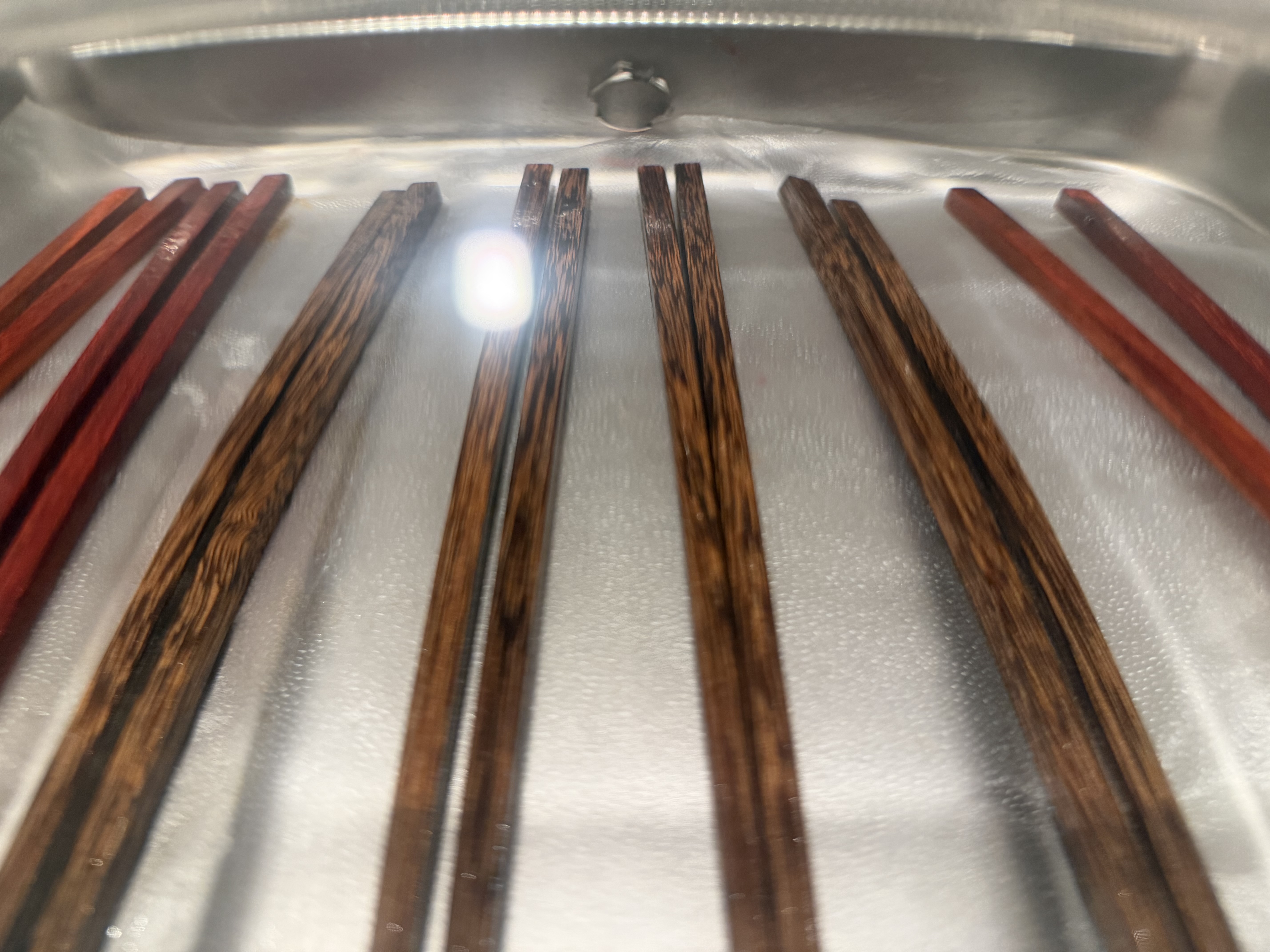

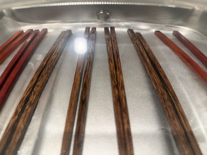

A small bit of vacuum seems to work well for getting the tung oil to soak in.
Also I tried oil sanding with the relatively thick tung oil. It was pretty great. No dust, no chemical smells from solvents, no paper loading. A perfectly pleasant experience.
I’ll probably use tiny a peristaltic pump to keep a small about of tung oil dripping on the paper.
Tyler, I can almost see a bag in your photo, but did you use a bag to get the vacuum situation? I’m thinking of a broken Seal-A-Meal that I have saved to use for “a small bit of vacuum."
I used a chamber vac but your save a meal should work, especially if it’s got an accessory port you could plug a tube into and connect up to your own container.
The sticks in the photo are actually just sitting on some cling film to keep the chamber clean.
There was some surface bubbling all around the sticks which means some air was evacuated OR some water was driven off (this gets plenty low enough pressure to boil of water at room temp)
I’ve got to do some controlled tests to gain confidence that it’s worth doing. Maybe some weighing before and after to see how much they absorb.
Initially I was going to try and do a similar process to the cactus juice stabilizing and get the tung oil to penetrate deeply, but it polymerizes with oxygen, so only the surface is likely to cure.
In my efforts to make this whole process faster, I’ll likely stick with the short vacuum cycle and I may try adding in some extra oxygen to facilitate the curing between coats. See if I can get a few weeks process down to below a week.
