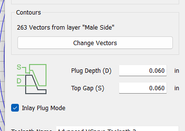

In the file you have both set to Start: 0.0 Max: 0.120
This shouldn’t technically fit at all. The male should sit above the female.
You control the depth with the start depth if you’re not using the inlay mode.
With the inlay mode you control the depth with the “Top Gap” setting.
If you can, cut the female first, then cut the male bigger than what you think you need.
i.e. set the start depth smaller or the Top gap larger than what you want.
Fit the loose female to the male still on the machine, measure the results & adjust accordingly.
When assembled, the Top Gap is at the top (Which is the bottom as the male is being machined upside down), and the Glue Gap is at the bottom. Glue gap is the female depth minus the plug depth. Top Gap you can actually enter for the male in the Inlay Mode.

On the Male V-carve, I might start with this
Then fit the female & measure the gap. You’re shooting for something like a plug depth of 0.100
So if the actual gap after this program measures 0.040", you want 0.020", a difference of 0.020"
So change the plug depth to 0.080" and the top gap to 0.040" and recut it.
Good idea to practice in MDF, but the adjustment/fudge factor may be a little different in hardwood, so still start with too much material & work your way down. You can always remove more, you can’t add material back. :wink:

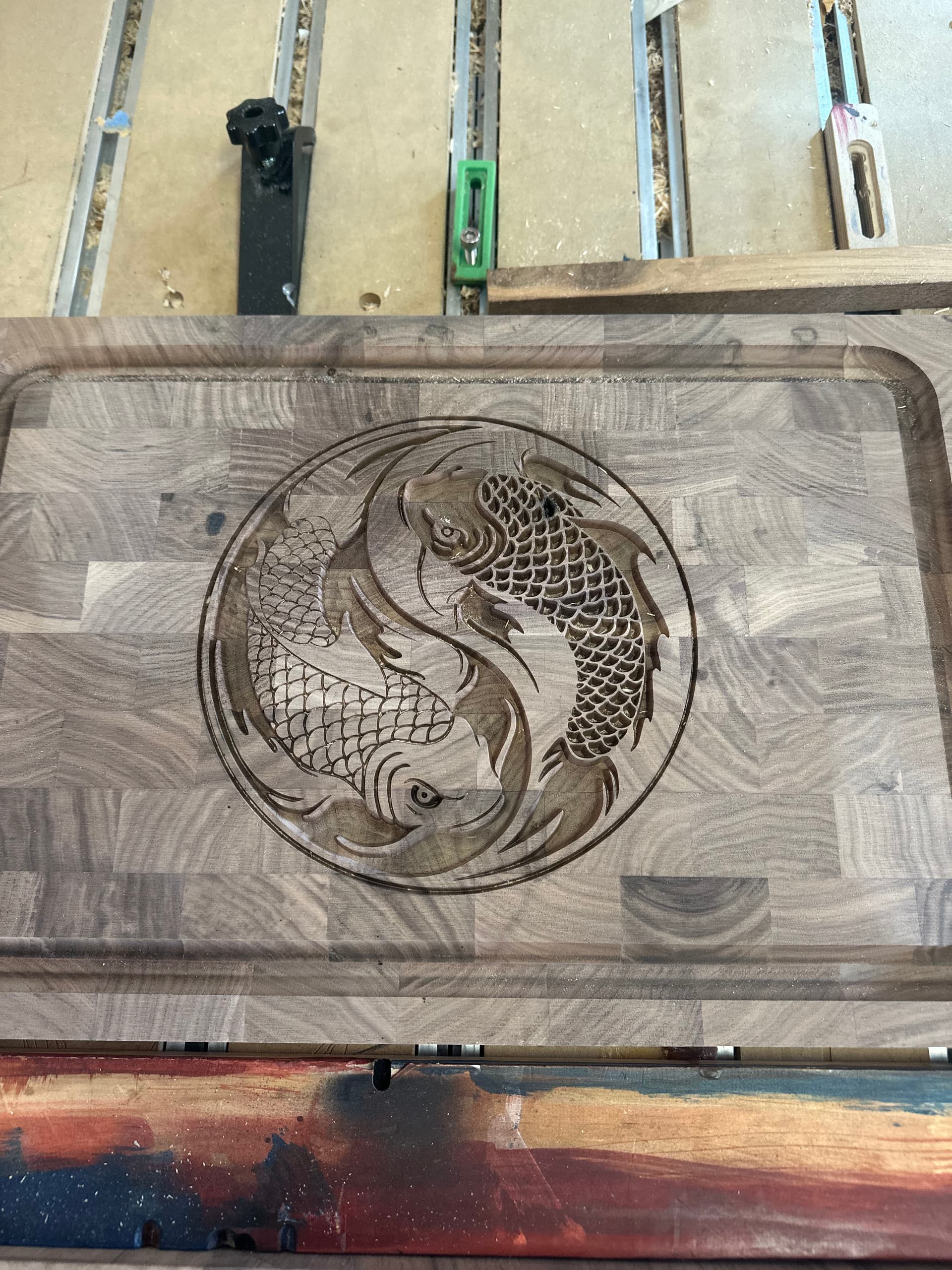

It turned out pretty darn good. I need to improve the press I used, as the Middle looks like it didn’t get enough pressure. Some tear out on the fine details of the horns.
I already started the next one. It’s being glued up today, 05/05/2025.

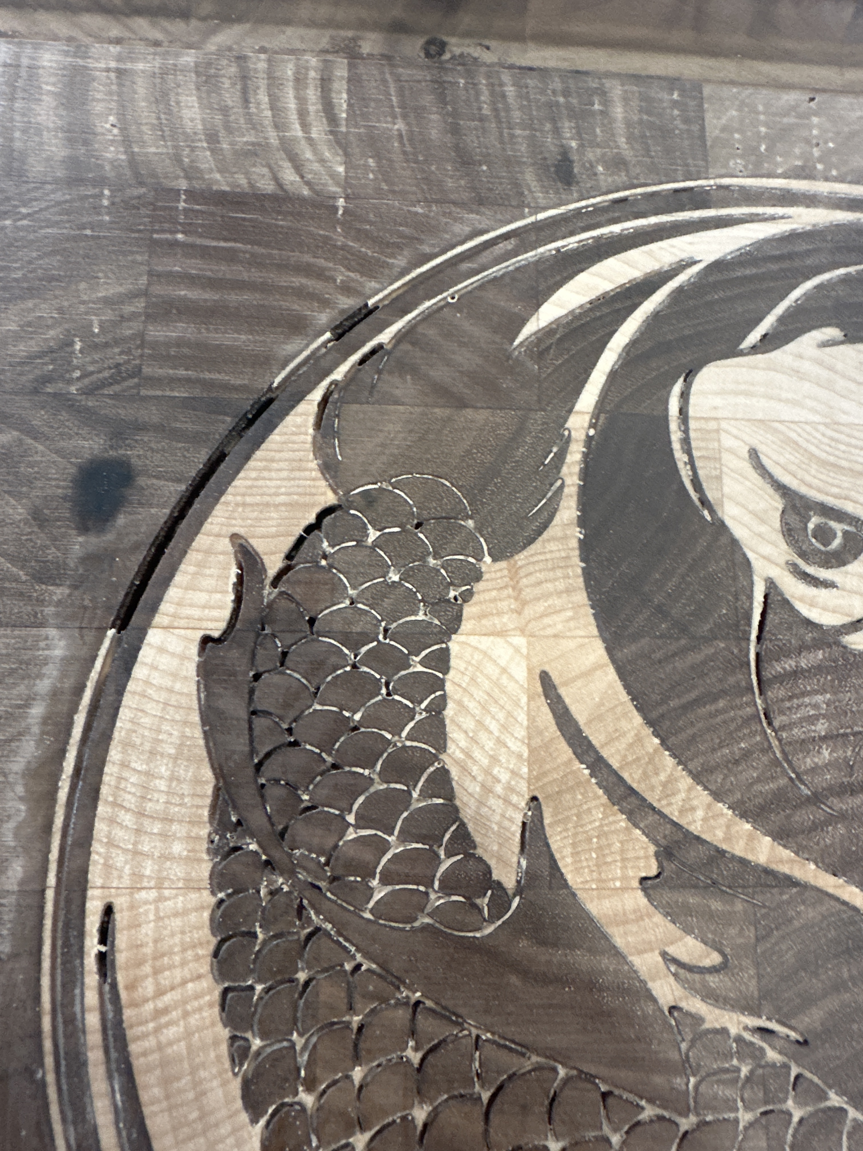

First successful inlay. Multiple failures. There are a few little spots that don’t look good. I filled them with black CA glue.
I pulled the Koi Fish Yin Yang from a google search.
“Koi fish yin yang silhouette”
KOI YING YANG INLAY

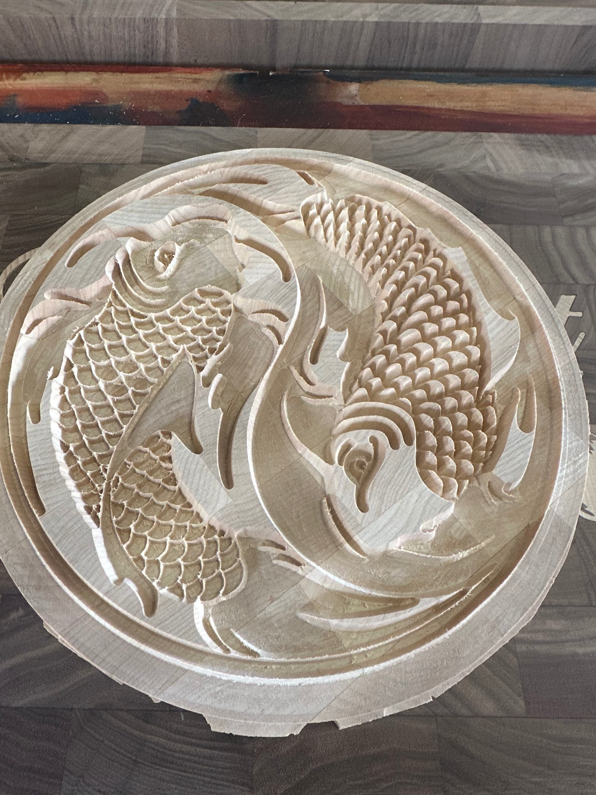

The glue up is done as if this morning. All I have to do now is face off the plug and reveal the design.

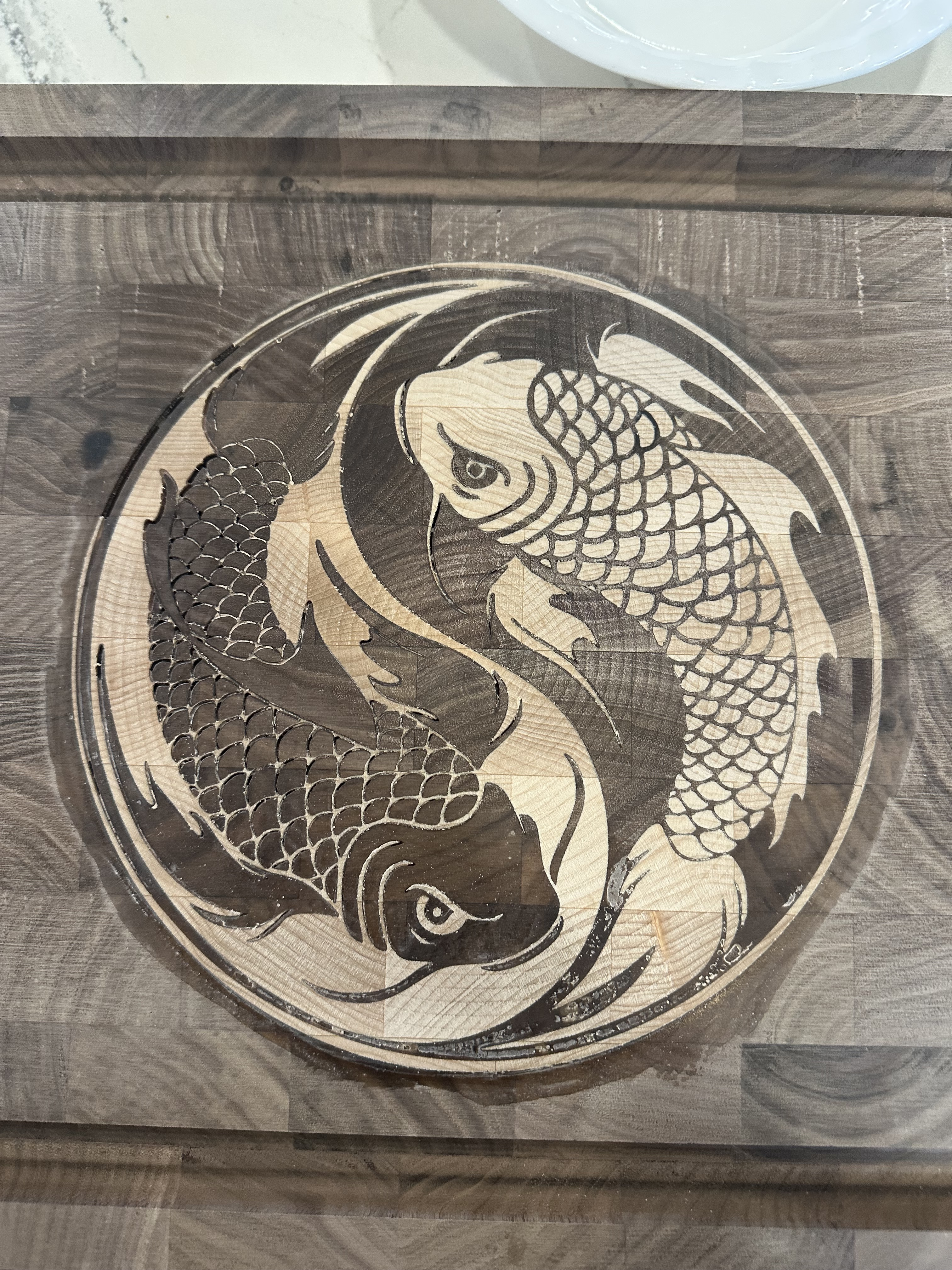

Impressive for just starting inlays, we are looking forward to seeing the final Koi fish completed!
Well kinda of a fail.
It looks like the glue down went on crooked so one side of the plug didn’t go into the female deep enough
Are you getting enough glue in the female blank?
Still turned out pretty good, only way to learn. I have not had time to get into inlays yet.
Yes, there is enough glue. I knew immediately when I pulled it out of the clamping system I used that it was not right.
The spot where the scales didn’t stay was raised. Before I faced it off, I used my calipers to measure the height of the plug. The “good” side was .25", and the “bad” side was .458" above the female side.
