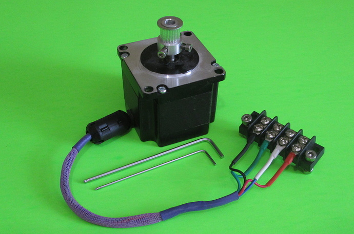

One of the other things I did that helped alot is replace all the motor set screws with cap screws. The cap screws give you more torque on the motor shafts and help hold it in place better. May not be the issue but it will solve problems later potentially.
Thanks,
These are the really small set screws for the motor shafts?
Do you happen to remember the size of the new cap screws you used?
I dont remember for sure but think they are M3. I would take one of you set screws with you. You can get the cap screws at Home Depot, Lowes and Ace Hardware I know for sure. Other places probably sell them.
Here is a picture for reference
Correct. M3m the set screws are ~4.75mm in length, so 5mm probably too short, 10mm seems to have clearance.
