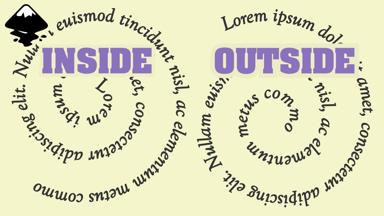

Inkscape has a feature to do spiral text. It actually snaps the text to a design line which just happens to be a spiral feature they have. But would also snap text to any line you choose.
