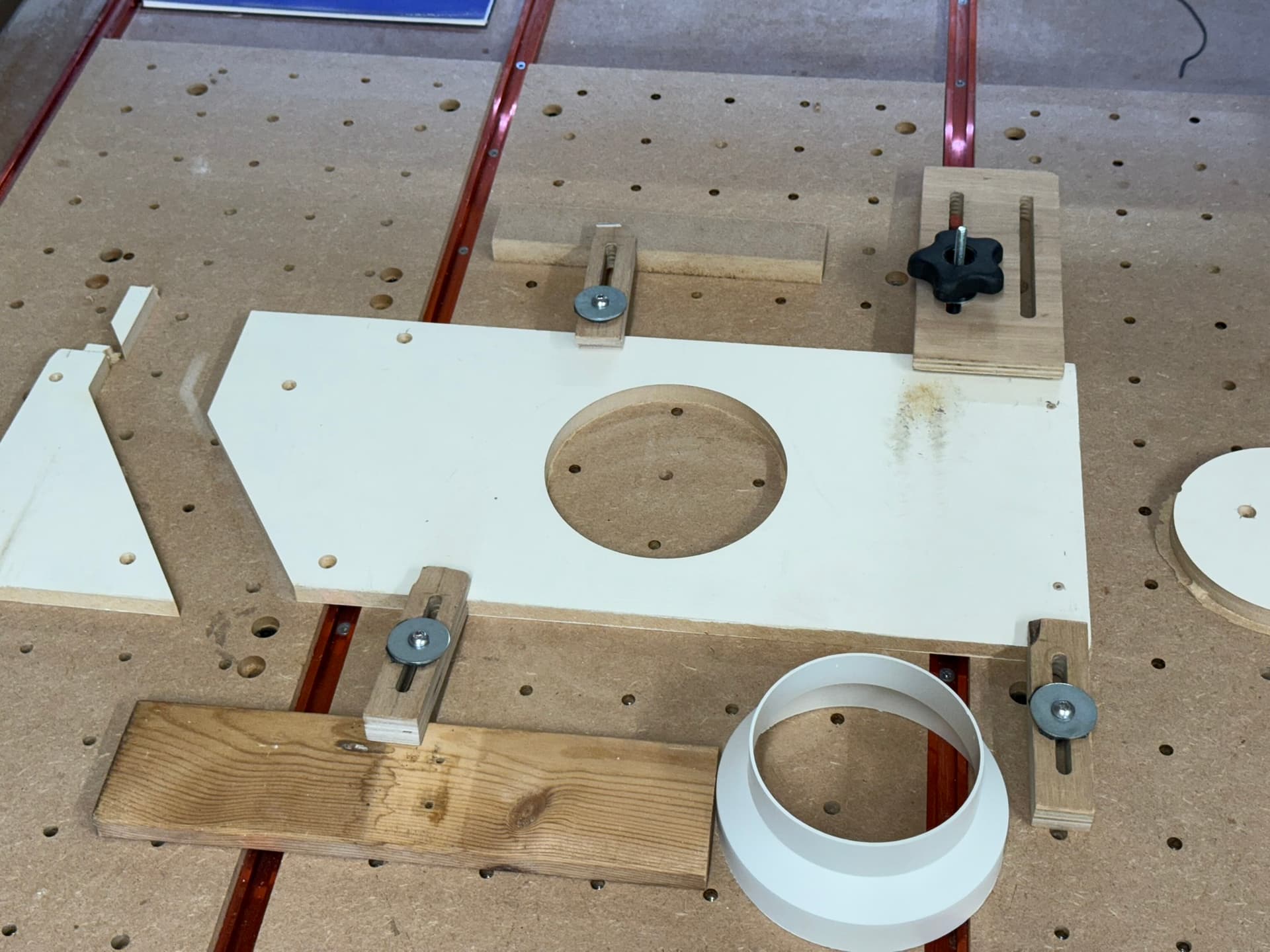

I made various plywood hold down clamps, a slot for the bolt and a step to register at the edge. When the workpiece is thicker I use some scrap under the tail end of the clamp, a cheap version of the stepped clamps on a mill.
The longer plywood clamps help keep the metal hardware away from the workpiece and toolpaths and, if you hit them with a careless rapid, they just get cut and you make a new one.
I bought a kit of handy stuff for making jigs from a local tool supplier, I’m sure Rockler and others have similar in the US. The kit comes with various lengths of bolts for the T tracks for different height workpieces.
Couldn’t find a pic of thick stuff, but I’ve used the larger slotted plywood clamps to hold down 3" thick workpieces.
The perforations in the spoilboard are holes with M6 Tee nuts inserted from behind with a few 6mm bores for alignment pins, but you probably have way more T track than I do.
