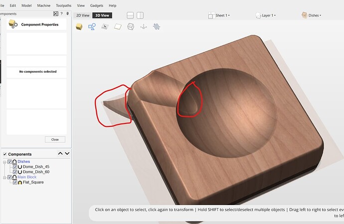

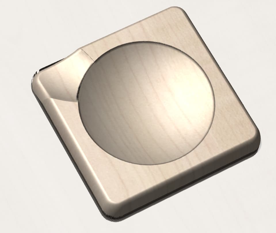

Anyone know how I can clean up this model? The clipart function on vcarve is leaving some unwanted overhang.

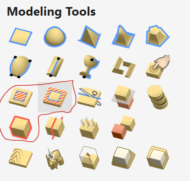

What you are going to do is create a vector around the center dish. Select the vector and the outside dish, and delete everything inside the vector. Then create a vector outside the square piece and select the outside dish again and delete everything outside the vector.
You will be using these three modeling tools.
