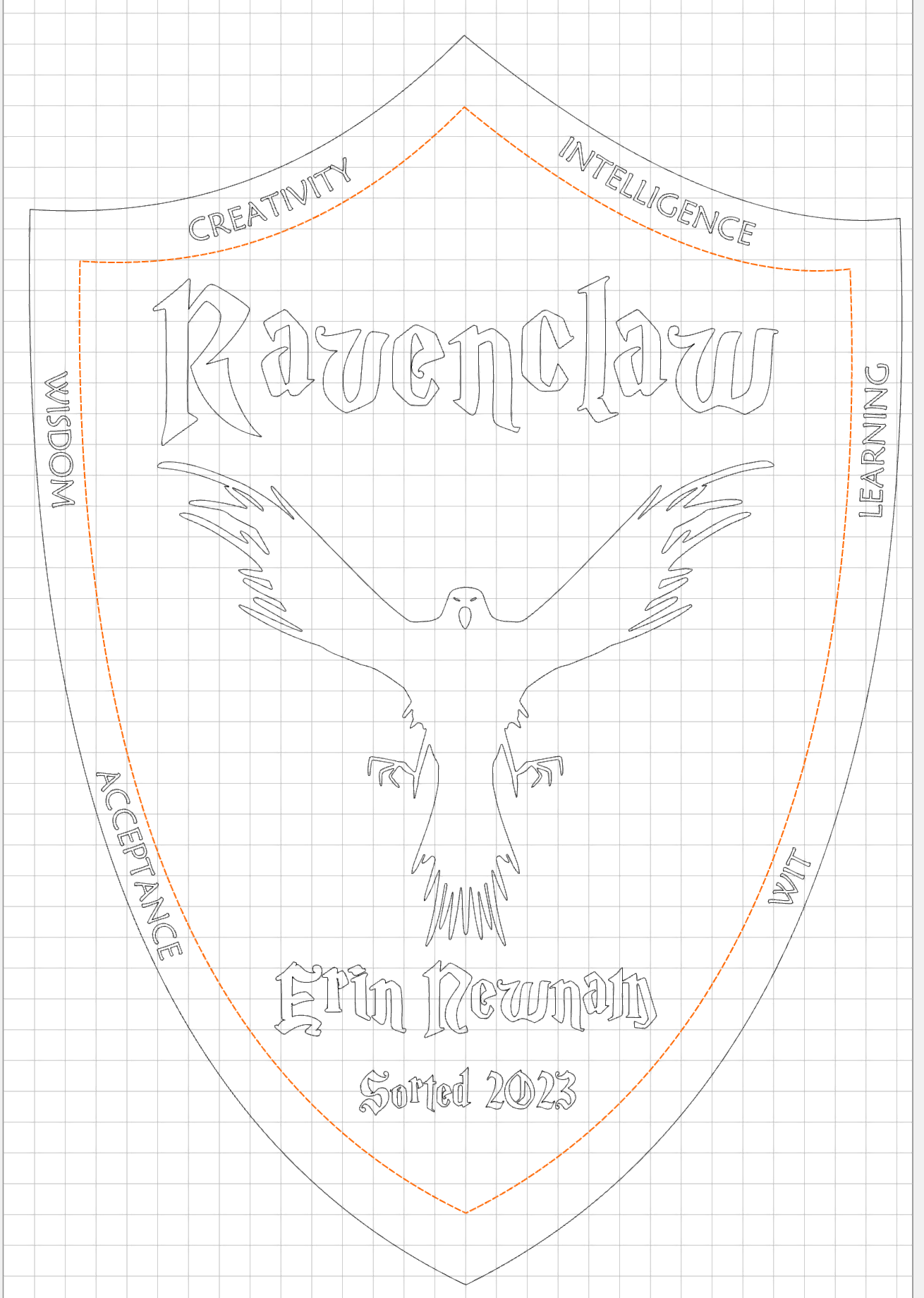

Hey Folks,

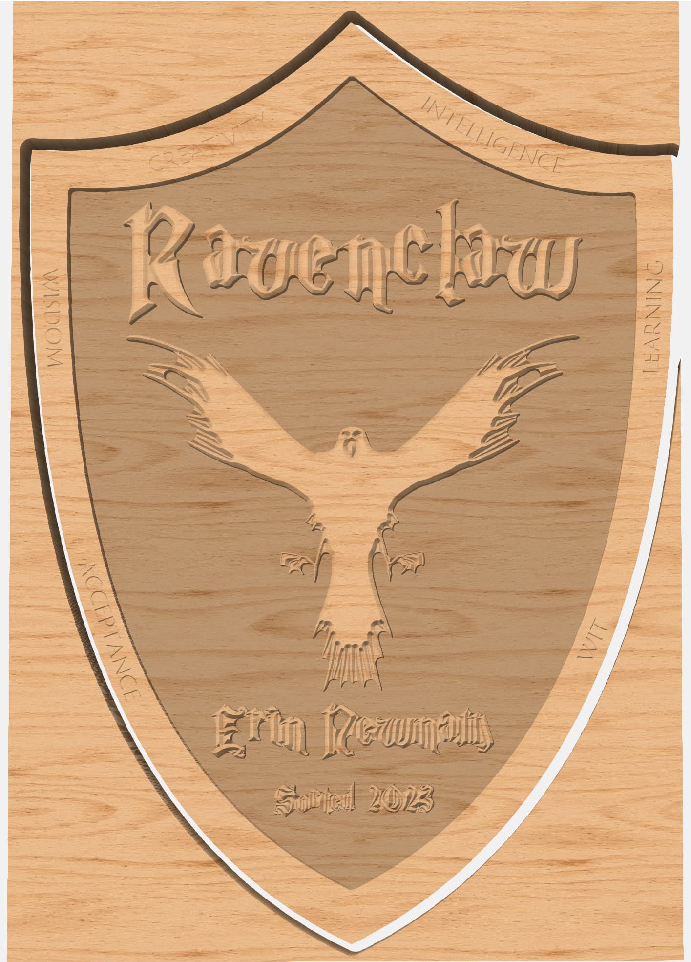

I am in need of assistance. I am working on a Christmas present for my sister in law, who is a nerd like the rest of us, but her nerdery is in the form of Harry Potter. So I am commemorating her “Sorting” to house Ravenclaw (just an online quiz thing) with a plaque/sign thing. I am planning on using cherry for the base material and have gotten the appropriate wording and outline all designed, but I am having some trouble getting satisfactory results with the toolpath.
Here is the design concept. I’d like the shield border, Ravenclaw, the raven, the name, and sorting to all be the surface. I’d like to then pocket the areas between that, and then v-carve the traits around the shield border. When I initially tried just pocket, the resolution of the endmill made it obviously bad, so i thought, hey, why not do a shallow v-carve on the vectors to set that detail off, then pocket or texture the lower spot. That certainly got me closer, but still not quite there. Oh, and if I could have an interesting rough texture for the pocket, that would be amazing, but when I tried the texture toolpath it was even worse.
So what am I missing? As you can tell, I’m quite inexperienced, and hoping one of you will have the magic combo for me that will be obvious to me one day. :slight_smile:

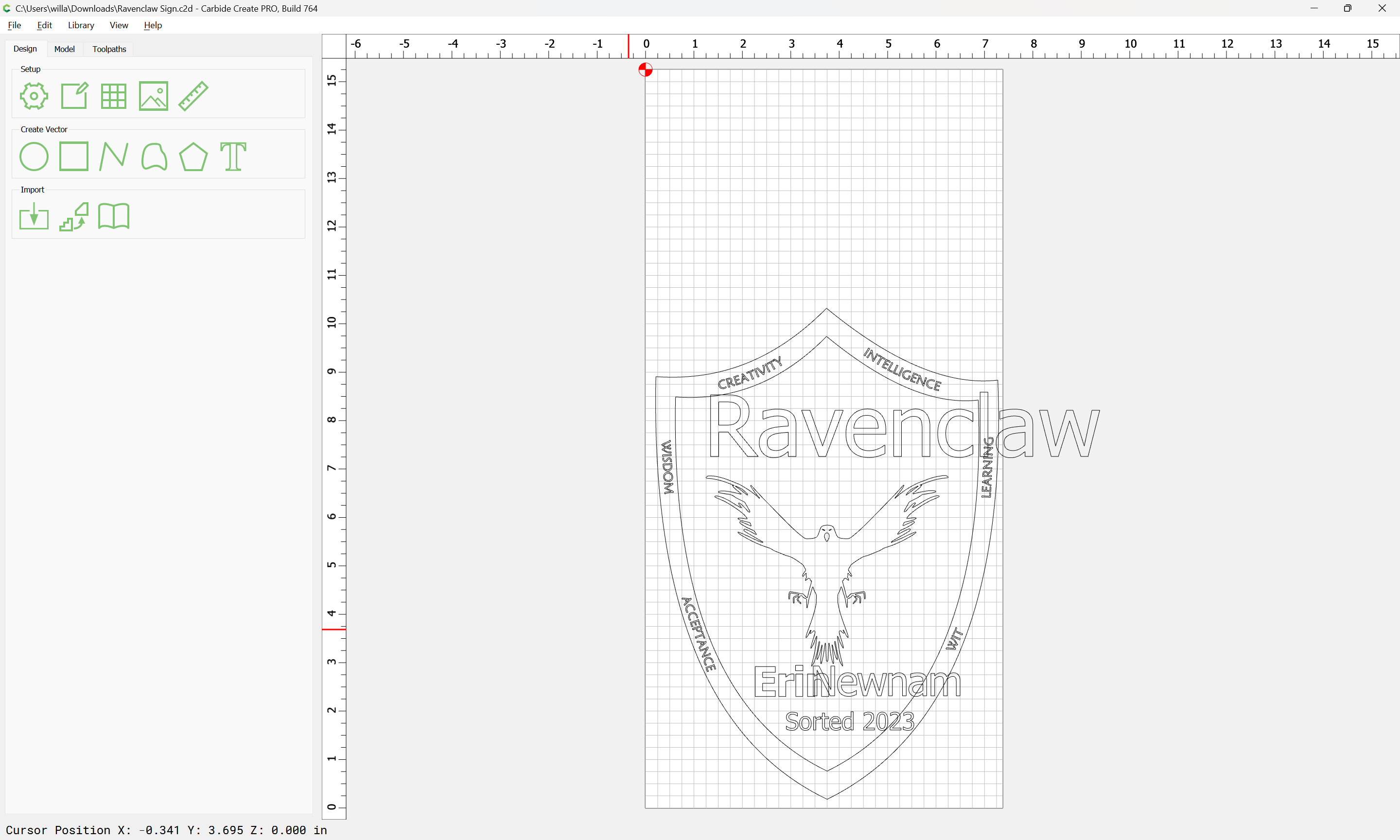

Unfortunately, I don’t have the font in question:
Please convert the type to paths:
https://carbide3d.com/blog/merging-script-fonts-in-carbide-create/
and we’ll do our best to assist.
I believe that Advanced V carving will be what you want though.
Ah sure, that makes sense you wouldn’t. Here is the converted file.
Thank you for looking!
Ravenclaw Sign_ConvertedText.c2d (1.2 MB)
Edit: dangit, I missed one. Reuploaded at 9:03p cst
Yeah, thanks for that direction. After a quick googling on that term, and finding the vid from C3D, that def looks like what I need to be doing!
Still playing with depth, etc, and thats definitely the feature I needed. Thank you so much for the help!

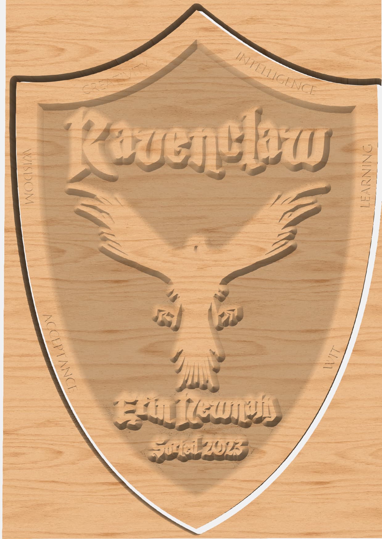

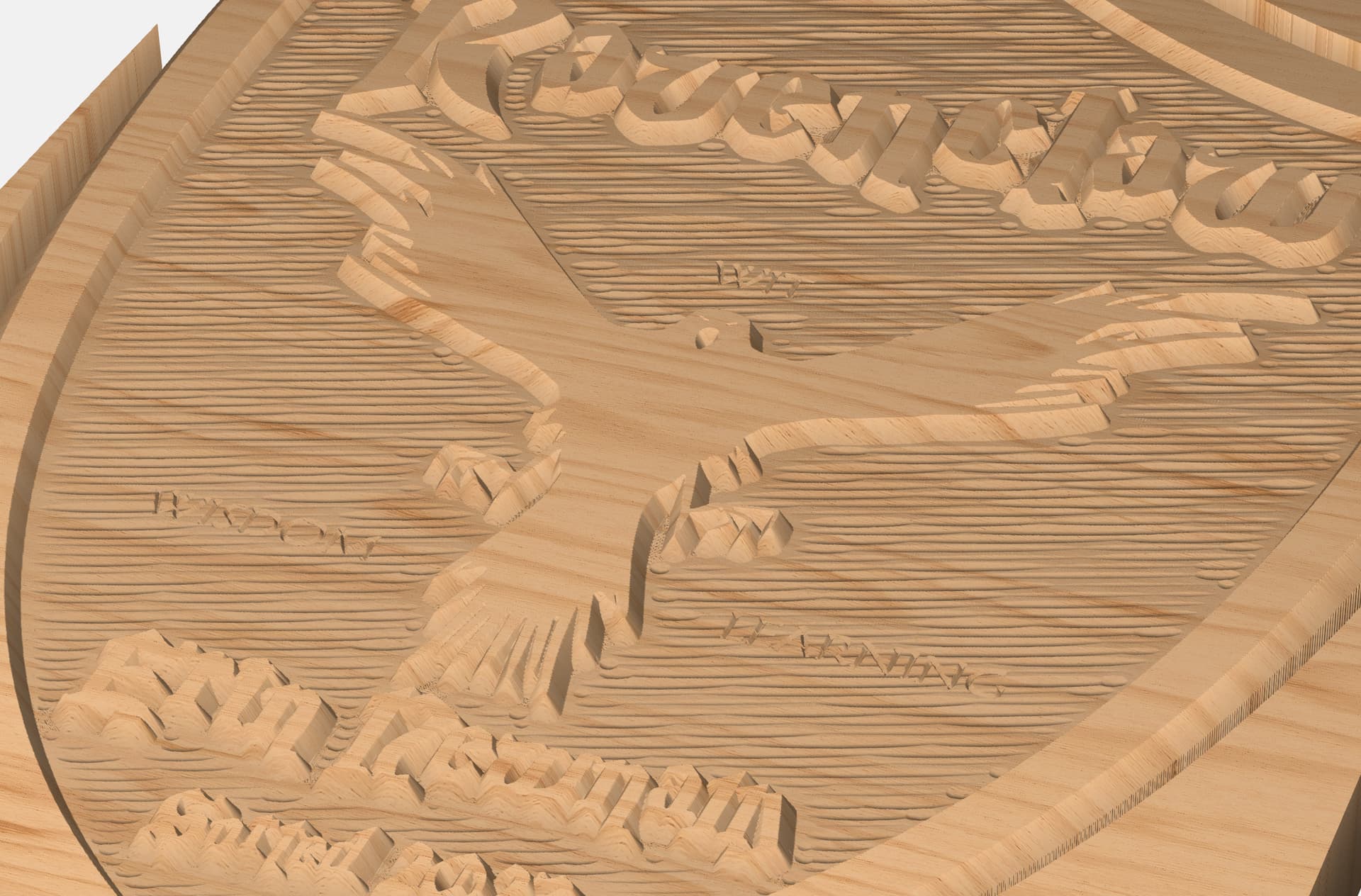

I played around with the texture toolpath with a 1/8" ball…
You have to offset the boundary as the texture path cuts ON the boundary, not inside of it, and I had to account for the 45° angle from the V-Carve. (I showed the math in the file)
I also changed the Adv V-carve depth to 0.050
If you want to see the detail better, when you simulate rotate the part forward so it’s kind of upside down

I like the look of your attached sim, though, thats great! I was worried about going too shallow and losing some of the pop, but that looks like it could be nice.

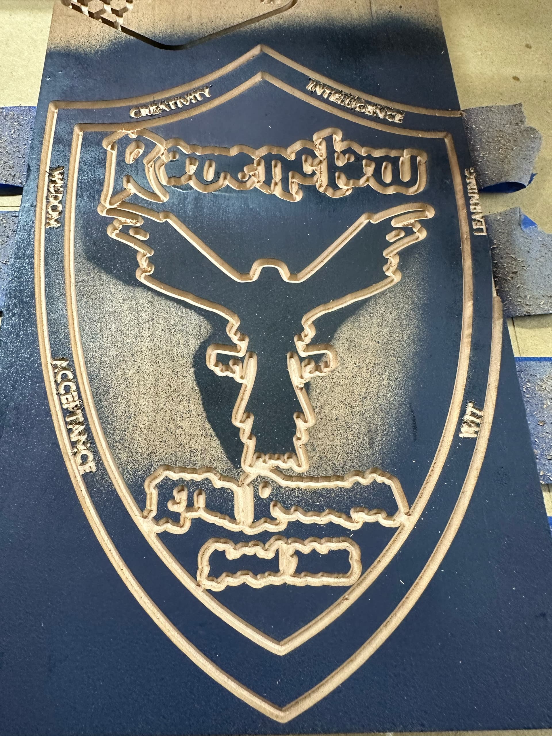

Well I got my bitsetter and am off and running. Turns out…I can’t tell the difference between 7 3/8 and 7 3/16. Lol, doh. I converted my brain to metric for 3d printing, I dunno why I’m sticking with imperial here.
Either way, I suspected this would be a dry run…and it was. I messed with pre-painting and it turned out pretty nice. The black and blue are pretty similar, though.
Looks like I need to investigate single line fonts a bit further…the 6 traits didn’t do so well in v carve. Anybody have any good resources that helped them with small text like this?
Here is a pic so you can see how I had my setup wrong, and some of the other issues. I stopped it before it got too far in (not even finished the vcarve part before pocketing), but let it go long enough that I could see if most of it was working. I will probably plane this off and try again tomorrow.

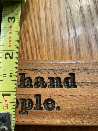

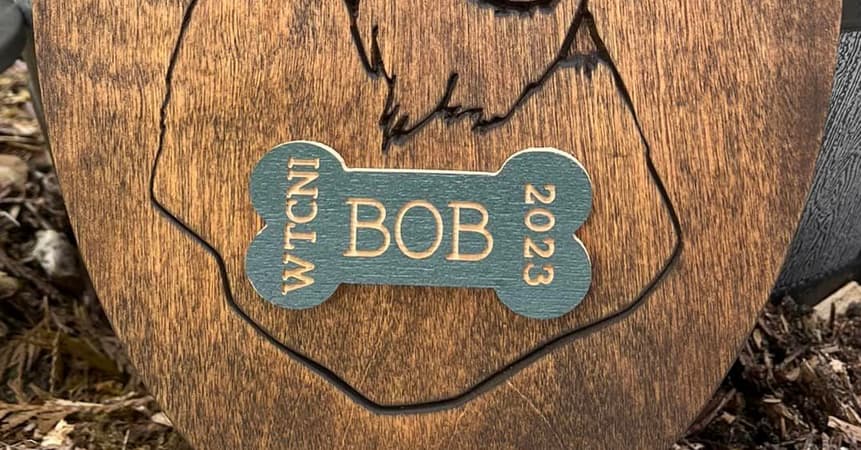

For V Carving small fonts, a sharper V bit can help, like a 30 deg bit.
Another option is a font designed for contour cutting, and use a very small bit. For example, this is from a dog-show prize I made, the ‘bone’ is about 1" across the center area:
This was done with a 1mm downcut bit, using the ZNiko font:
Thanks, Michael! That is one small bit! I will definitely be looking for those, and a 30 degree in the future. Unfortunately for now, for Christmas, I’m stuck with what I have.

The thing which are critical here are:
  • that the surface of the stock is flat and parallel to machine motion (either the stock has to be of uniform thickness, or it needs to be surfaced on the machine)
  • that the surface which the stock is mounted to is flat and parallel to machine motion (unless the top is surfaced on the machine)
  • that the tool length offset stays consistent if the tool is changed
  • effective V angle of the tool matches the tool definition in the file
@KevBarn14 has an excellent video on this:

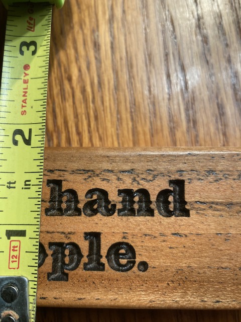

Here is an example of 30 degree v carve in cherry using a western font. Tool path from CC on an S3. This was done using a bit from a cheap 10 pack off amazon (nothing special). Your small lettering is a little less in width than the horizontal portion of the “e” and would carve shallower. 30 degree would do it but what Will says applies with respect to flatness etc. You could always scale up the traits if their small size is an issue.

@WillAdams you mention those points specifically, but I don’t think I had any issues related to flat unexpected tool profiles. Or did I and i just haven’t realized it yet? lol. I have changed the file a bit since the last one, and added a chamfer to the outside profile. My issue for sure was that I had the wrong width of stock in CC. So is there some defect that you see in the image that I am totally missing?
