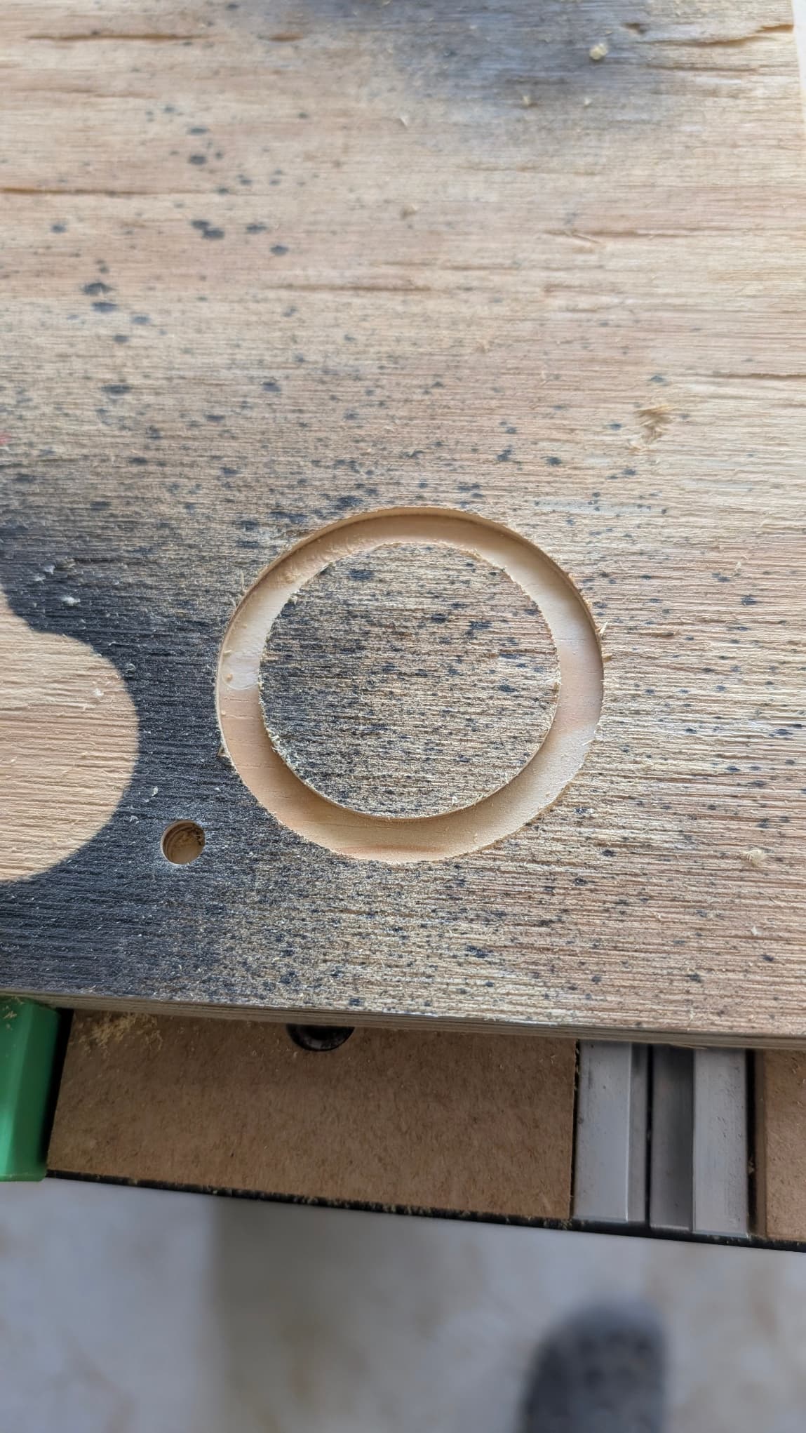

I also ran a simple circle and it looks pretty good to me:
So I guess I’m just resigned to a loud machine. As long as it’s an accurate one, I’m OK.
