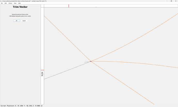

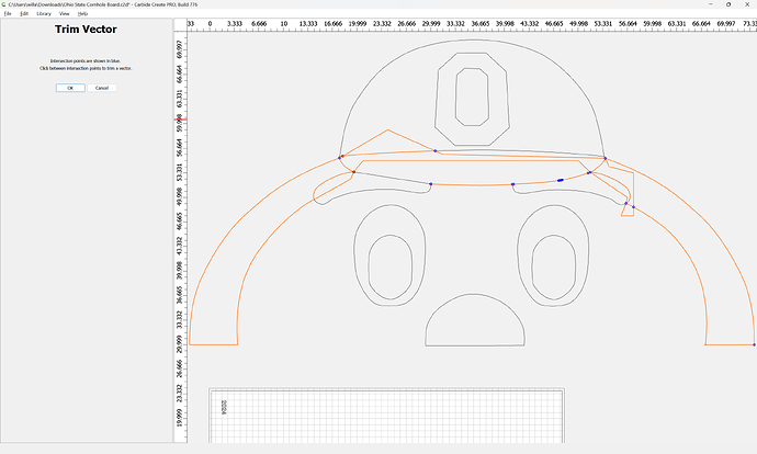

Add the elements to the selection by shift-clicking:
and then use the Trim Vectors tool to remove what is not wanted:
If necessary, pan around and zoom in/out:
until one arrives at:
OK
