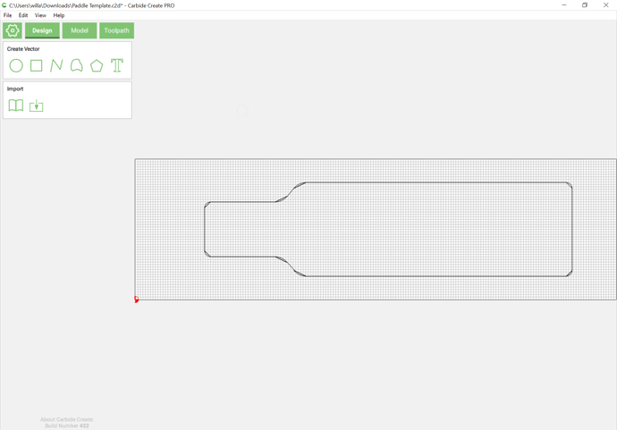

I am trying to make this handle in CC and its seems pretty straight forward, but i can’t seem to make the arcs or work like i want them too. I drew up the paddle in Autocad and converted it to a dxf. It has left the rounded corners and fillets open.
I tried to create this same object in CC but i could never get the circles and rectangles to cooperate using one of the boolean options.

Unfortunately, Carbide Create doesn’t have an option to join open paths with closed, or multiple open objects into a closed object.
Would you please send the source file in to us at support@carbide3d.com? That import is wrong in ways which it might be useful to have a developer look into.
Easiest way to fix this in Carbide Create would be to:
  • delete all the open (magenta) paths
  • draw in a polyline which describes all the missing parts:
  • select it and all the curves which make up the outer rounding:
  • Boolean union:
  • Select the shape and shift-click on one of the inner roundings so that it is the key object (dashed selection) and Boolean Subtract:
It should be pretty easy to draw this in Carbide Create — you’d just need two rounded rectangles unioned, and a second one rotated, duped, mirrored and subtracted twice.
Thanks Will. I was able to do that like you showed. I did send the file. If i could get some feedback after the developer looks at it, that would be great!!!
