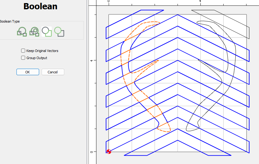

Closing open vectors
OK, so select all the chevrons & one of the antlers, and subtract

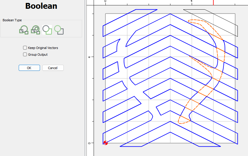

The chevrons should still be selected, so just shift-select the other antler, and subtract again
