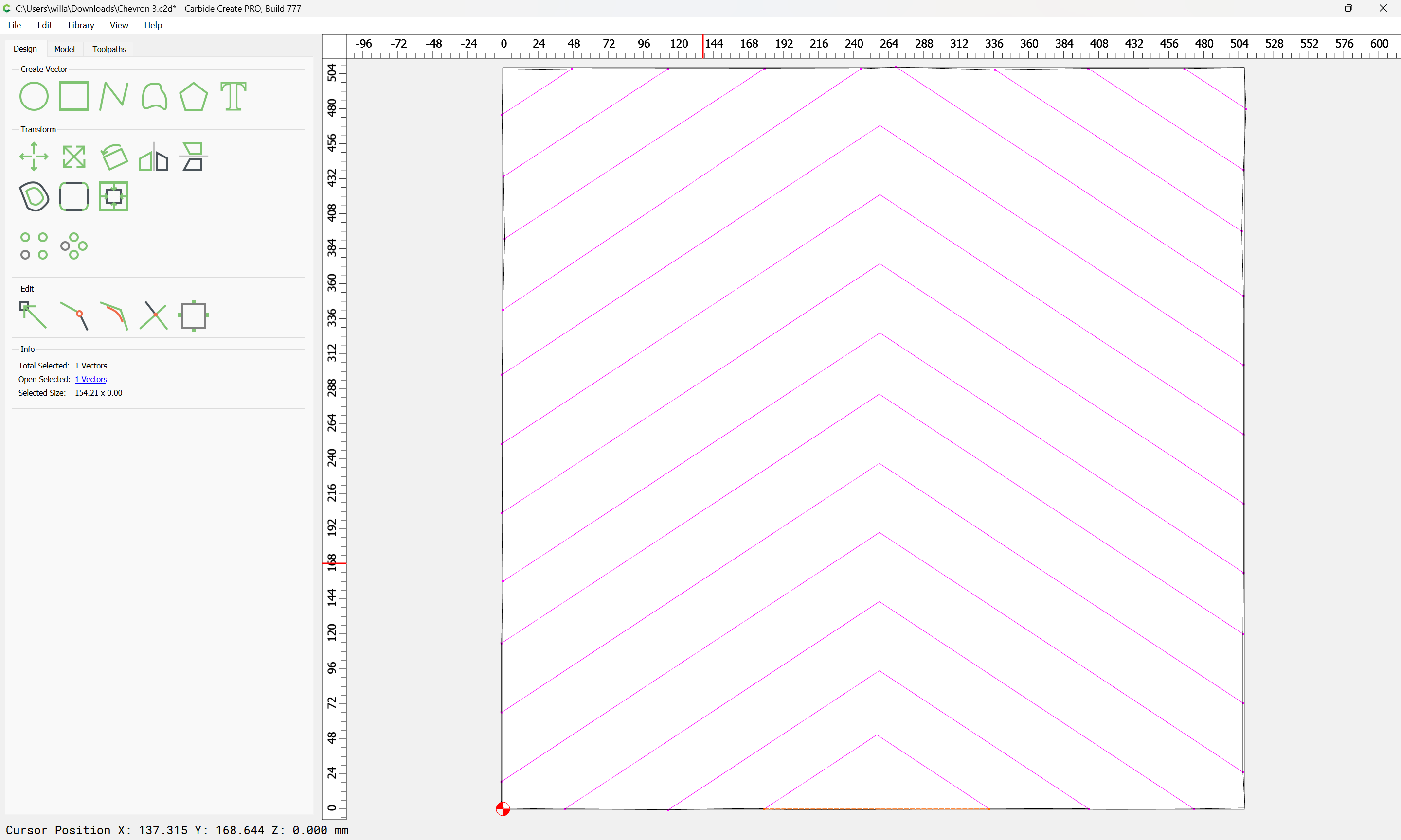

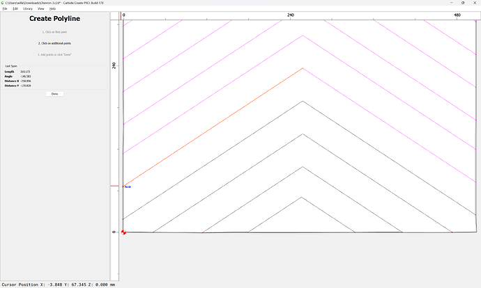

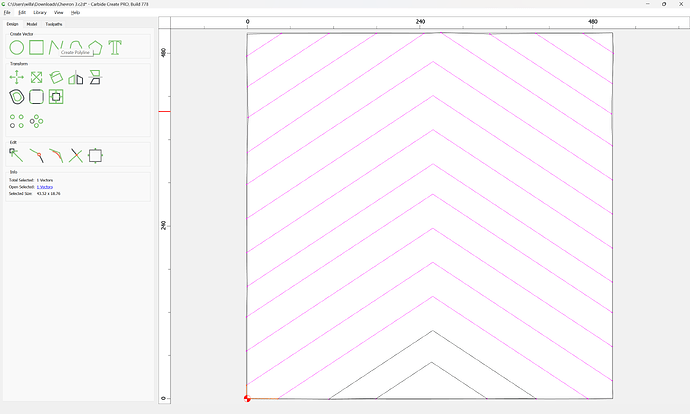

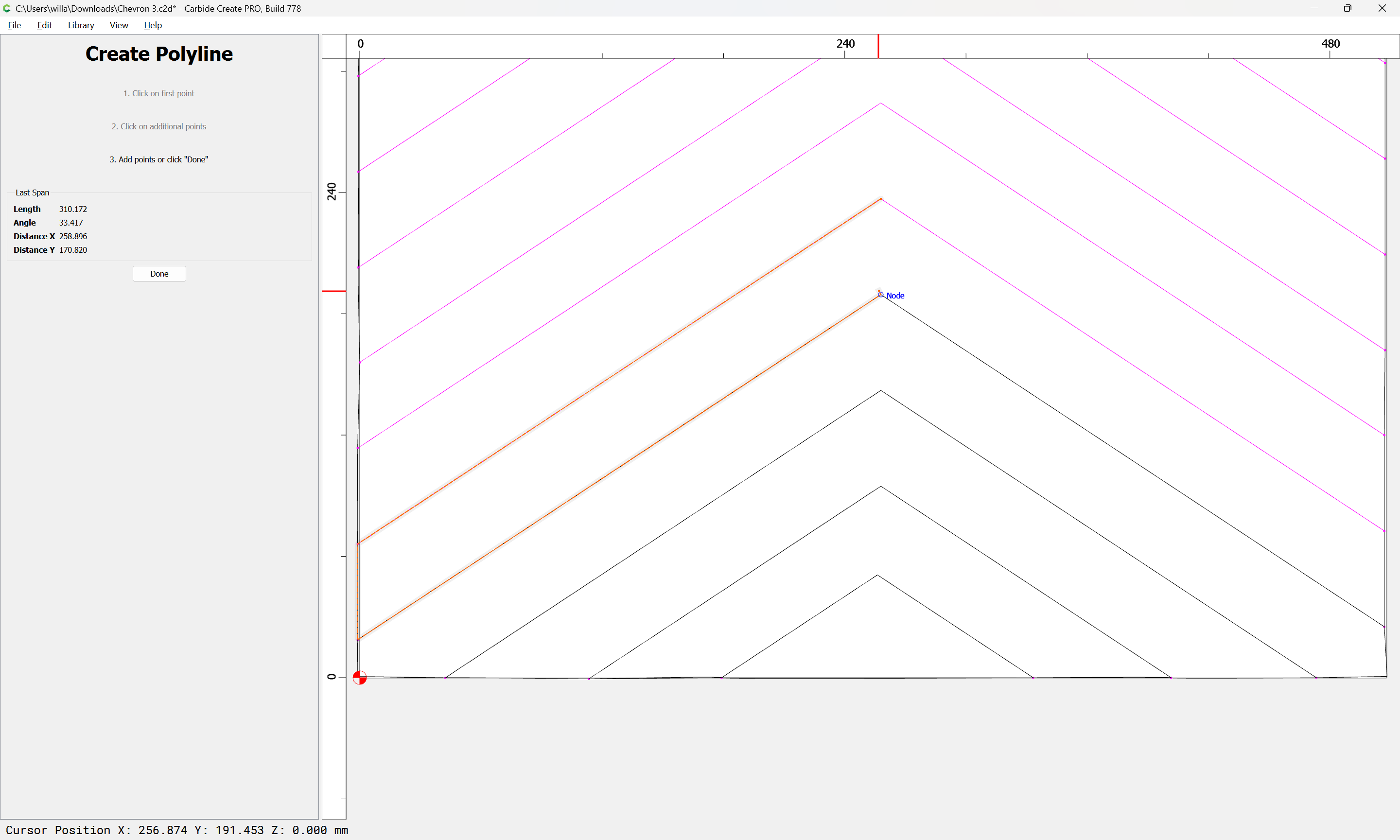

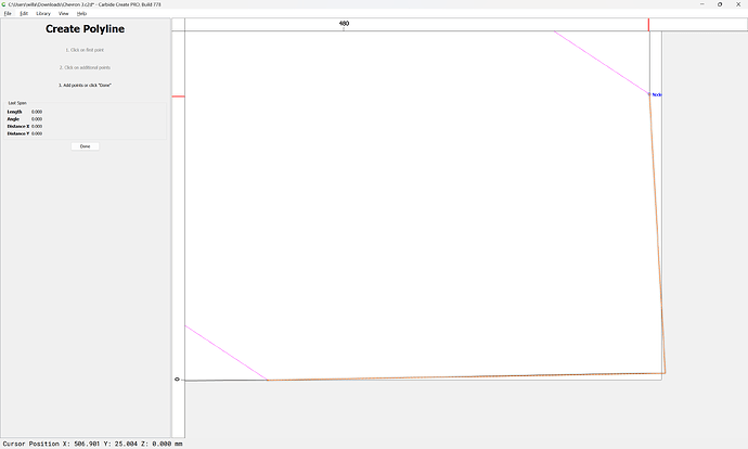

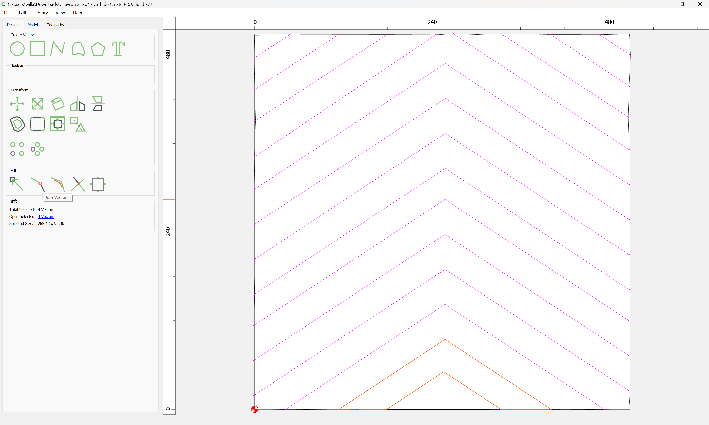

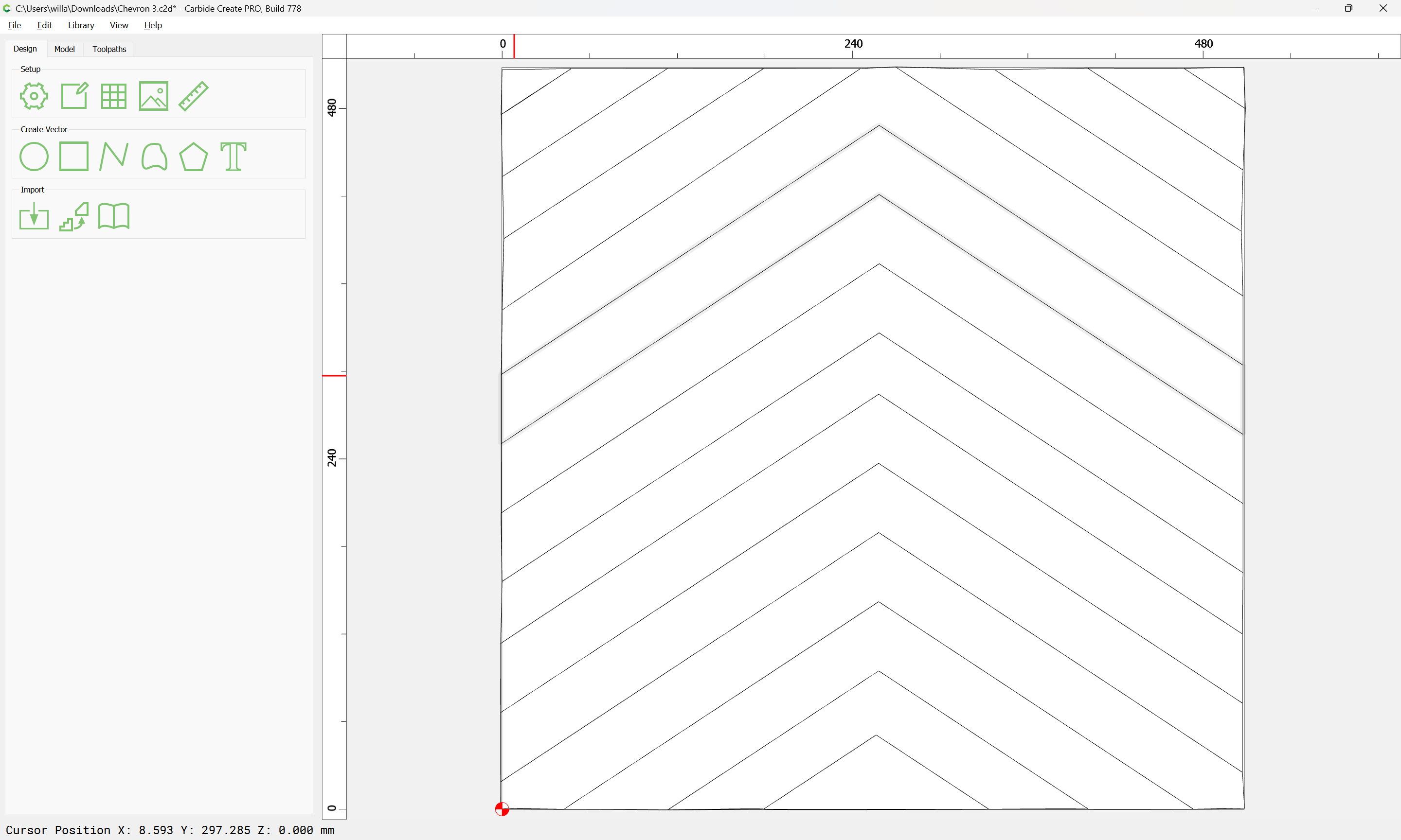

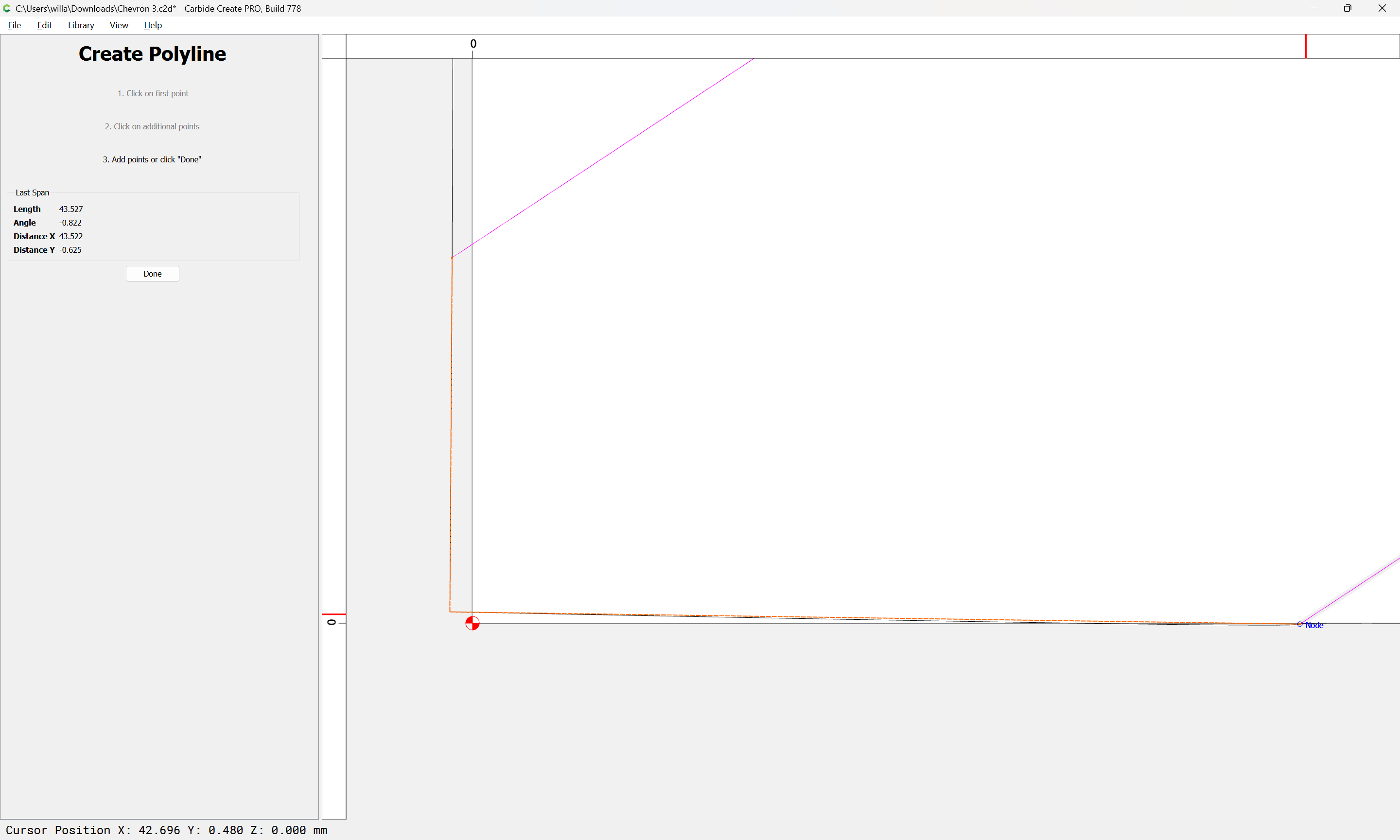

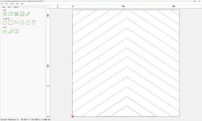

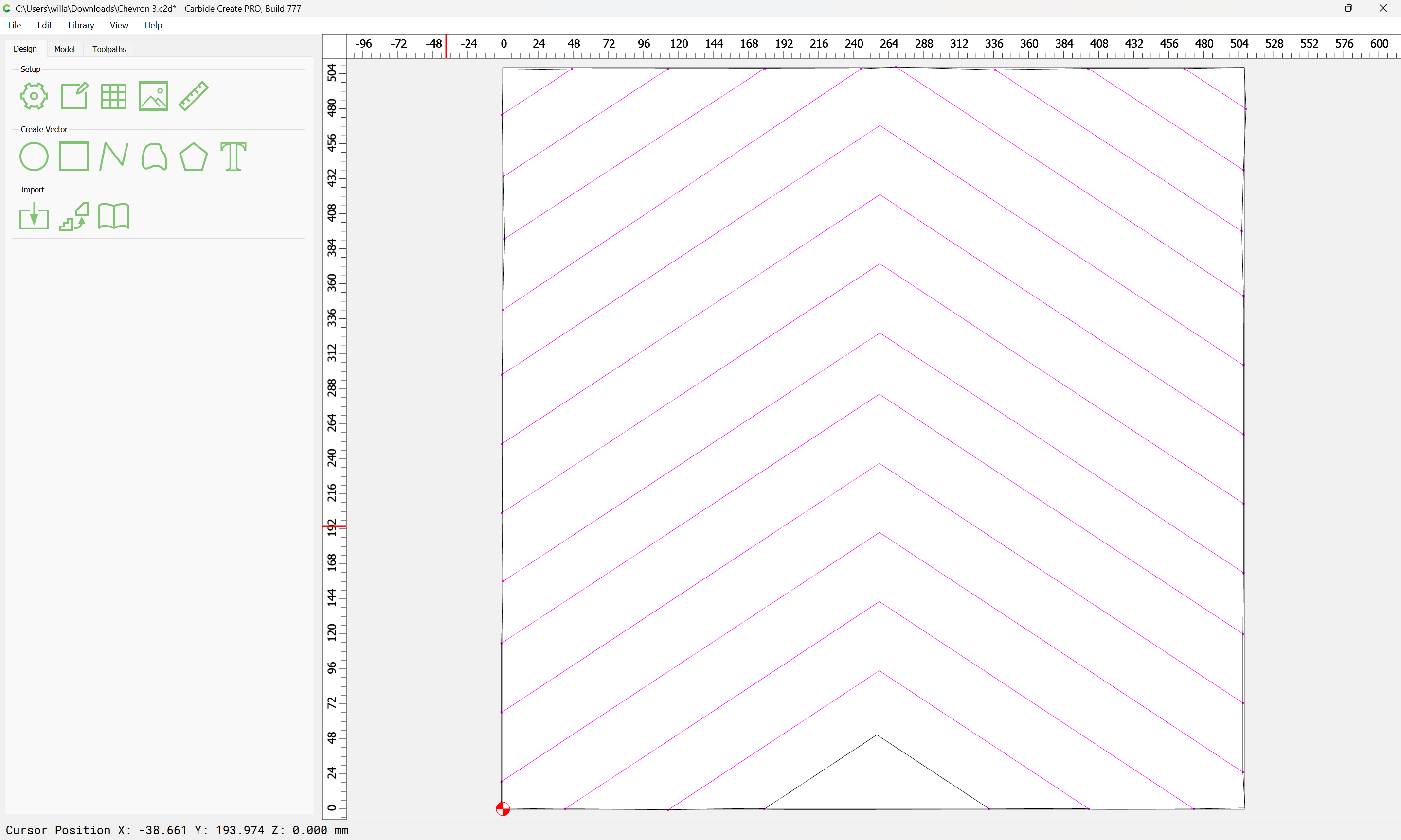

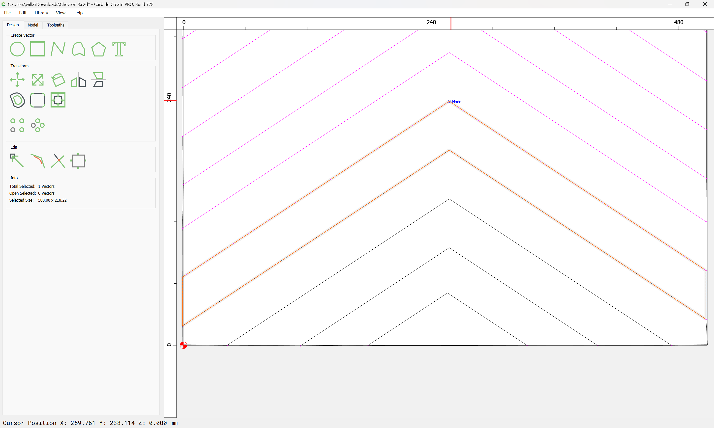

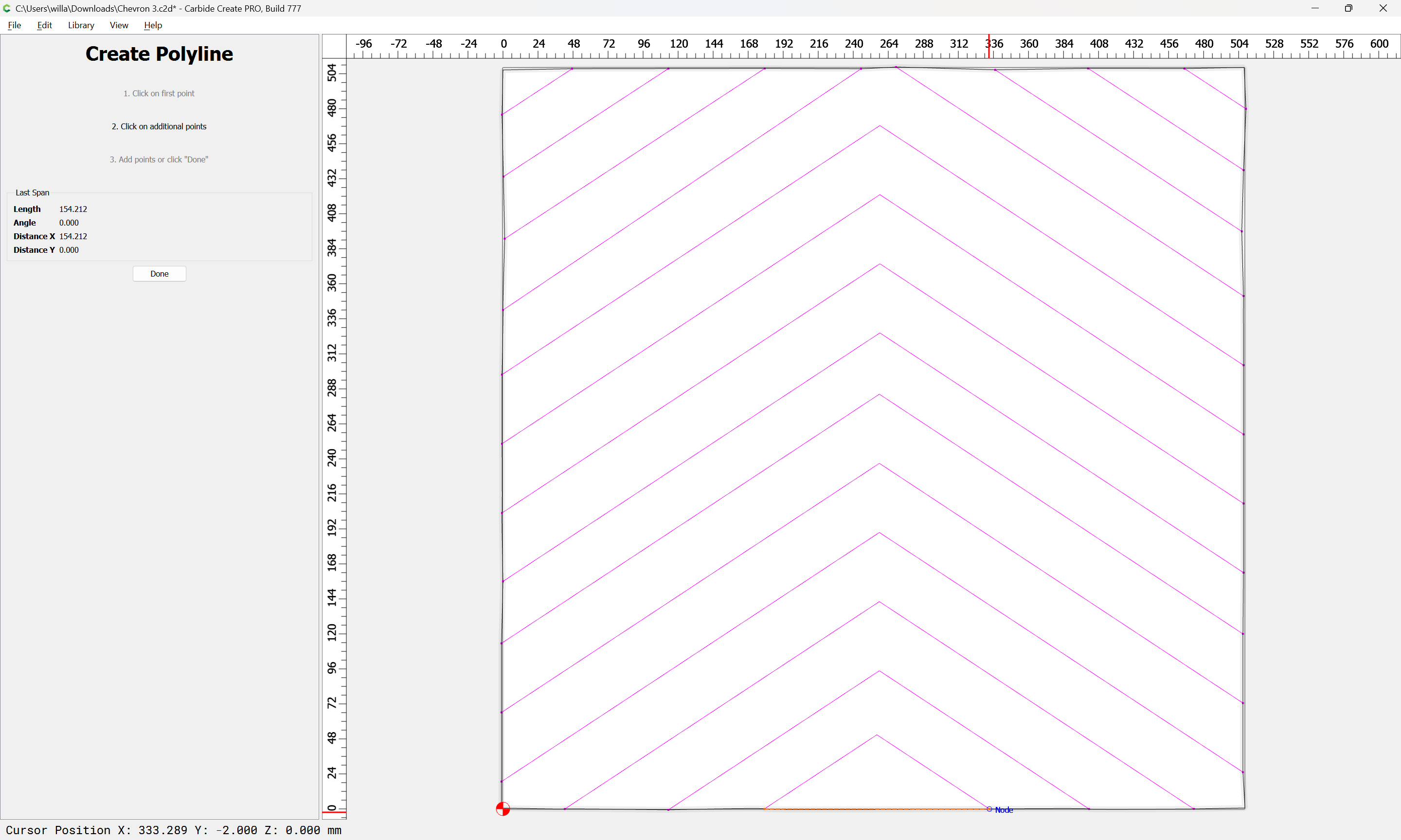

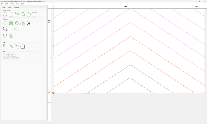

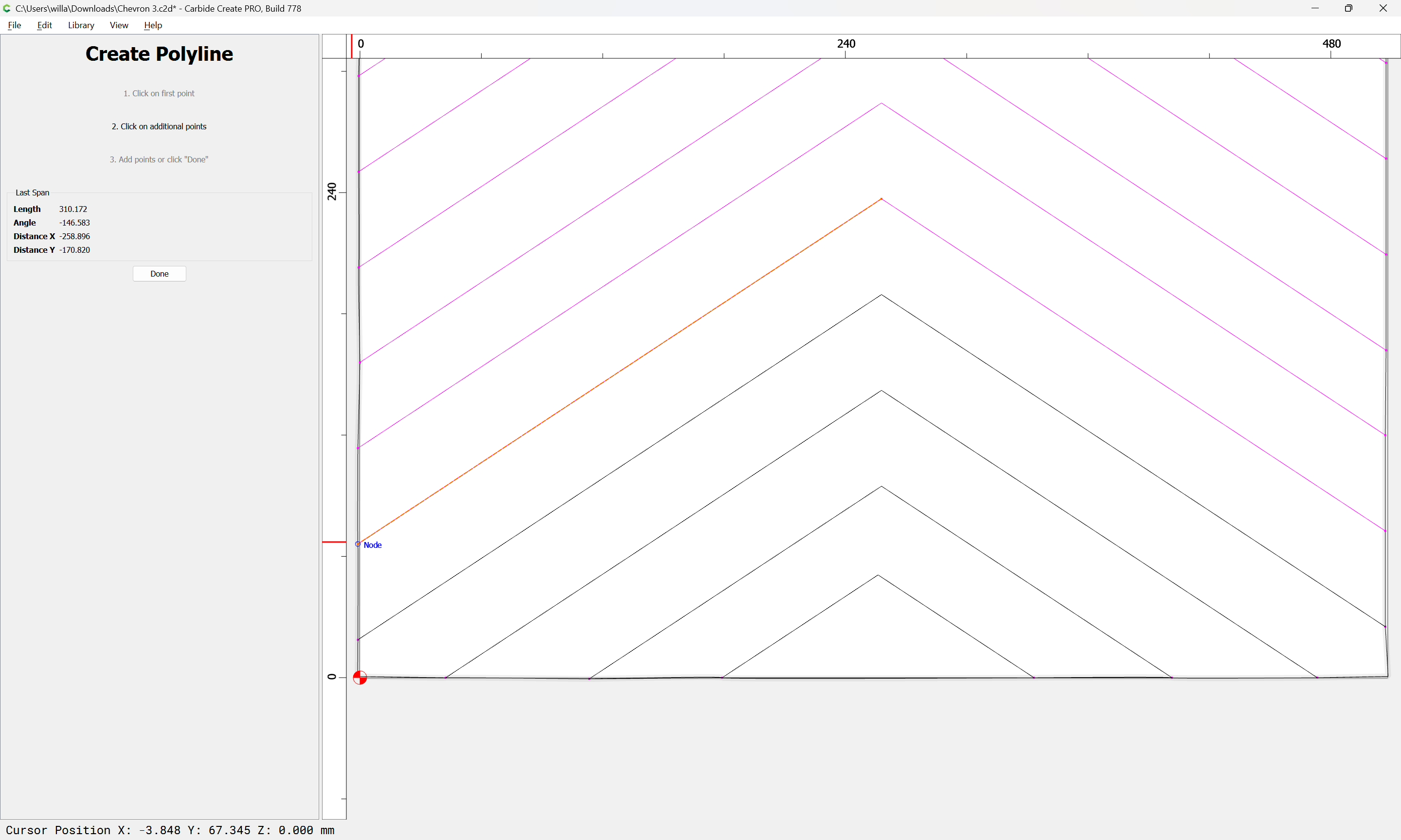

I am trying to create a Chevron and learn about vectors. I downloaded this Chevron, but it had a bunch of open vectors. I tried drawing a poly line around the border and adding nodes as each intersection of the poly.

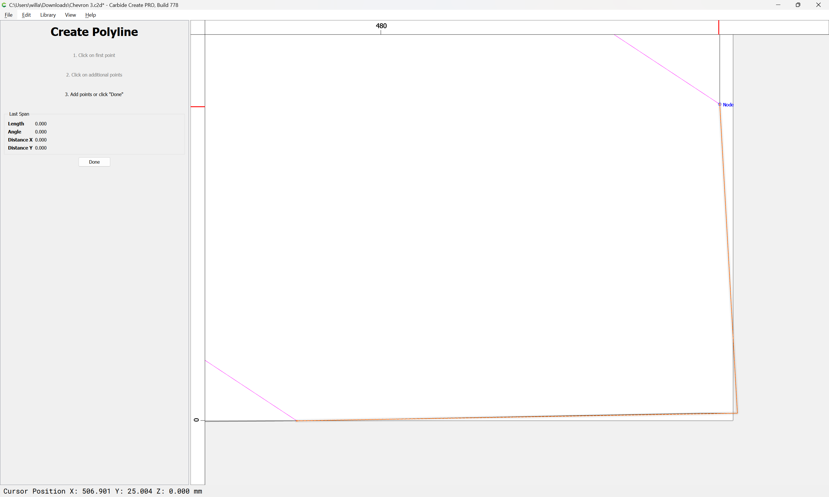

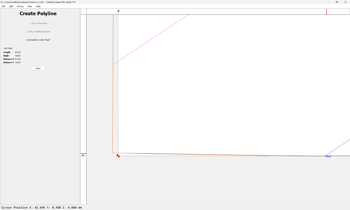

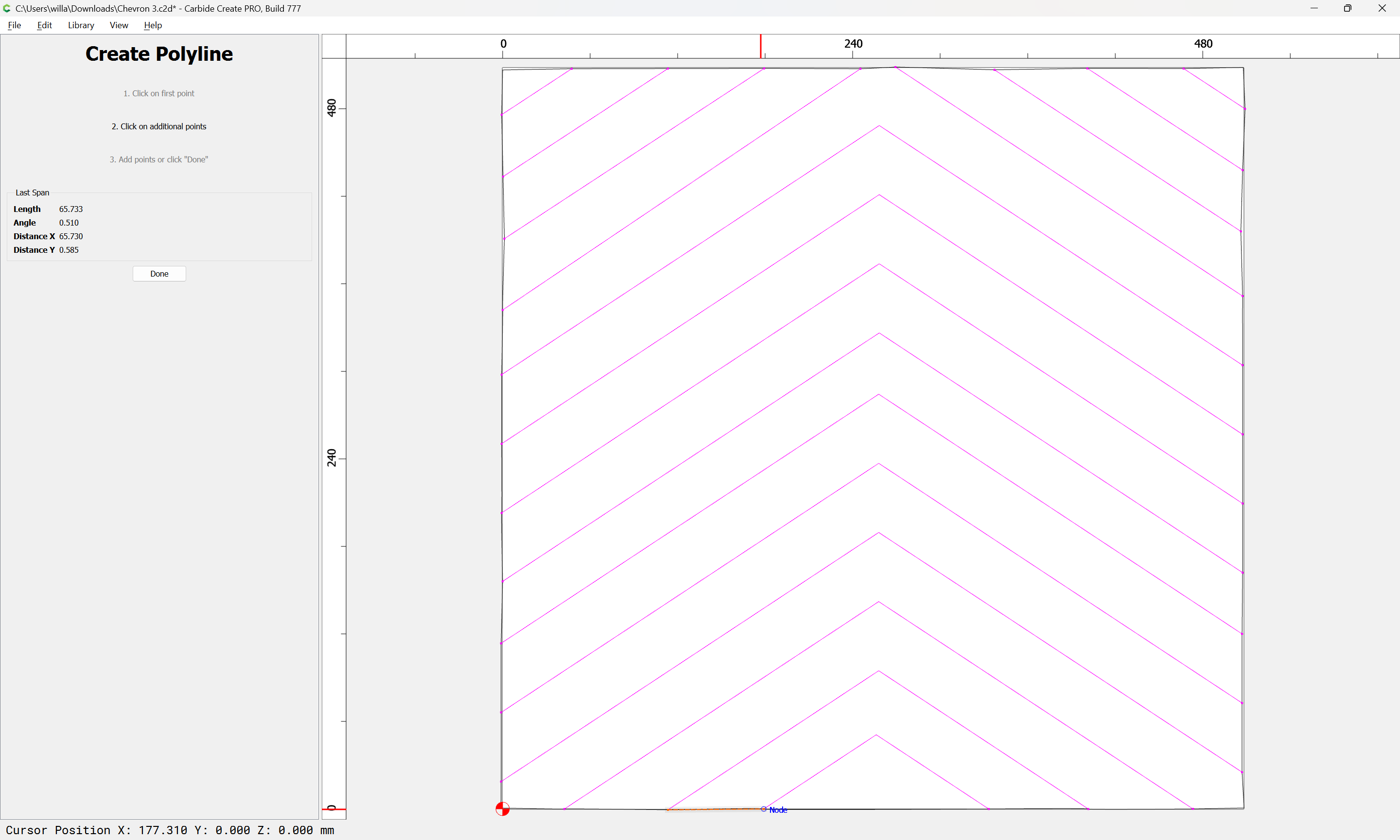

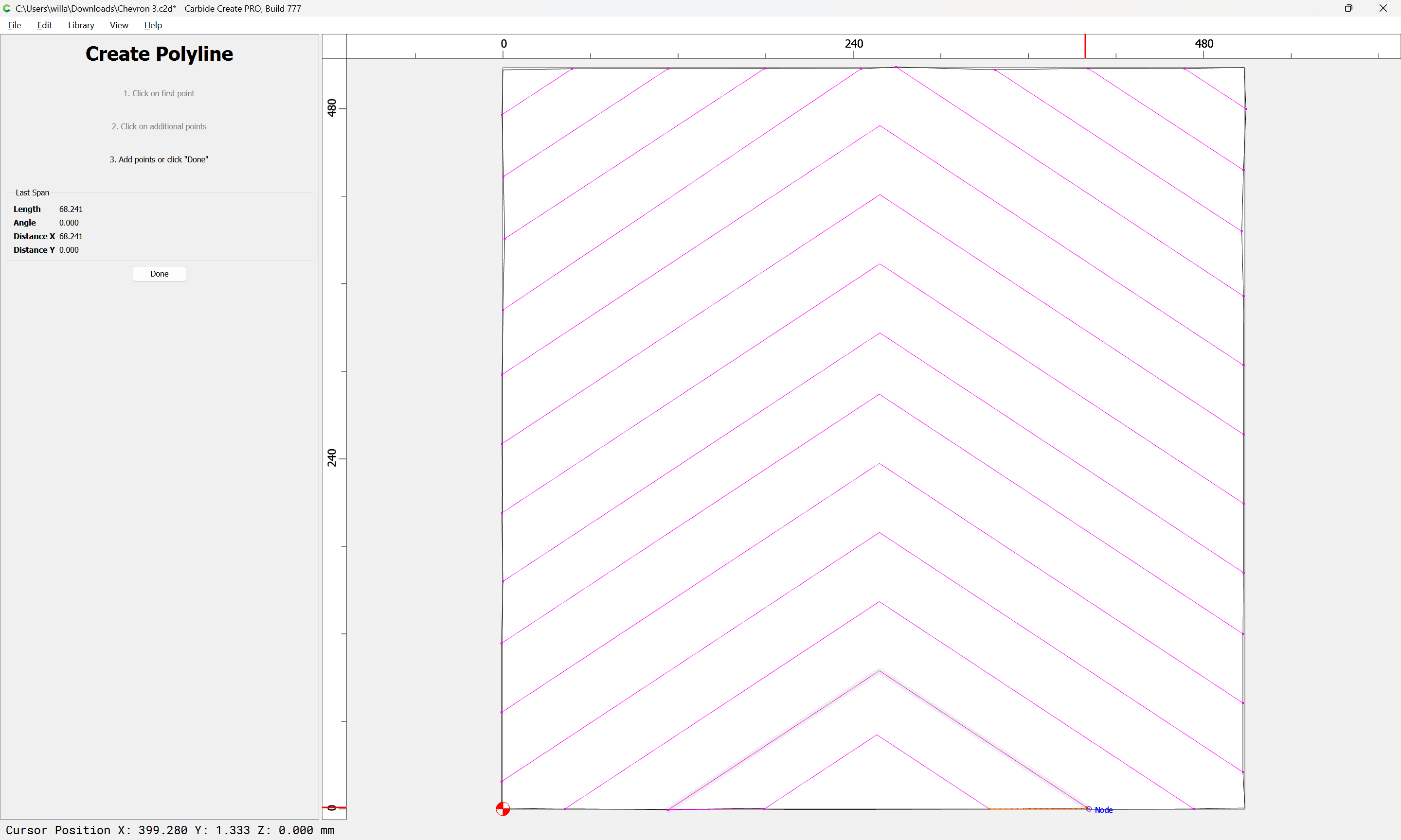

I still have open vectors. When I tried the join vectors, it does not join it to my poly line as i expected. Sometimes it draws a horizonal line across the workspace – creating a triangle.
How do i get it to join my slated lines for the chevron with the poly line (border)?
Chevron 3.c2d (56 KB)

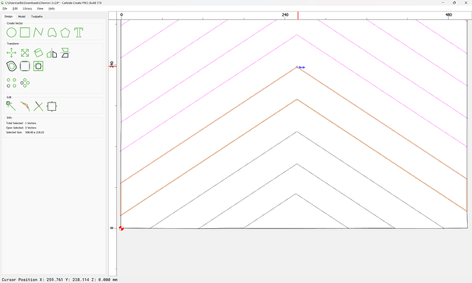

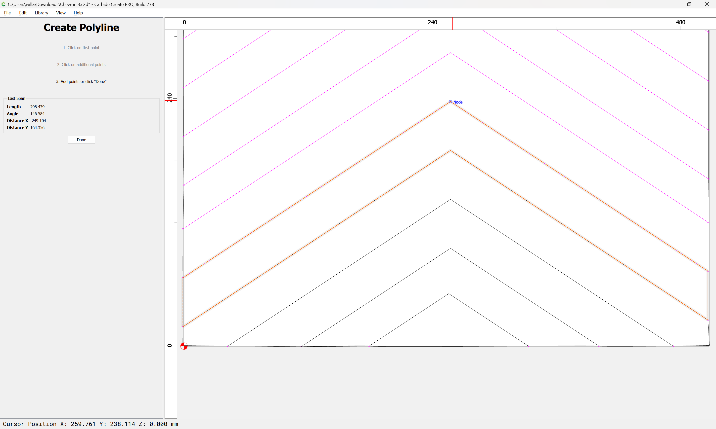

How do you plan to cut this? You can use a contour path with no offset to follow an open vector.
If you are going to cut out every other stripe, then you’ll want to join 2 chevrons with vertical lines on the ends, then the next 2, etc…

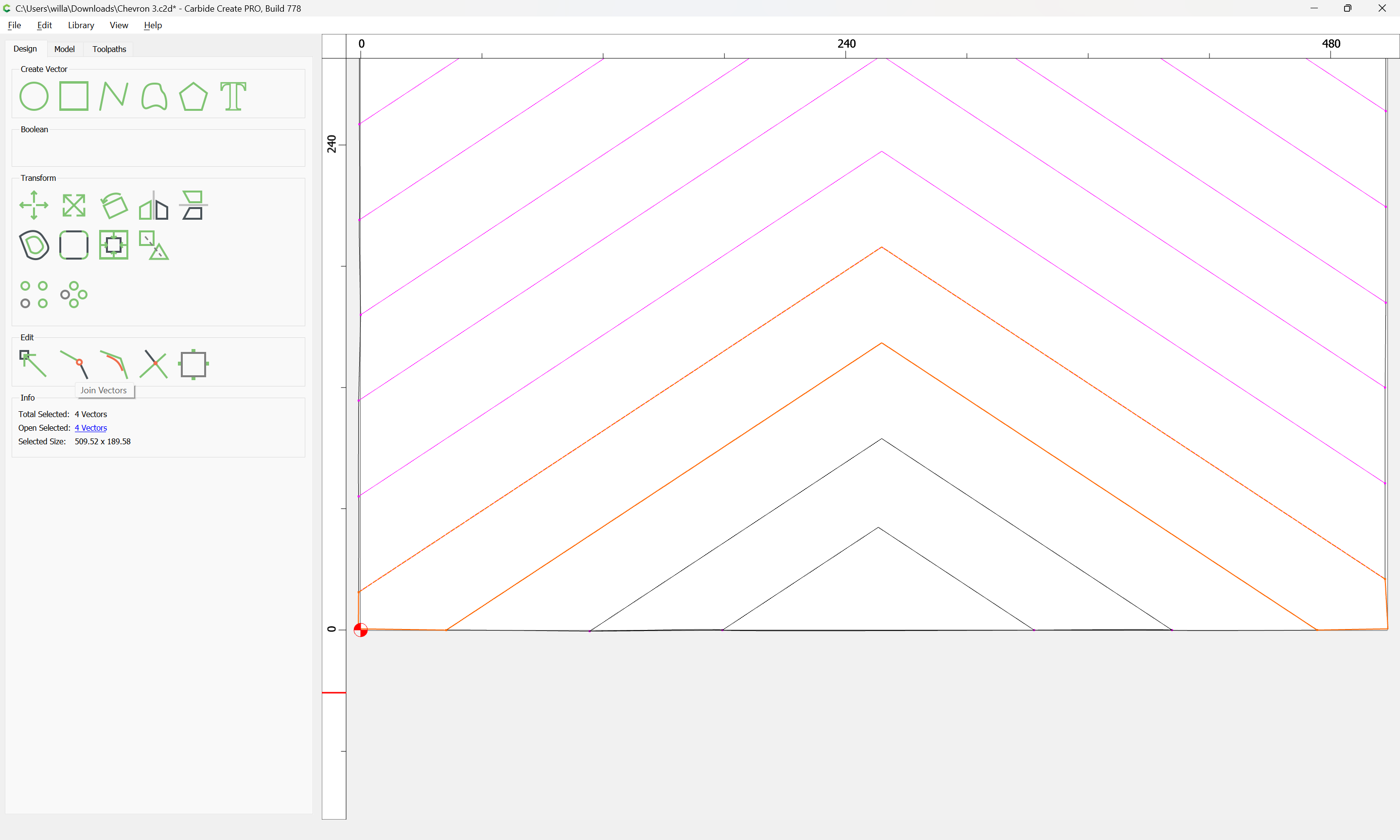

For each section you will need to duplicate the geometry:
draw in the missing line(s):

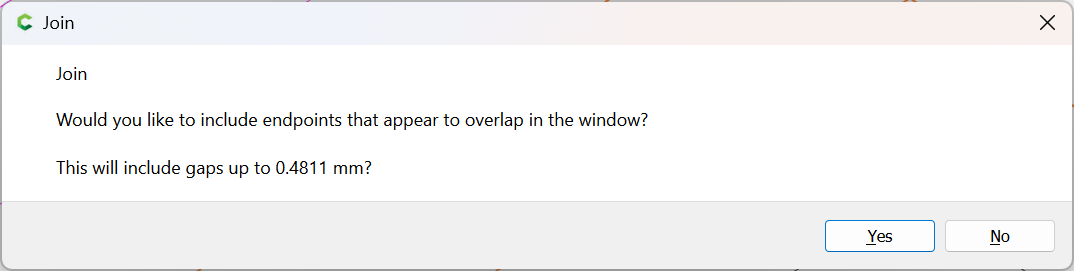

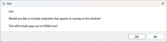

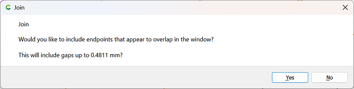

and then you can use Join Vectors:

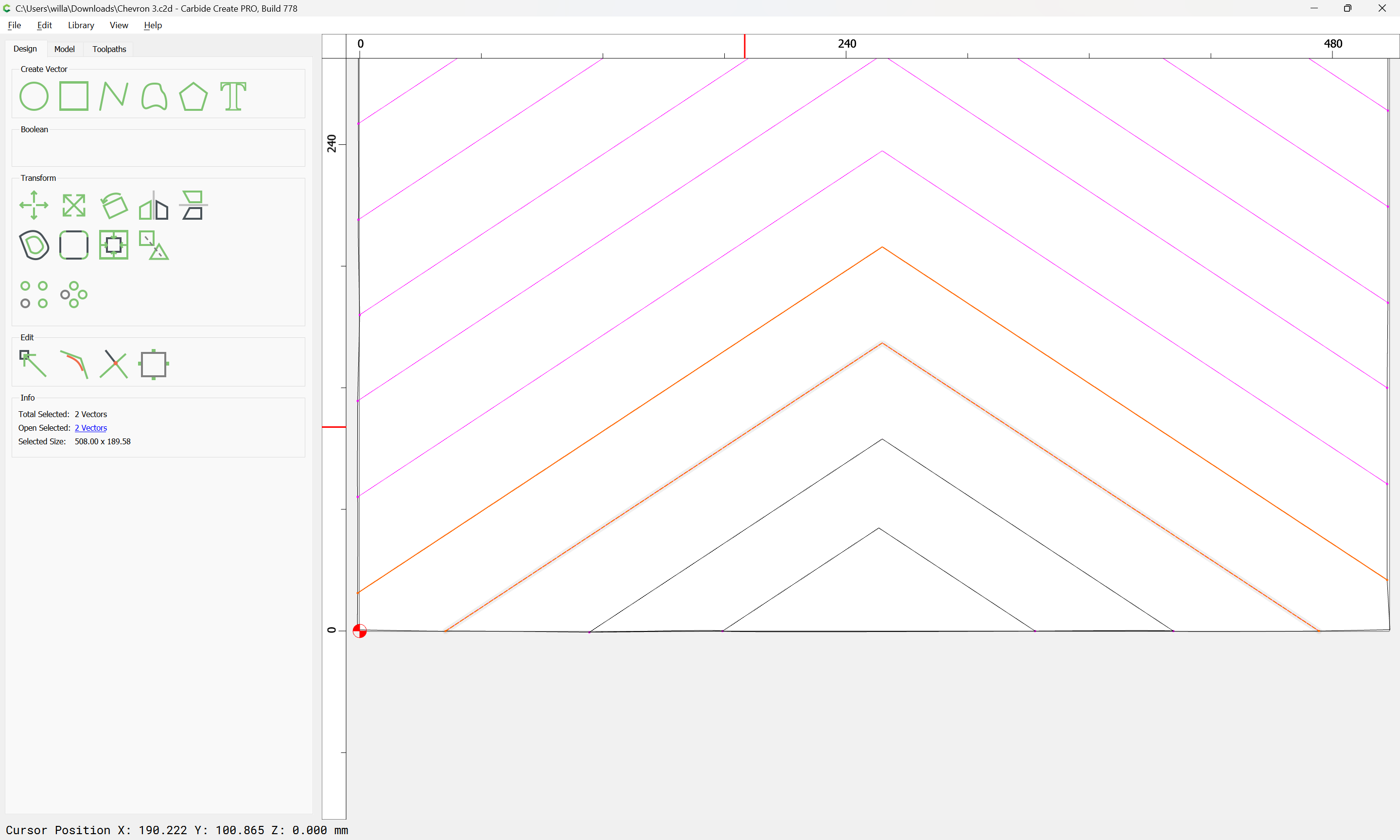

Yes
Repeat for the balance:

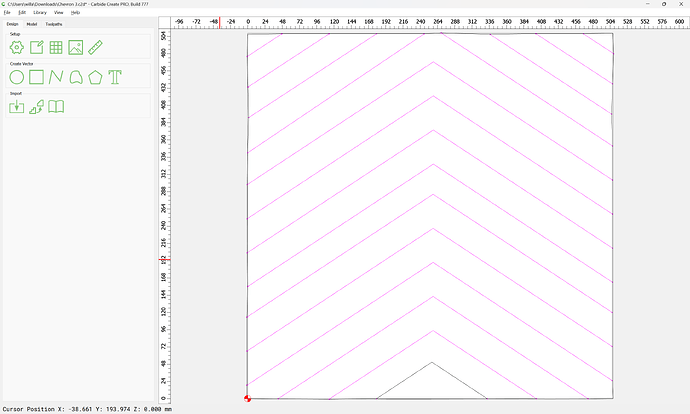

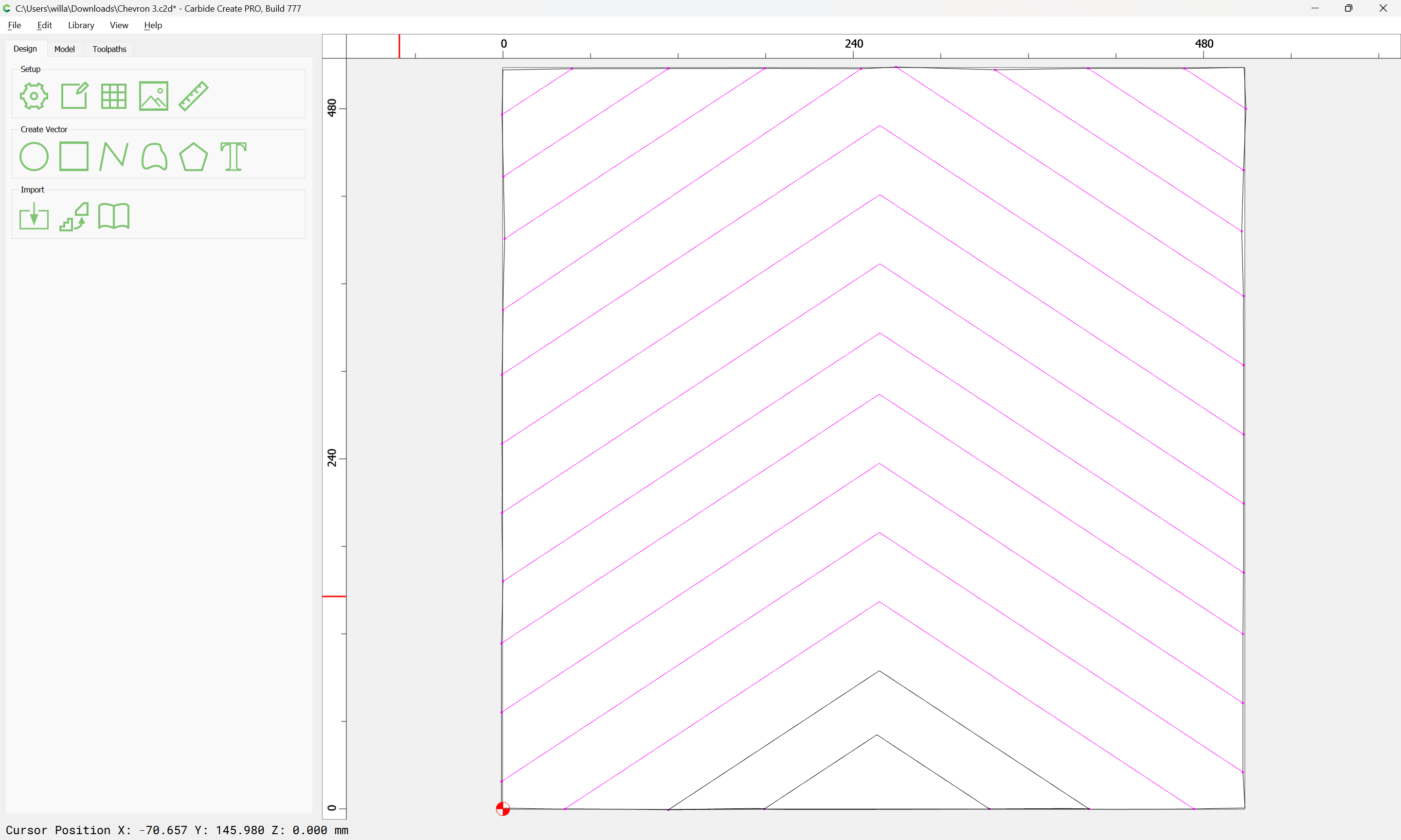

I was going to use it for a background. The Boolean is not working because of the open vectors.
Will,

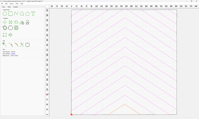

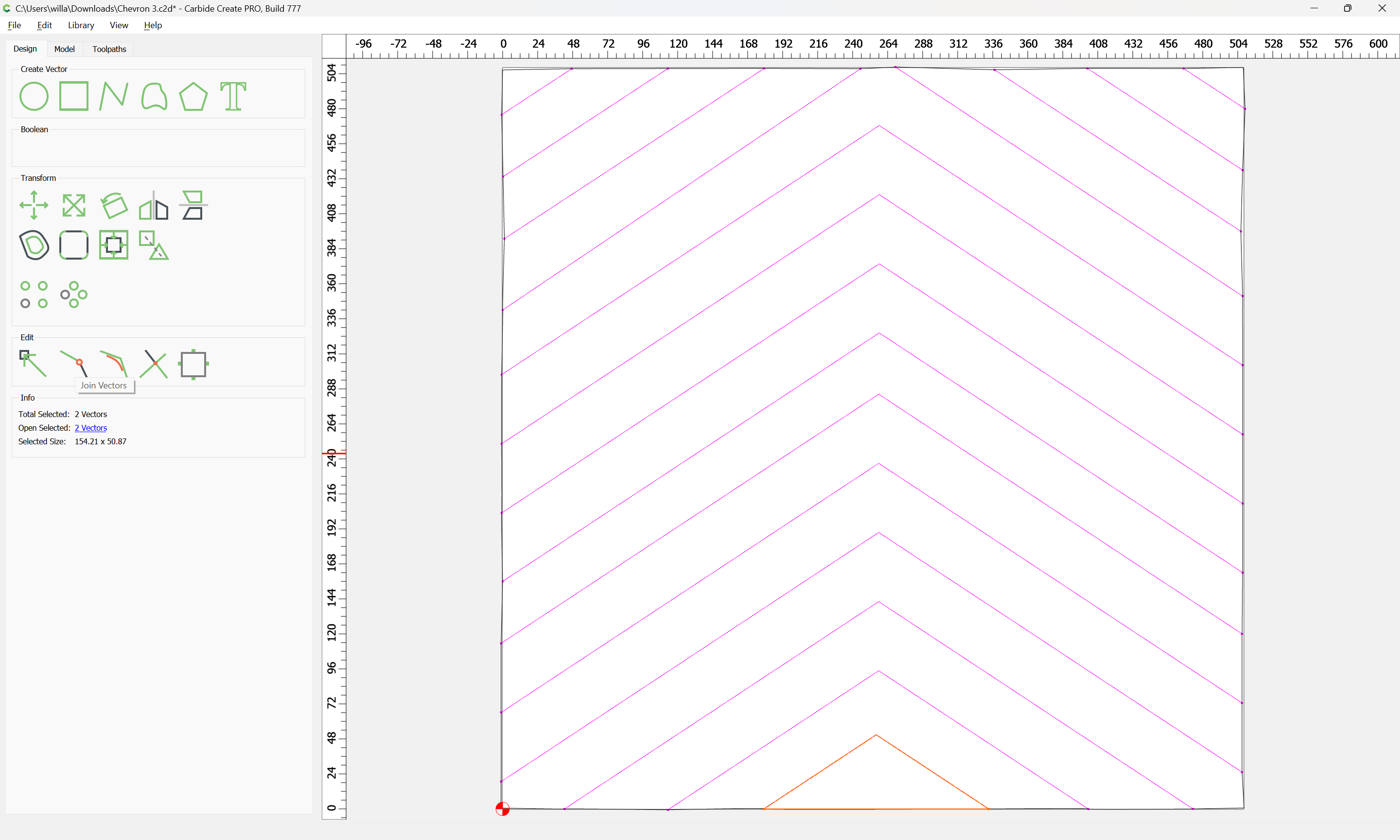

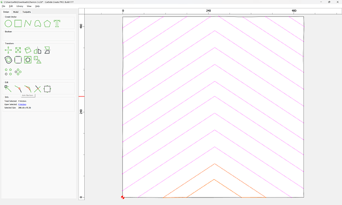

I apologize, but I have looked at this a few times and I can’t seem to follow it. When you say duplicate geometry – are you talking a simple copy / paste? I am having trouble making the connection as to why this allows me to draw a line (opposed to adding a line to the existing).

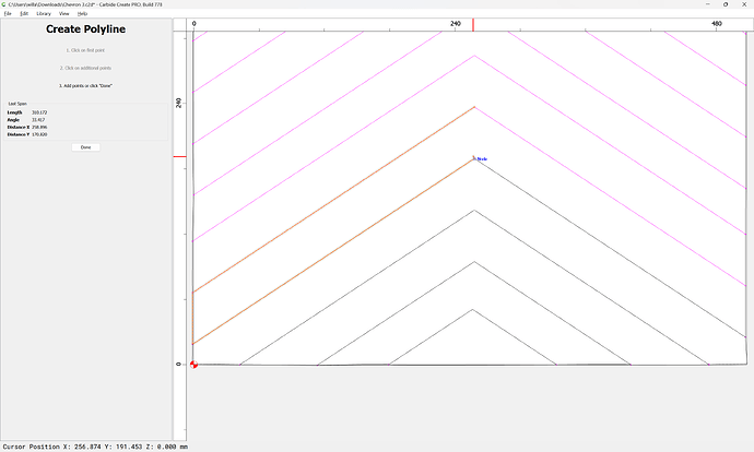

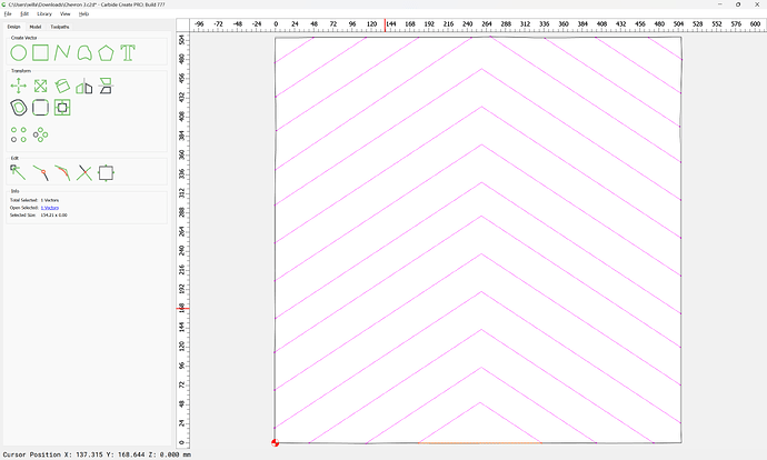

The slanted lines that touch the bottom of the drawing can be joined – if I tell it to join, it adds a line along the bottom.
What am I joining the sides to?
I was hoping slanted lines could be joined with my outside perimeter line. Is that not possible. I guess I need to watch a good video on Vectors and Nodes.
Thanks

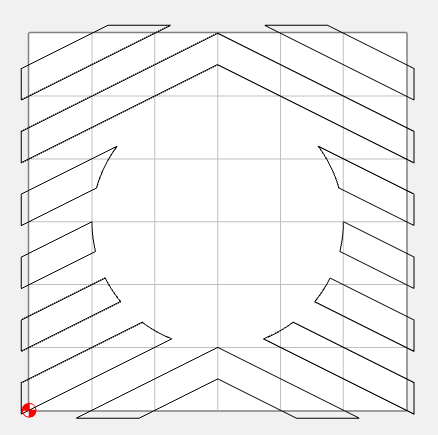

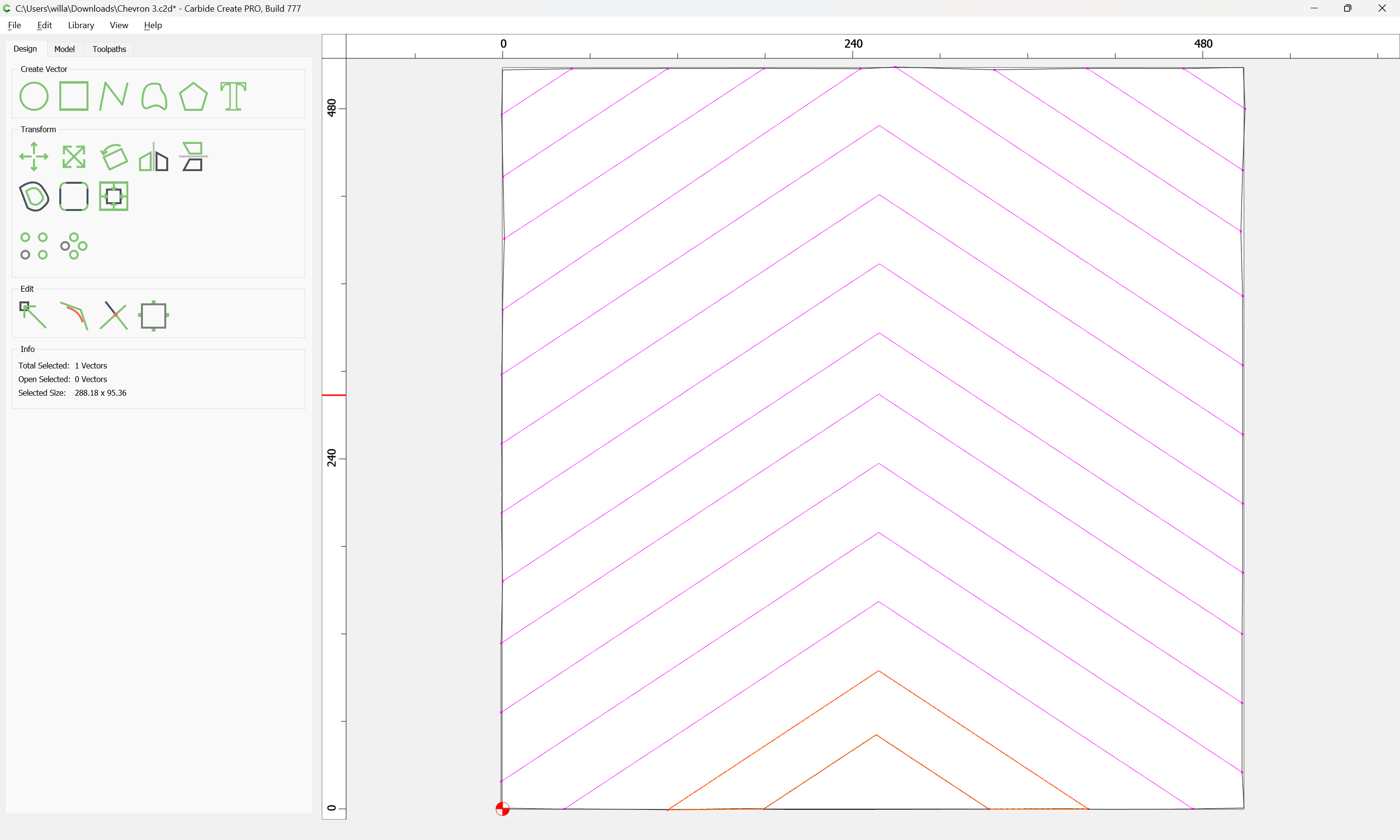

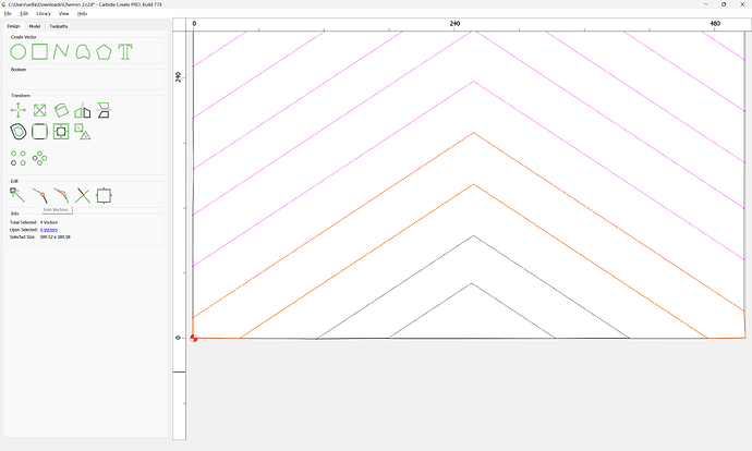

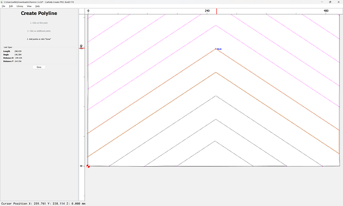

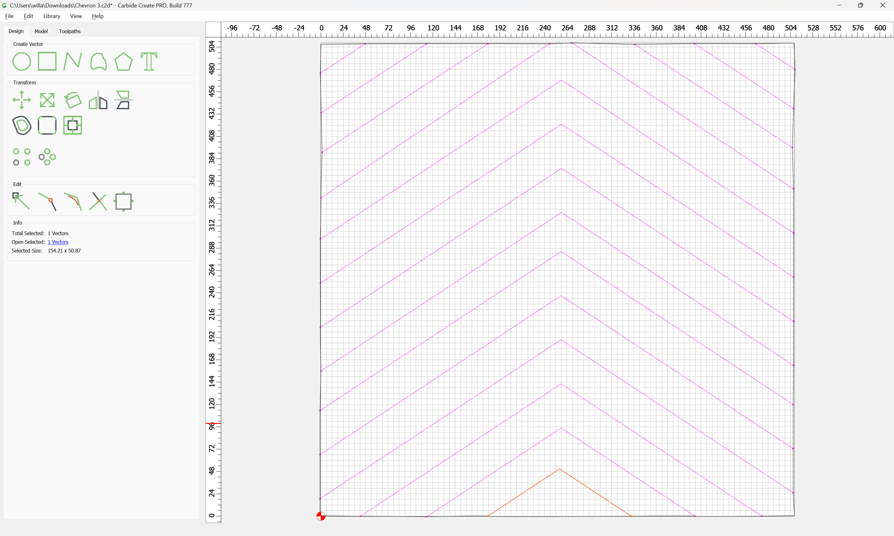

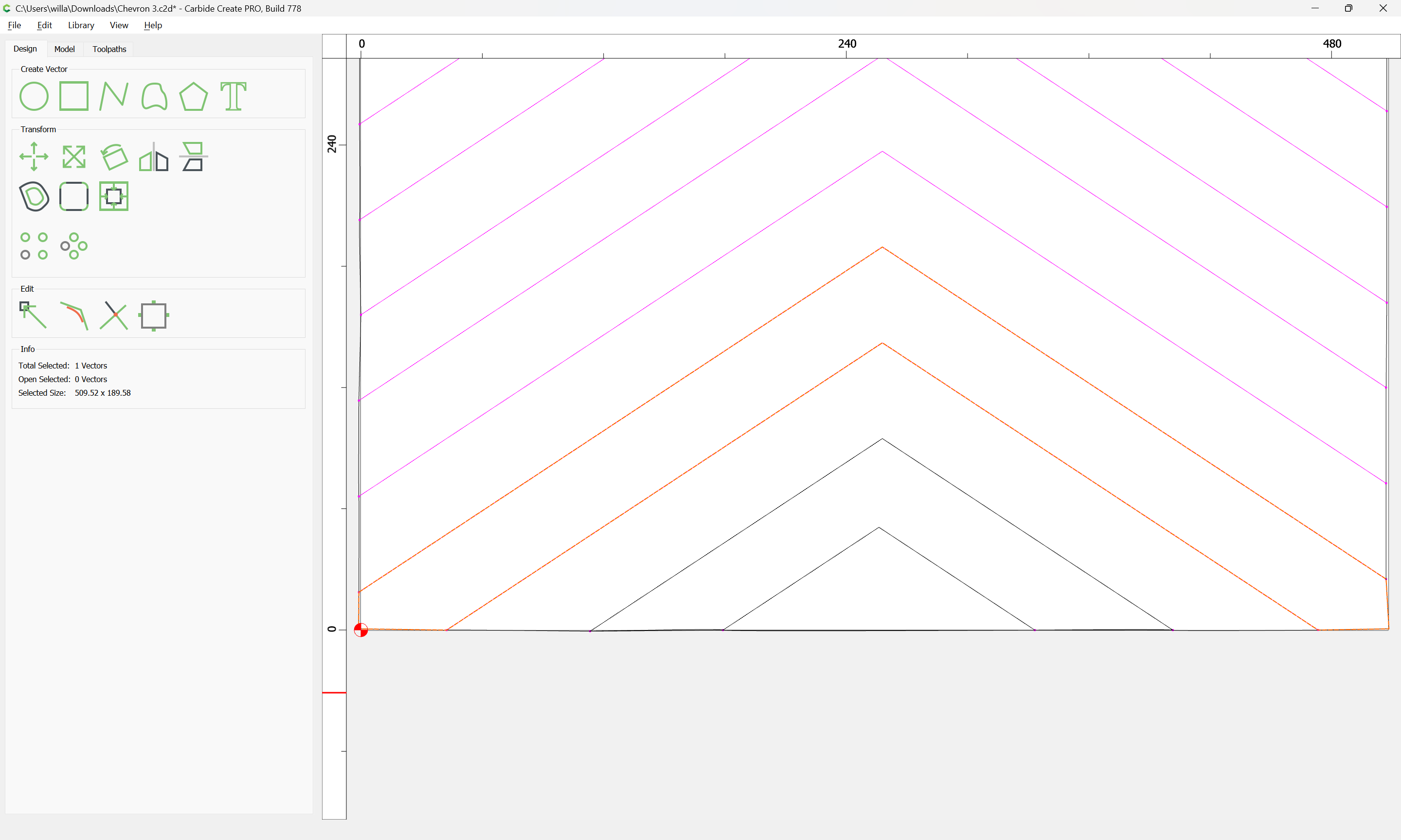

For each chevron, you have a top and bottom:
You need to draw in the balance of the geometry:
Then select all the geometry for a given chevron:
and use Join Vectors to close it:
Yes

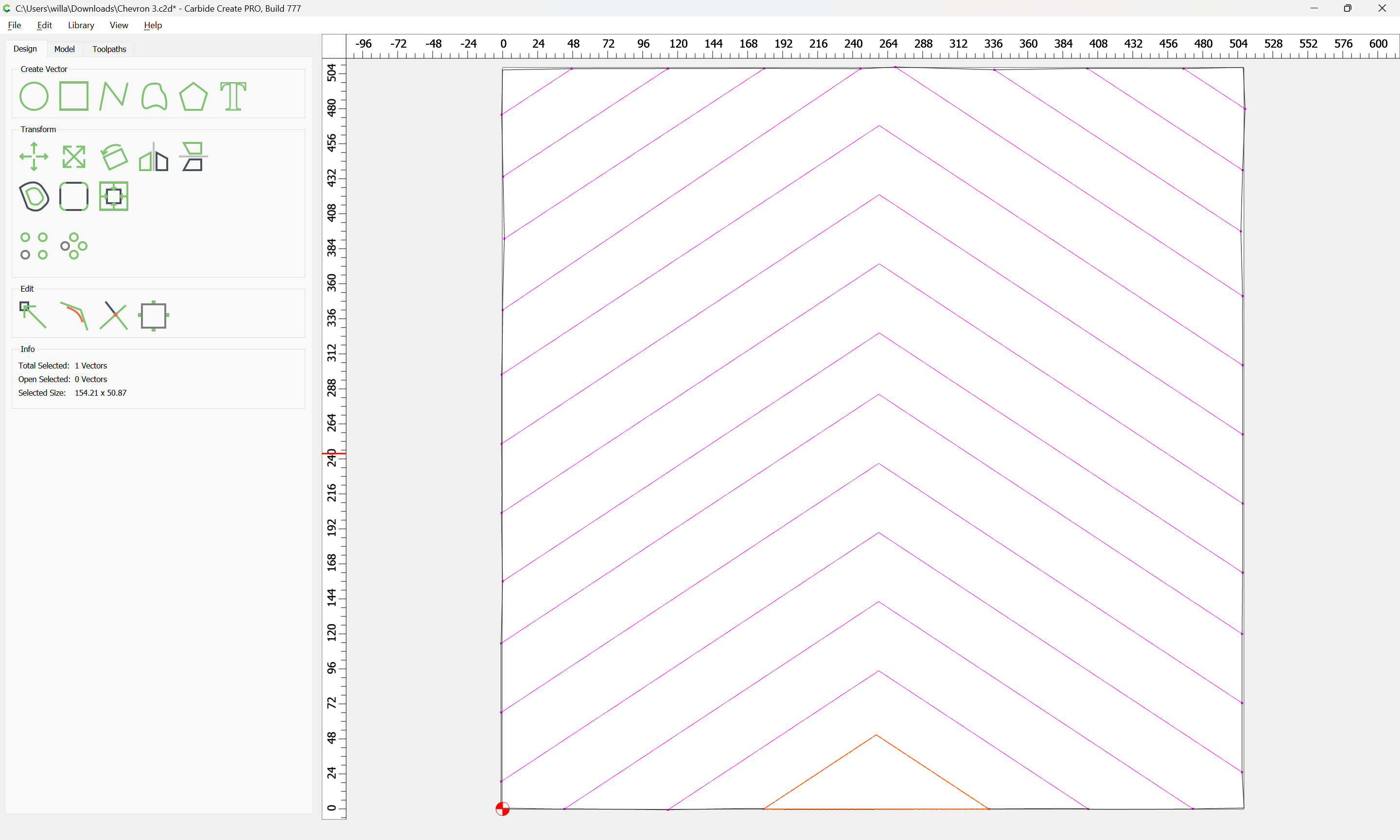

Alternately, you can just draw in the entire chevron:
Here’s a version with closed geometry:
Chevron 3_v7.c2d (56 KB)
Got it!! THANK YOU! Thanks for the file. I tried a few in my file to make sure I understood and it worked. Thank you.

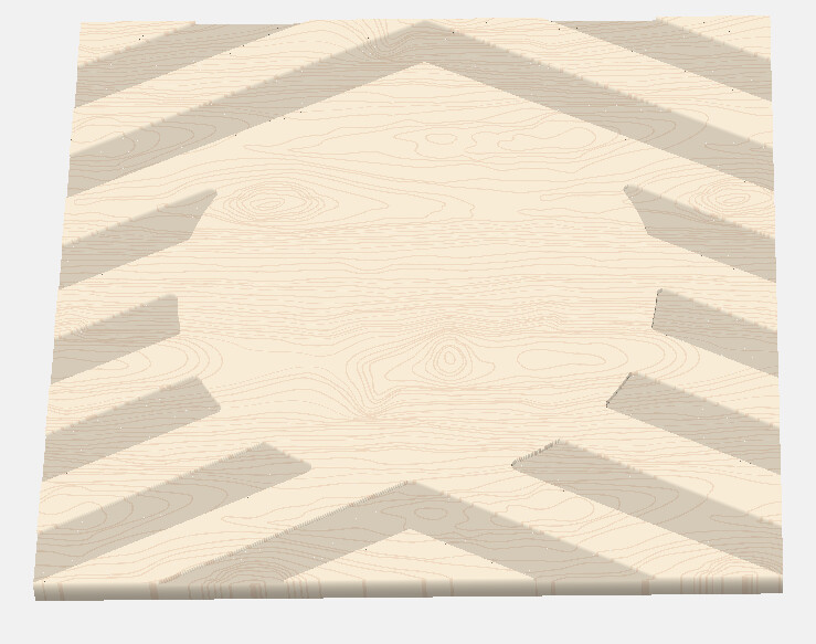

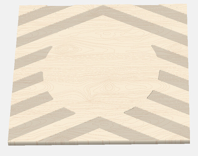

The idea was those shapes were the background. I wanted to use Booleen to prevent the background from cutting overtop the foreground image.
That didn’t work – apparently too many shapes and it Booleen gets confused. I had a support call. We had all the vectors closed – but (as you stated) we ended up with several individual shapes. The booleen could not handle having 8-10 shapes as the background and there was no way to join all those into a single image for the background.

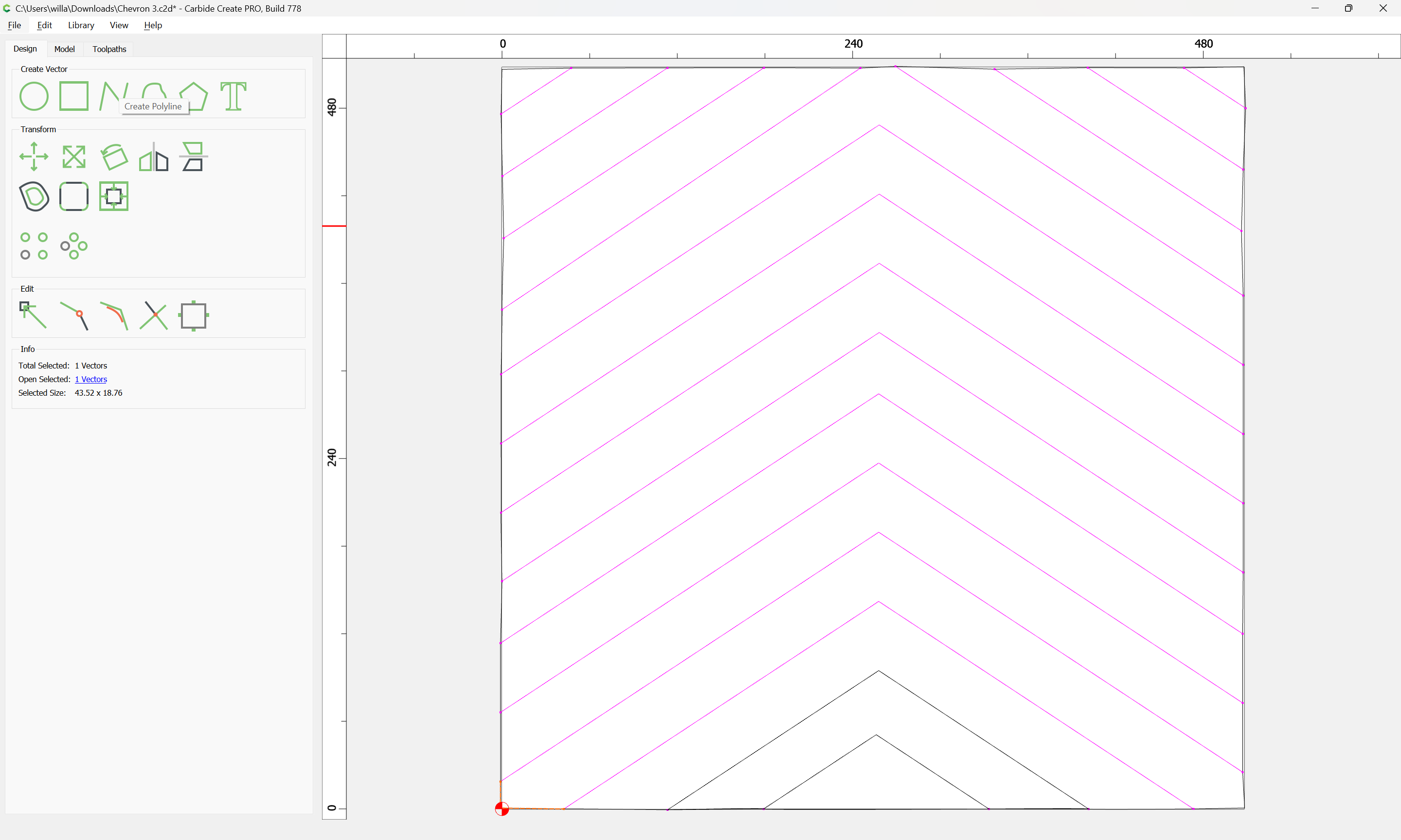

Something like this?
In this case, the chevrons are not adjacent, right next to each other. Every other pair of vectors is joined to make a chevron with an equal space between them. Then the center shape is subtracted from each chevron.
Yes - that is what I am going for.
I created a file that joined every other line to make a chevron - with equal spaces between the chevrons (just like you said).
I had two images for the foreground image (Antlers). I grouped the foreground images and (separately), I grouped the chevrons. The Booleen would never do for me what you are showing here – it would remove (seemingly) random parts. I went through all the Booleen options. I tried selecting foreground image first and chevrons second. then I tried the reverse.
OK, so select all the chevrons & one of the antlers, and subtract
The chevrons should still be selected, so just shift-select the other antler, and subtract again

That worked!!! Unfortunate that my support rep didn’t know this. I appreciate your continued help on this post and finding this solution. This is very helpful.
Thanks Will. Good to know this approach as well.
