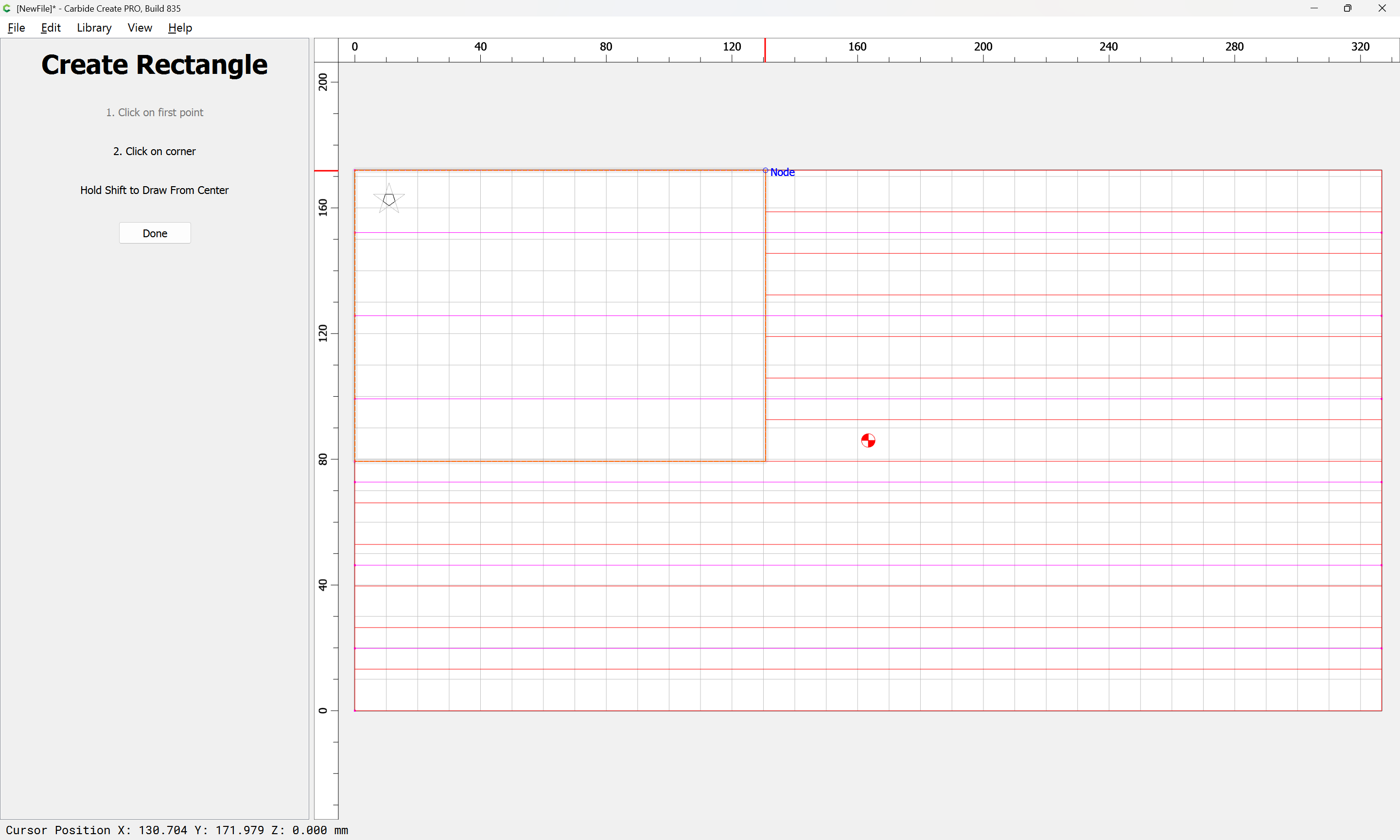

Since Carbide Create doesn’t do asymmetric scaling, and one can’t define an accurate 1/16" grid, one will need to delete the background rectangle and redraw an approximation of the area needed:

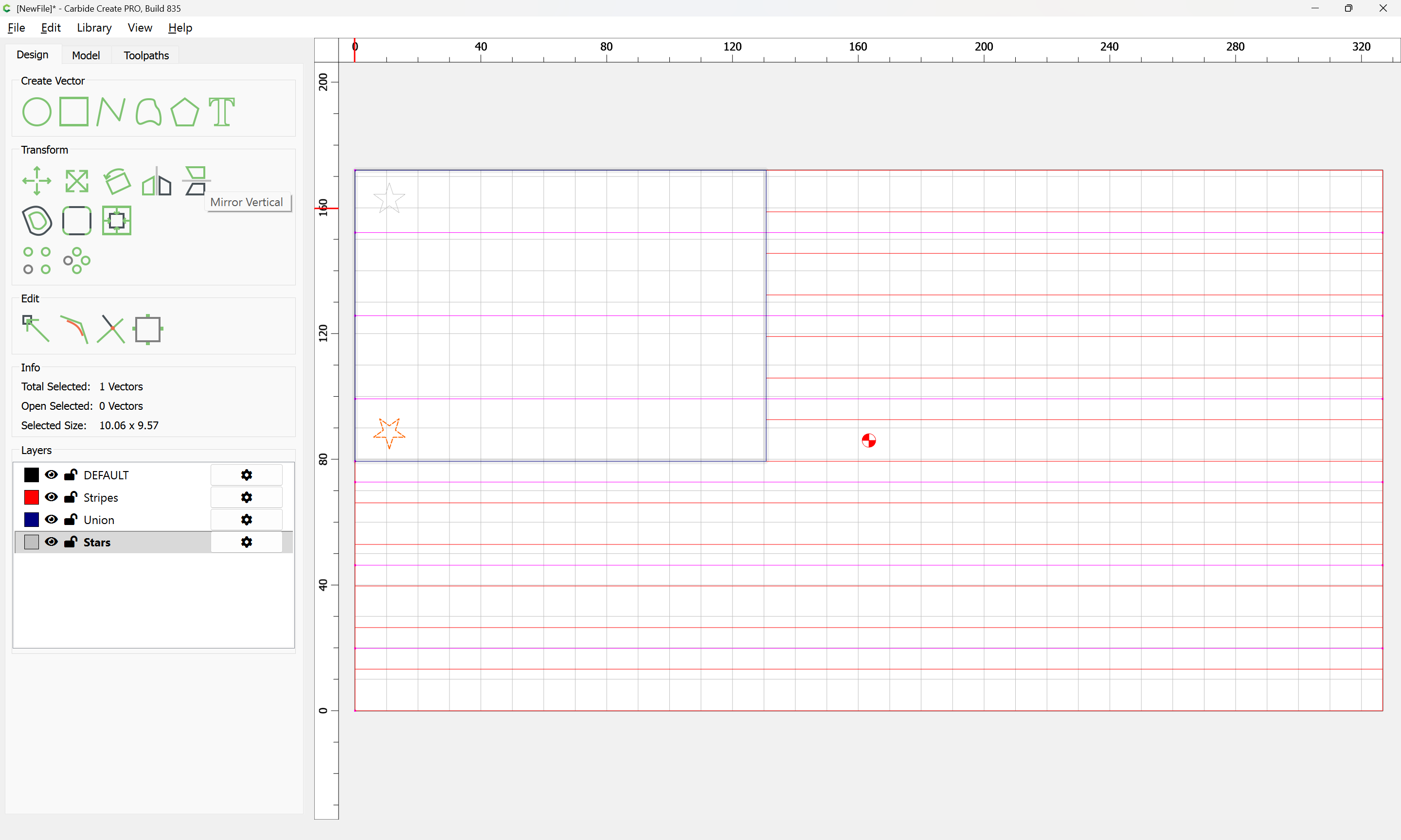

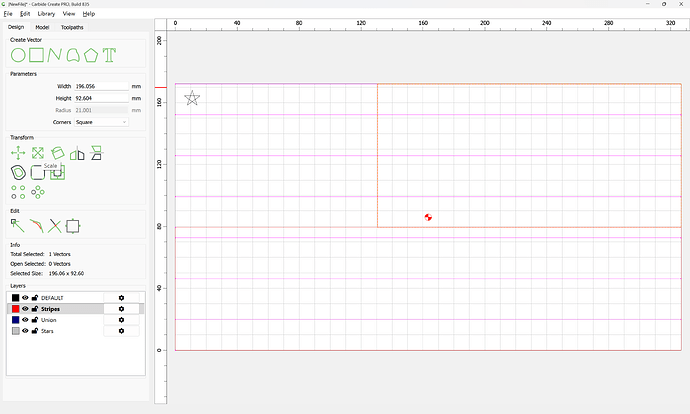

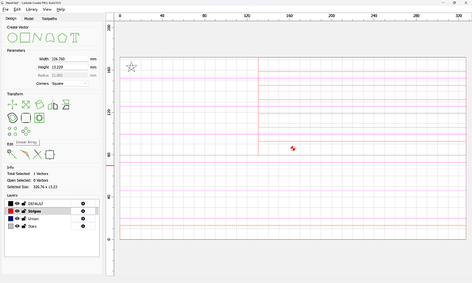

12

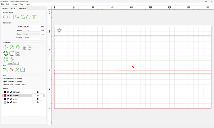

When downloaded from:
imports as:

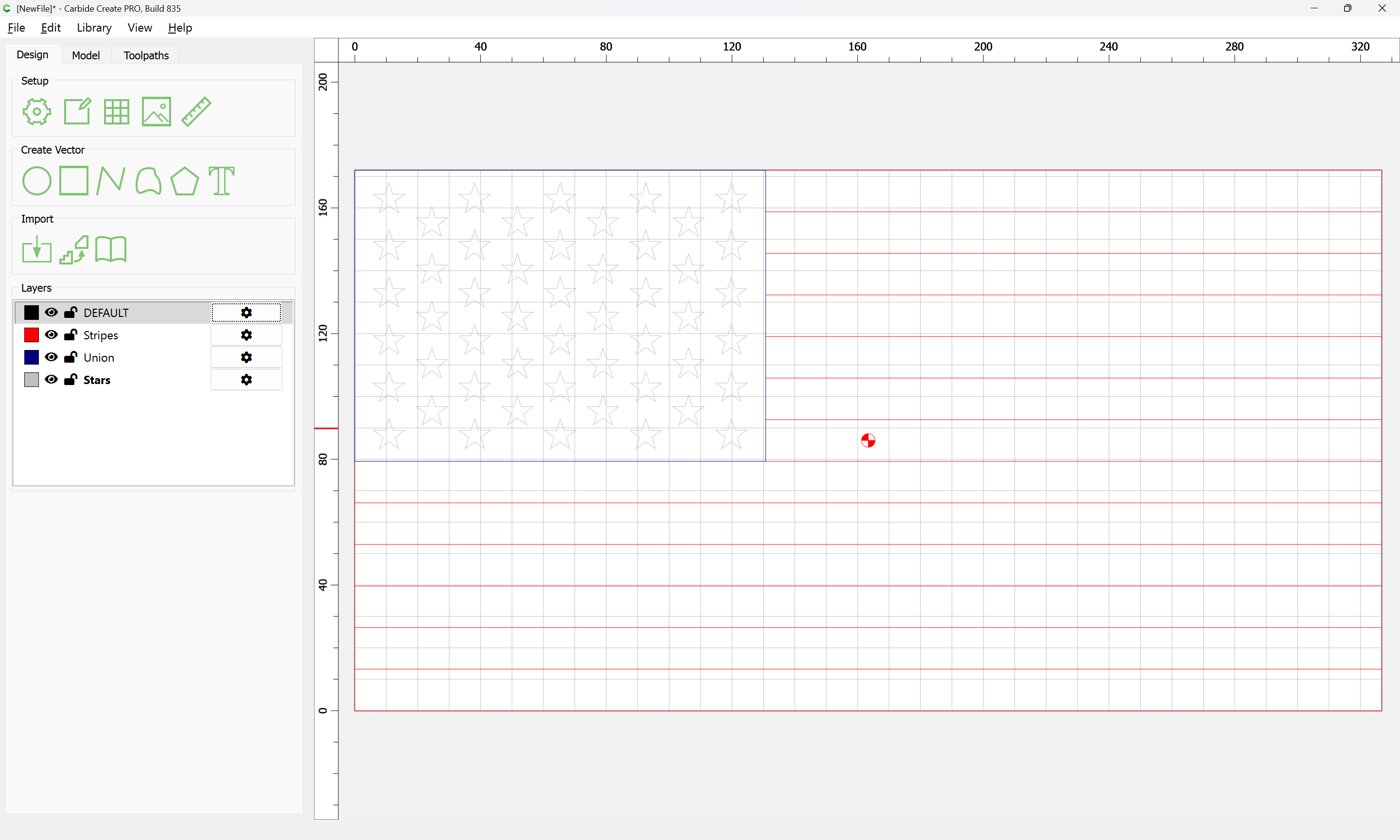

Fixing this is pretty straight-forward in newer versions of Carbide Create:

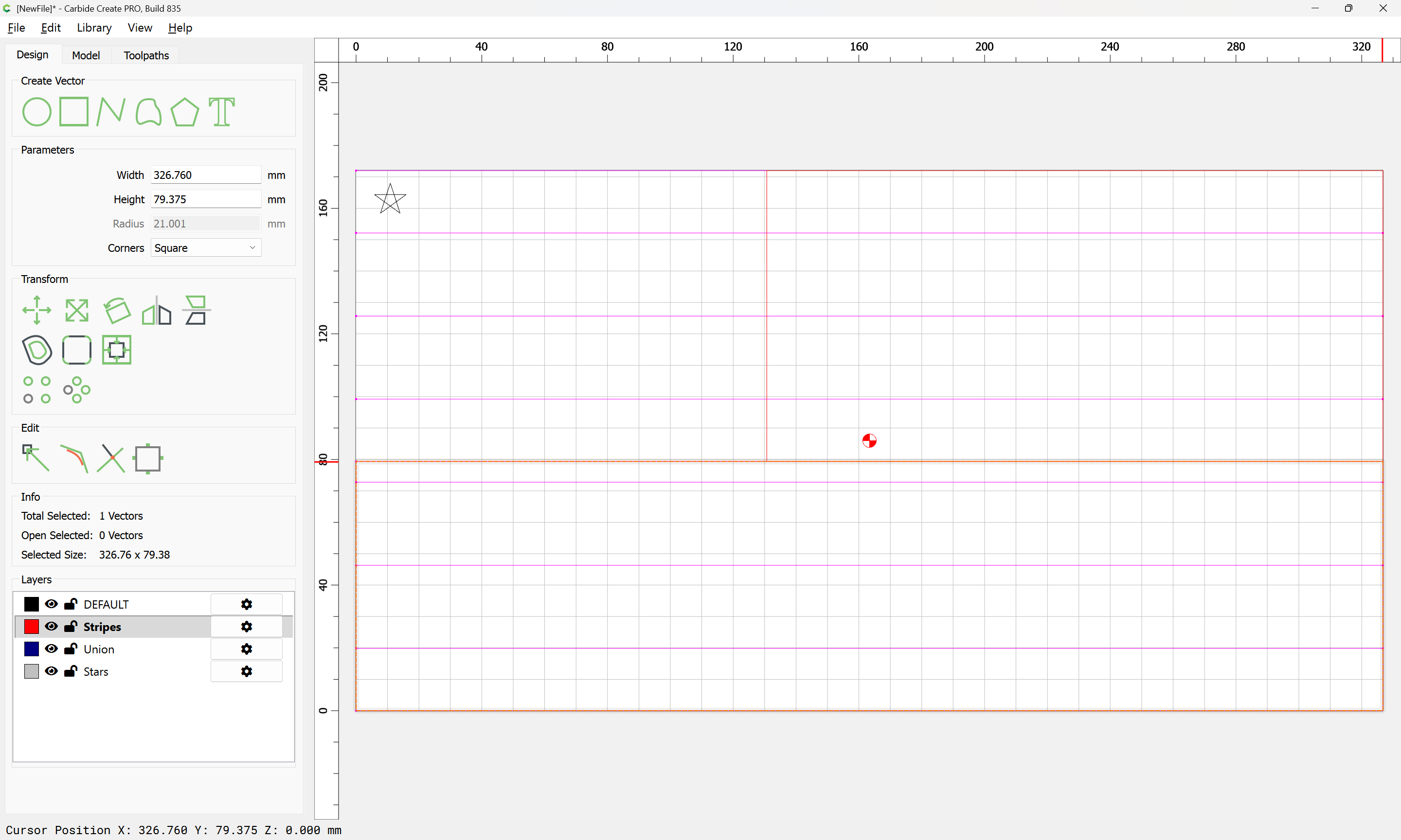

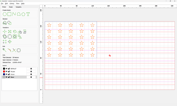

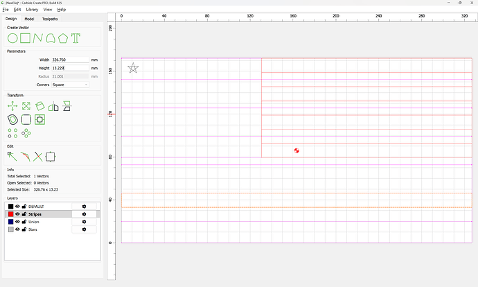

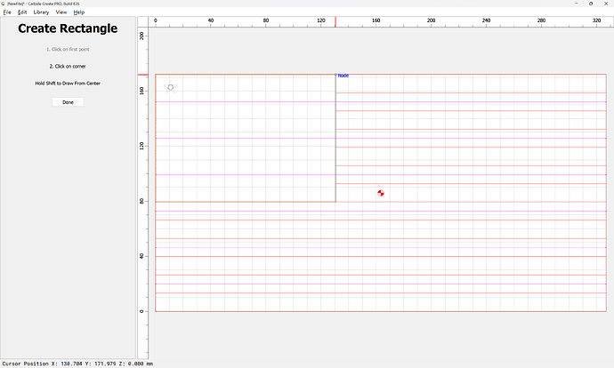

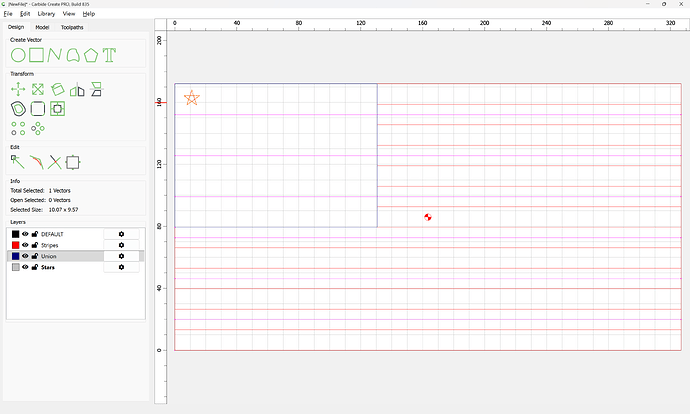

Create a new layer for each element:

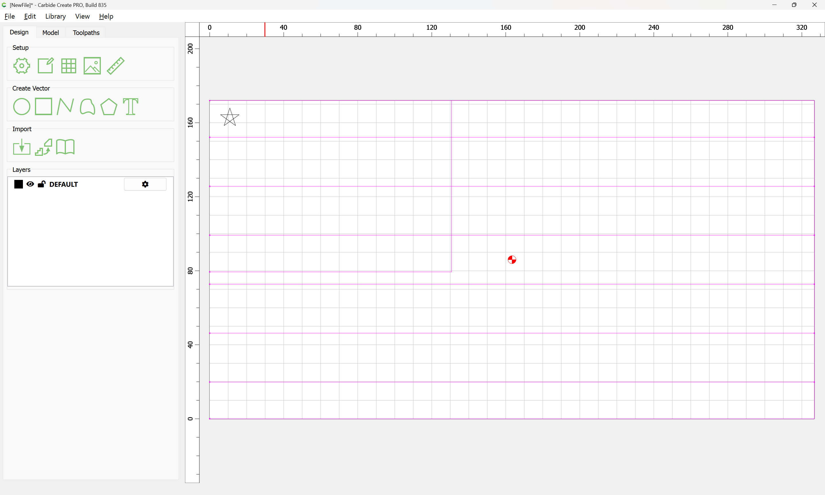

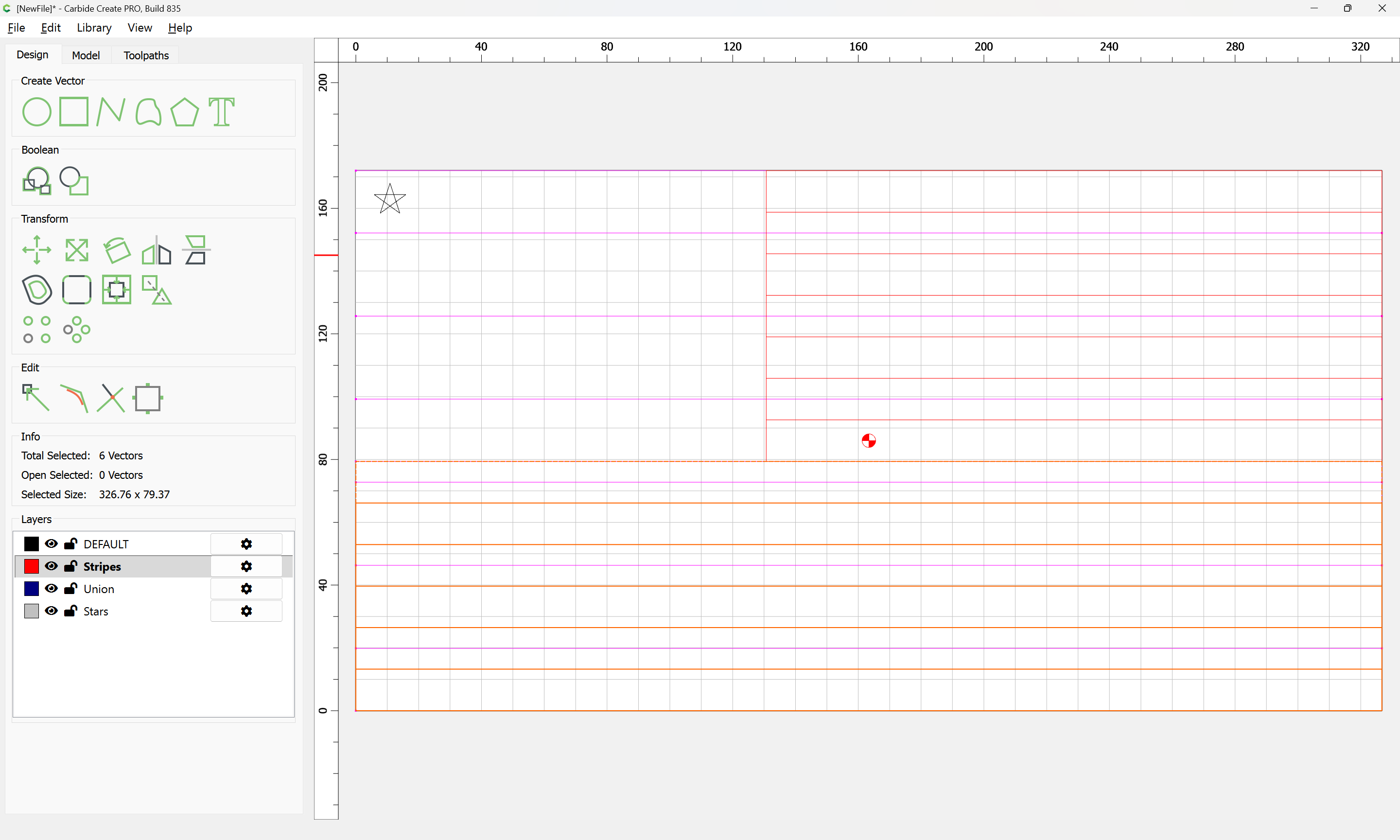

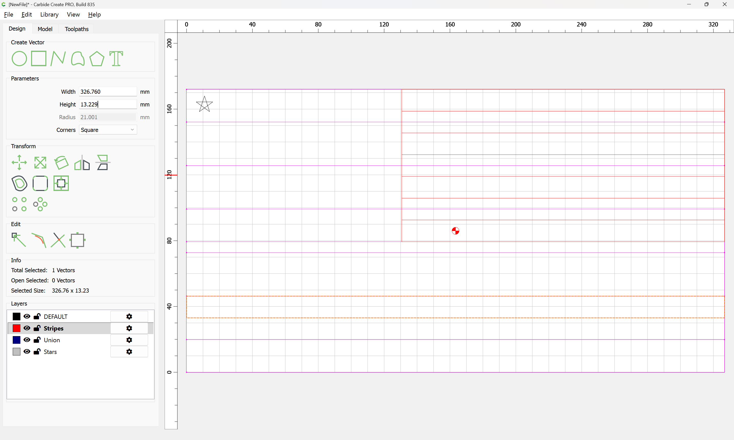

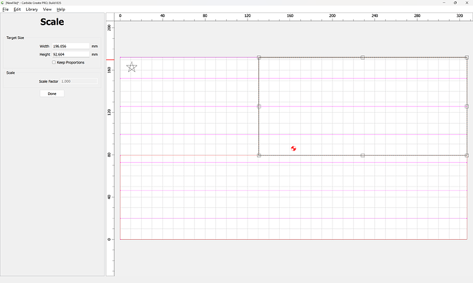

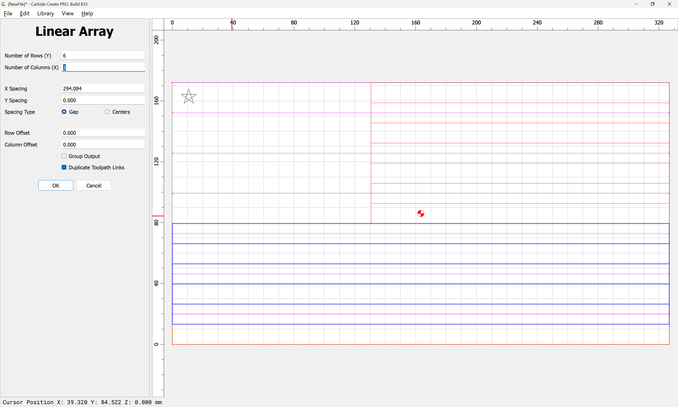

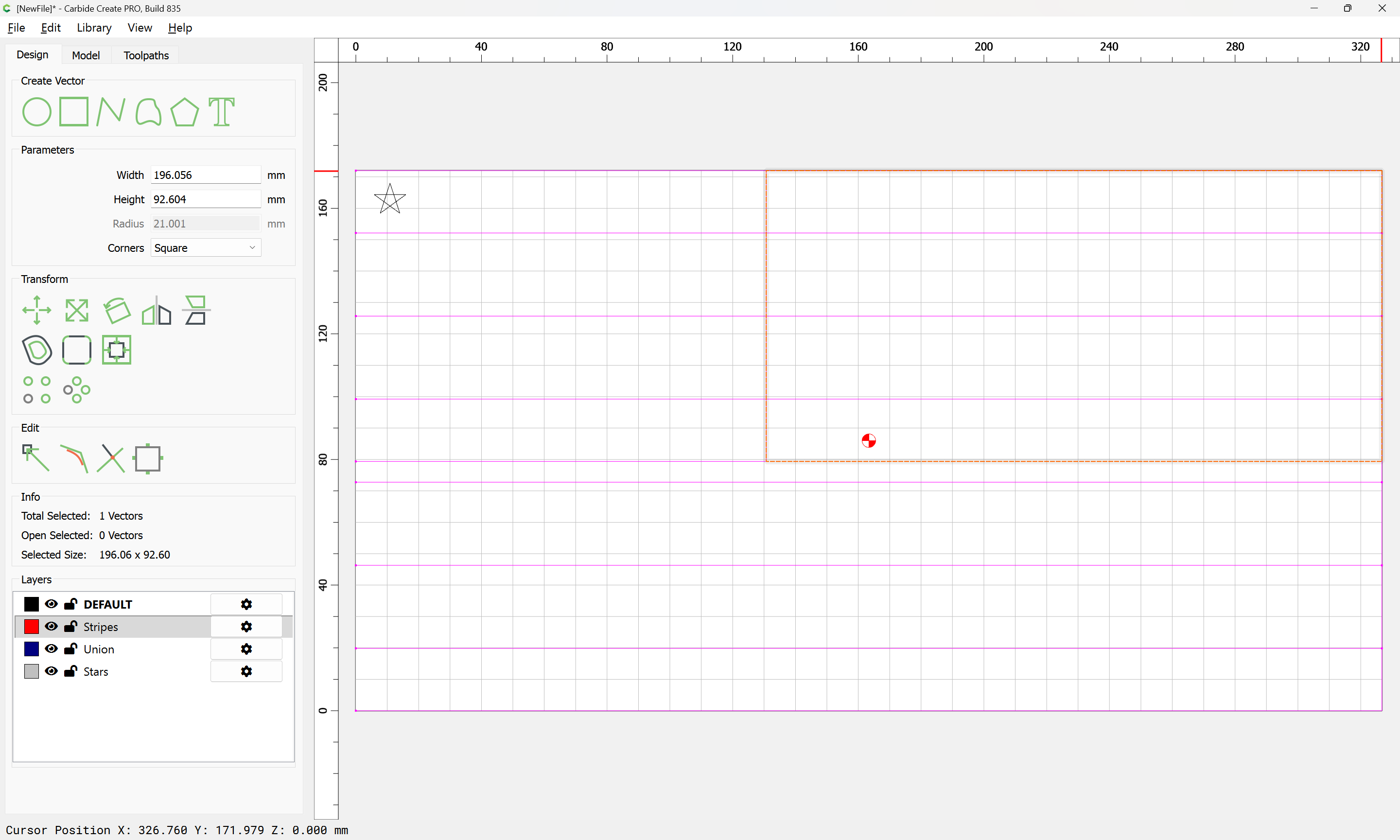

For the stripes, draw a rectangles for each length needed:

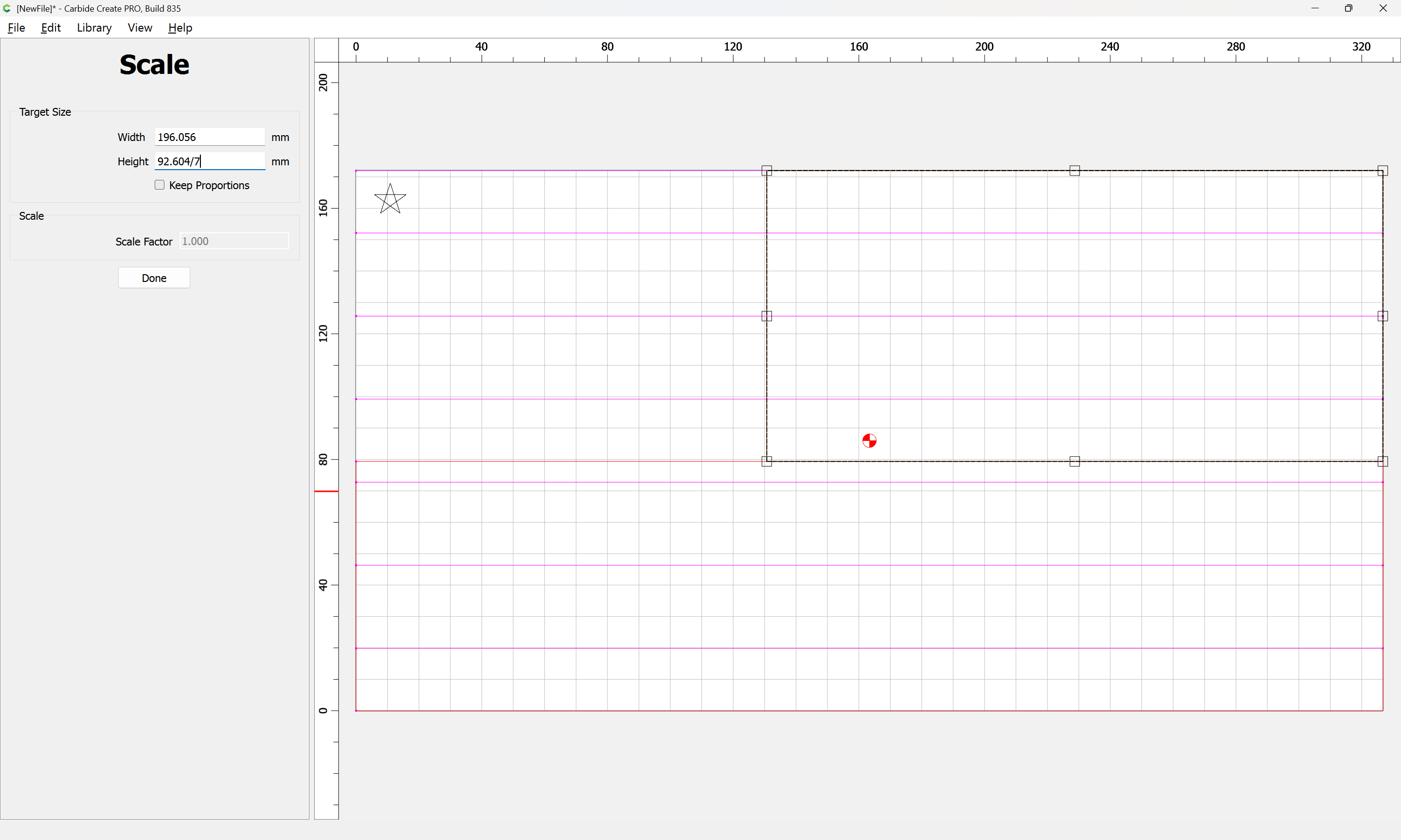

Count the number of stripes of each length and scale asymmetrically:
then drag into alignment:
and use Linear Array to replicate as needed:

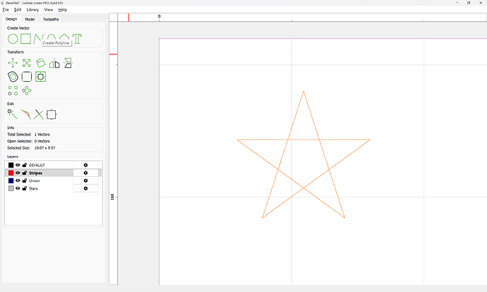

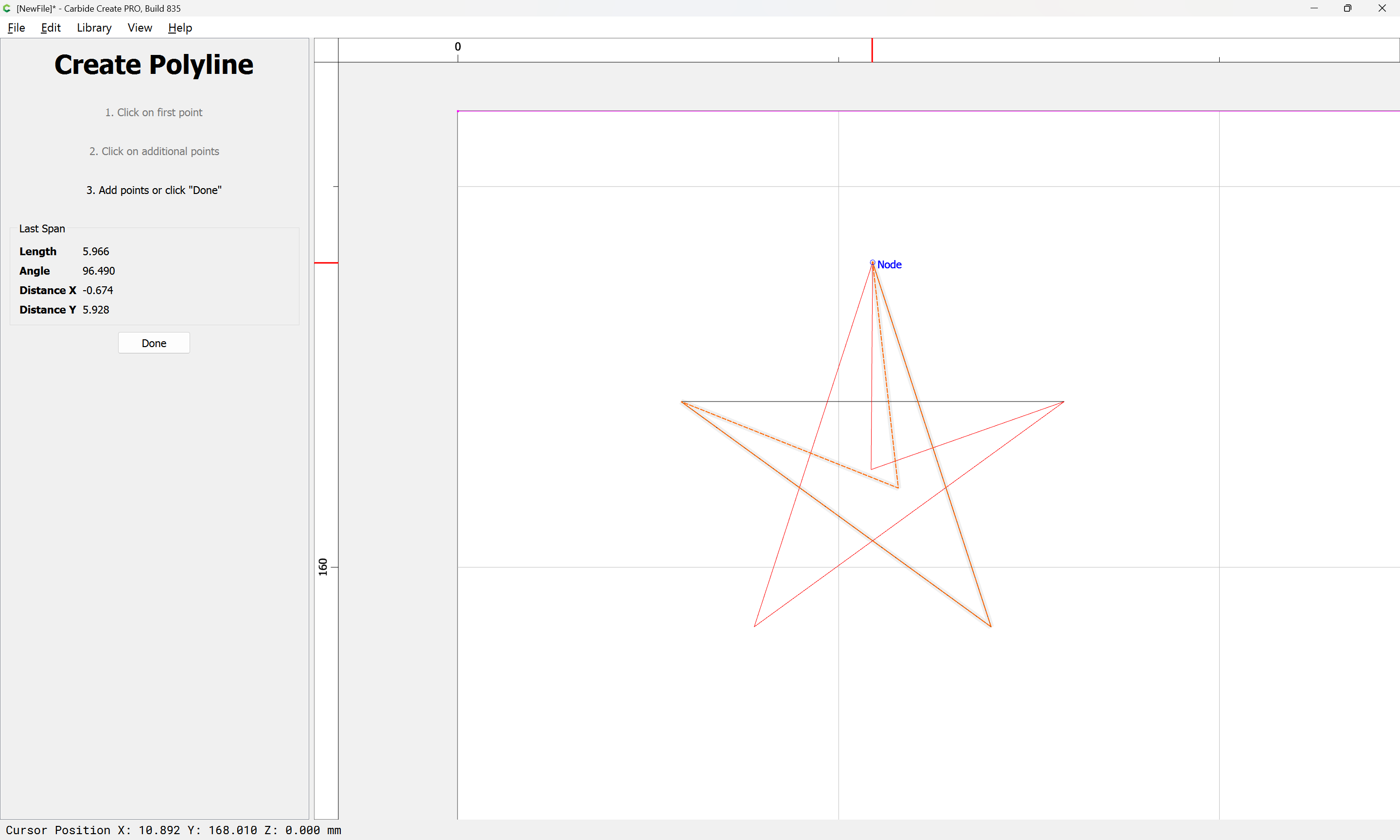

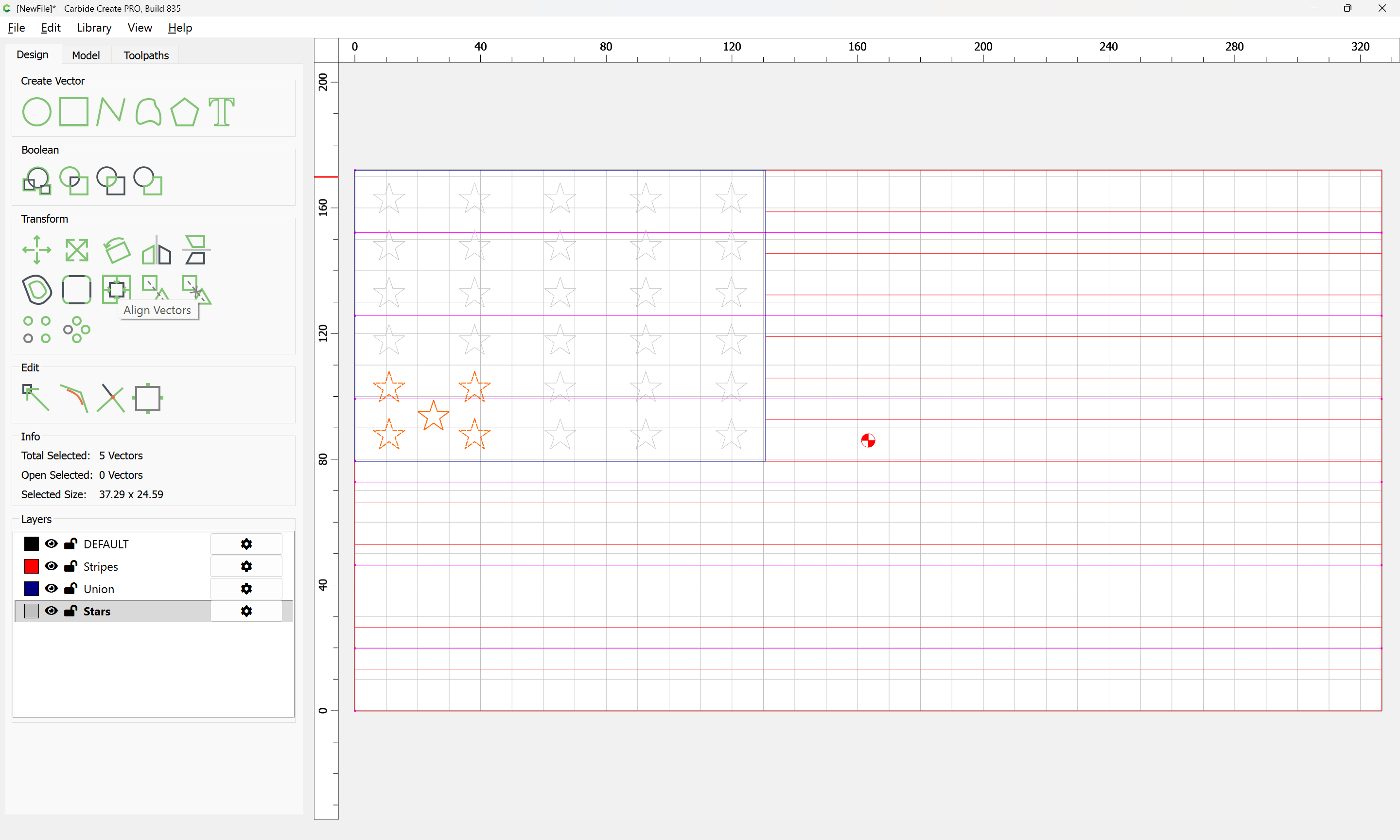

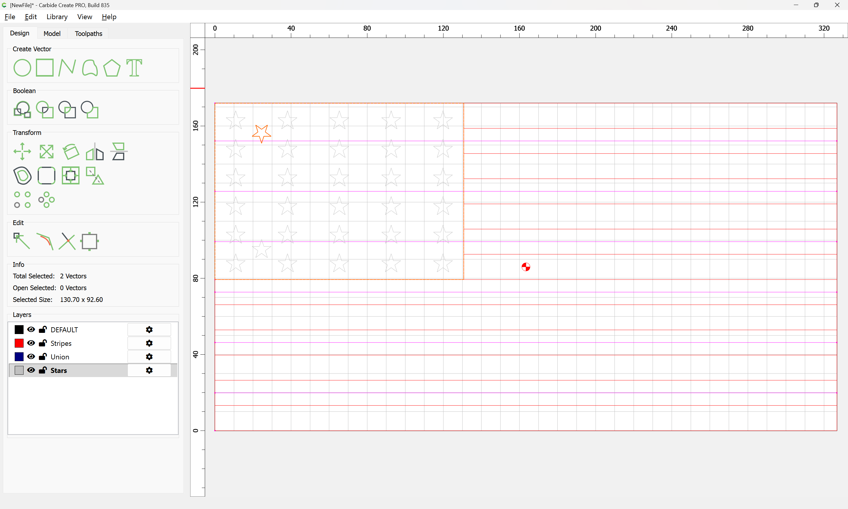

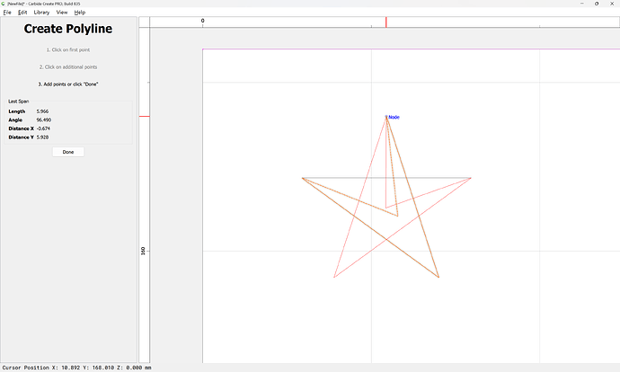

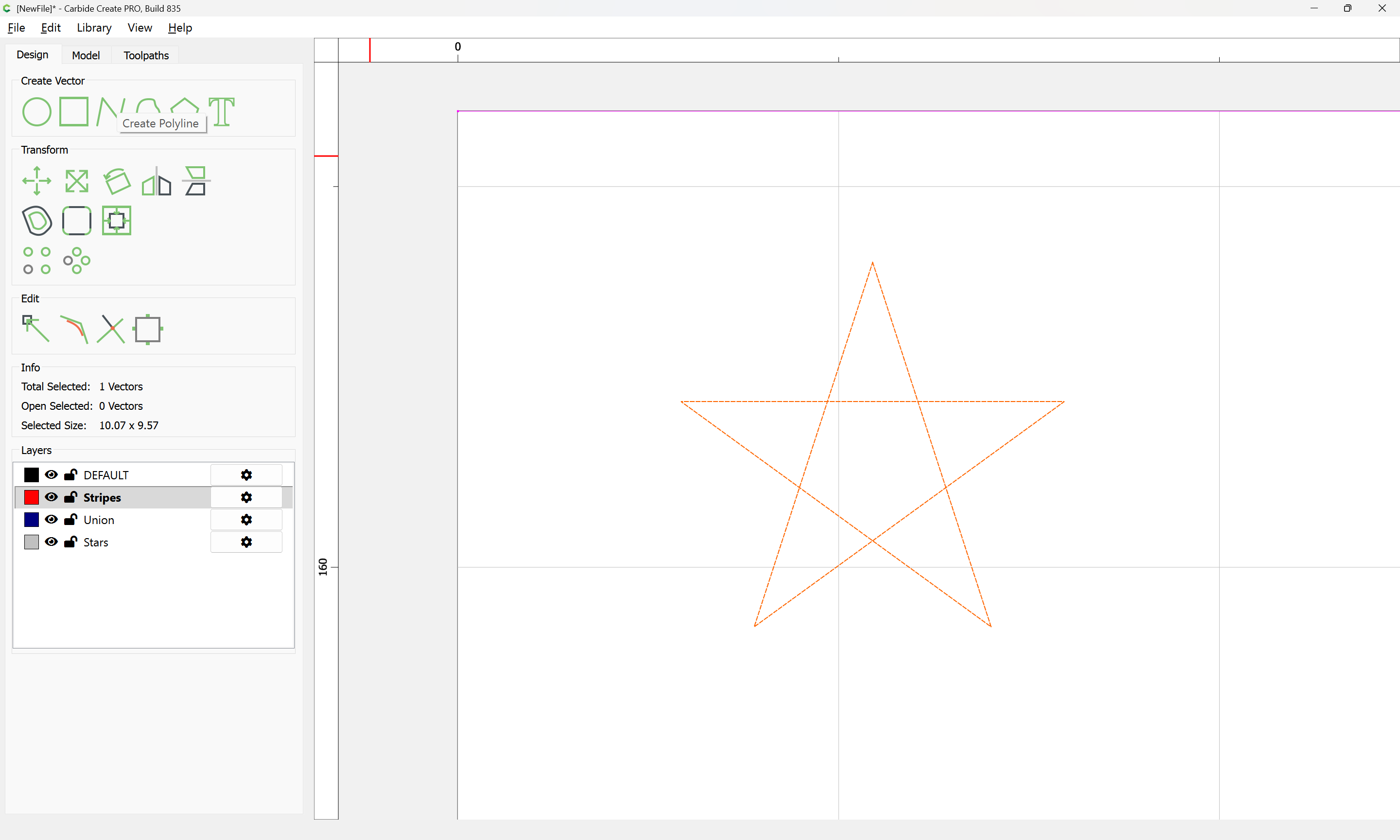

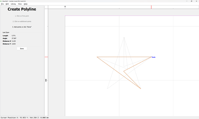

Then for the stars, just use the polyline tool to re-draw by snapping to the nodes:
creating three overlapping regions which define the star:

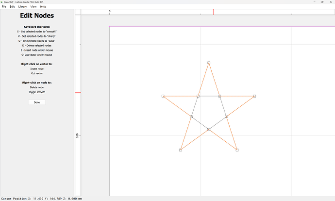

Select all three and Boolean Union:
If the overlaps aren’t right, go into Node Editing mode and clean up:

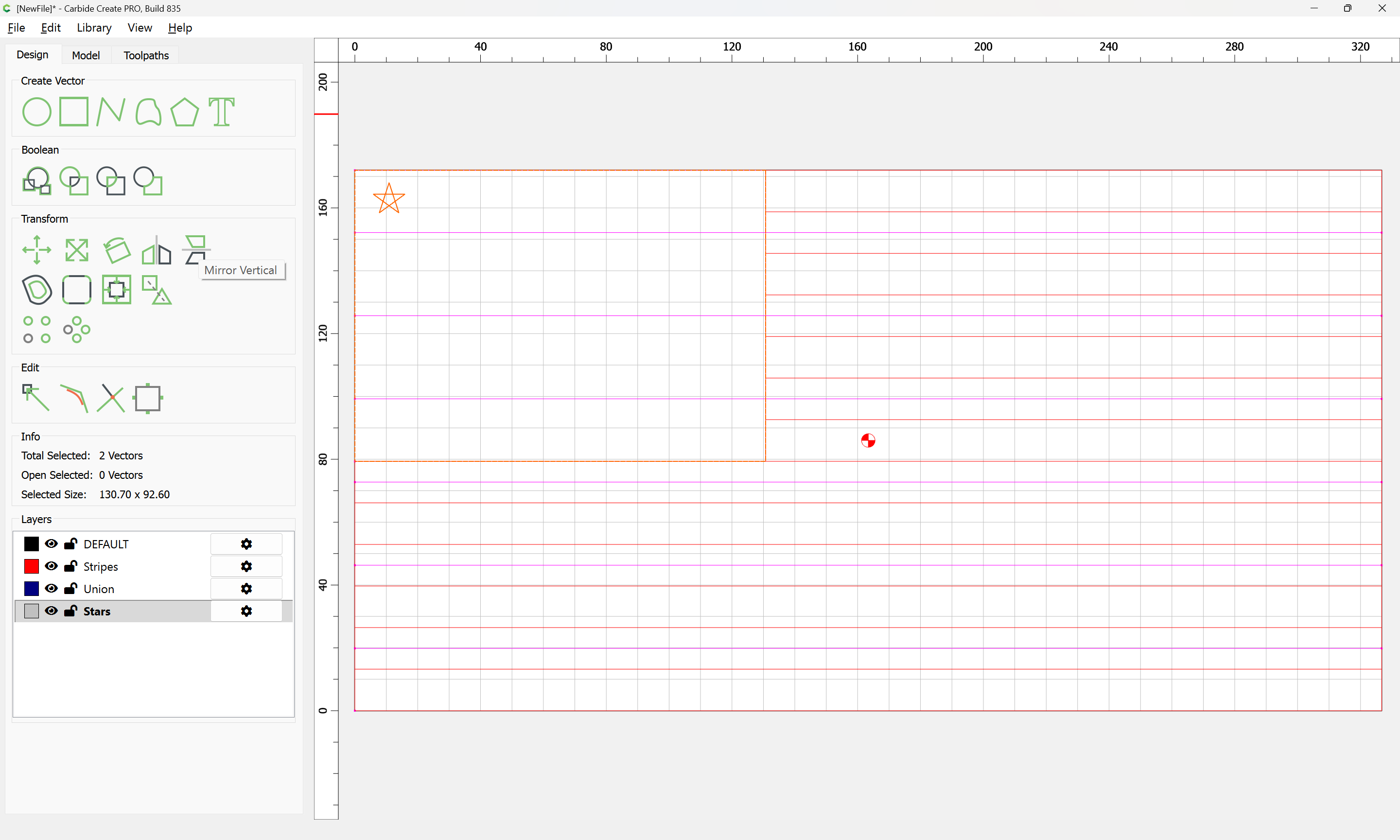

Draw in the Union:

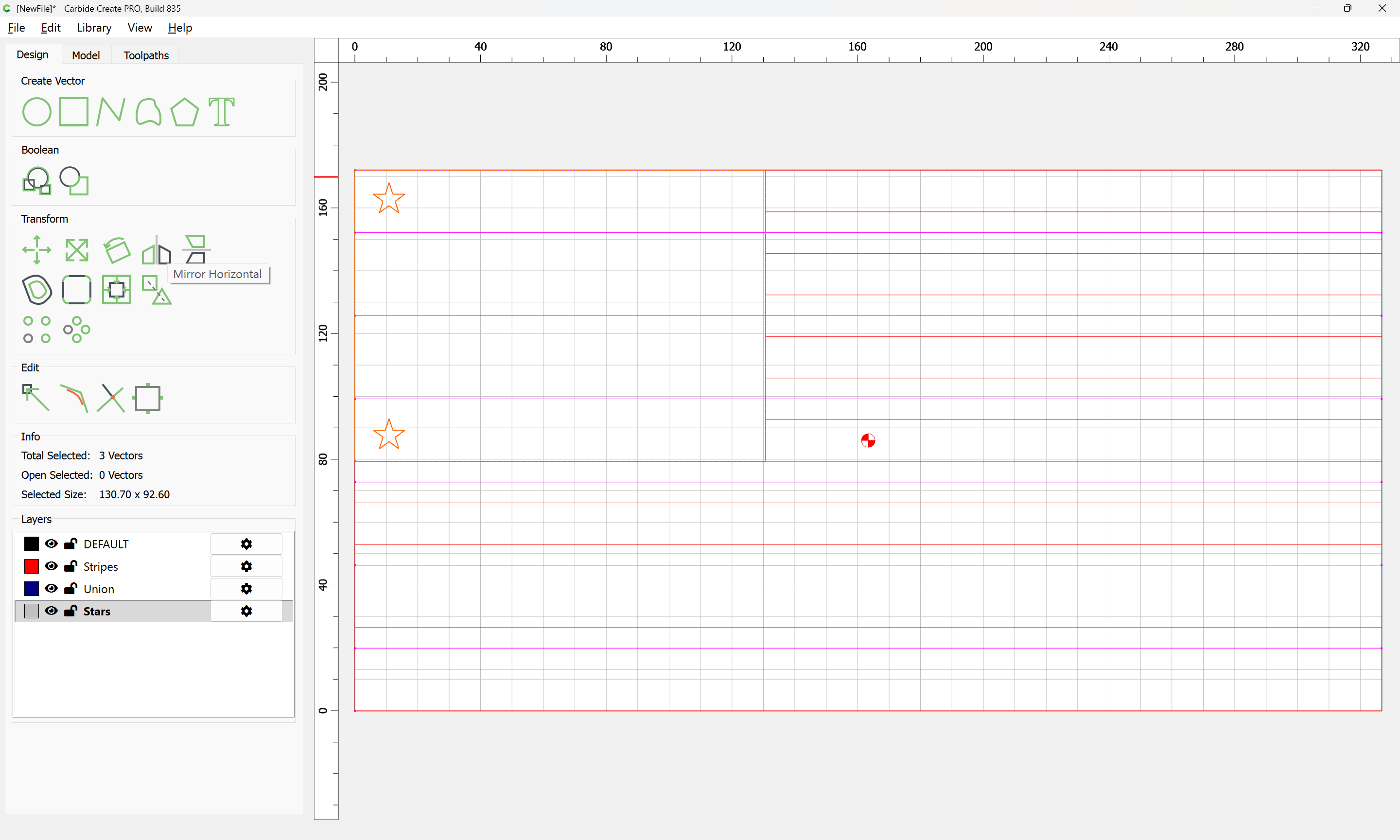

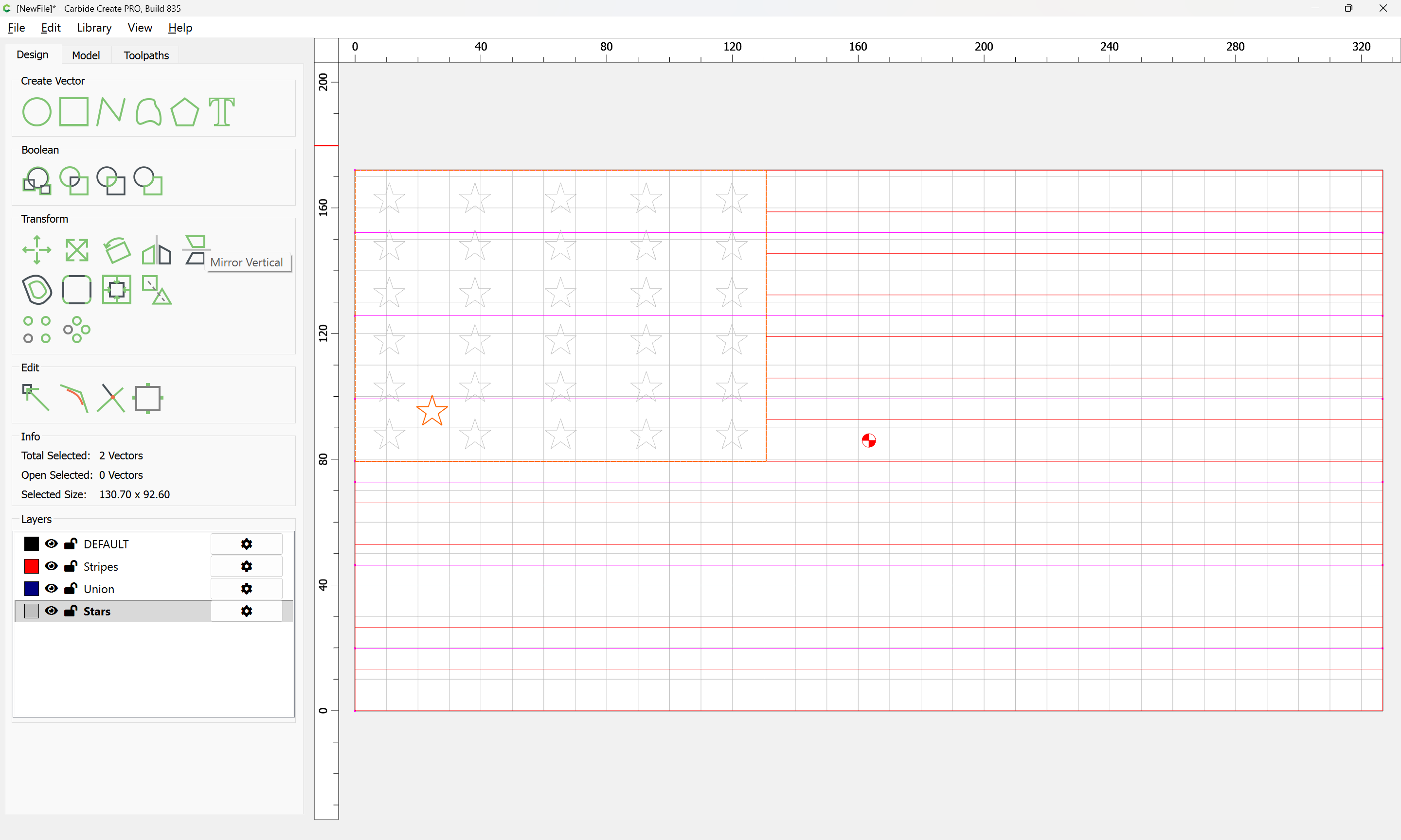

Then copy-paste the star to get a duplicate in register:
Select both the duplicate star and the Union:
and mirror them horizontally:
Then select only the mirrored star:
and reverse the mirroring:

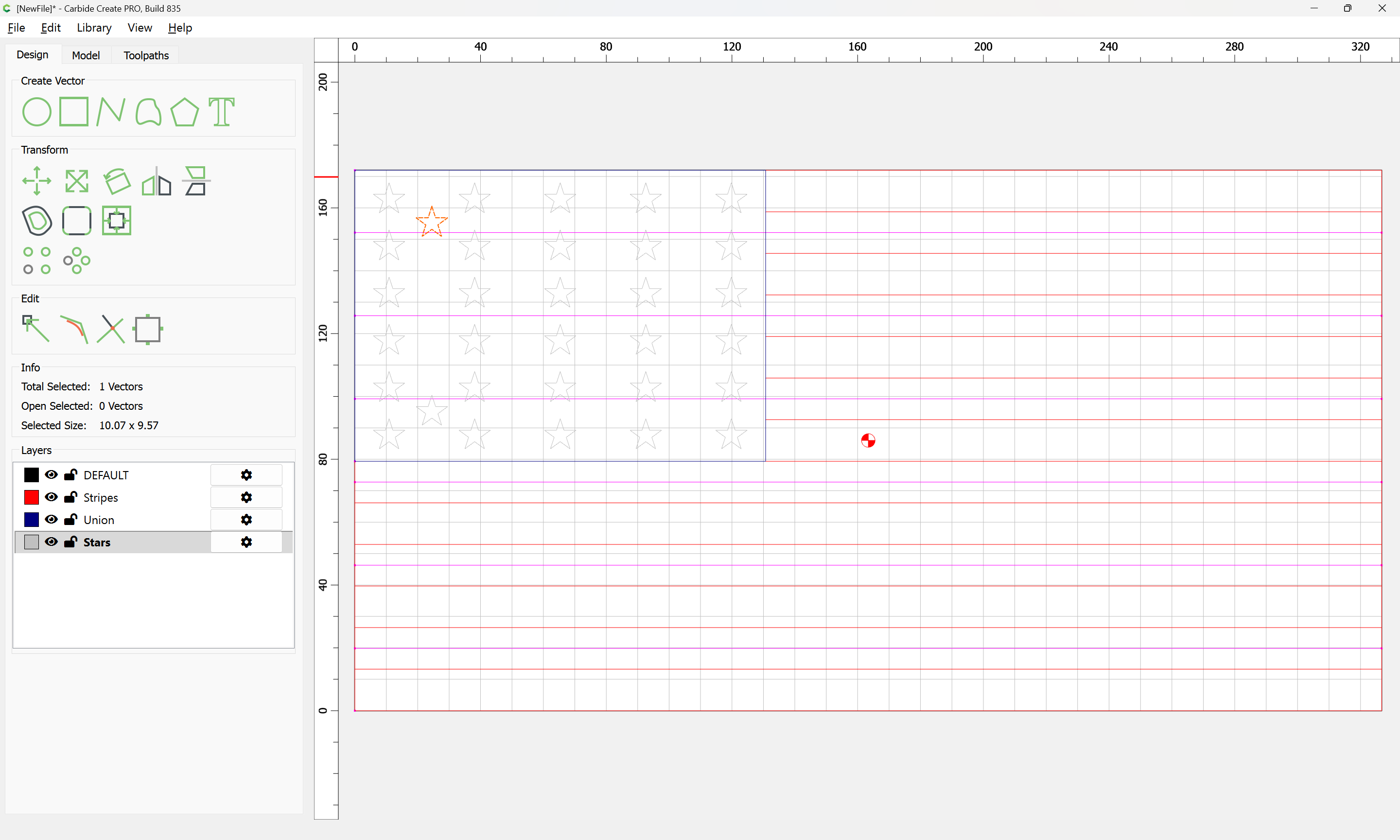

Duplicate both stars:
and Mirror Horizontal:

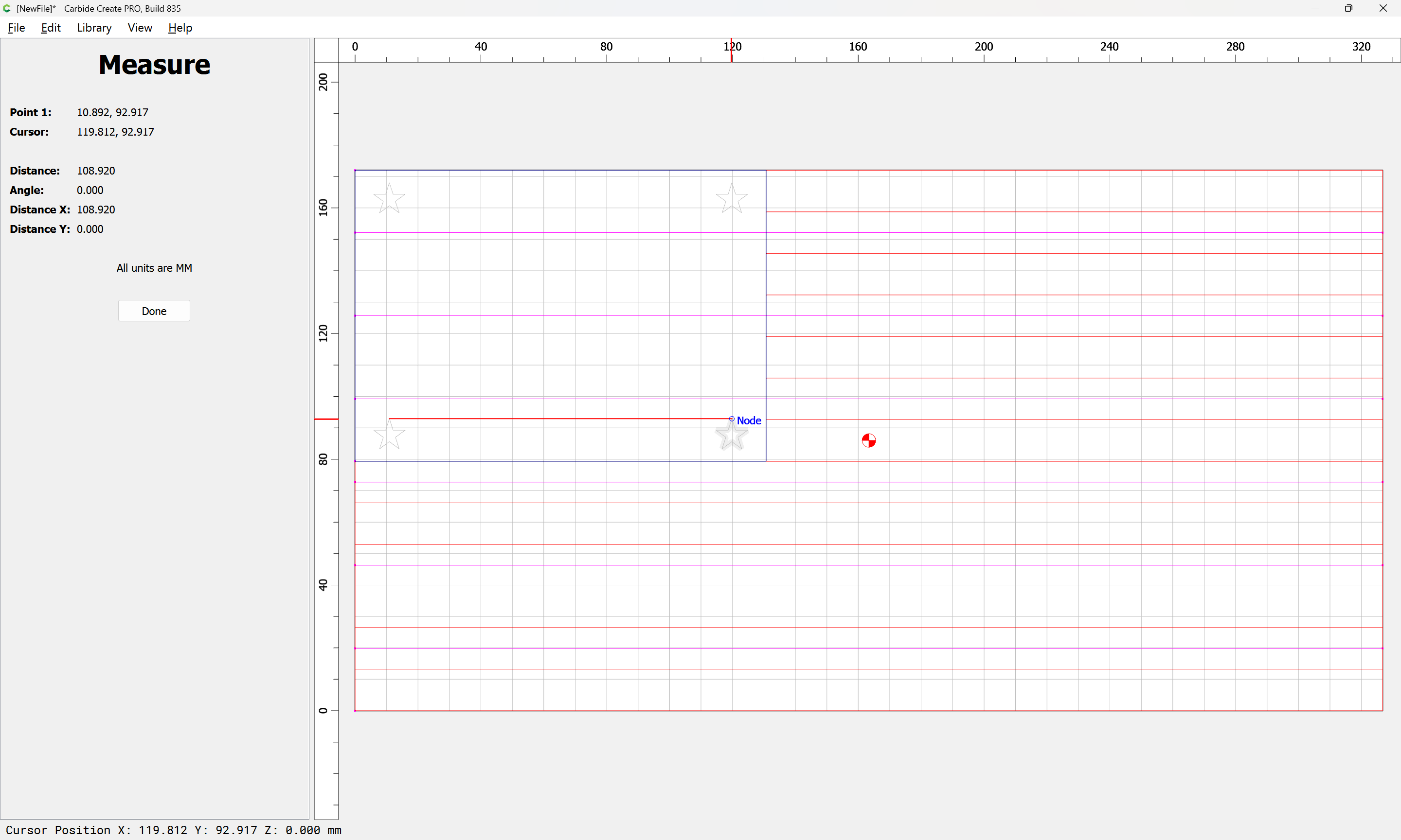

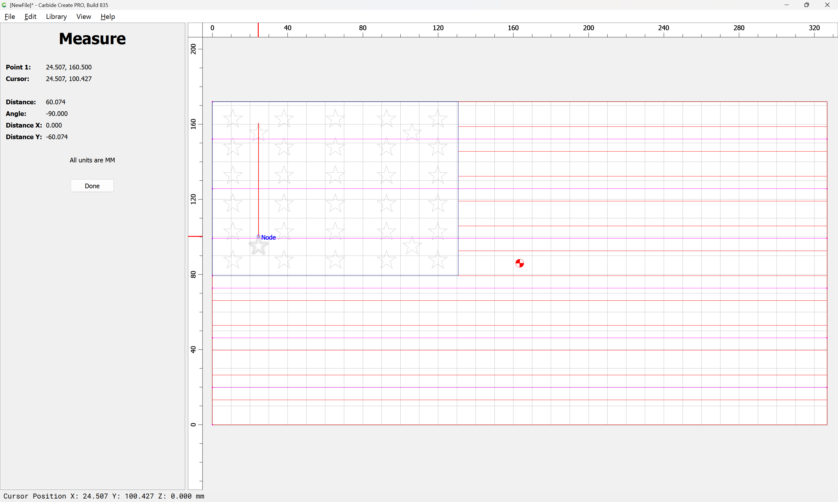

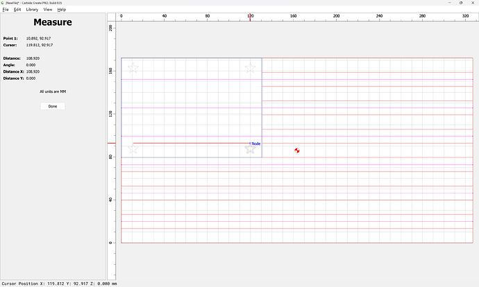

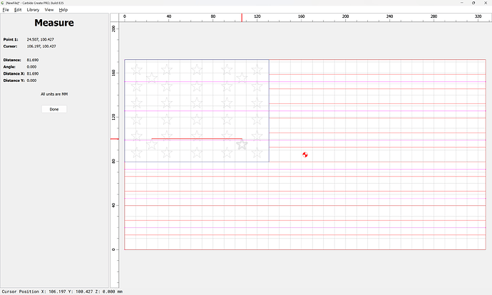

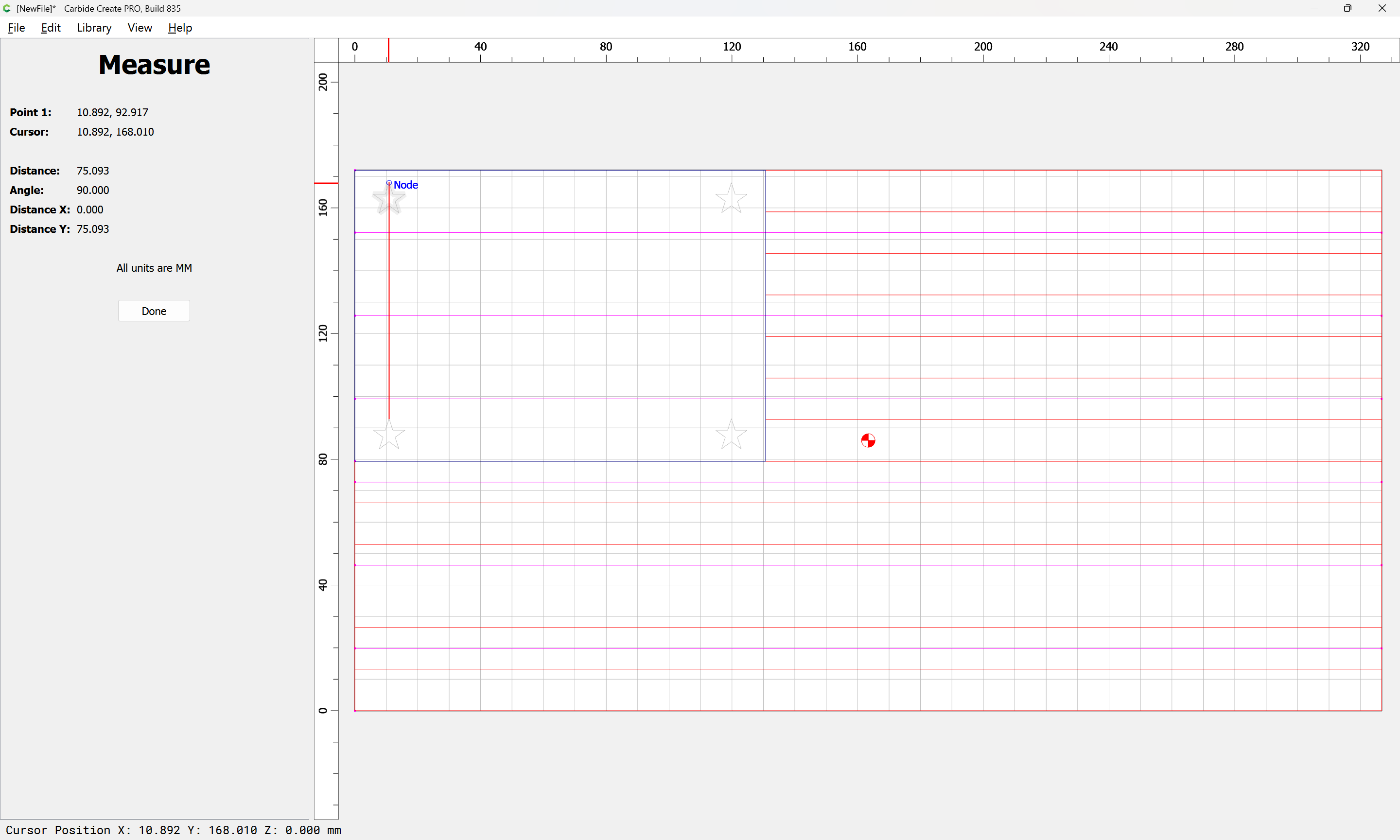

Measure the distances between the stars:
108.92
75.093

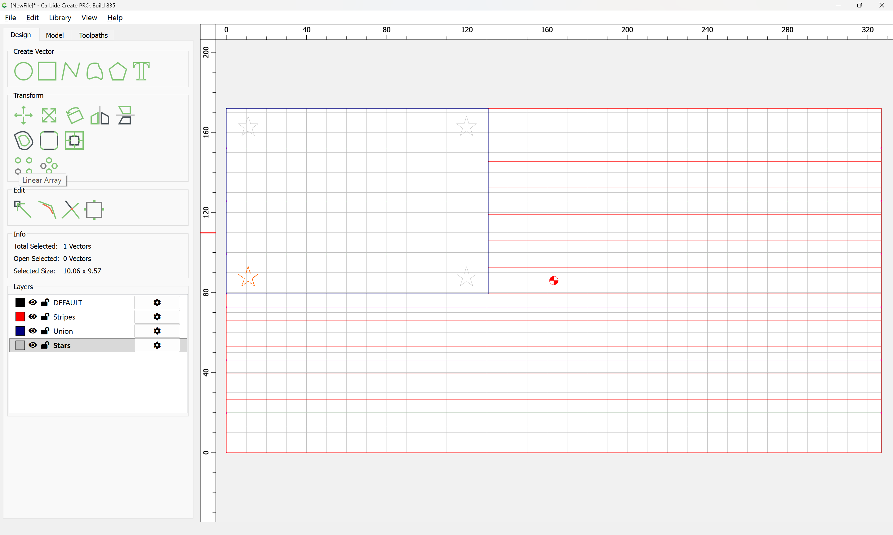

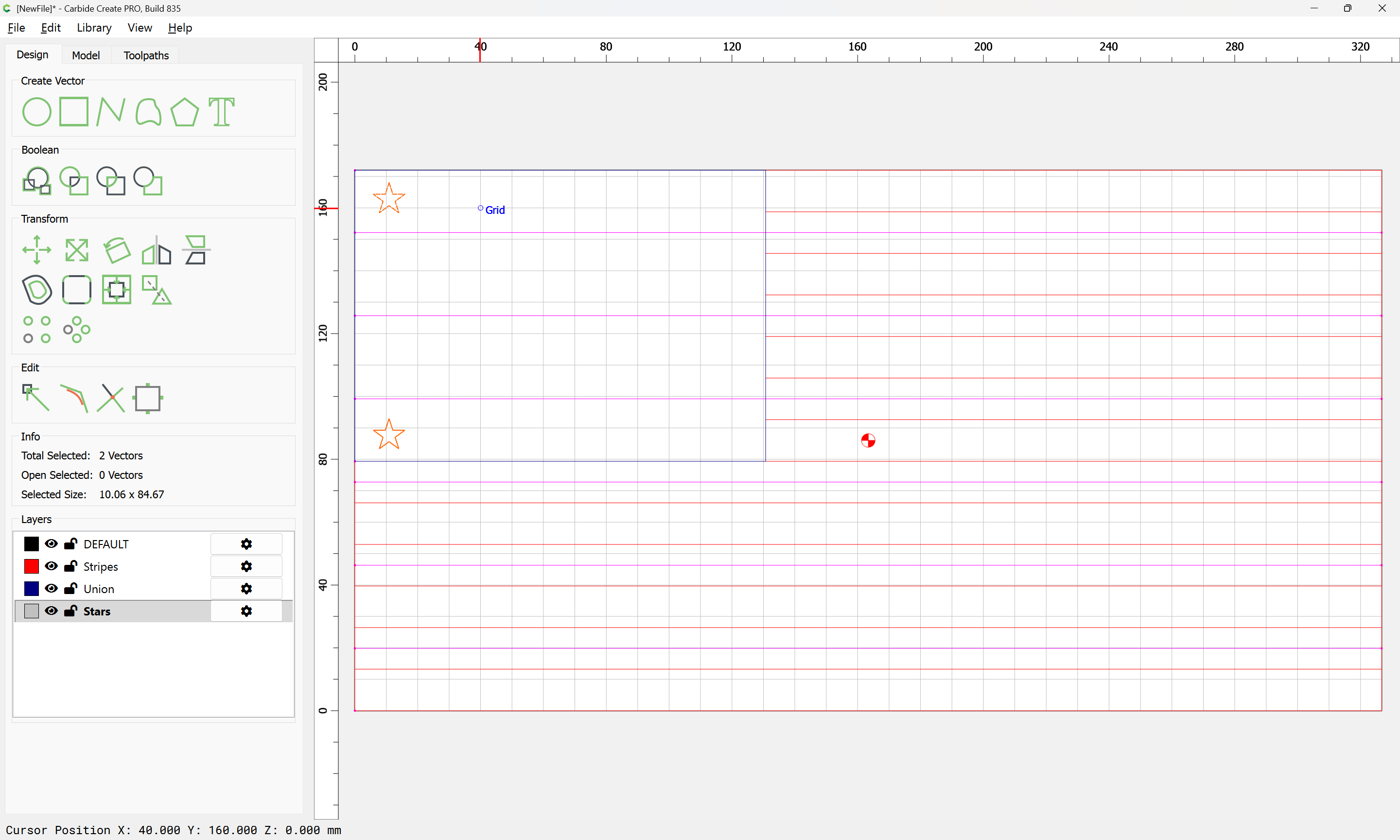

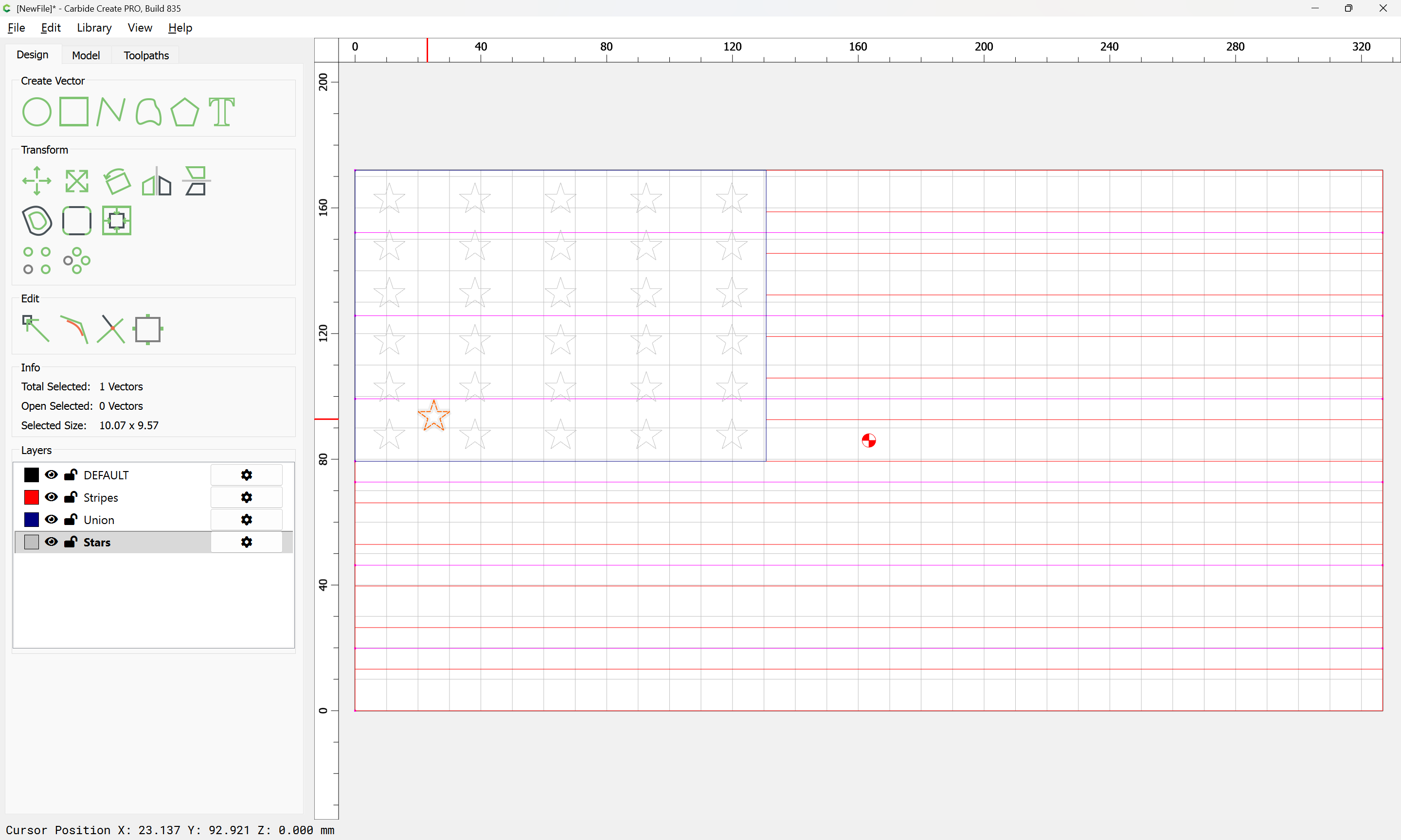

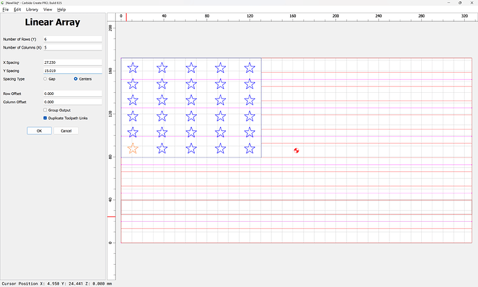

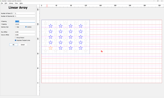

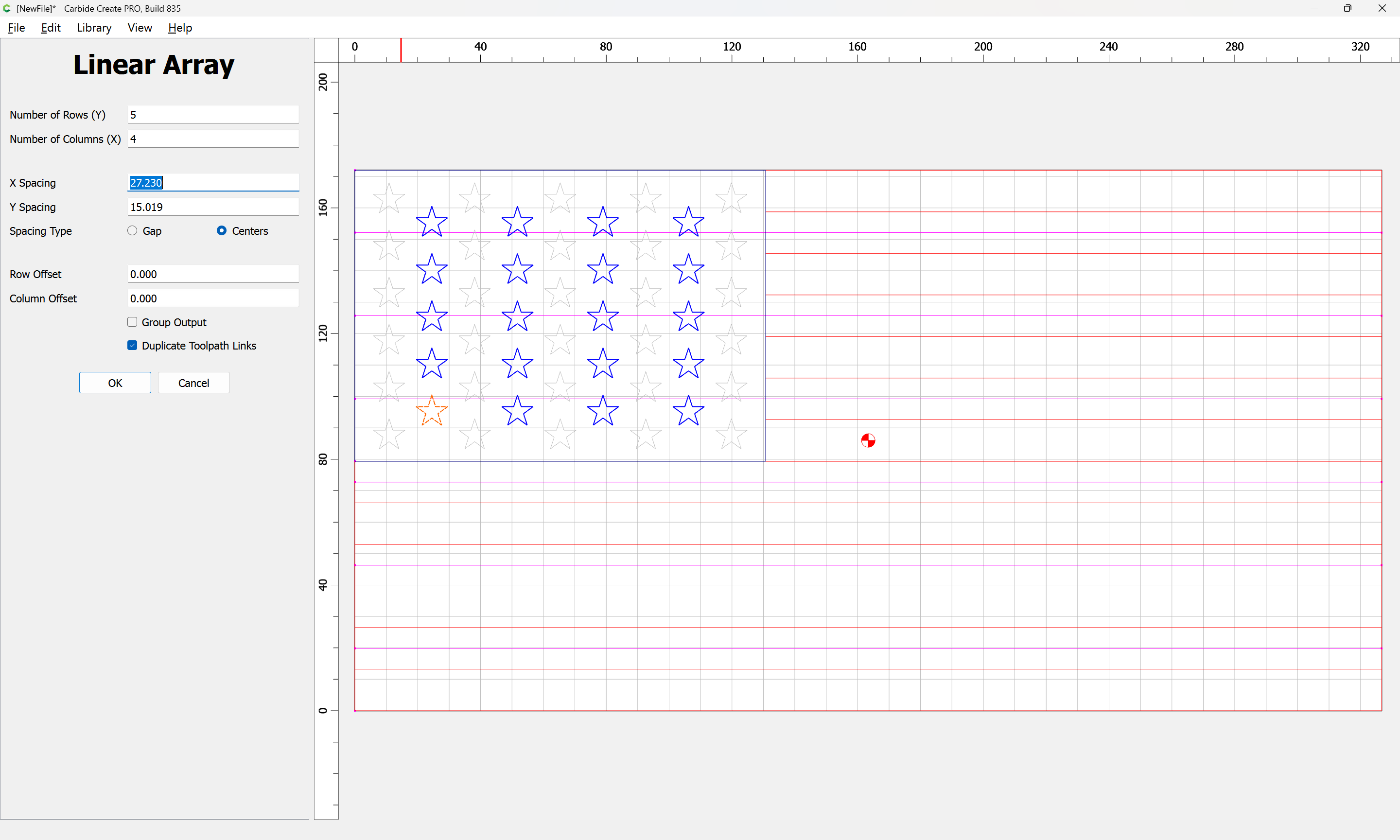

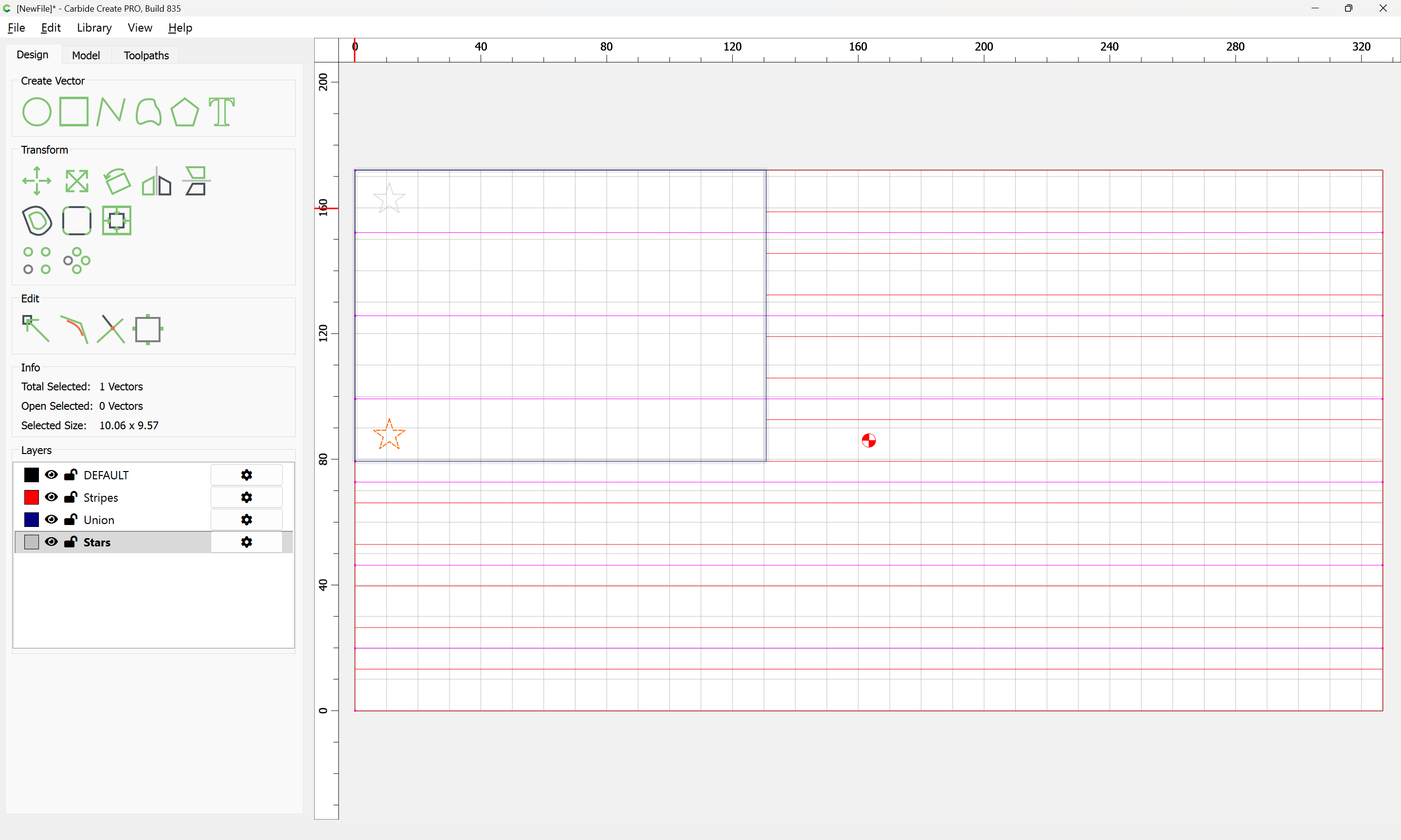

Then select only the star at the lower-left:
and use Linear Array:
to make the correct number of stars and use the measurements:
to correct the spacing:
OK

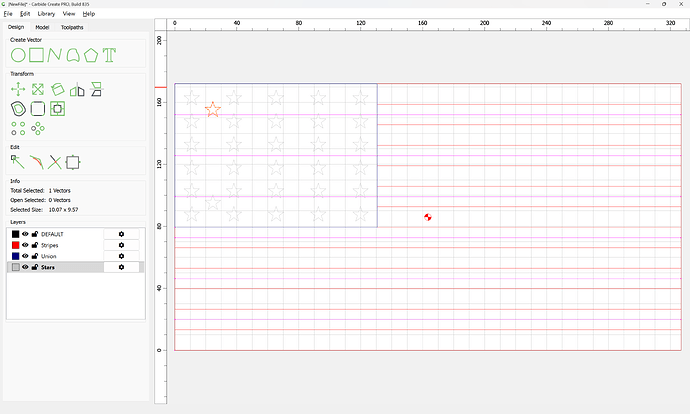

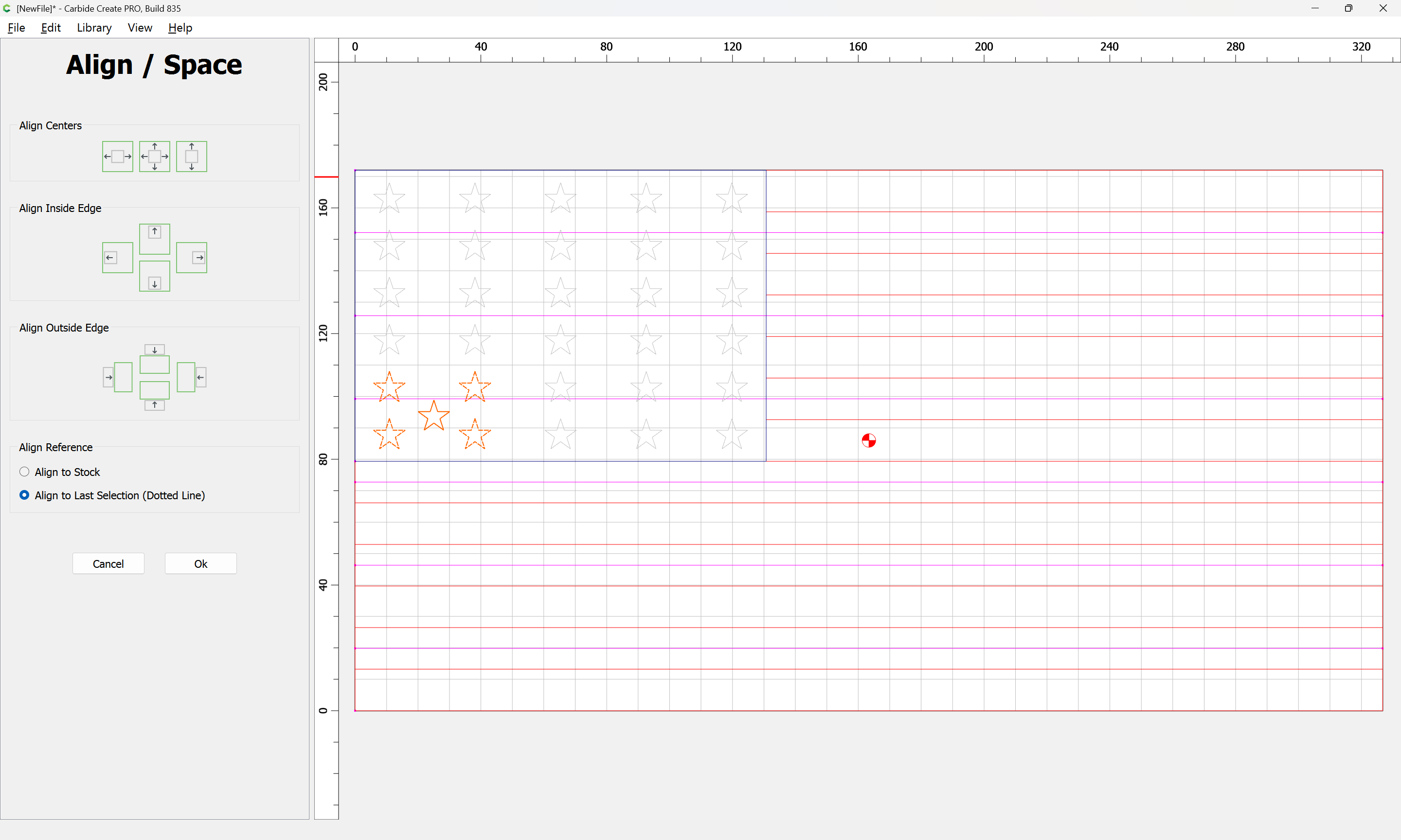

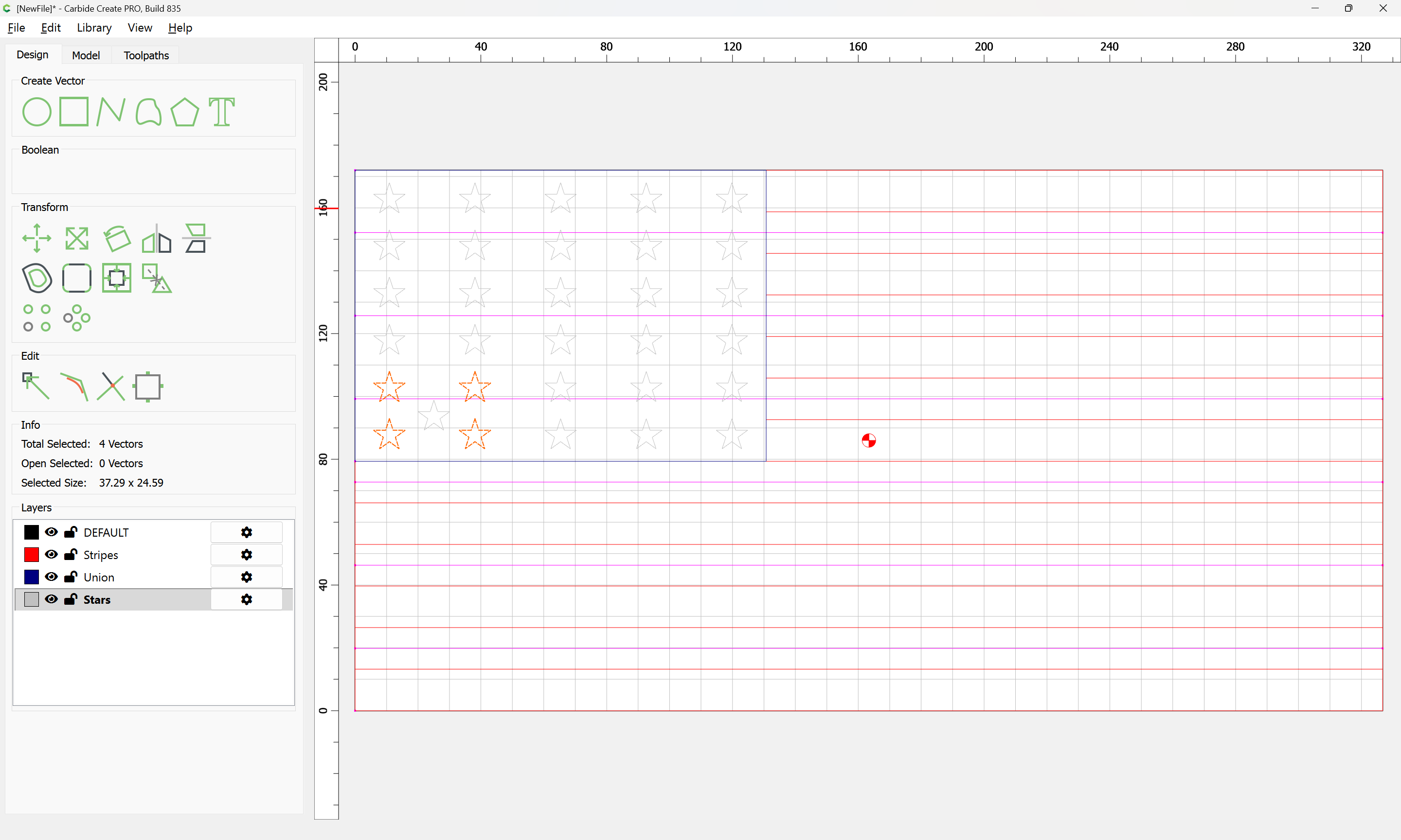

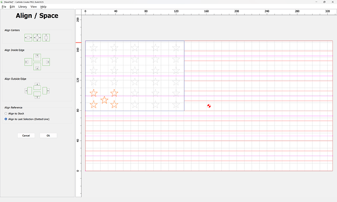

copy-paste one star and place it at the lower-left between the 4 stars at the lower-left:
Select the afore-mentioned 4 stars:
and group them:
Select the out-of-position star:
and shift-click on the group to add it to the selection:
and use Align Vectors:
to center it:
Ok

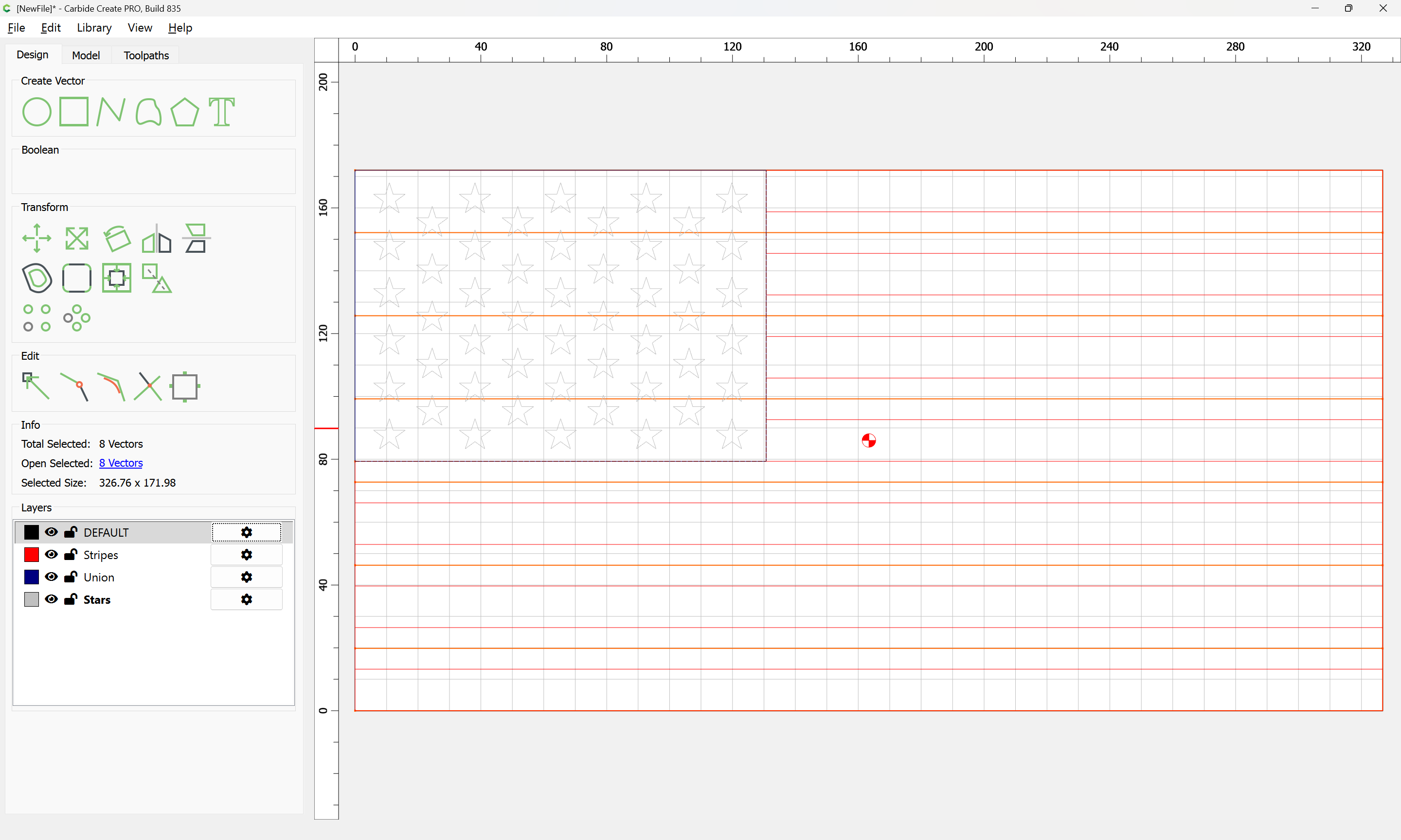

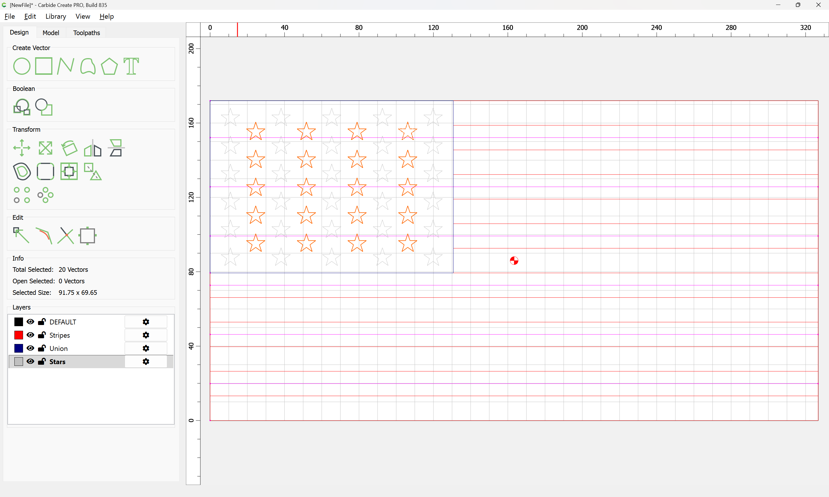

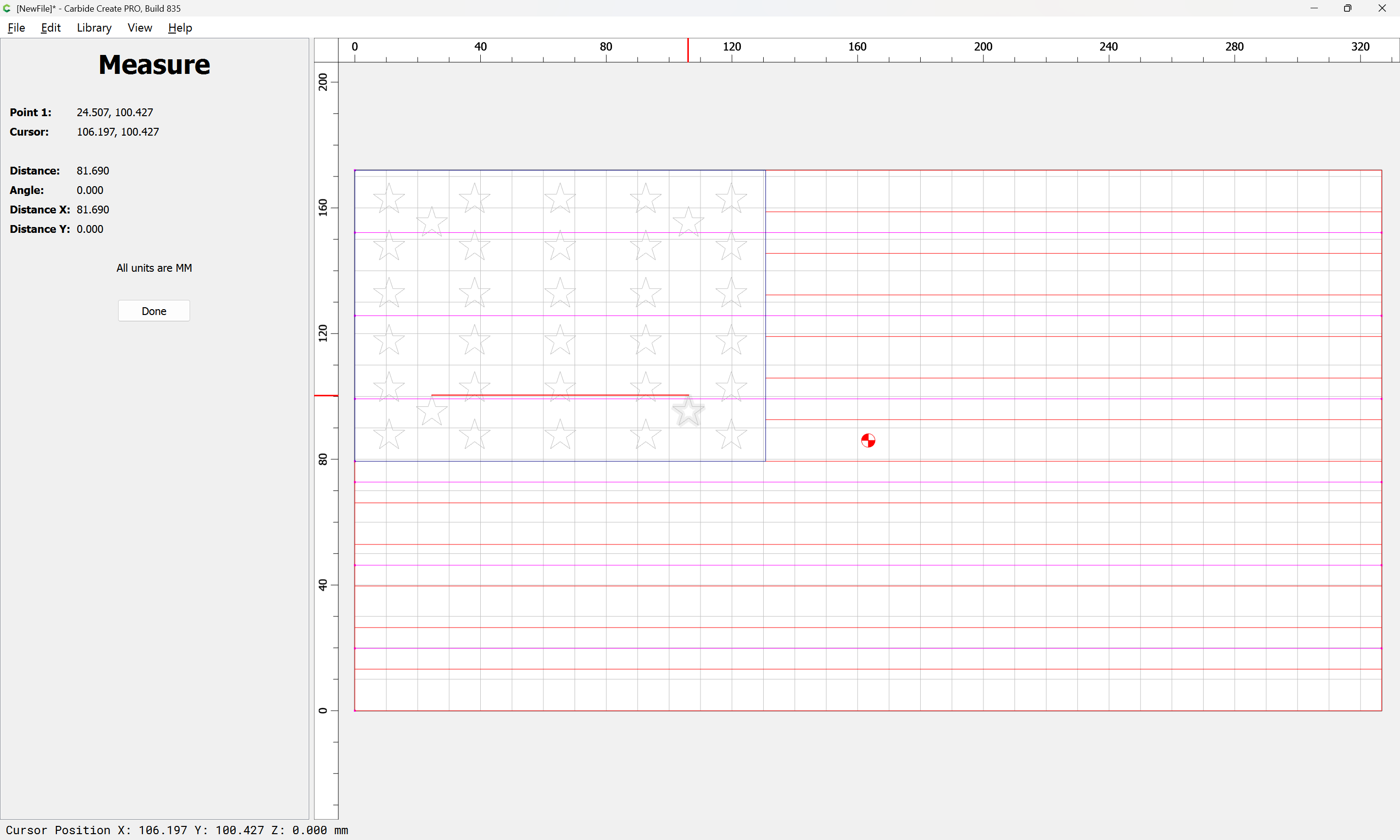

Repeat this process for the balance of the stars:
81.69
60.074
but since the spacing is uniform, the correct values auto-fill and it is simply necessary to reduce the number of rows/columns:
OK

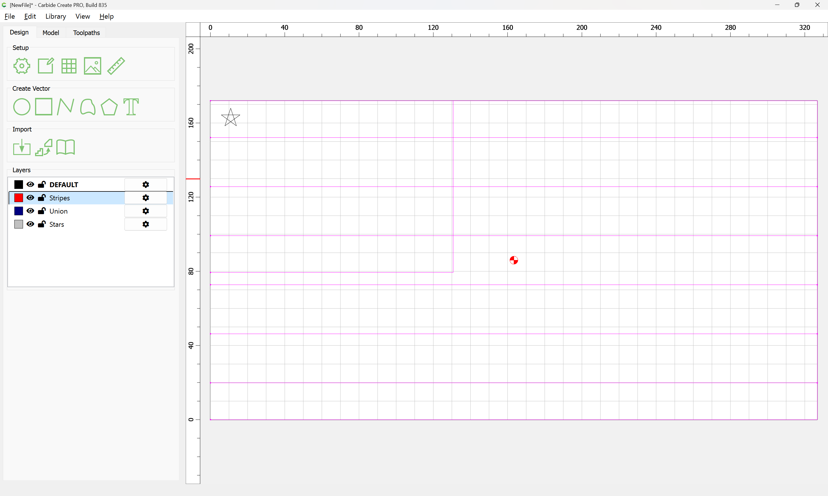

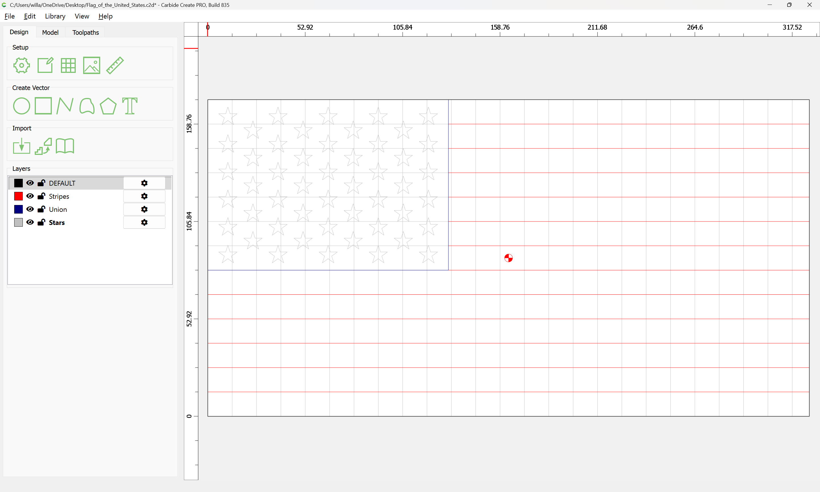

Select the imported geometry and delete it:
and re-draw the outer boundary.
Fixed flag:
attached as a v8 file:
Flag_of_the_United_States.c2d (92 KB)

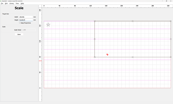

First set the Stock size to 19 x 14, then select everything then choose the scale tool:
Set things to 19 inches wide, then center it on the stock area and trim half of 0.235 or so from each side.
You may need to inset the paths if the features get too large to cut with your V endmill.
