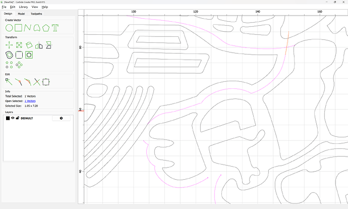

The open geometry:
shows that what is needed is geometry along these lines:

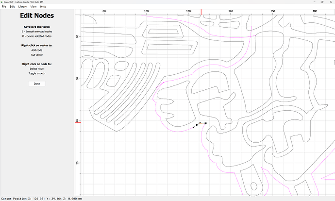

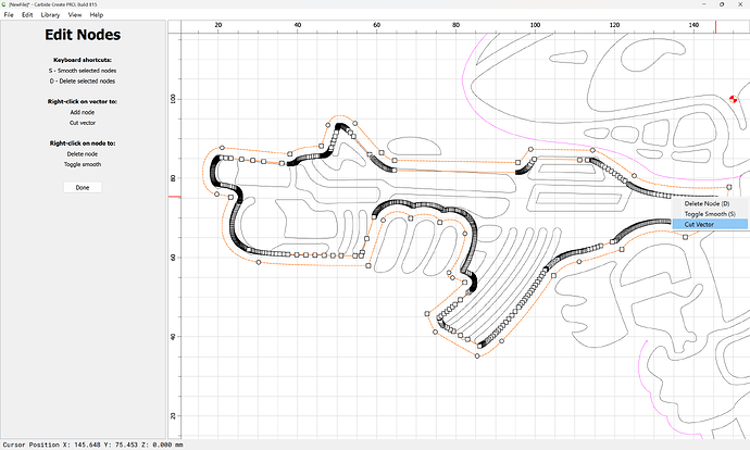

Use Nod Editing to isolate the regions in question:
Done
Delete what is not wanted:

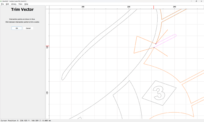

Use Trim Vectors to adjust:

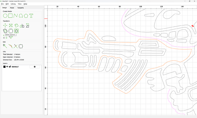

Repeat for the other sections, if need be offsetting to the outside:
Apply
