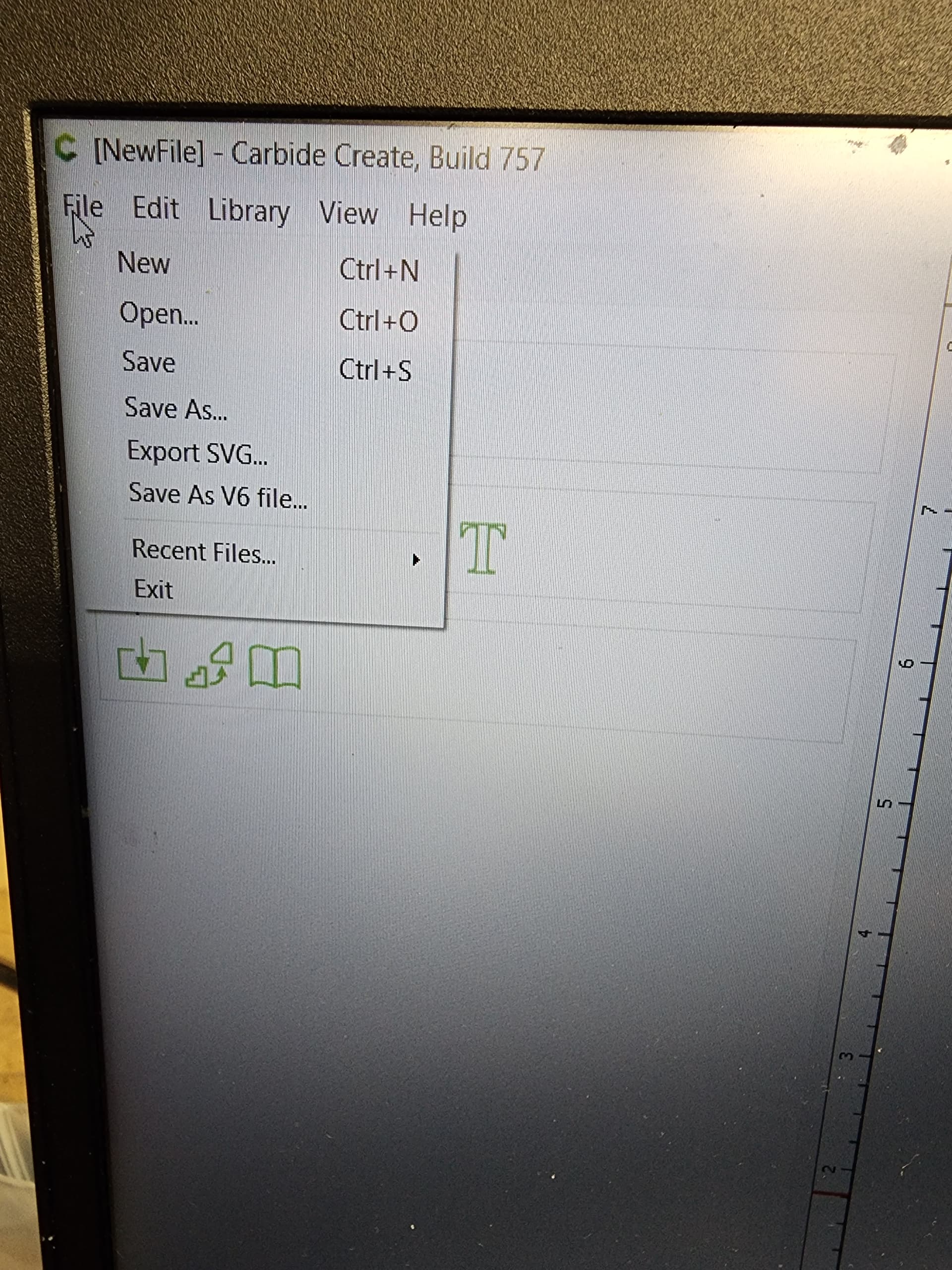

I downloaded carbide motion 618 and ran through the set up to get my shapeoko and the tool setter functional. Then I downloaded carbide create V7 (757). I created a simple file and saved it. It gives one option: “Save As V6 File…”.
I then opened Carbide motion and attempted to load the file I just created only to get this error: “Only C2D files from carbide create V7 are supported.”
What did I do that was incorrect?

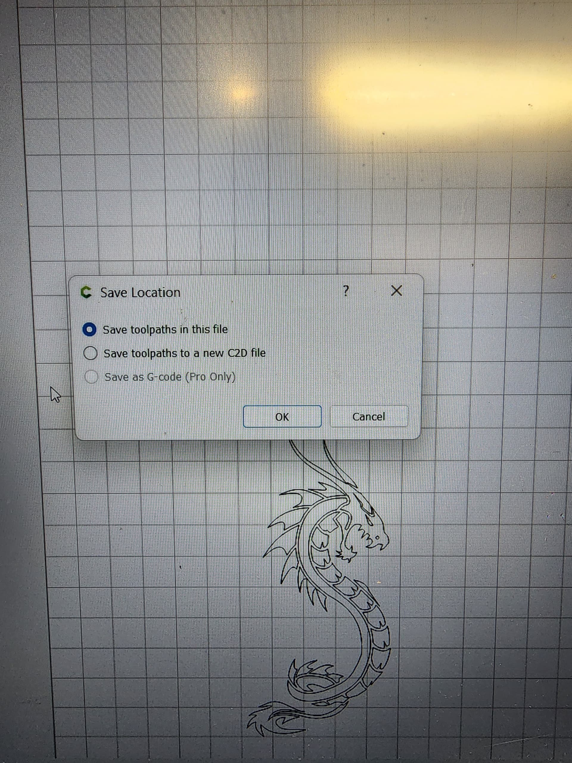

At the top of the drop-down is save and save as. When you are in the tool path tab there is a button save tool paths. One this is done you will be able load the file in CM
You want to just do a regular save, as a V7 C2D file. The GCode is now saved into the C2D file, and you can load a V7 C2D file into CM.
Unfortunately, that suggestion didn’t work.
Did you sucessfully create a toolpath?
What does the 3D preview show?
I see where I made my mistake. You are correct. I had forgotten to set the toolpath. Thank you very much, it loaded.
