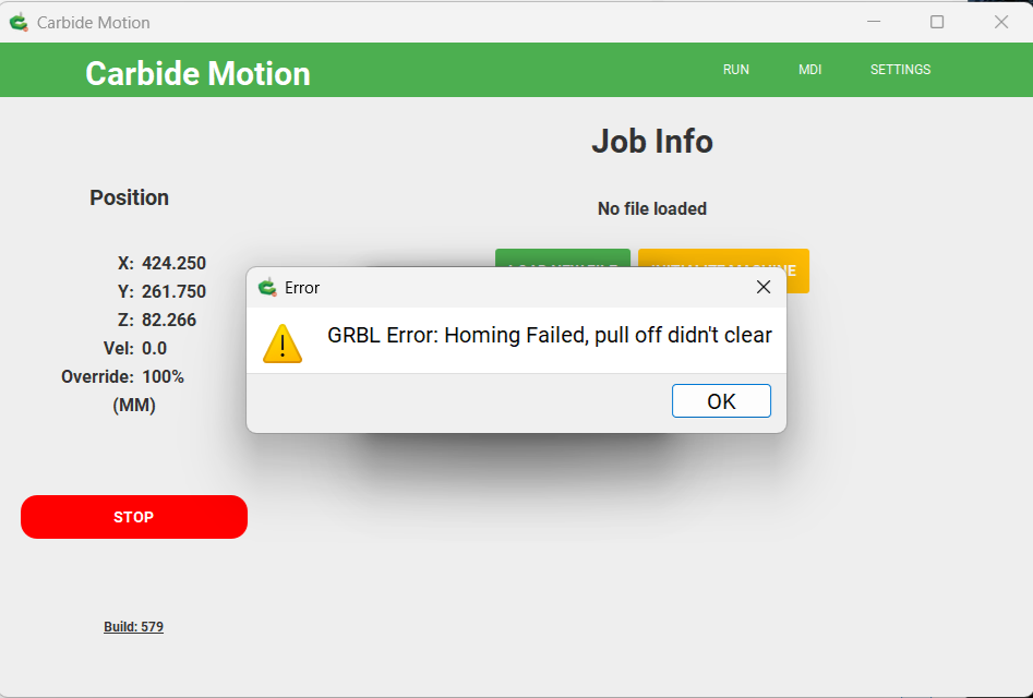

I used my Shapeoko 3XL yesterday, and today CM won’t initialize the machine. The Z moves down a little, then I get the following error. I’ve manually pressed the Z limit switch in a few times but I keep getting this error. There’s also a Limit Switch Error (Z) popup. It seems like CM thinks the Z limit switch is active. I’m running CM Build 579

If the Z is stuck on, the Z axis will pull-off (move away from it) so it can approach it again. So, on each initialization the Z will move slightly down, then abort.
Sounds like the controller board is going bad.
Connect to the machine. Do not initialize.
Go to Settings / Debug. There is a live display of the inputs. What does the Z say?
Z is stuck on. If I press and release X and Y, they both change on the display. Z never changes; it’s always on. I ran another test; I turned off the machine, swapped the X and Y connectors on the controller, turned it back on and went to debug. The problem moved to Y; i.e. the Z switch seems faulty. Is there something else I can do to verify this?
If the limit switch/sensor is bad, whatever input it is on will not change state. So the issue will follow to whichever axis input the bad switch/sensor is plugged into.
If the controller input is bad, then that axis input will not change state even if a good/verified switch/sensor is attached to it.
The Z limit switch is bad. I ordered the Shapeoko 3 Proximity Switch Kit - XL, and will replace all three mechanical switches. This should fix it. Thanks all for your help.
