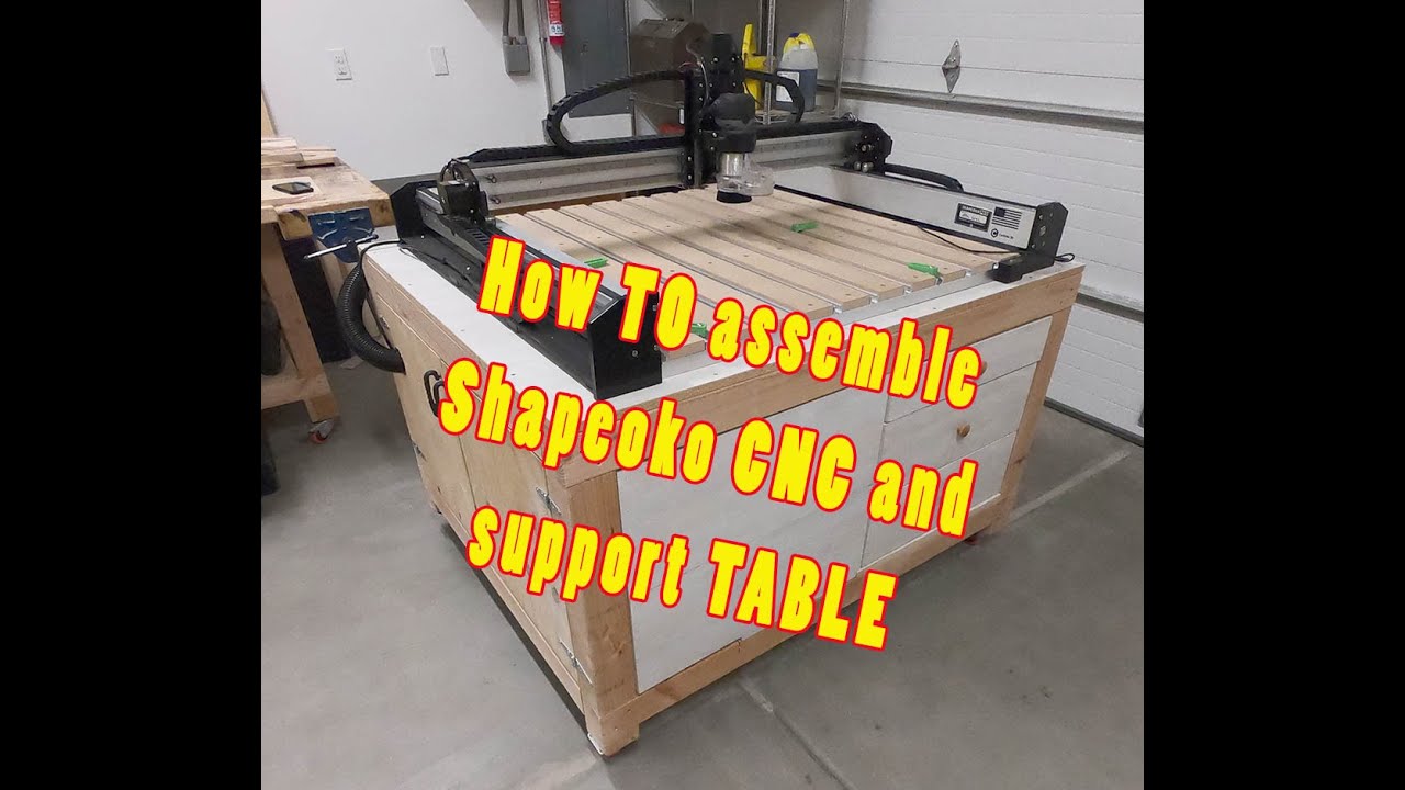

I made a table with casters and built-in vacuum setup. Works great. Still no actual enclosure, but I did add some foam panels on four sides to keep the wood shop dust from building up.

Currently building my enclosure. I have a 3 car garage and 1 bay is dedicated to work space. I have not even cut anything yet with my Pro! The cabinet is built to return some storage space I had with 2 previous shelves in the same location.
I still need to mount the doors for the lower and upper shelves and make the acrylic doors for the enclosure area. I have drawers on 3 sides, where the front side is larger and will store the tablet that connects to the Pro.
