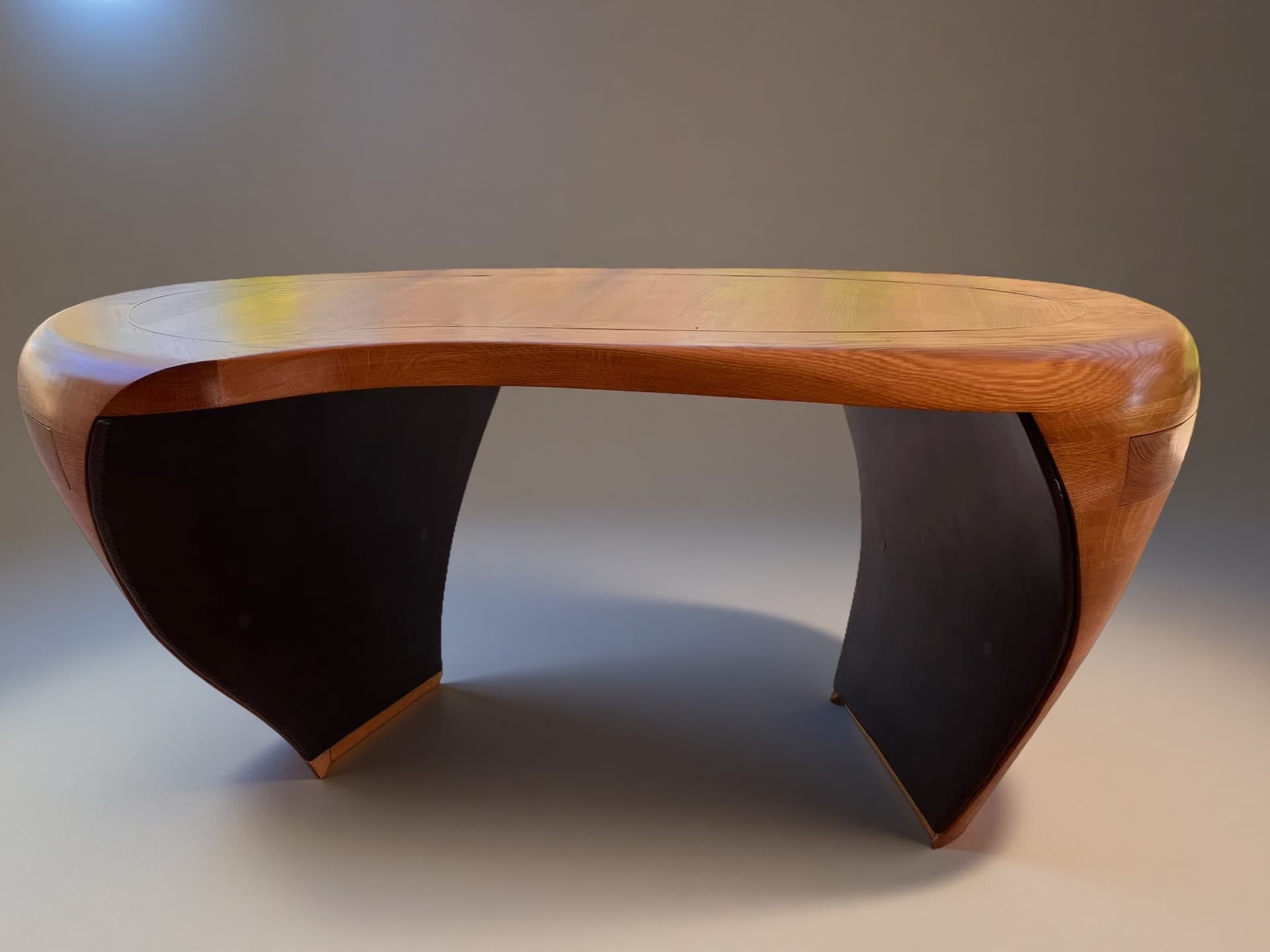

Here is another application of CNC in furniture design. This is a desk with a somewhat radical design, made of white oak and carbon fiber / epoxy composite. FYI, the photos are edited with an AI app to create backgrounds and shadows, etc,… Just because I did not have the courage to set up my photo studio. However the desk is NOT an AI generated object, as shown in the first photo taken in my shop.

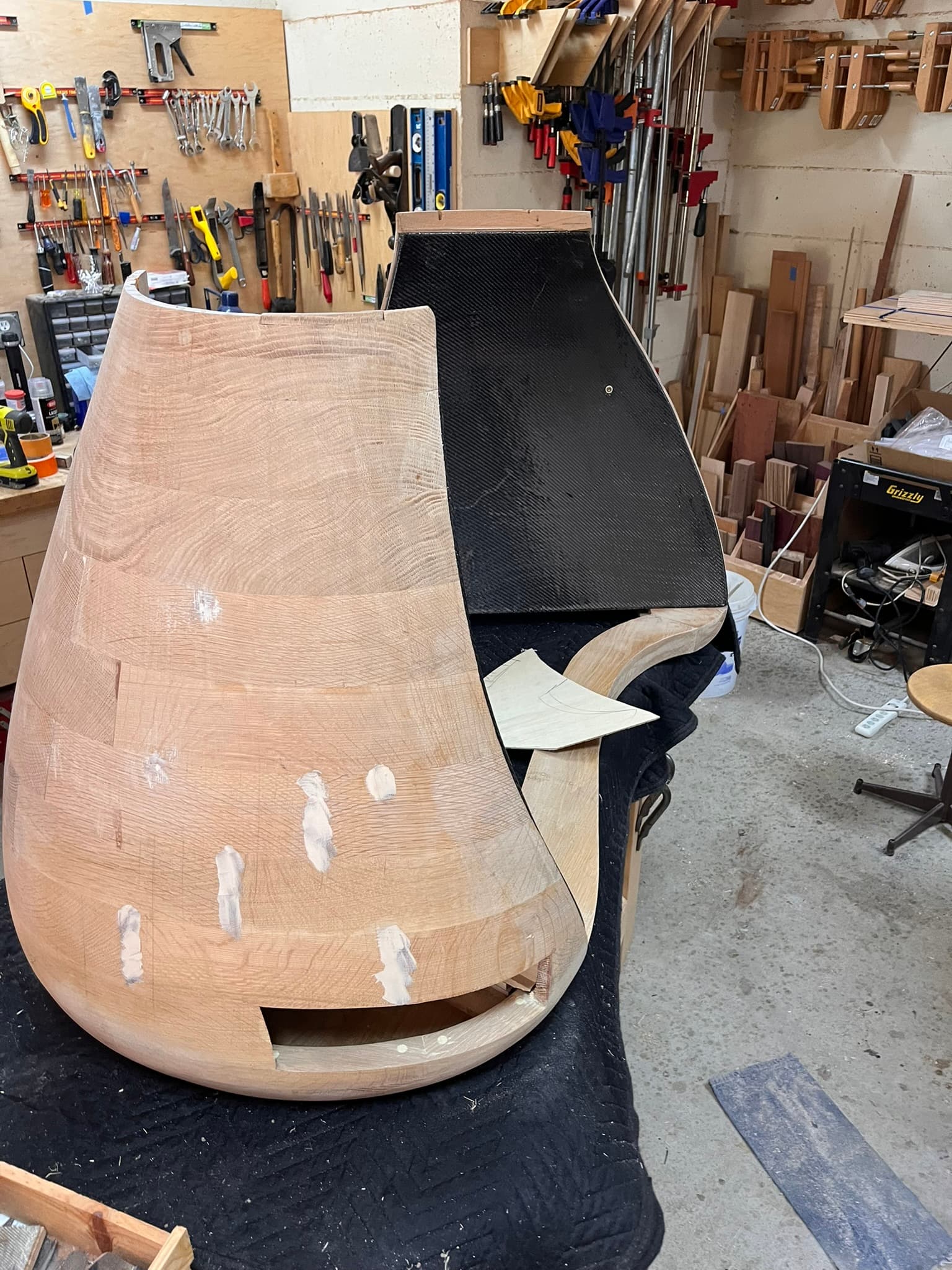

My approach: Onshape to do a 3D model and Fusion to createe toolpaths, and then some kind of a bricklaying method to assemble the various pieces milled on my Shapeoko 5. Each part is usually milled as a two sided job. I do not mill the pieces entirely as it would take forever, i.e. there is significant griding and rasping after assembly. The carbon fiber inserts are make manually by laminating using the finished desk as mold.

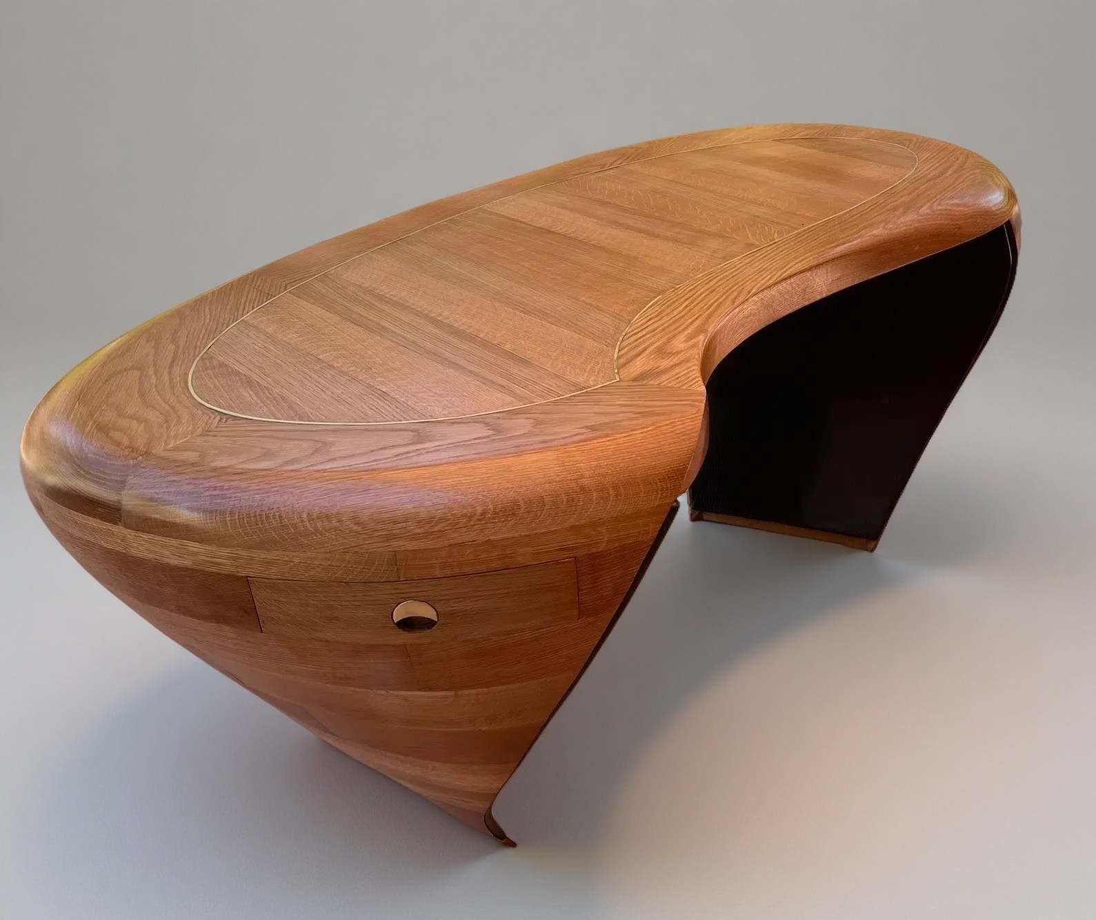

As with many “freeform” designs, it looks like a serious tipping hazard. There’s a lot of solid (heavy) material up high and a small (narrow) footprint down low.
Yeah I thought the same thing, but based on their previous work/experience I’m giving some benefit of the doubt :slightly_smiling_face:
That and the fact that physics can be tricked into doing some strange things with the right geometry. I mean, it’s certainly top heavy, no doubt about that. I’m just not certain that top heavy necessarily means tipping hazard :thinking:
I was actually thinking that way, too, but also thinking of trying to move it around.
Anyway, its not like I’ll ever be able to afford such a fine piece of furniture. :smiley:
HeuristicBishop thanks for your humorous comments. And by the way my production is priceless since I do no sell anything but giving them away to friends and family! My only constraint is to find room in an alrady crowded house.
As for the “top heavy” profile, it is true that until the last moment, when I had assembled the last “bricks” at the bottom and put the whole thing upright, I thought it would tip over. I had already started making a foot in carbon fiber with a larger footprint. But to my pleasant surprise the desk was very stable. The weight of the thing must have helped a lot though…
