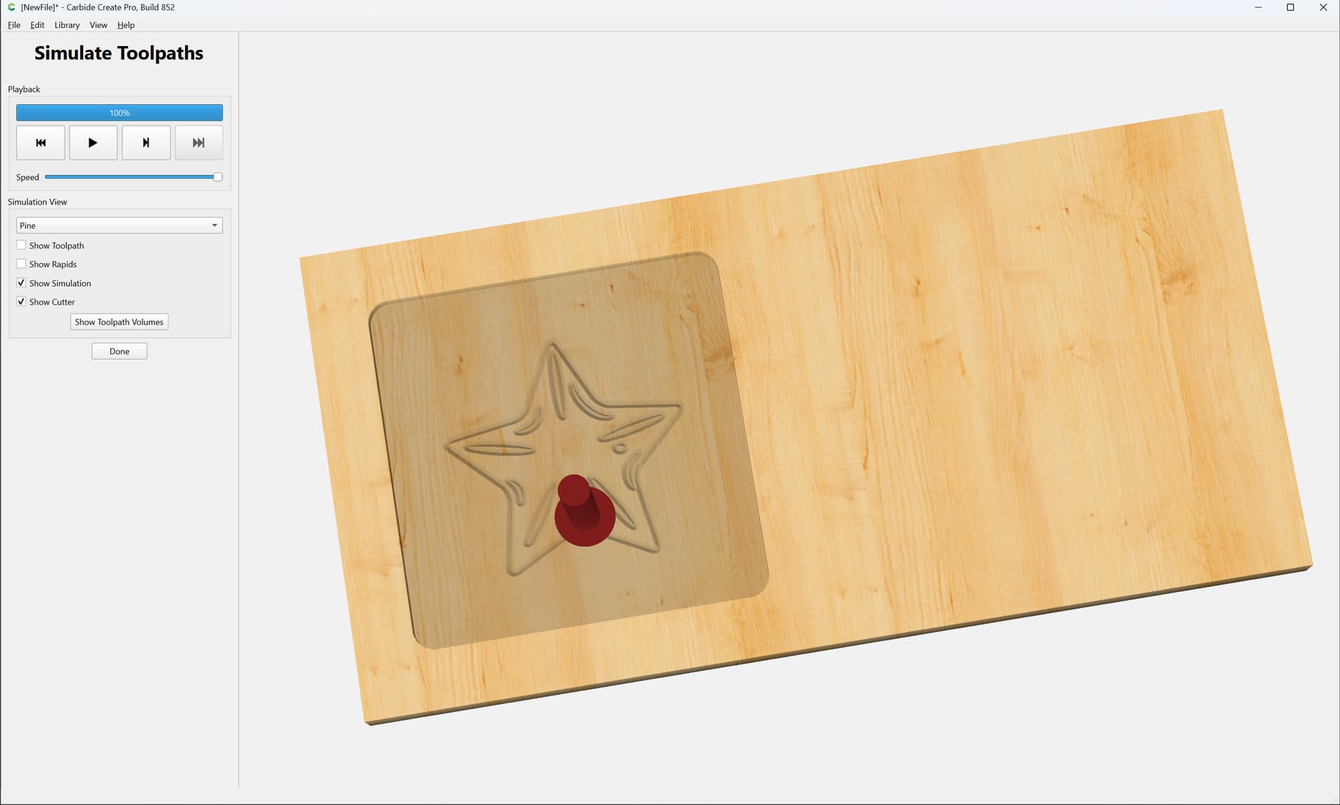

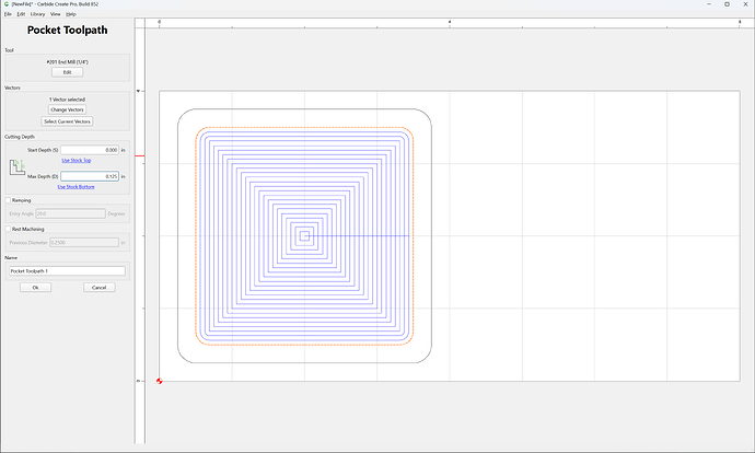

I am wanting to make a coaster that is groves out a bit and then have a design on the bottom. Not sure how to go about this. Can someone help me out?

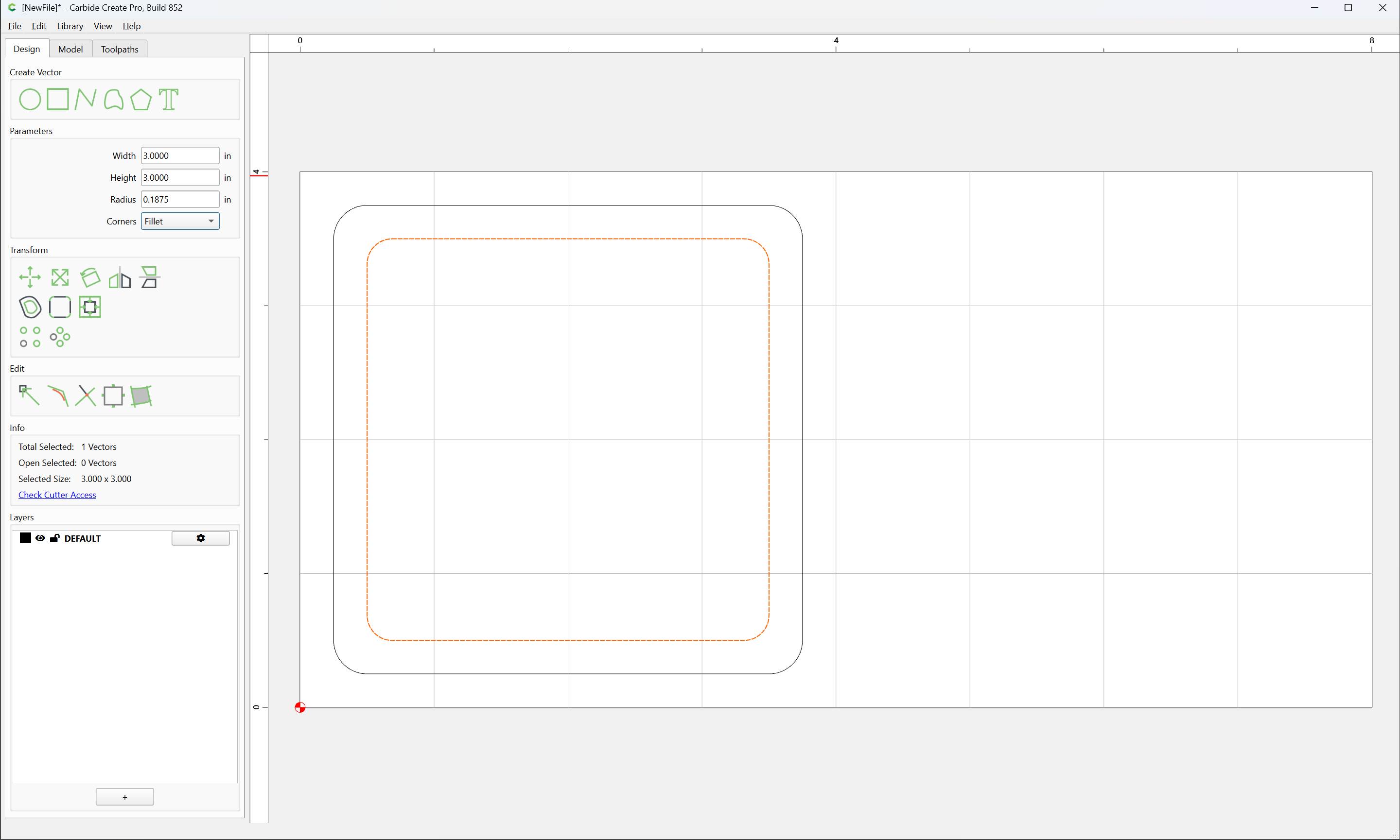

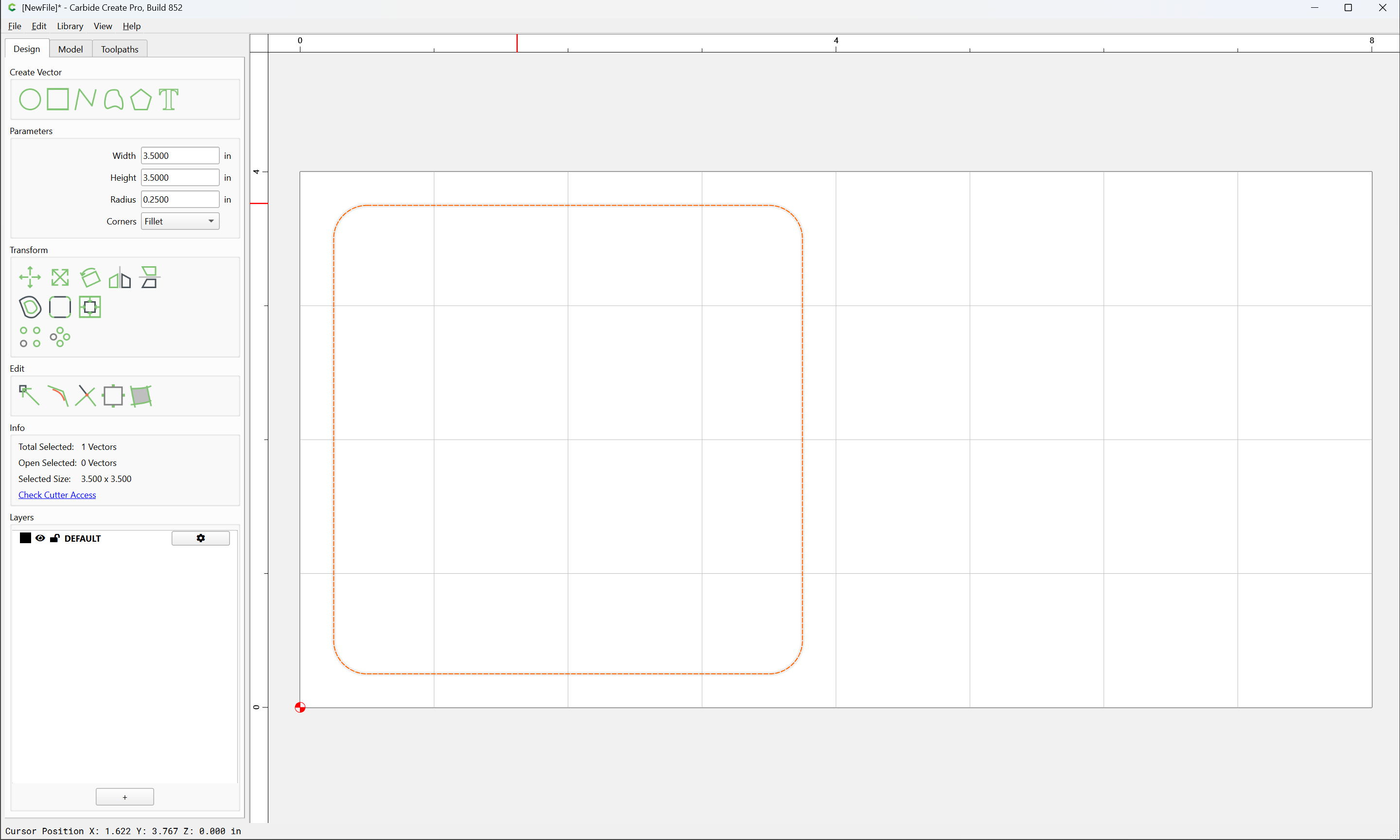

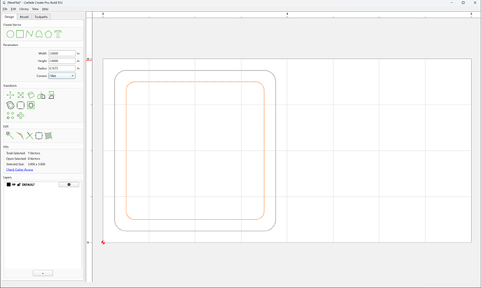

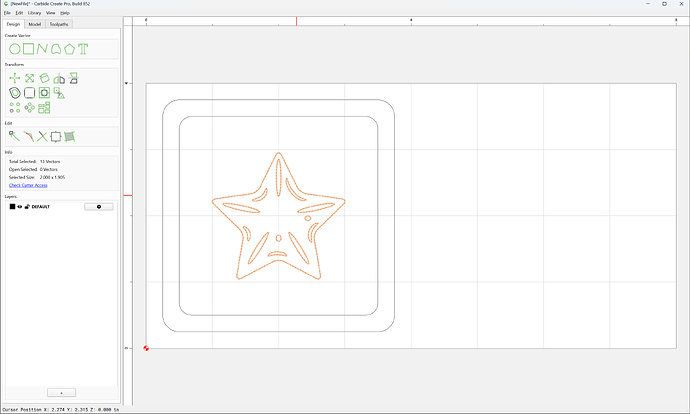

Draw a piece of geometry inset from the edge of the perimeter:

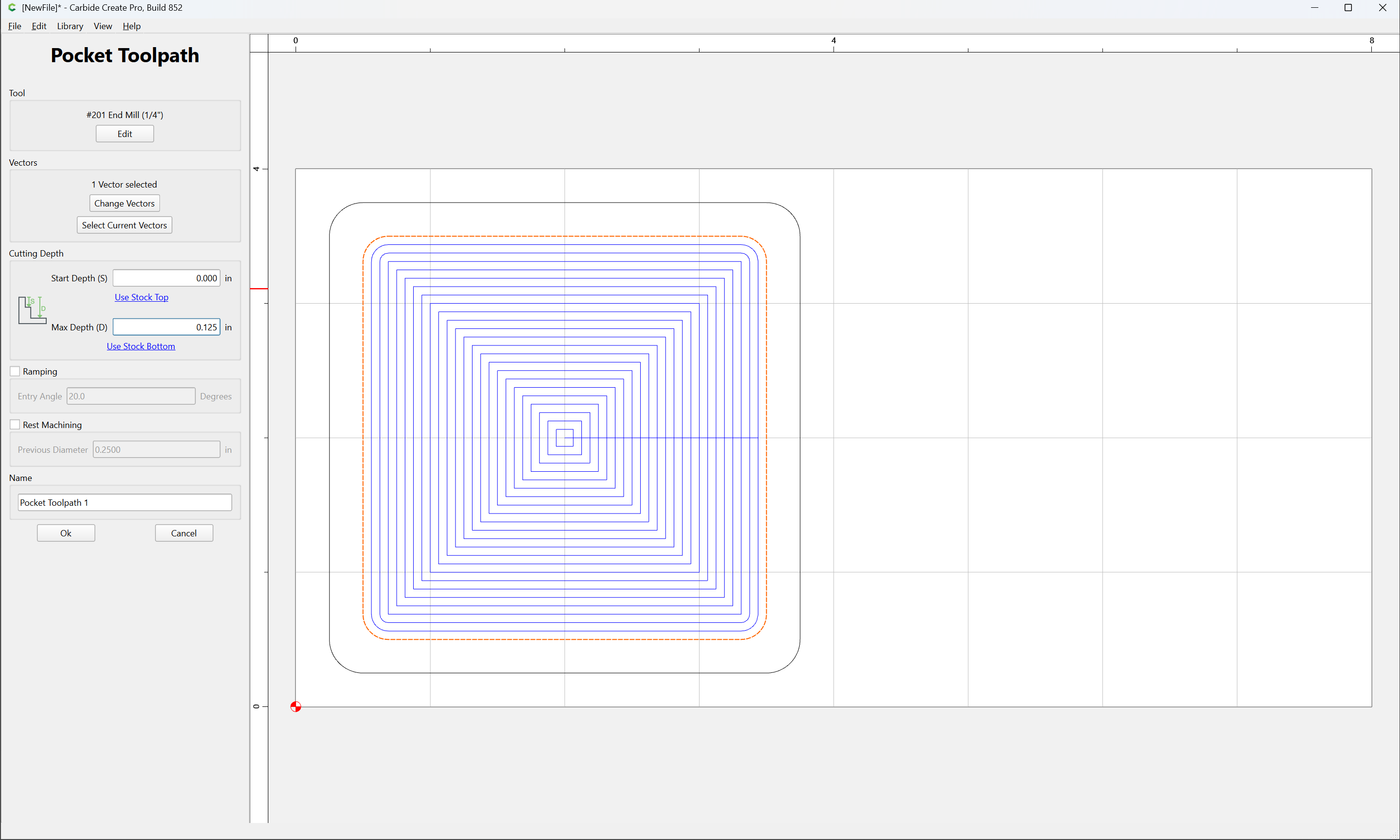

Then assign a Pocket Toolpath to the desired depth:

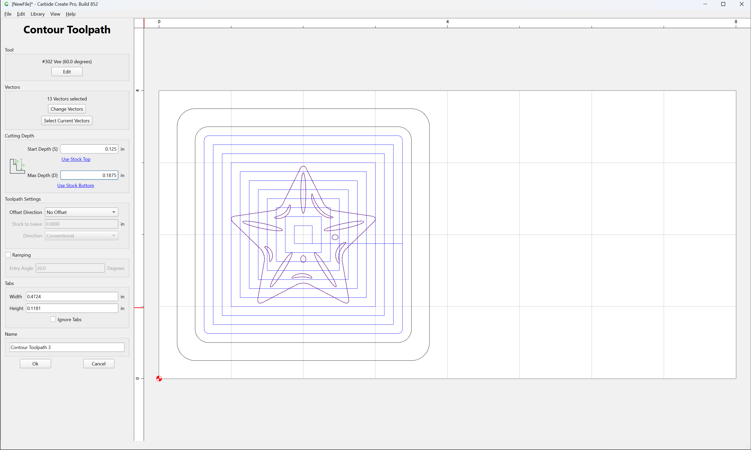

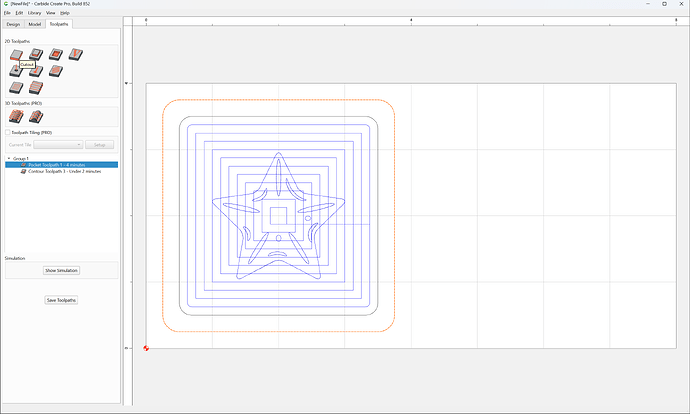

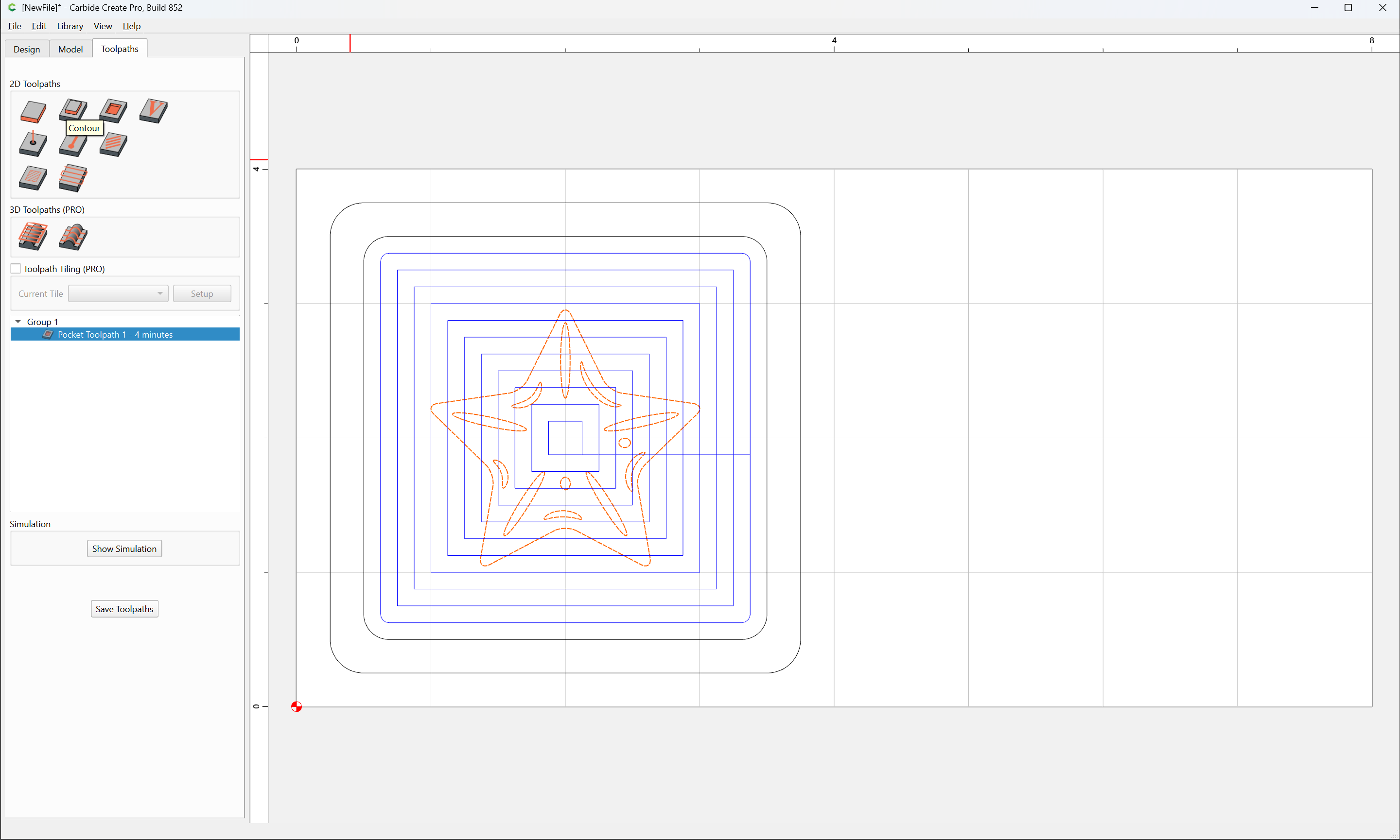

Create a design:

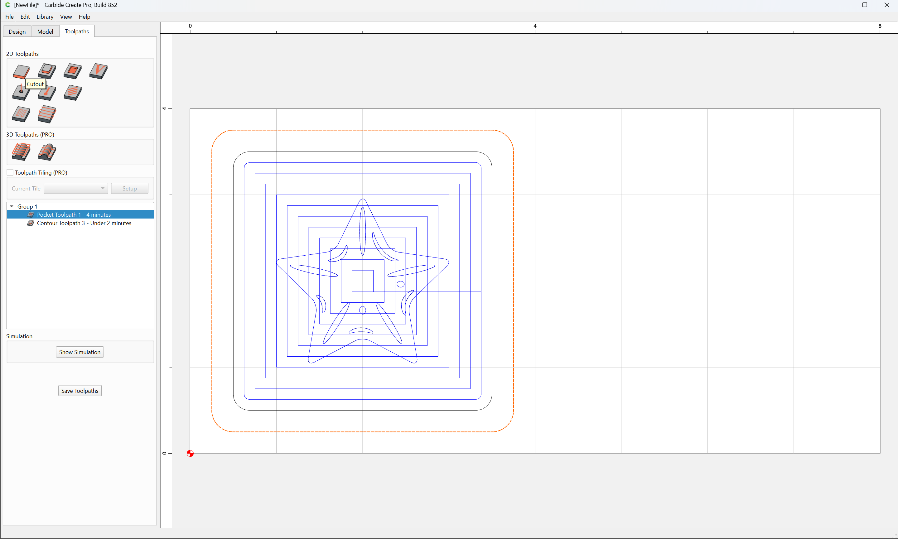

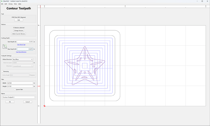

then apply a suitable toolpath to it which starts at the bottom of the previous toolpath:

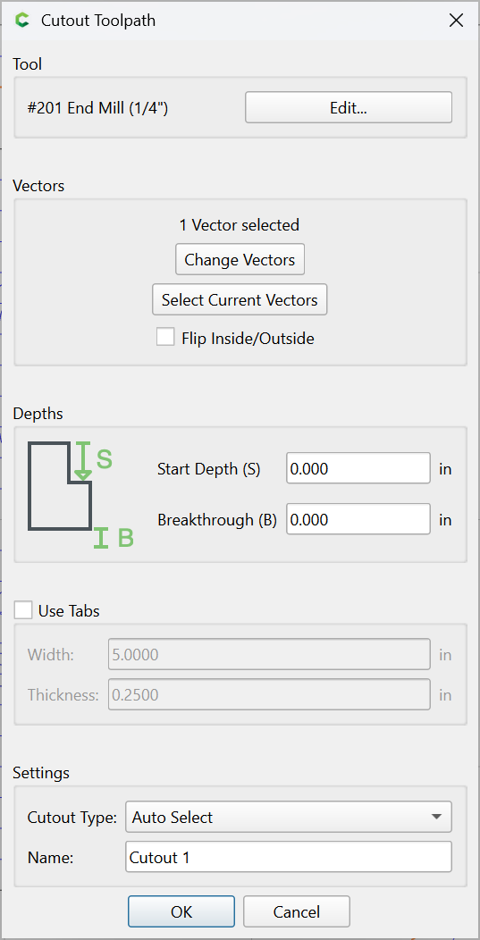

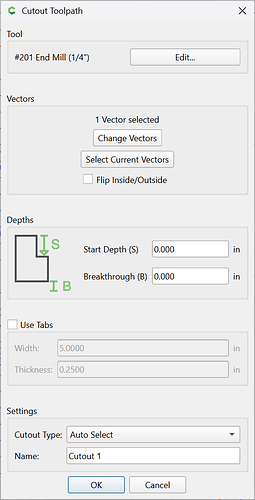

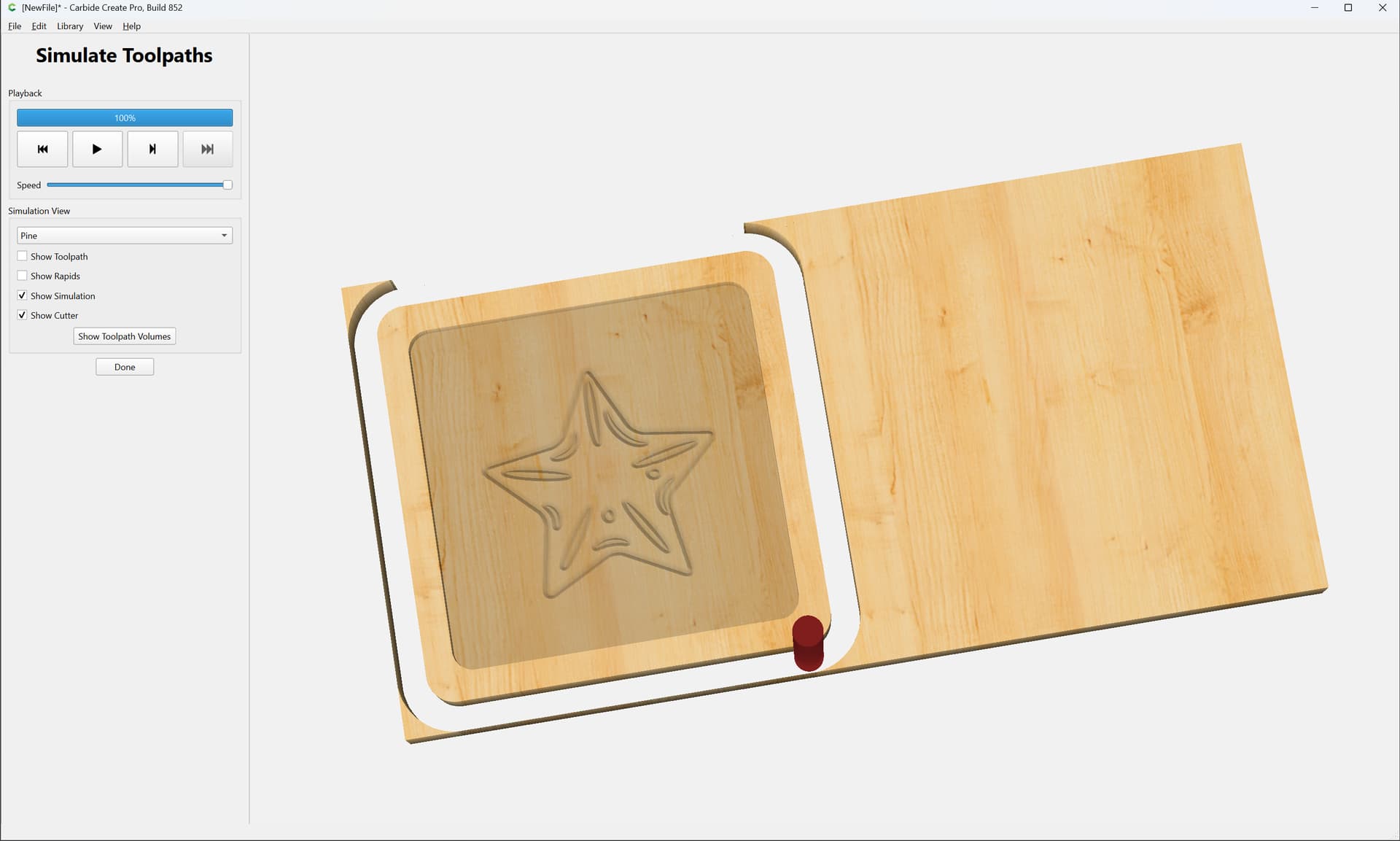

Then, cut to the outer perimeter
Attached as a v8 file:
