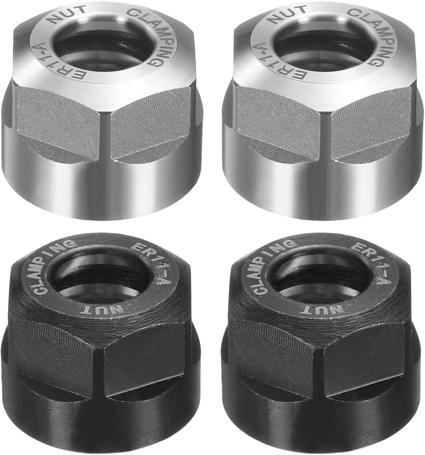

I just recently bought the Carbide ER-11 Router. Since a number of my jobs switch back and forth between the 1/8 and 1/4" shank size - and require that I pop out the collet each time, I was thinking of getting a second collet nut and keeping each size ER-11 collet in the nut - making swapping faster, reducing wear on the collet ring, and just making things easier.

  3. Where can I get an extra collet nut? Will any ER-11 nut do?

Any ER-11 collet nut should work, since it is a standard. However, nuts will come in different qualities. A better quality nut will be better balanced, and have better precision and tolerances.
The precision, run-out and balance become more important as the bit size gets smaller.
If you are in the USA, you could just get them from C3D. The collets themselves can wear-out over time, so getting the extra collet with the nut isn’t really a bad thing.

Hrumph. So, the carbide nut/collet is $25 plus $8 shipping…and I don’t even need the collet. Seems like a lot to spend on stuff I don’t want. I’ll try my luck on Amazon, I guess.
I’m far from an expert, but I did find these ER-11 collet nuts on Amazon:
$13.50 for 4, and they claim to have been dynamically balanced via drilling.

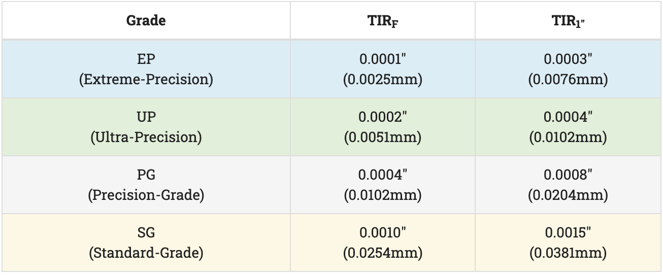

PreciseBits has this to say about what collet grades to get for wood:
  • Pine, fir, cedar and other softwoods: If you are machining softwood, or any other material that tends to compress during the cut and then spring back after the bit has gone by, using a collet grade higher than PG doesn’t really make much sense. There will probably NOT be a noticeable improvement in the quality of the cut using a lower TIR collet. For most projects with small tools, SG collets will probably be perfectly adequate.
  • Hardwood and plastic: Although most hardwoods and plastics do not display as much compression and spring-back as their softer kindred, a PG collet will almost certainly be more than adequate for most projects. As above there will probably NOT be a noticeable improvement in the quality of the cut using a higher grade collet.
Where the SG and PG grades are defined in this table:

I think I’m going to stick with the highest quality collet I can find - but I decided to get the collet nuts that were not the cheapest, but not even $10 per. All I needed was the nut - and even that was for convenience…so, I couldn’t see spending more than 3 times that to get a collet I don’t need and shipping.
