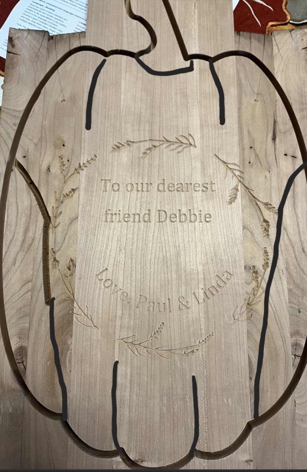

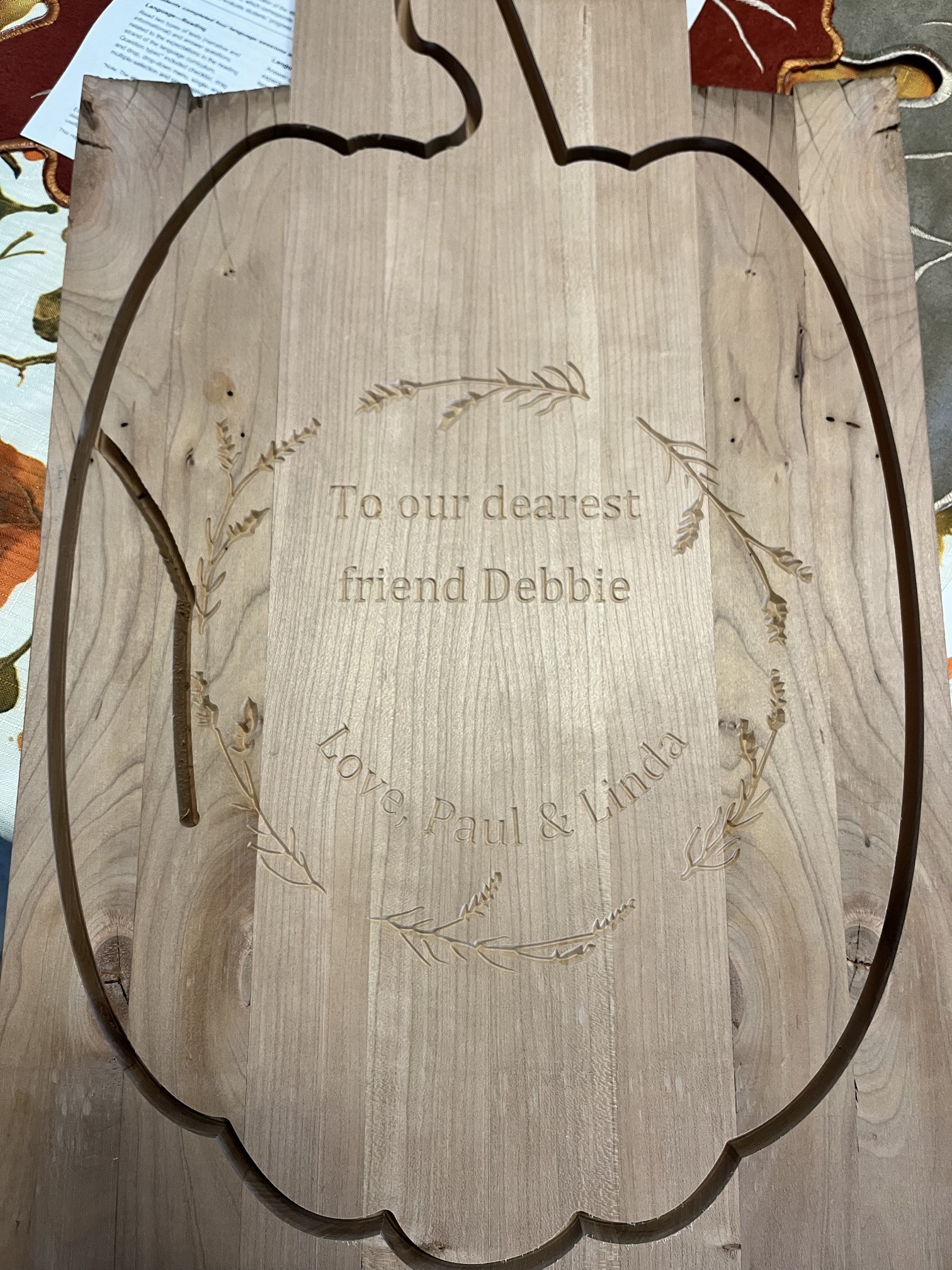

I wonder if there has been any thought, put towards some kind of collision detect when the machine hits a hold down clamp.Our CNC at my work when we hit something we usually get a collision guard or a collision detect it doesn’t go Squirrley like this, a couple projects I’ve made have been ruined because of this I don’t deny that I am at fault for not paying attention to the clamp position, but I feel like this is something I could be prevented with a simple programming option.
Are you sure that this was from hitting a clamp and not the machine getting pulled off-course by cutting a slot as narrow as the tool’s diameter, but quite a bit deeper?
I was sitting there when it happened. It definitely hit the clamp stuttered for a couple of seconds before I could stop the machine and then went Squirrelly. And even left a little mark on my sweetie. Which again is my fault I should’ve verified my clamped location, but you would think that it would detect a crash and maybe go up in the Z and give an alarm.

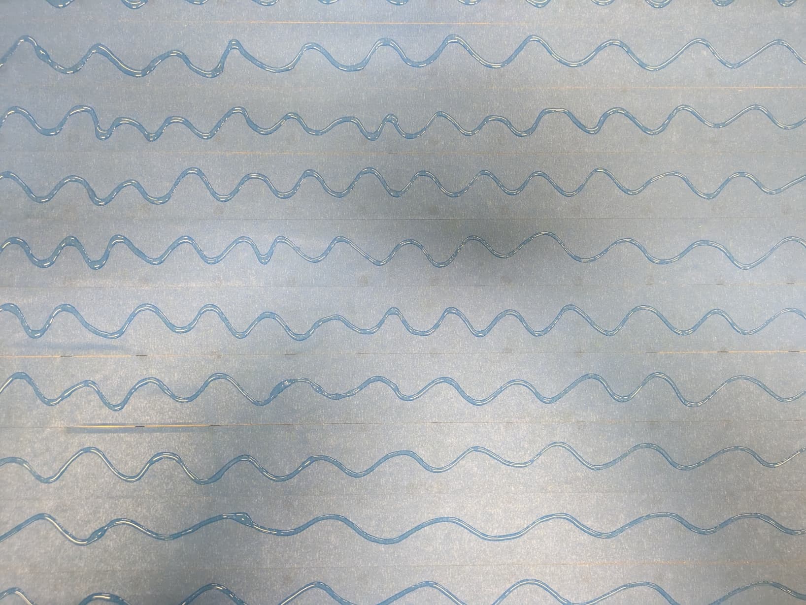

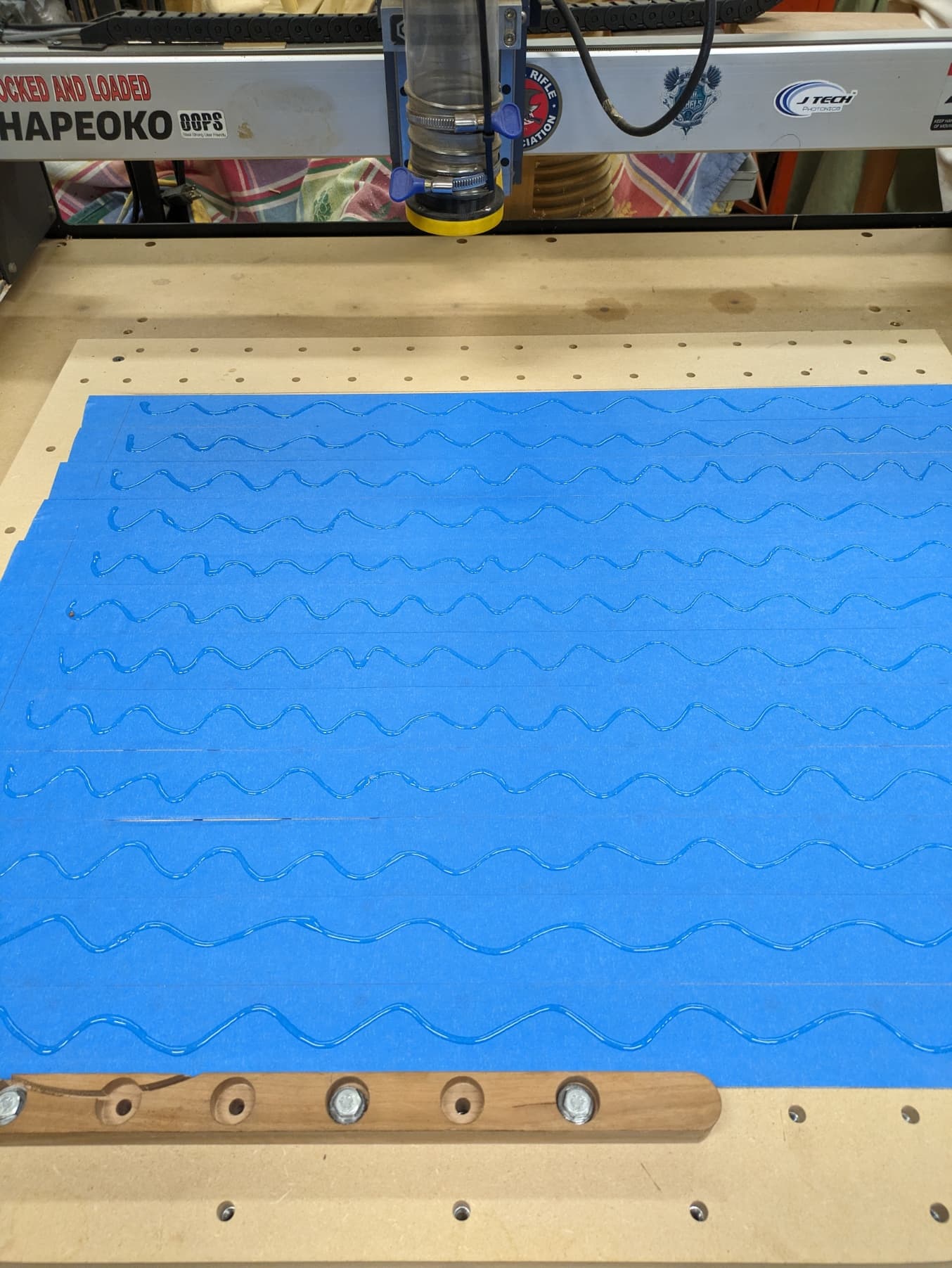

Clamps are always a problem. I suggest you use painters tape and super glue. This is an economical solution and you can never hit a clamp. Additionally I use a long L bracket to get my work piece squared up to the router. If I am going to cut close to the edge and hit my L bracket I remove the bracket after the glue has set.
I use regular 3M blue 2" wide painters tape and TiteBond Medium CA Glue. I have never had a failure.
Here is an example of making some easels on my SO3 XXL using the CA and Painters Tape.
I lay down the painters tape across my Spoilboard. Before placing the tape I make a pencil mark around the perimeter to I know where to stop the tape. I make sure to try to butt the edges together without overlapping them. I make the spoilboard layer a little larger than the material so when it comes time to remove the project I have something to peel up to get a putty knife under. Then on the bottom of the project material I lay the tape out starting out from the bottom row (top if turned over 180 degrees) so my tape lines line up. I trim off the tape from the underside of the project even with the edges. I spread the super glue in an S pattern. Press the material down and you have a little wiggle room to get it properly lined up. Hold the material down for really big pieces a minute or so and let it set up for a few minutes while you get your zeros set, project loaded and a bit installed.
After the glue has set remove the L bracket if you might cut through it. If you are only doing a vcarve or something you will not cut through just leave the L bracket in place. It is the tape and CA that holds the project down but the L bracket helps make sure the project is square to the router.
Project material measurement is important but I use bottom of material in CC and get very little scaring of my spoilboard. I just X and Y as you usually would and then jog off to a clear space on the spoilboard and use your BitZero to Z zero on the spoilboard.
This project was 9" X 18"
