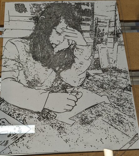

What do you use for non metallic colors for etchings ?

Specifically, what are you referring to? Wood? Metal? Using router bits? Etching tool like McEtcher?
I was referring to etching in acrylic. Sorry for the lack of info.

On rubber, you can refloat Rub n Buff with mineral oil after it dries. I assume on acrylic it will be the same. Acrylic paint, that would be too easy an answer for me to come up with.

Here is black acrylic paint on the etching. I found it worked to use as a paste, directly apply to grooves.
Wipe with dry paper towel, then damp. Hold to the light to find the smears and damp hard wipe it clean.
I used a lot of 1/2 sheets split in half.
