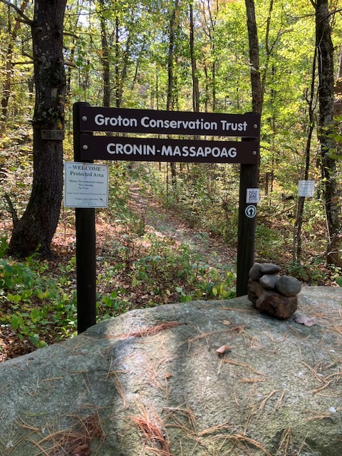

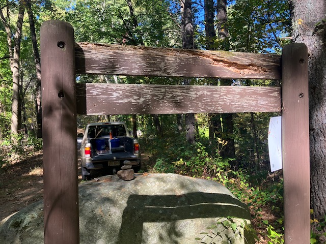

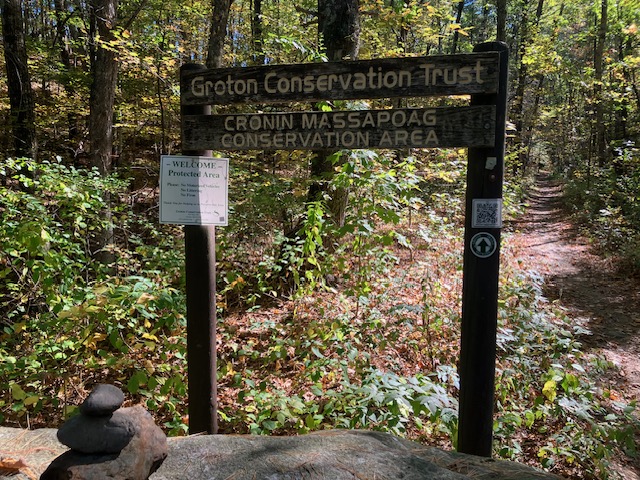

They’re not fancy but I am carving signs for our many conservation properties in town to replace the wooden signs that are rotting. One of the volunteers installing the signs sent me before / after shots.

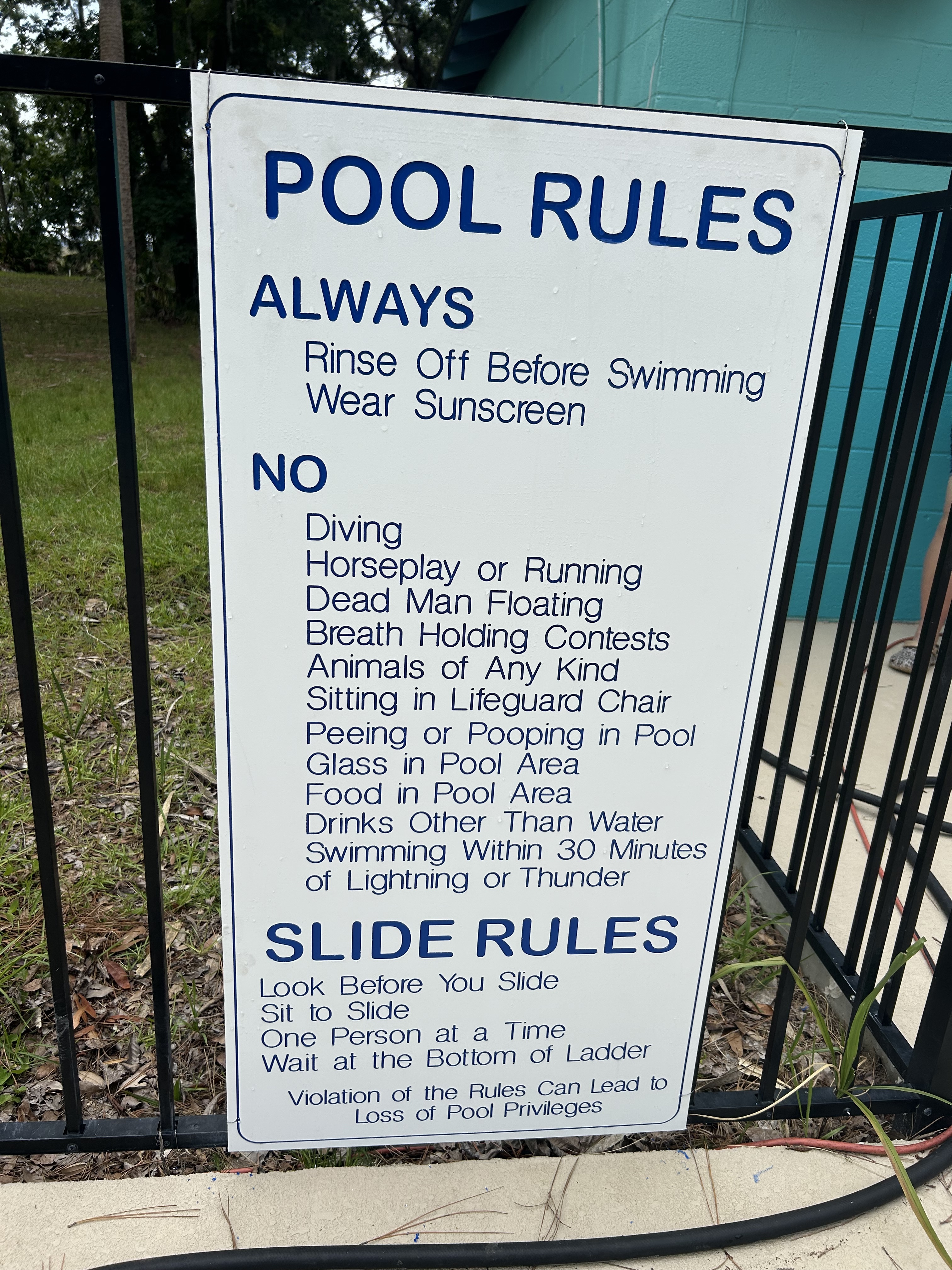

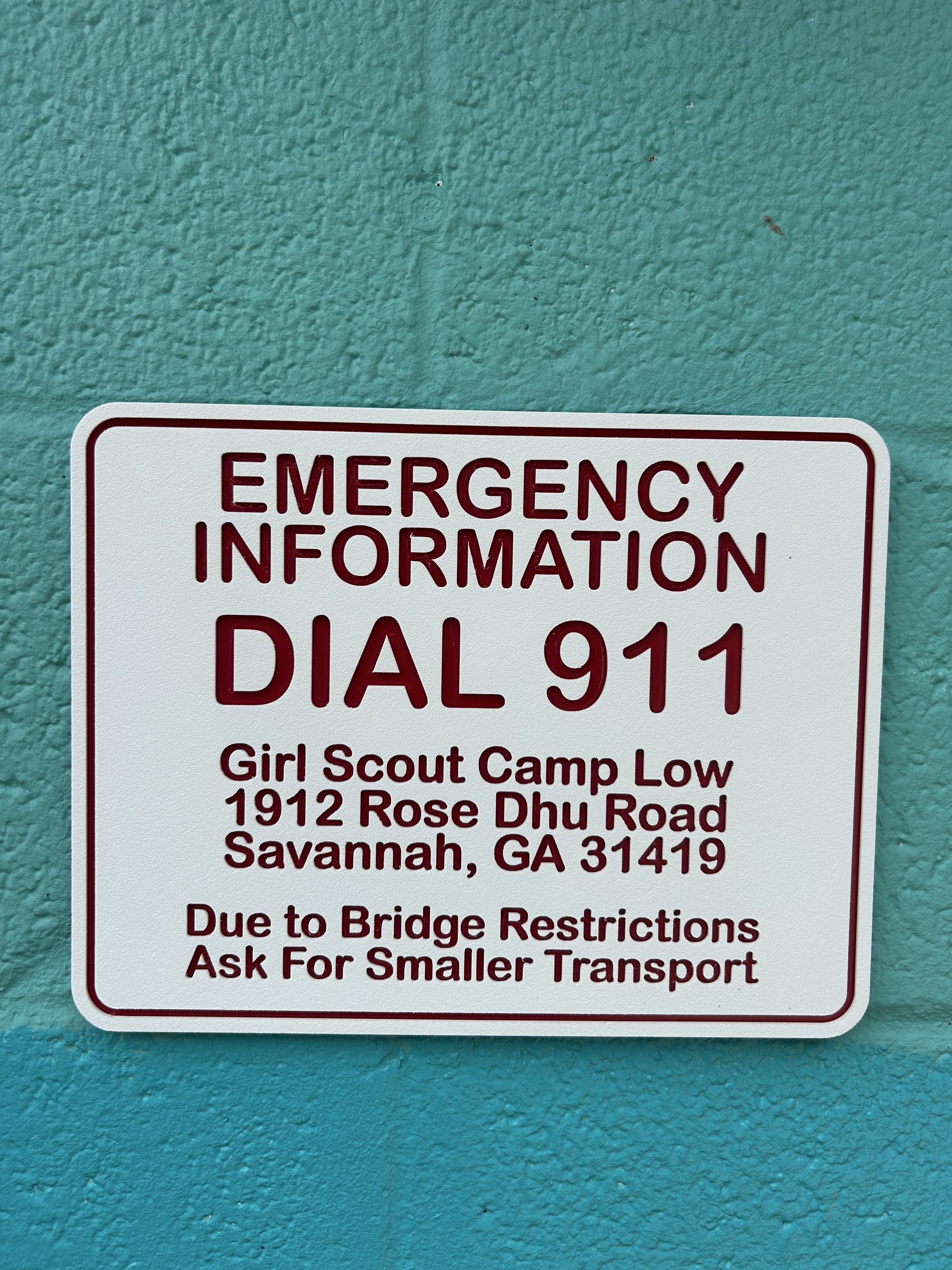

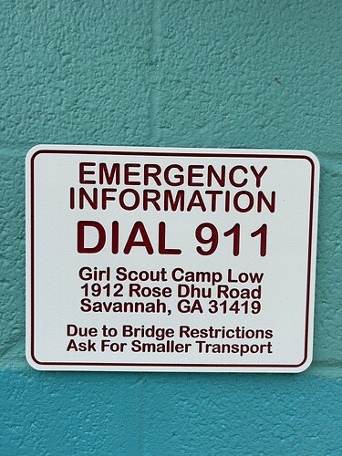

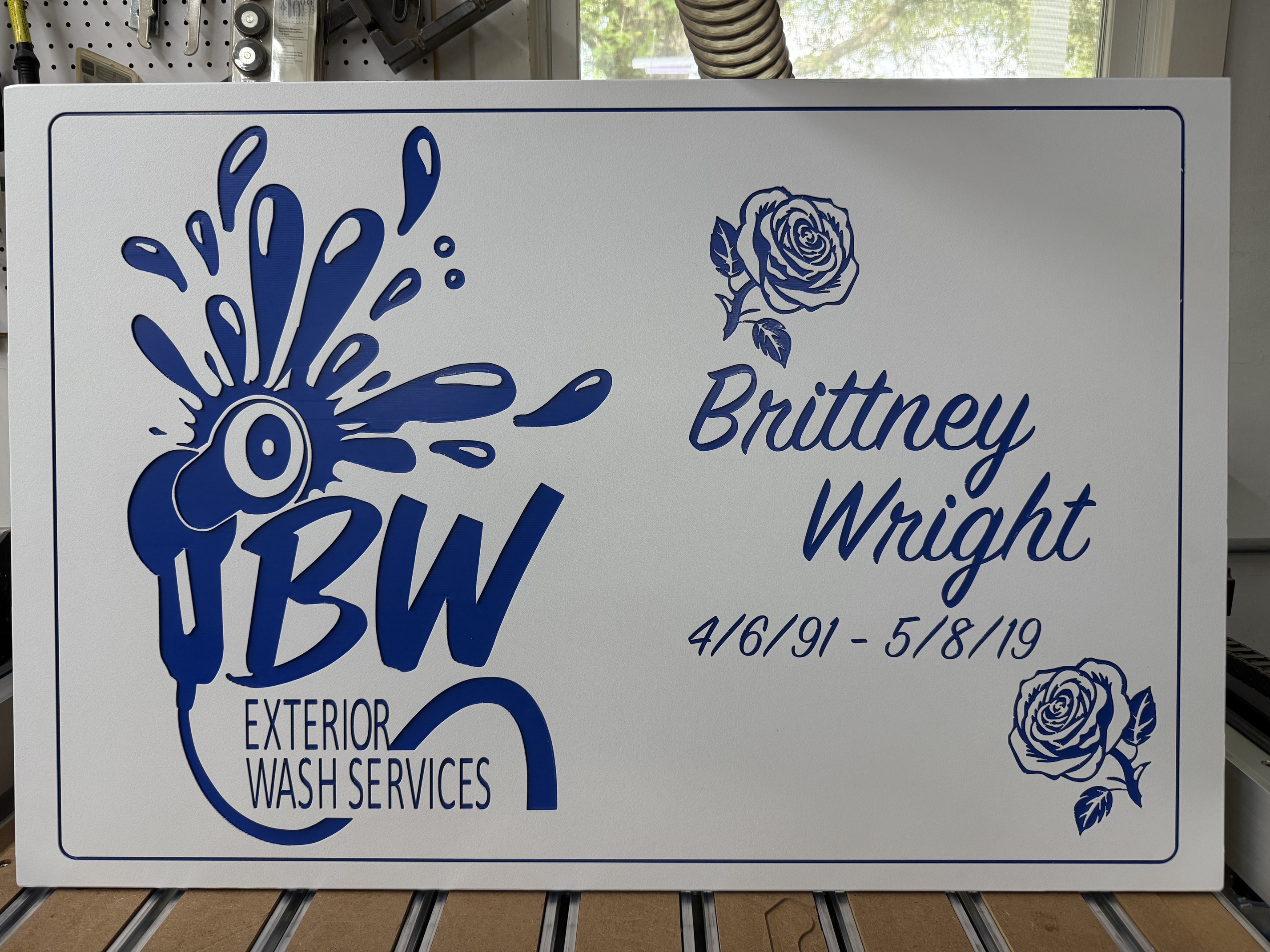

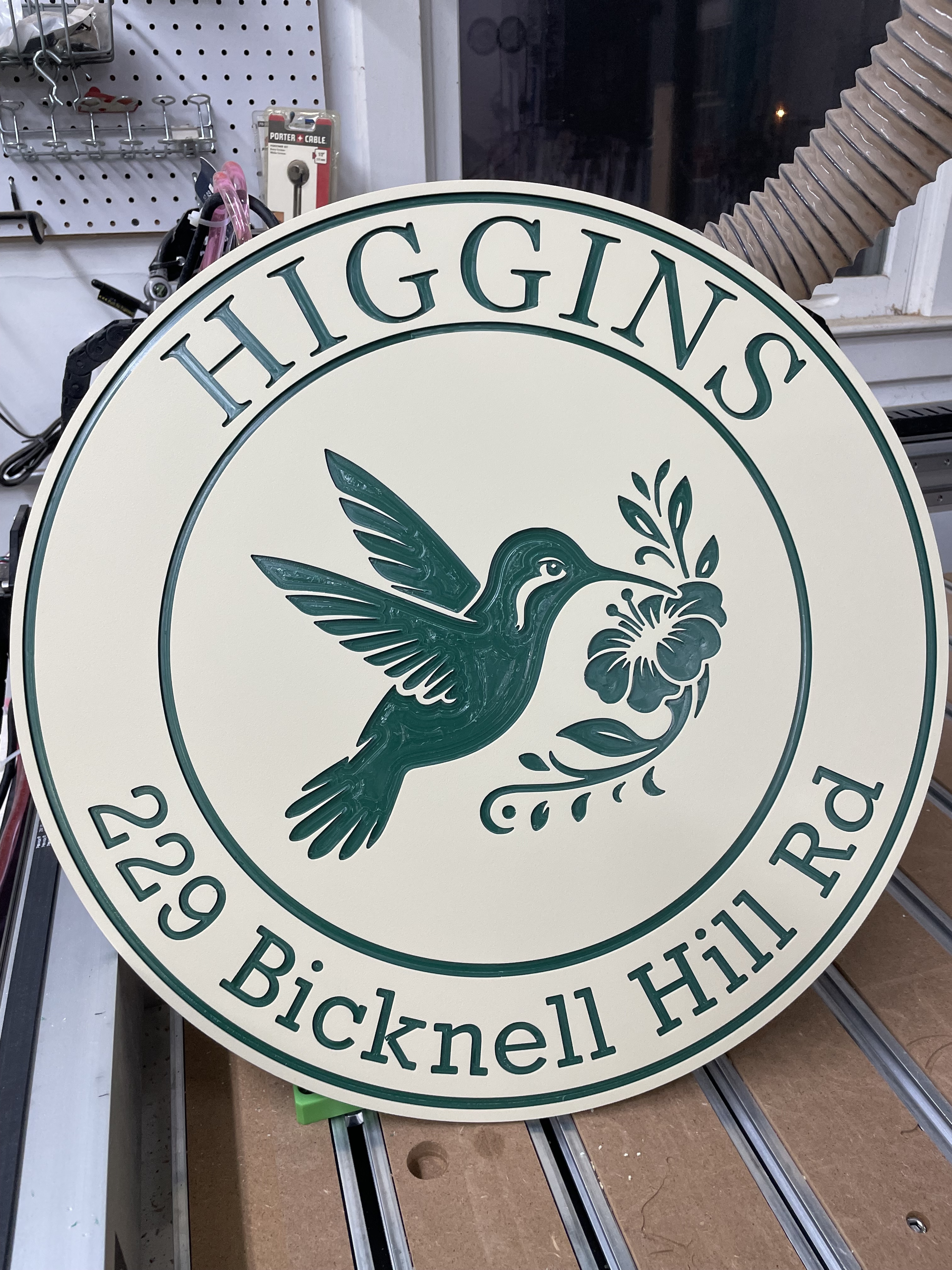

Here are a few of the ColorCore projects I have done.
CICworkshop
limited selection, but very nice prices.
Colorcore is pretty easy to work with. The biggest issue during carving is getting rid of the load of plastic shavings (I reserve the dust collector for wood).
