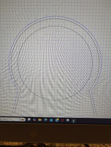

Concave pocket?

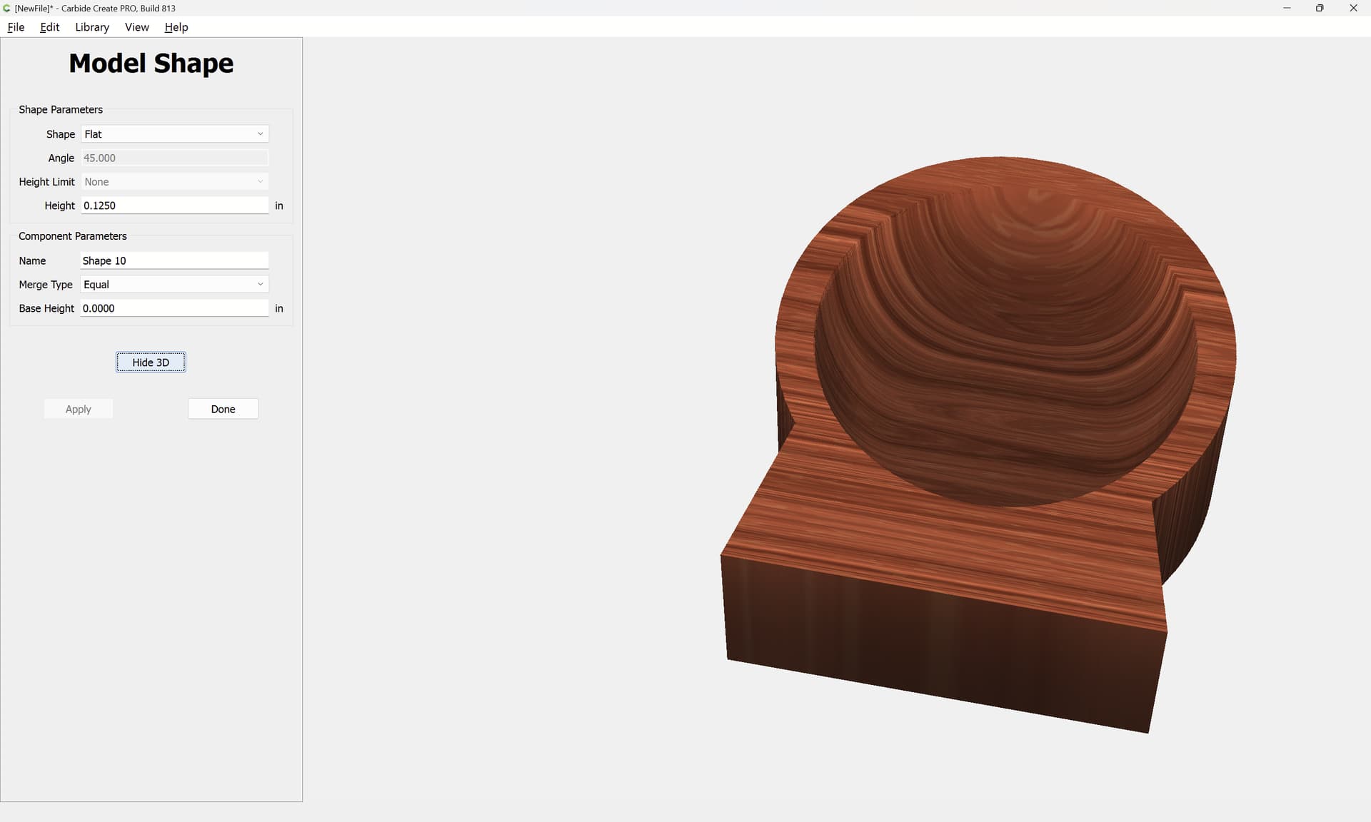

I’m wanting to make this inner circle a concave pocket. This circle is small (22mm diameter). And I’m wanting this concave pocket to be only 2 or 3mm deep at the center then smoothly ramping up and out from there. Is this possible in CC pro?

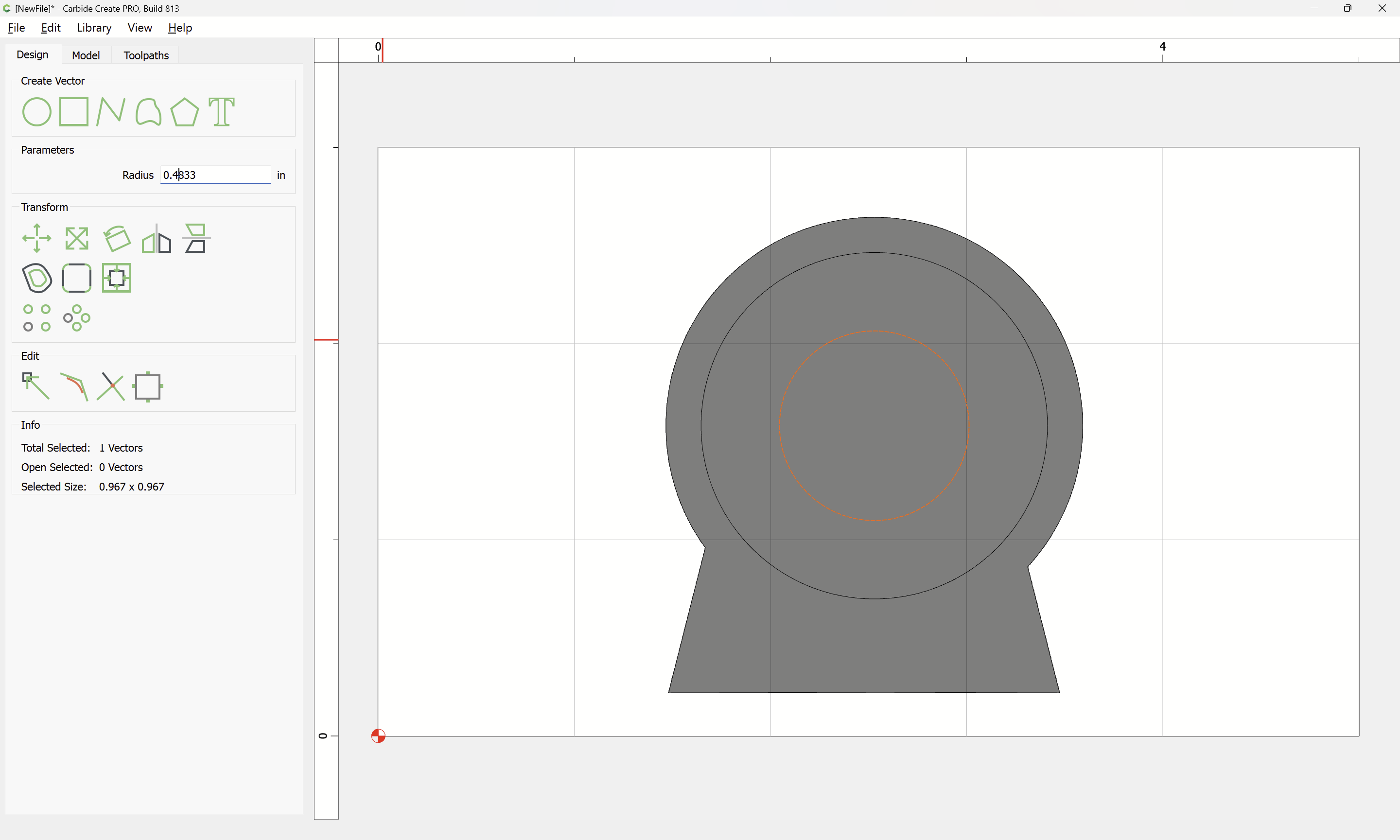

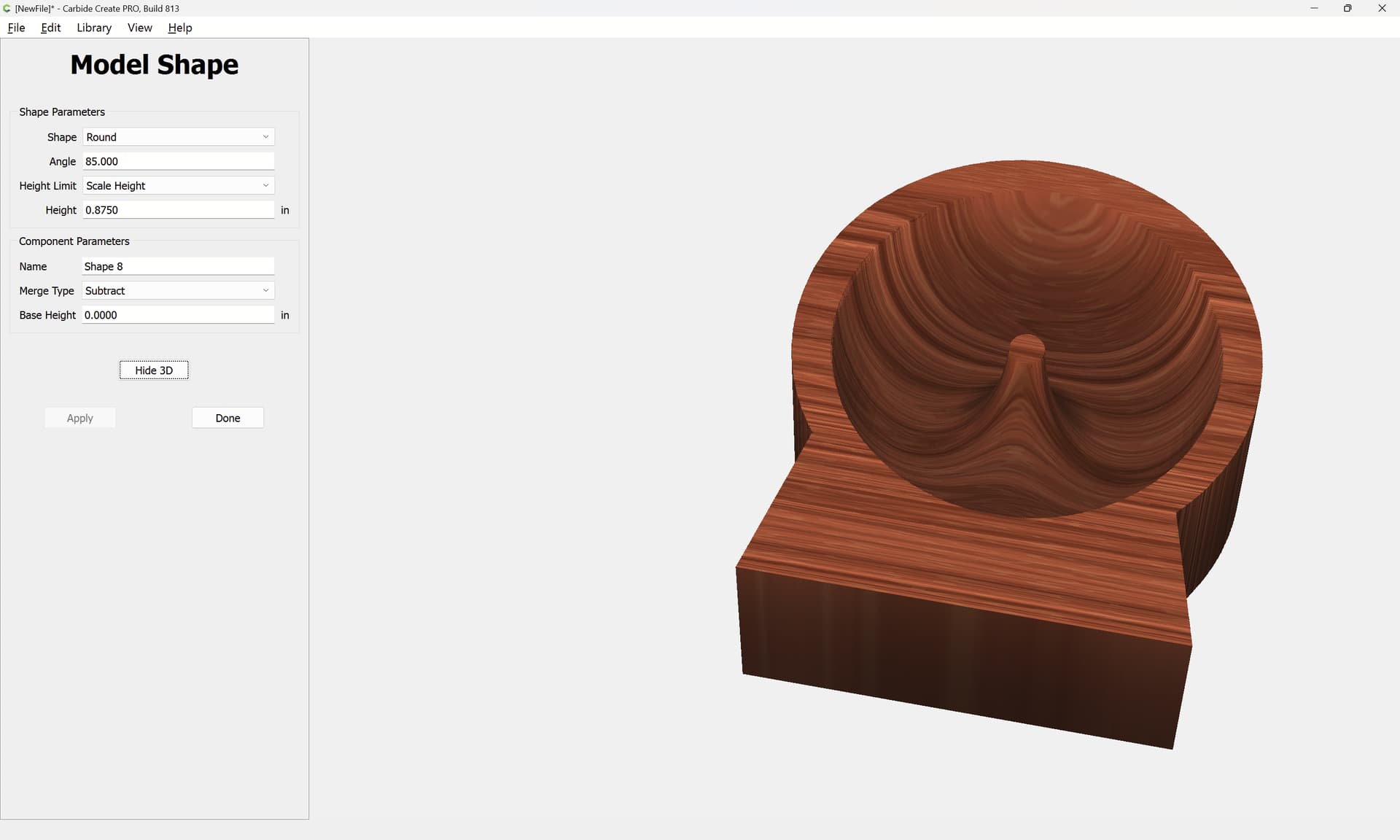

Yes, this can be done, but it requires a bit of math/checking to get the thickness.
Basically, it looks to be the same as a spoon/scoop, for which see:

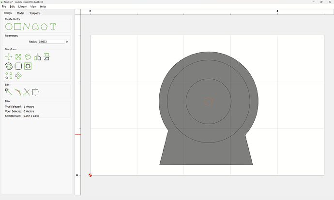

So one draws the geometry:
Note that the surrounding geometry must be closed so that it may be removed from and modeled in 3D:
Apply | Show 3D

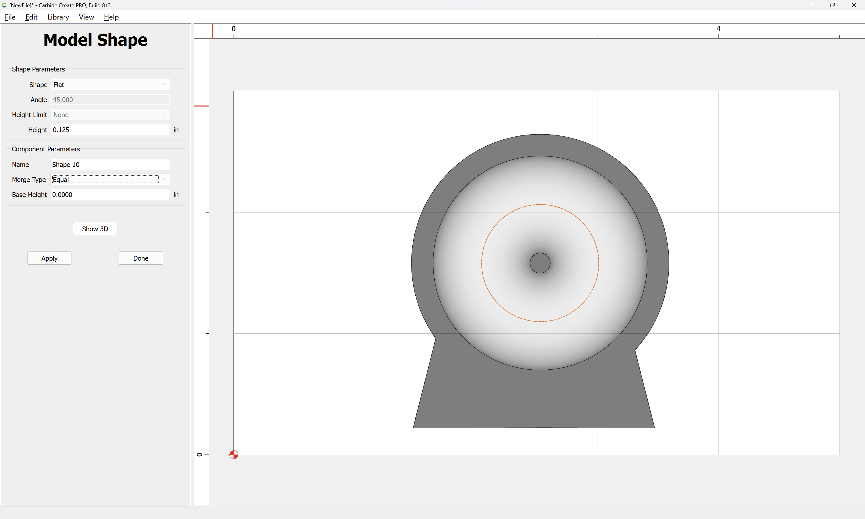

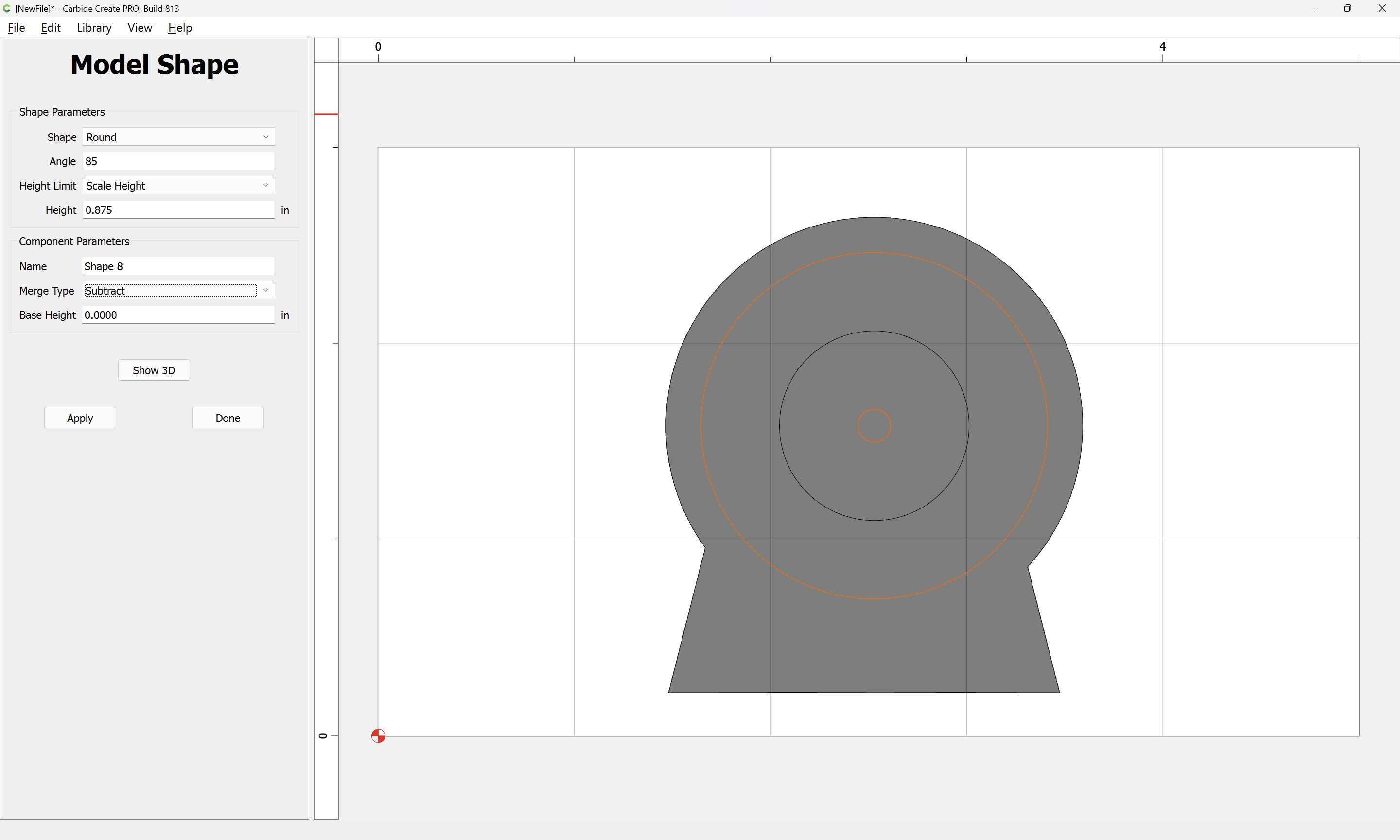

Then select the circle and make appropriate settings:
Apply | Show 3D

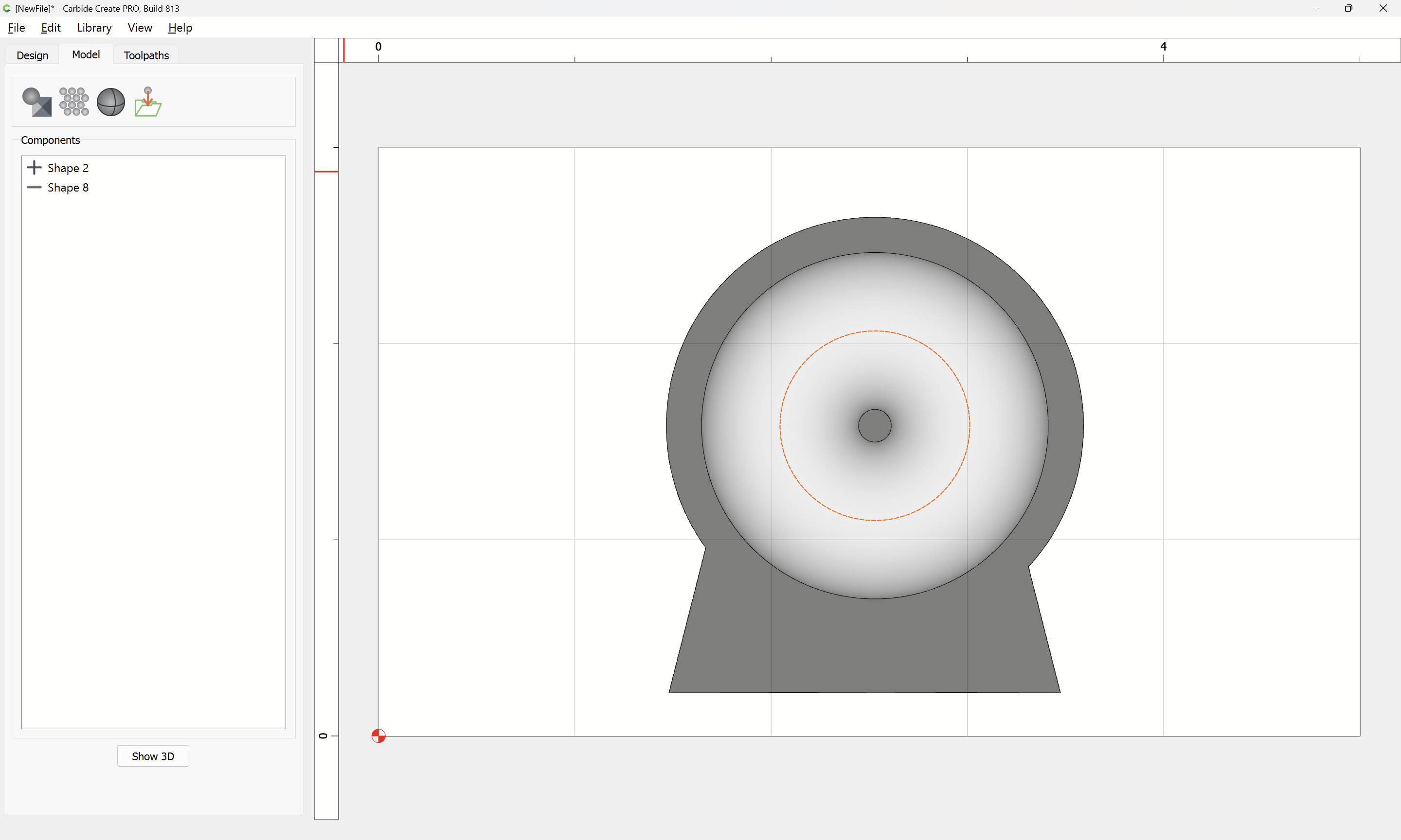

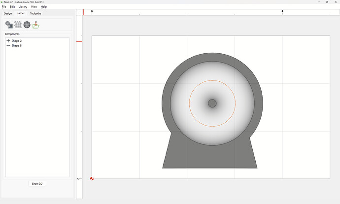

To check the depth draw a small piece of geometry:
Then model it to be equal in height to the dimension which you wish to check:
Apply | Show 3D
(then delete/disable the object after)
If you want a flat bottom pocket, this also can be done, but it requires some additional geometry:
which previews as:
Then select the middle geometry:
Thanks! I’ll give this a try tonight. Is there a certain bit I should use for this? Ball mill maybe?

Please see:
https://carbide3d.com/hub/courses/create-pro/3d-toolpaths/
You will want to use the largest ball-nose tool available for the interior — the top/sides could probably be cut with a square tool.
