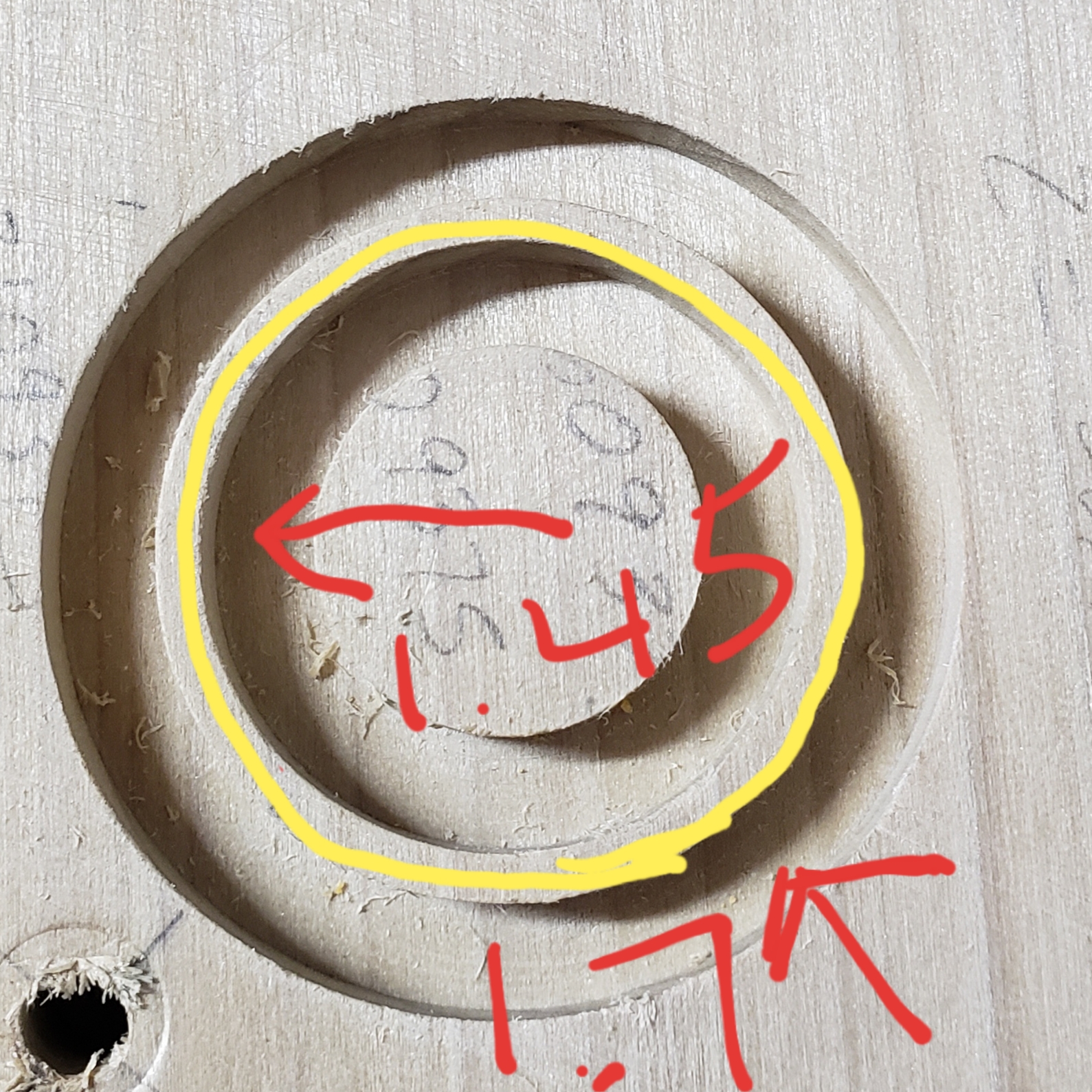

I am having issues milling concentric circles. I have had my Shapeoko 3 over a month. In the time I have pretty much taken it apart 3 times. I have squared the frame. It’s dead on. I squared the gantry. I have used the 123 blocks to square the router mounting bracket. I have milled the supplementary waste board 2x. I used the 2 end mills clamped at both ends of a small piece of wood turning in a 360° to check the router is plum. I have calibrated belt strech more times than I care to remember. I have checked and rechecked the v wheel, eccentric nuts, all bolts and set screws for tightness. Yesterday I was ready to throw it in the yard and set it on fire. I have been thru all the tutorials and watched tons of Winston’s videos and it seems no matter what I do it is not cutting the circular dimensions that I give it. So after all that explanation heres what it’s doing. In simple terms. I make a 1.7 inch circle with an outside cut. Then I drop in a 1.45 inch circle with an inside cut both at .25 inches deep. This should leave me with a .25 inch “wall” if you will between the cuts but it constantly comes in at .125 thick or less. The ID is 1.45 but the OD is roughly .125 small of the 1.7 it should be. I’m not looking for .001 accuracy here but its imperative for my application that if I say cut 1.7 inch OD circle that it does so. Any thoughts? You knowledgeable CNC guys go easy on me and use lamens terms. I am a carpenter. I dont have a machinist background. Thanks.

Ok. To make sure we are on the same page. I make and inside cut tool path at 1.45 inches. Then an outside cut tool path at 1.7 which leaves me with the yellow ring or “wall” which measures correctly inside but incorrectly outside over all.

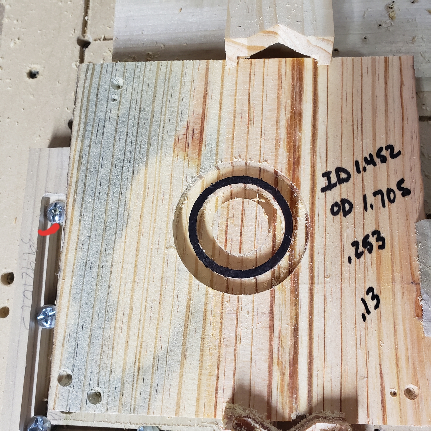

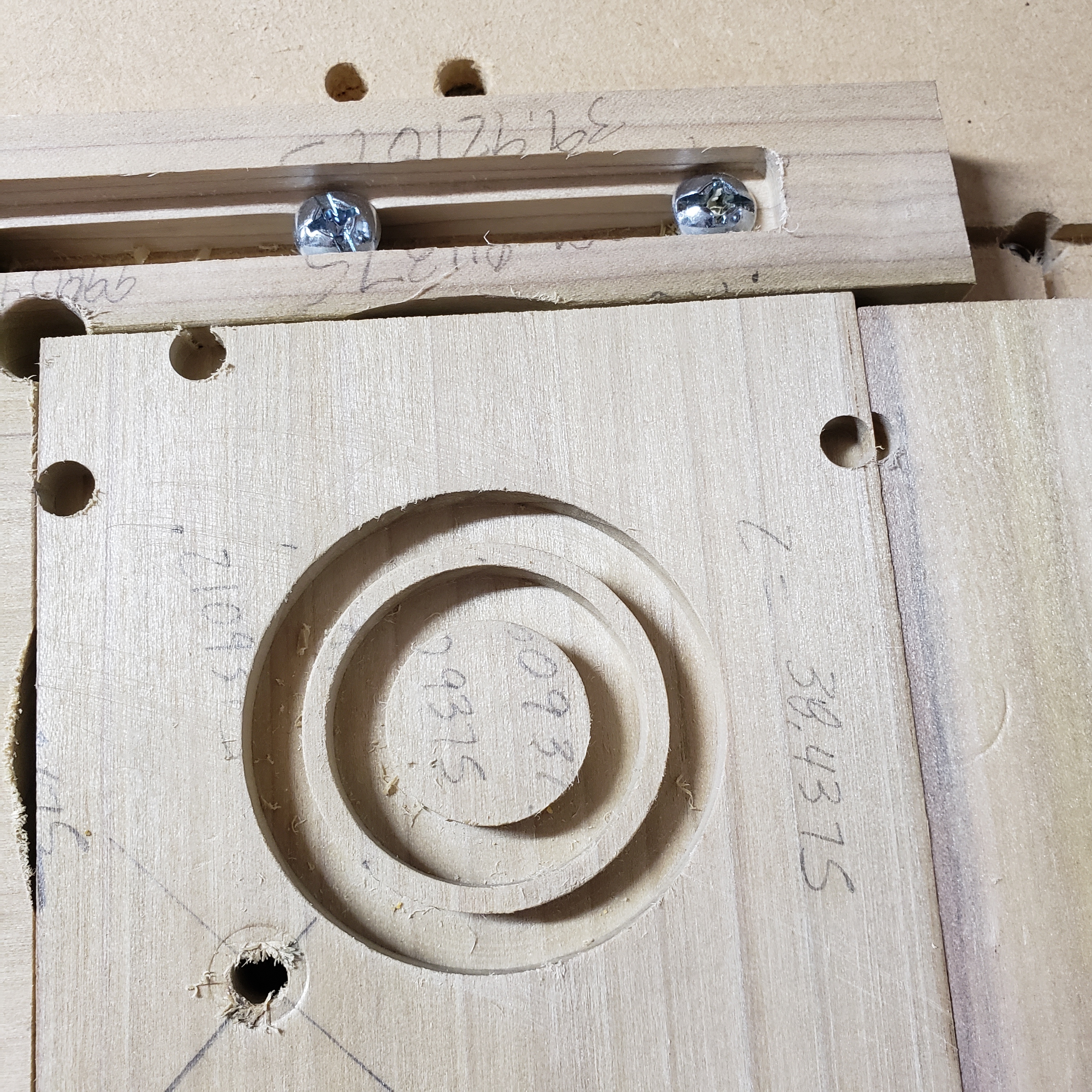

I just tried the same cut, soft pine, 0.25 flat end (supplied with the XXL) 1.7"outer 1.45 inner and came out with this.

Ok so I took Wills advice and used a vee bit and recalibrated belt strech. I also cut a slot and entered .266 for my .25 end mill and now my cuts measure 1.7 OD and 1.45 ID just like I programmed. So what’s not computing with me mathematically is I subtract 1.7 - 1.45 and get .25 left. I just cant seem to wrap my brain around that for some reason.
I should have added that the thickness is measuring. .125 to .13 depending on where I measure the ring.
