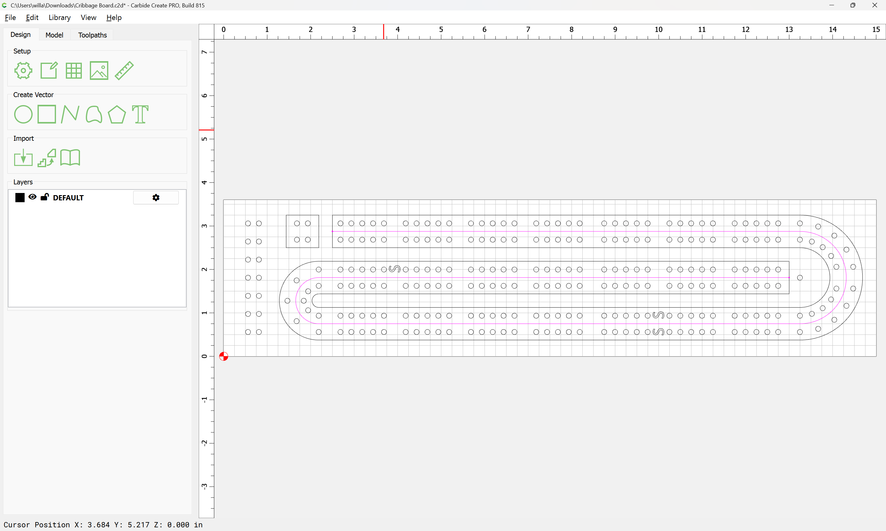

Given a design:
The question is:

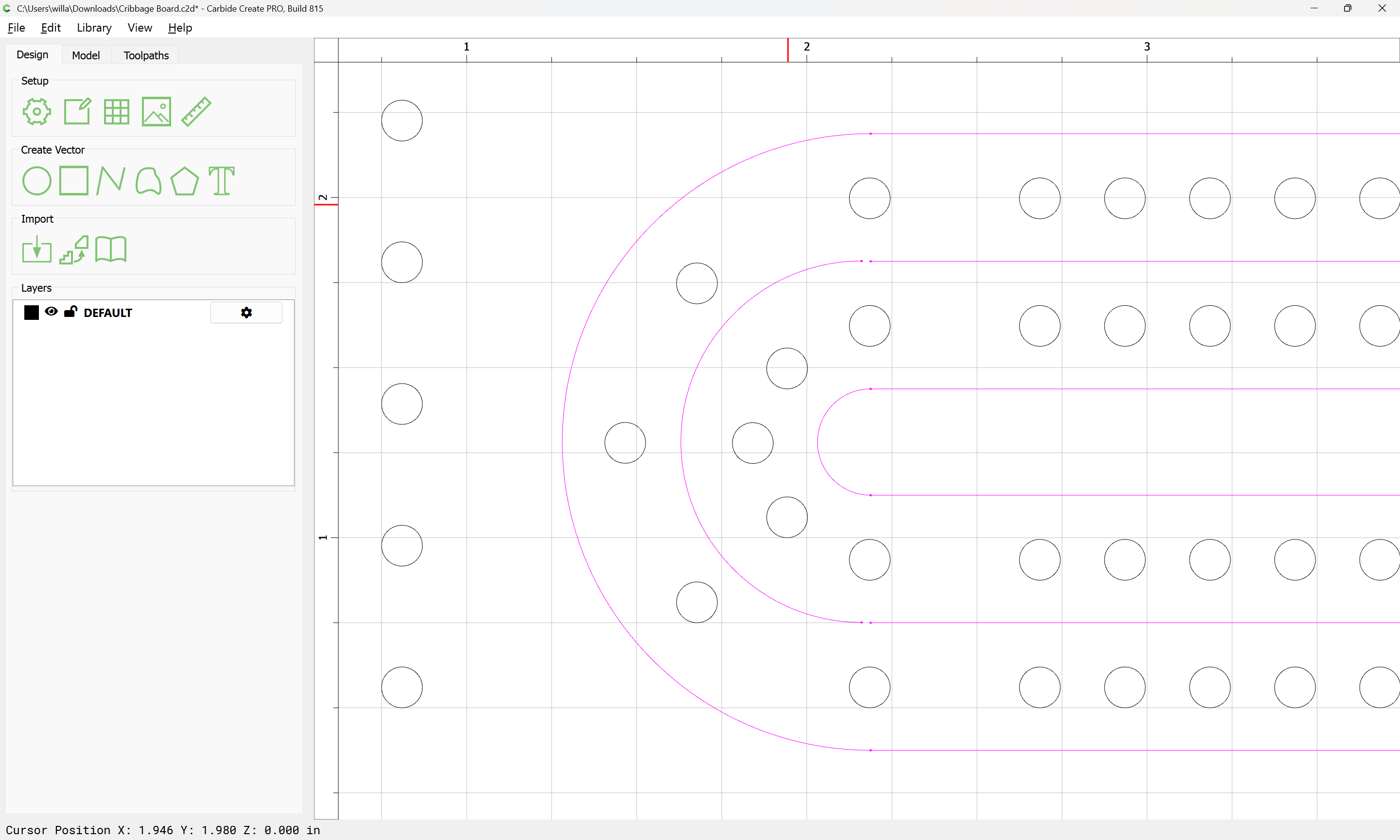

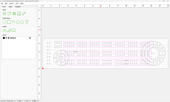

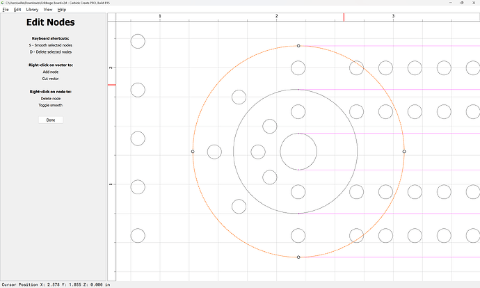

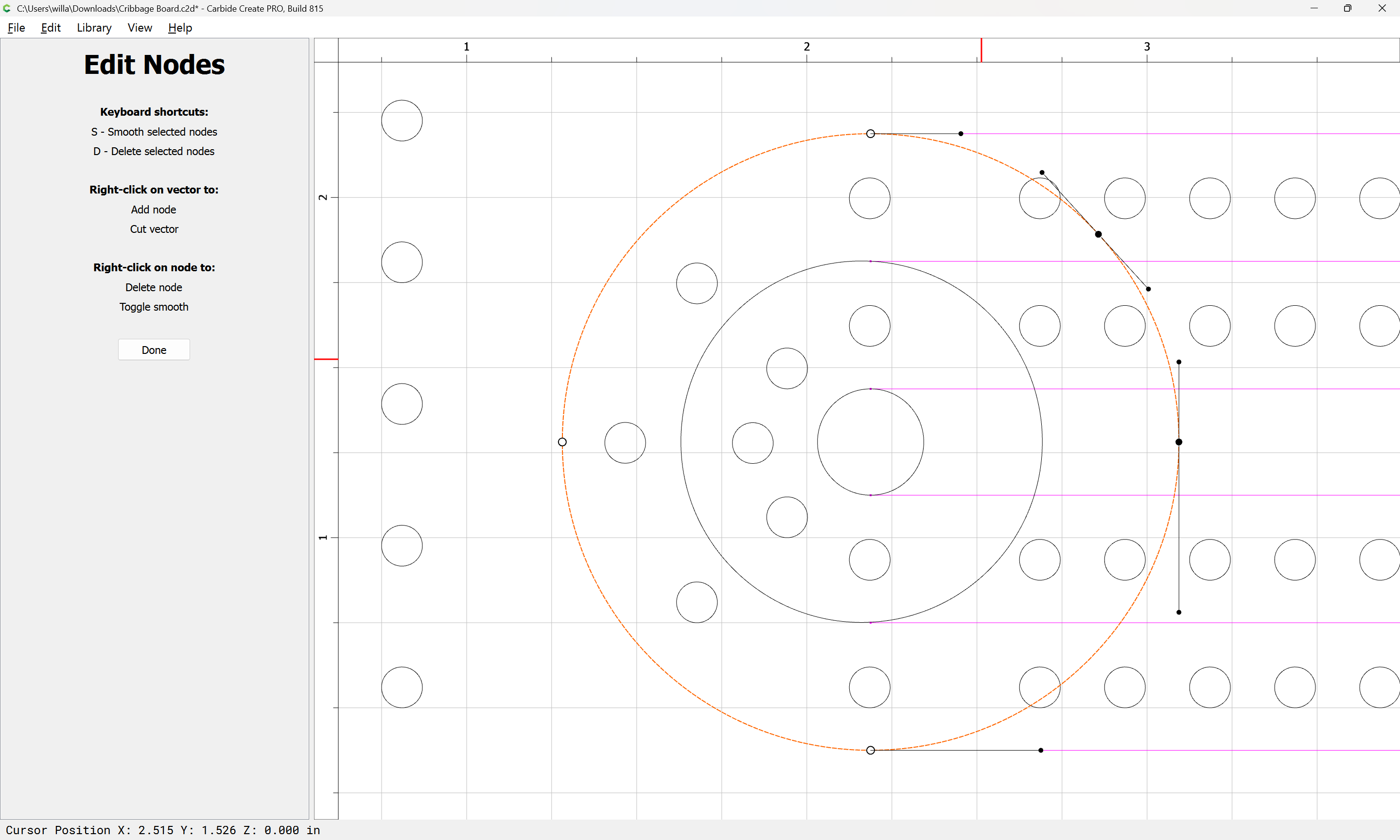

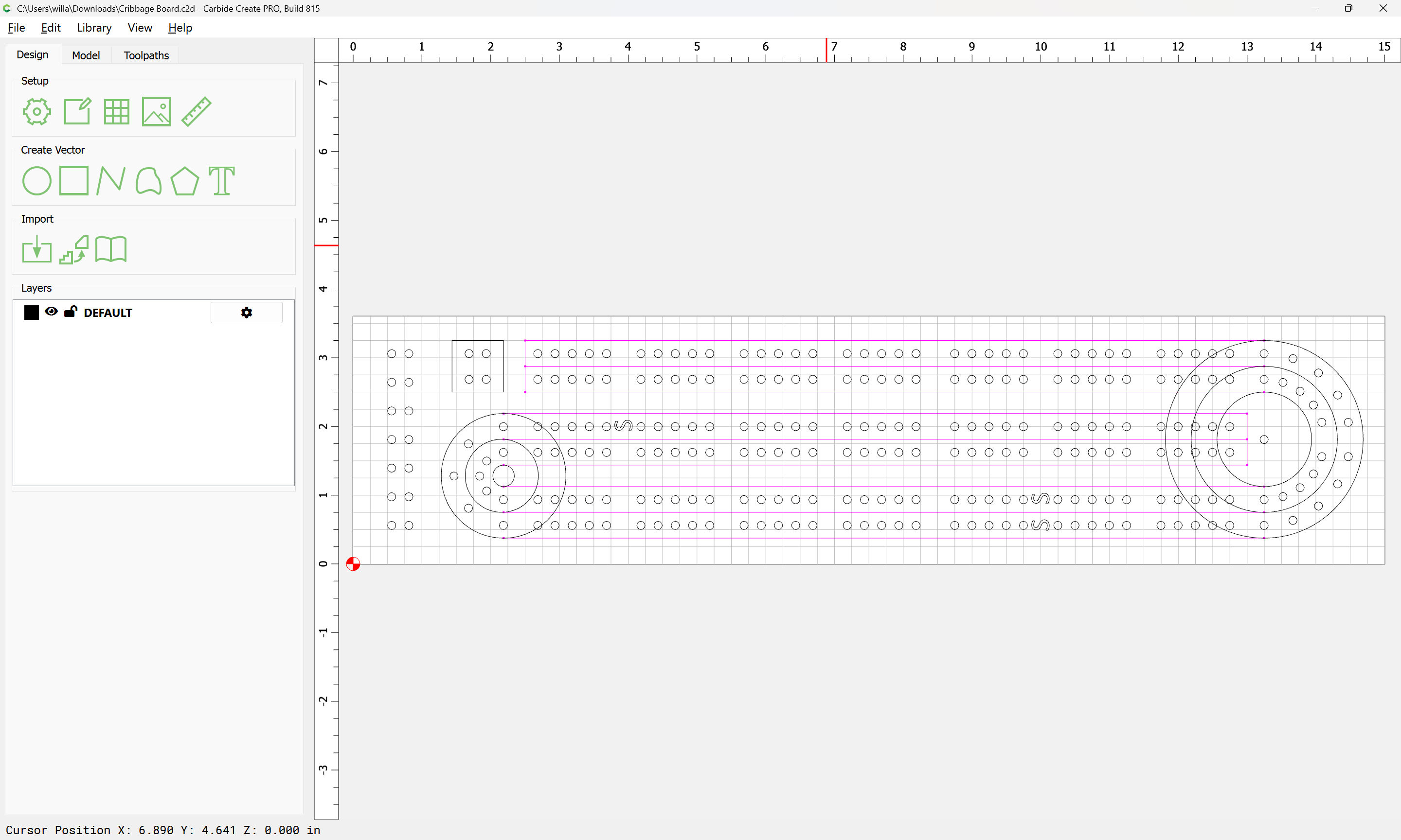

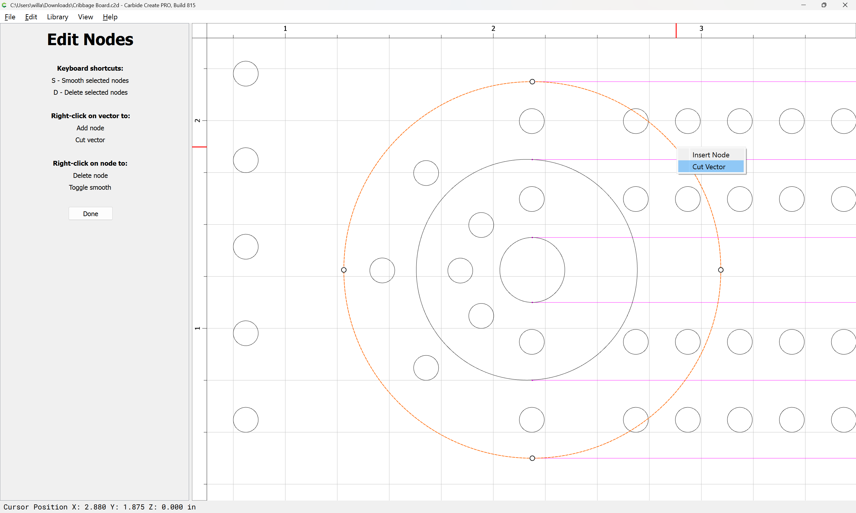

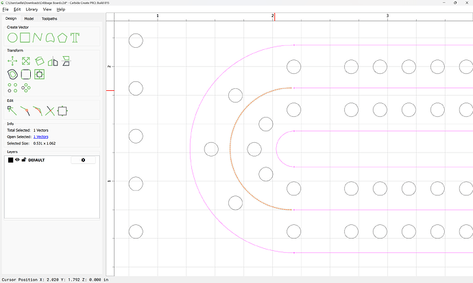

I am working in carbide create to design a cribbage board. I am trying to create a radius that I can connect to lines. Am I making this complicated? I created a circle but don’t know how to make it only half a circle.

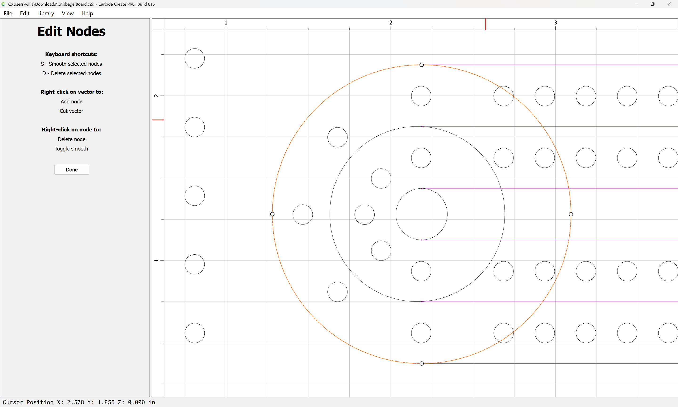

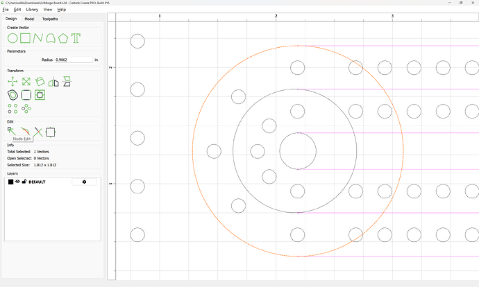

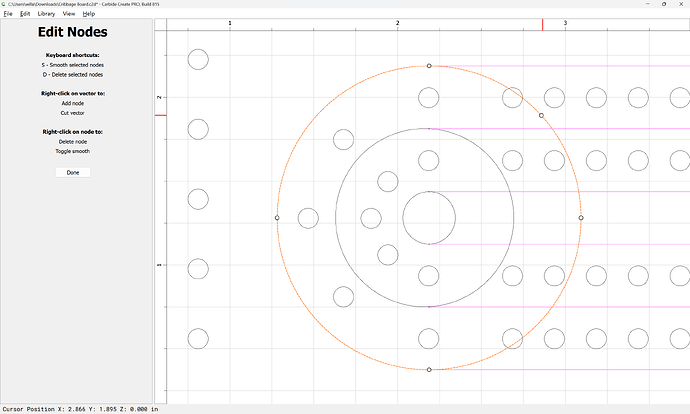

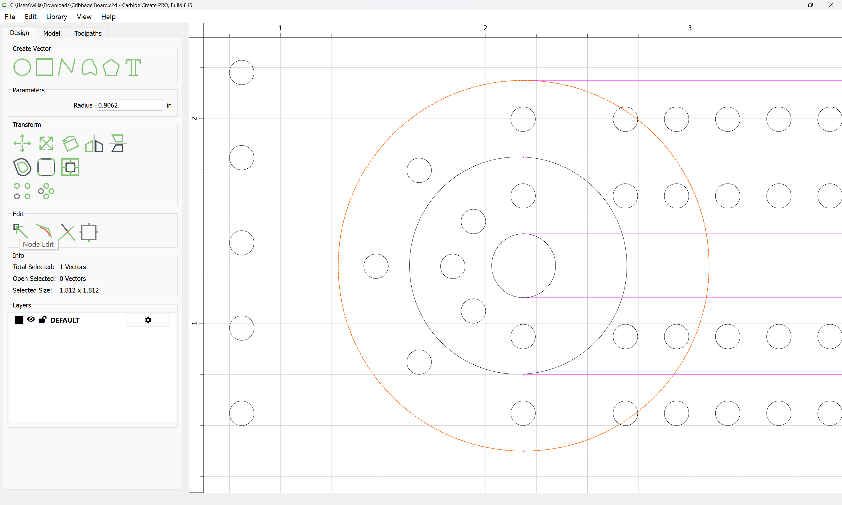

Making a half-circle is done by Node Editing, or by using the Trim Vectors tool. Since the latter may not work as expected if the geometry crosses at a node, and since the nodes are in the desired position, it is most expedient to use Node Edit:

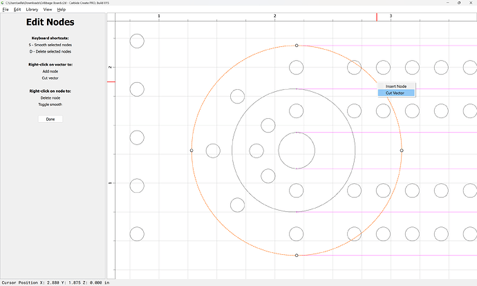

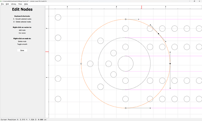

right-click:
Cut Vector:

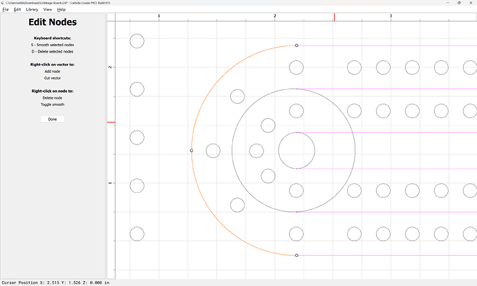

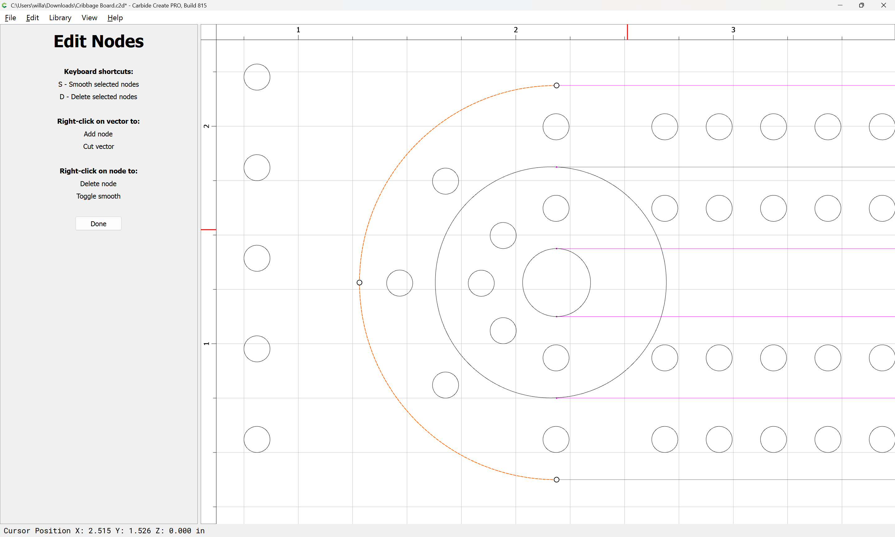

drag-select to select the nodes which one does not want:

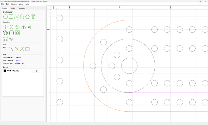

d for delete

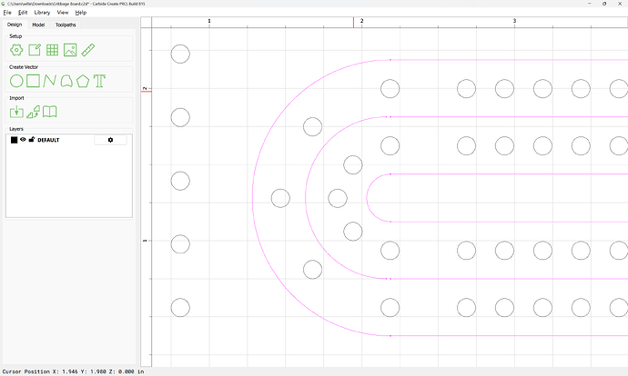

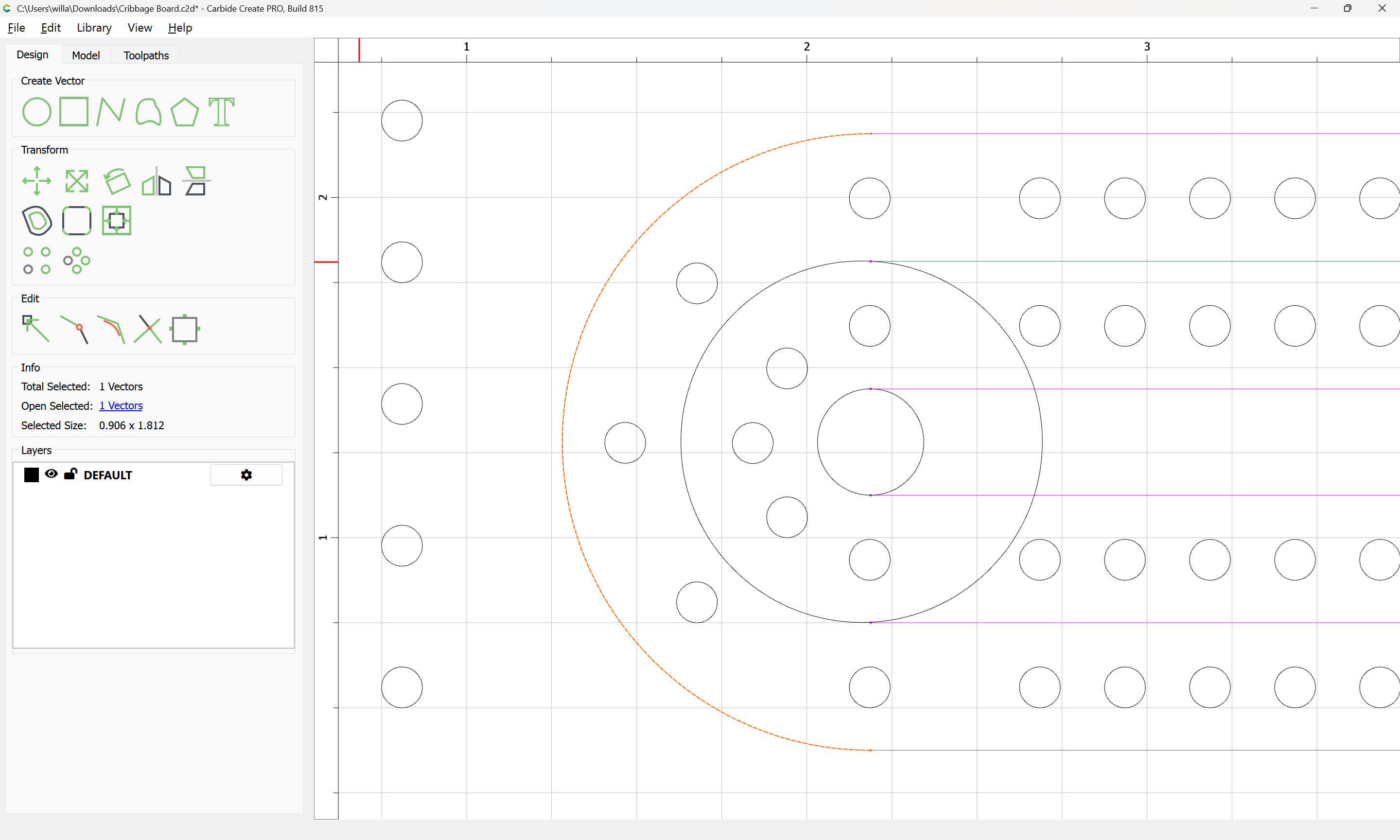

Done

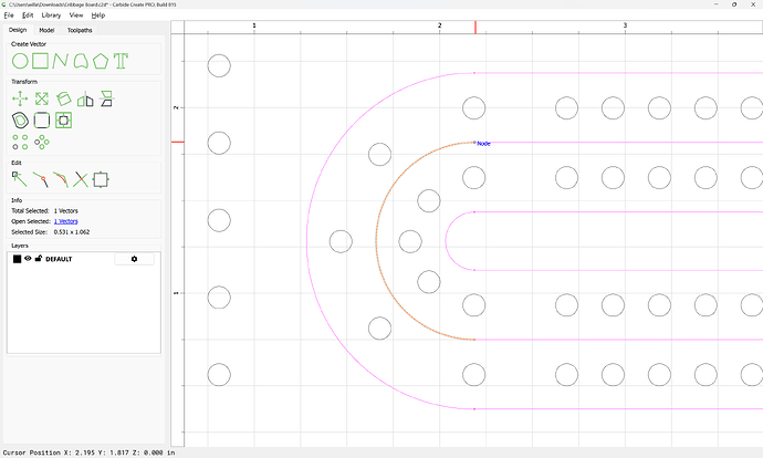

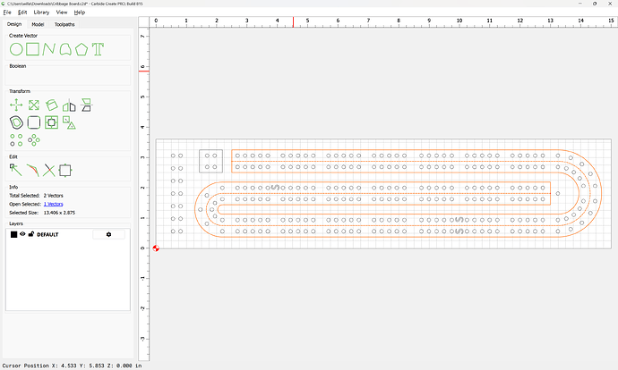

Repeat for each other circle until one arrives at:
Note that it may be necessary to drag a half-circle into registration:

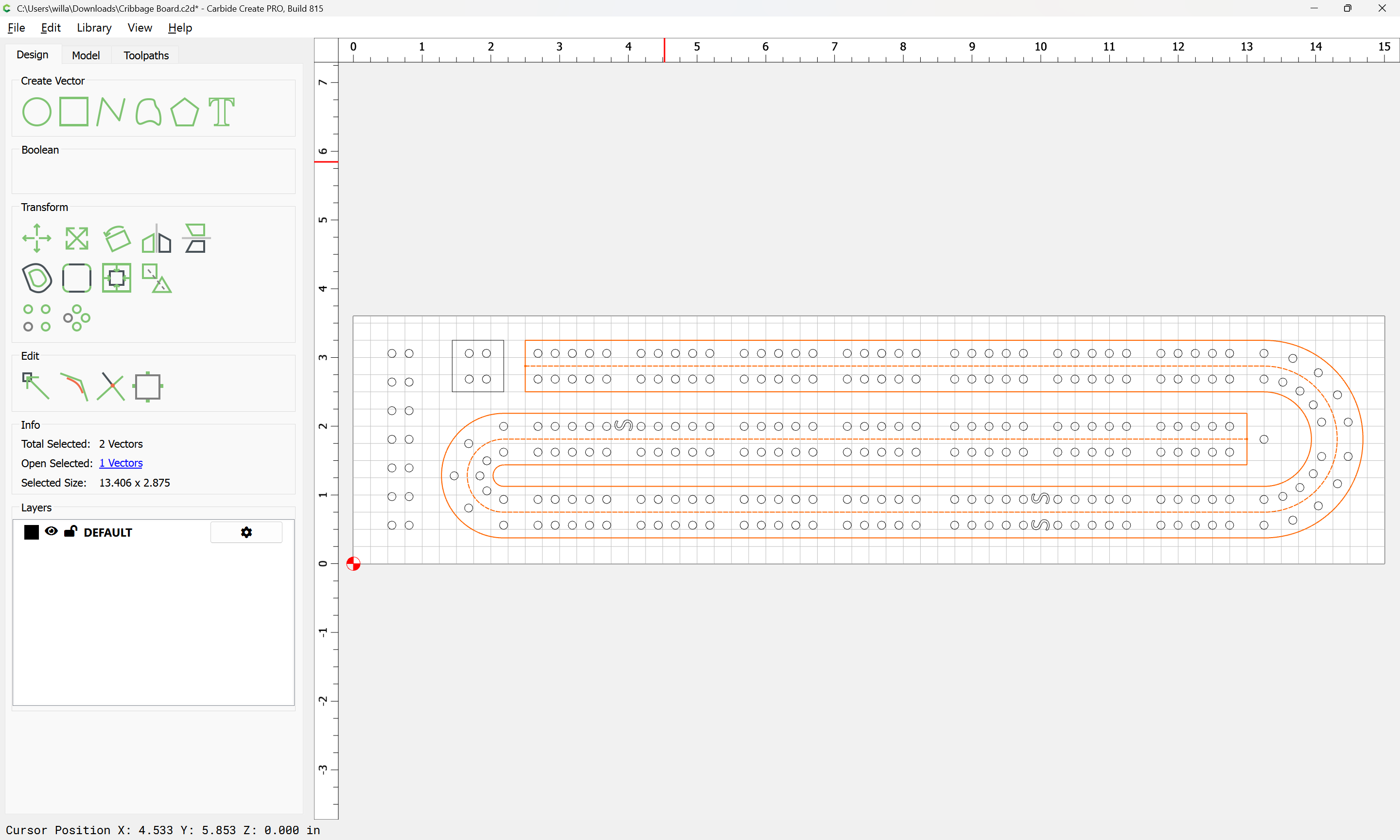

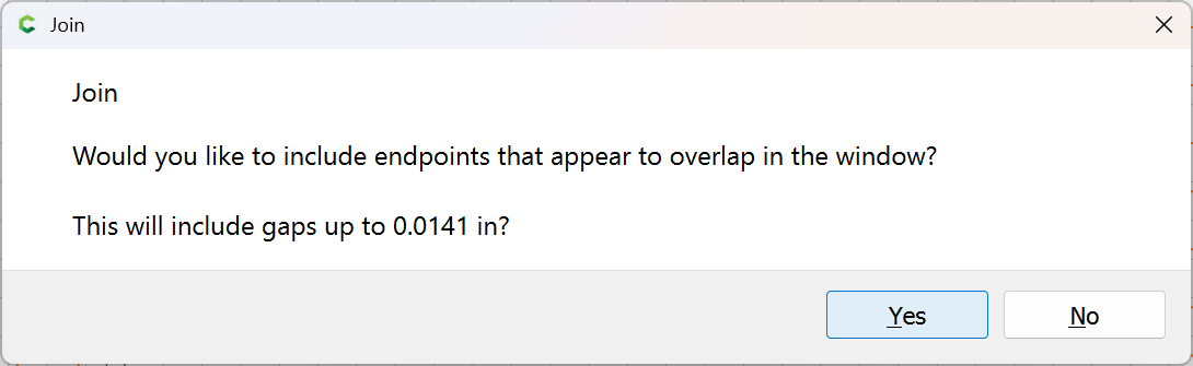

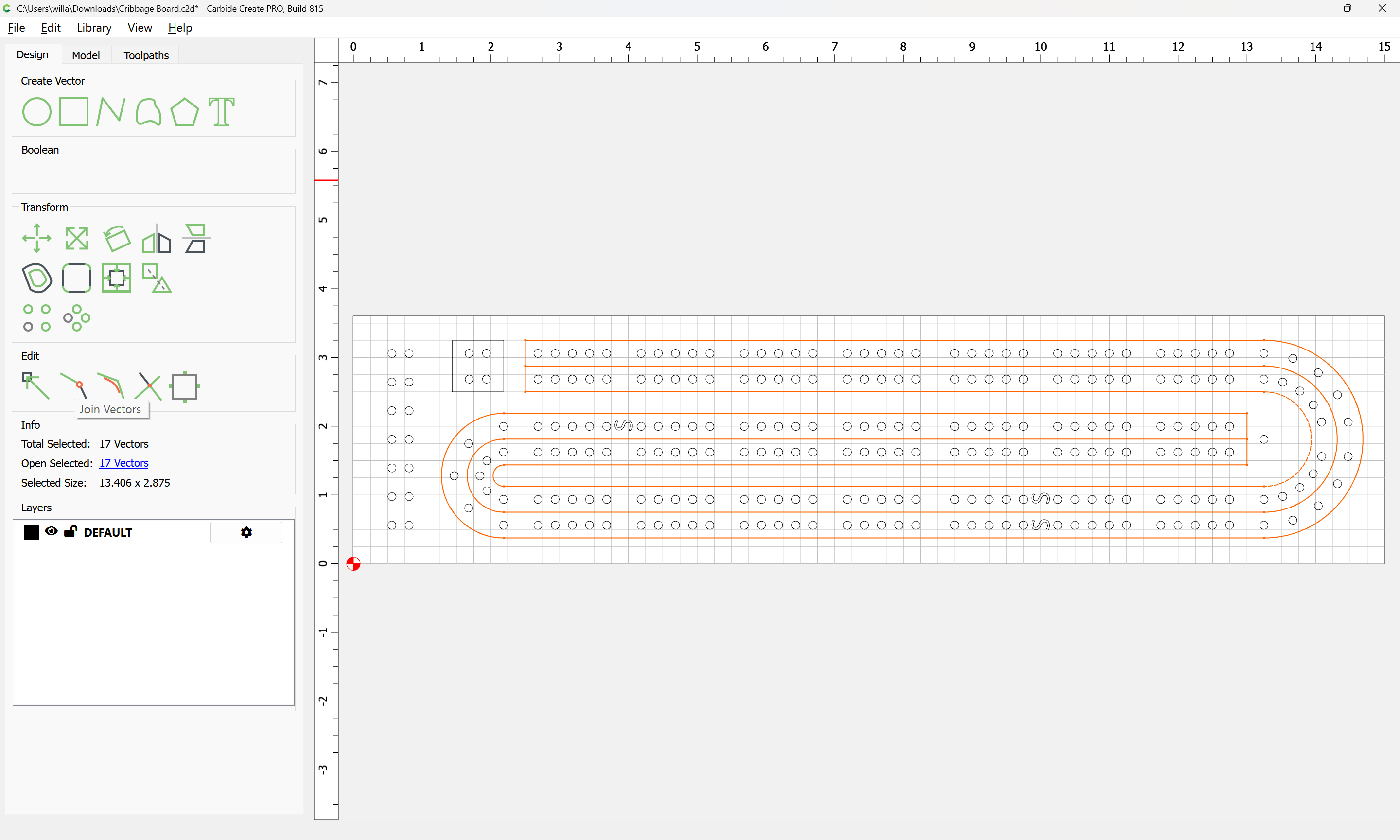

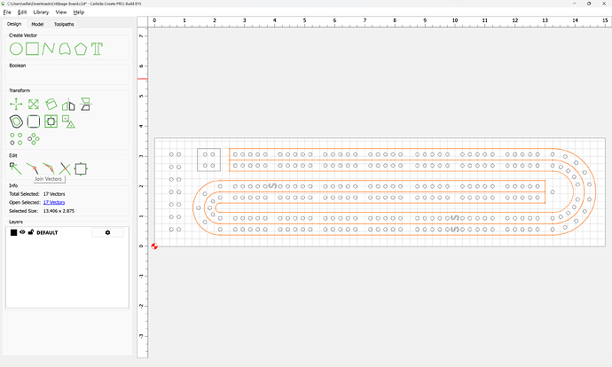

Select all open vectors:

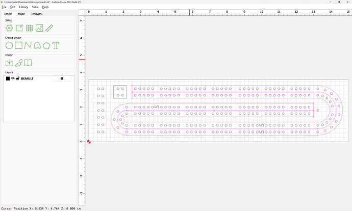

and use Join Vectors to close:
Yes
