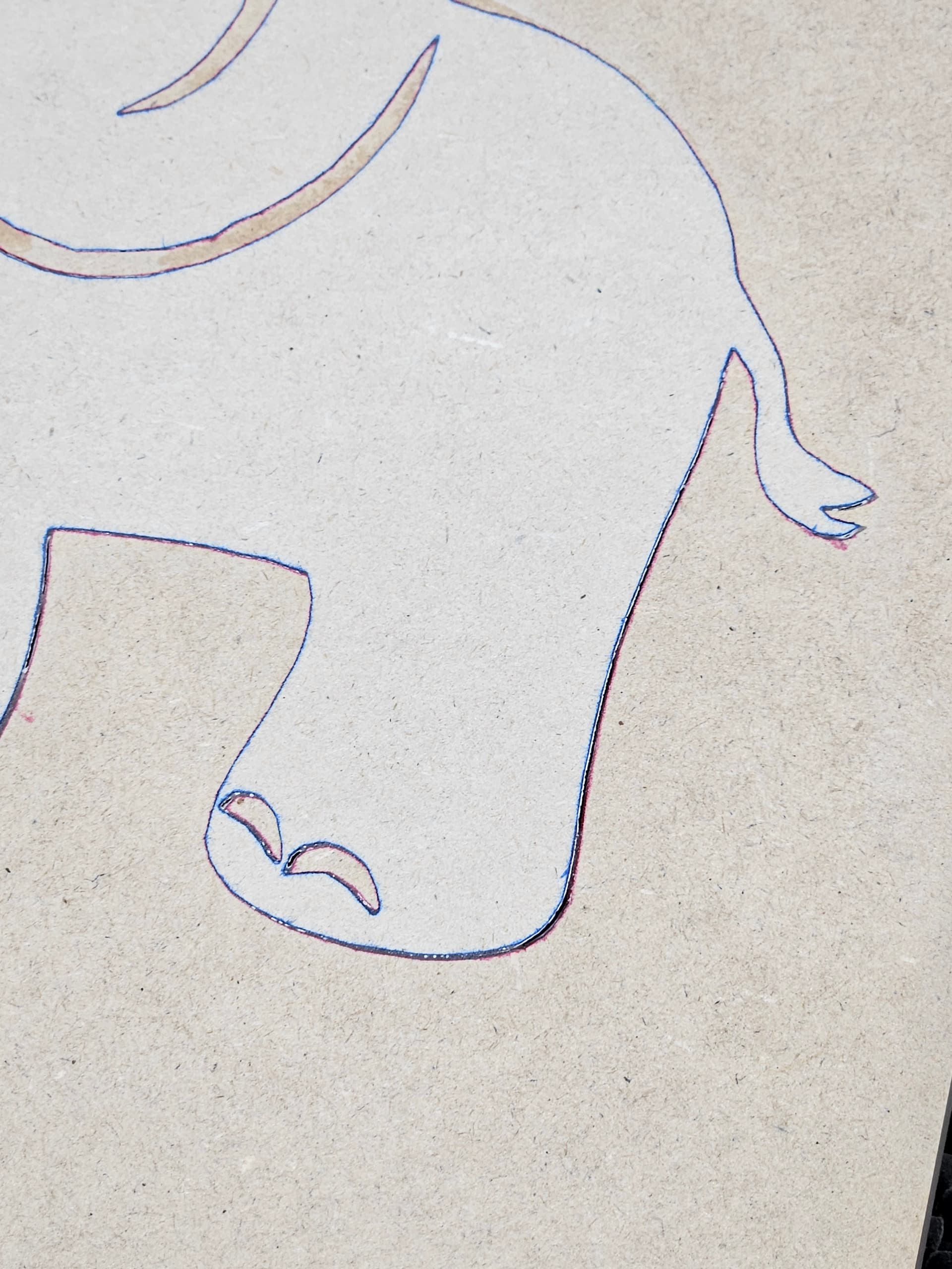

New to CNC. I have been trying to do my first serious inlay. Simple, one piece inlay. I was having problems with gaps around the edges, so I tried a series of test pieces cutting the inlays and pockets at different depths to see if I could find the sweet spot. BUT, I consistently get gaps especially at the bottom of the pattern. Could tramming be a problem? It is slightly out of whack, but I didn’t think it was enough to cause problems, other than a little extra sanding. Thoughts? Thanks in advance.

If your gaps are only at the bottom, and not on the sides, try a test mirroring your design for the male vertically instead of horizontally. Or just tram the machine & do another test, as tram is a pretty likely suspect.

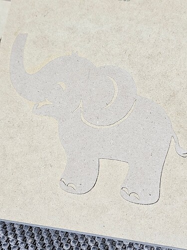

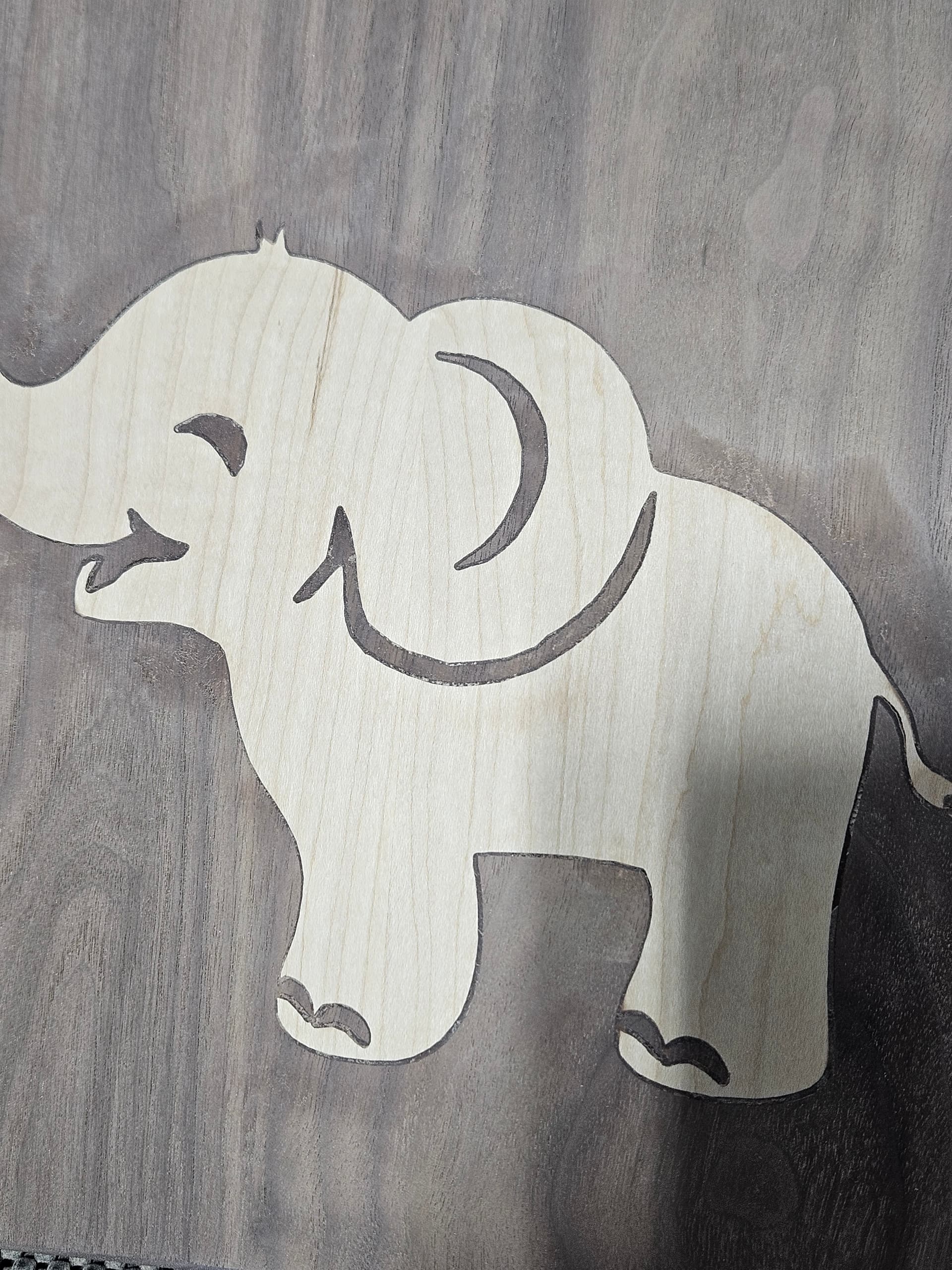

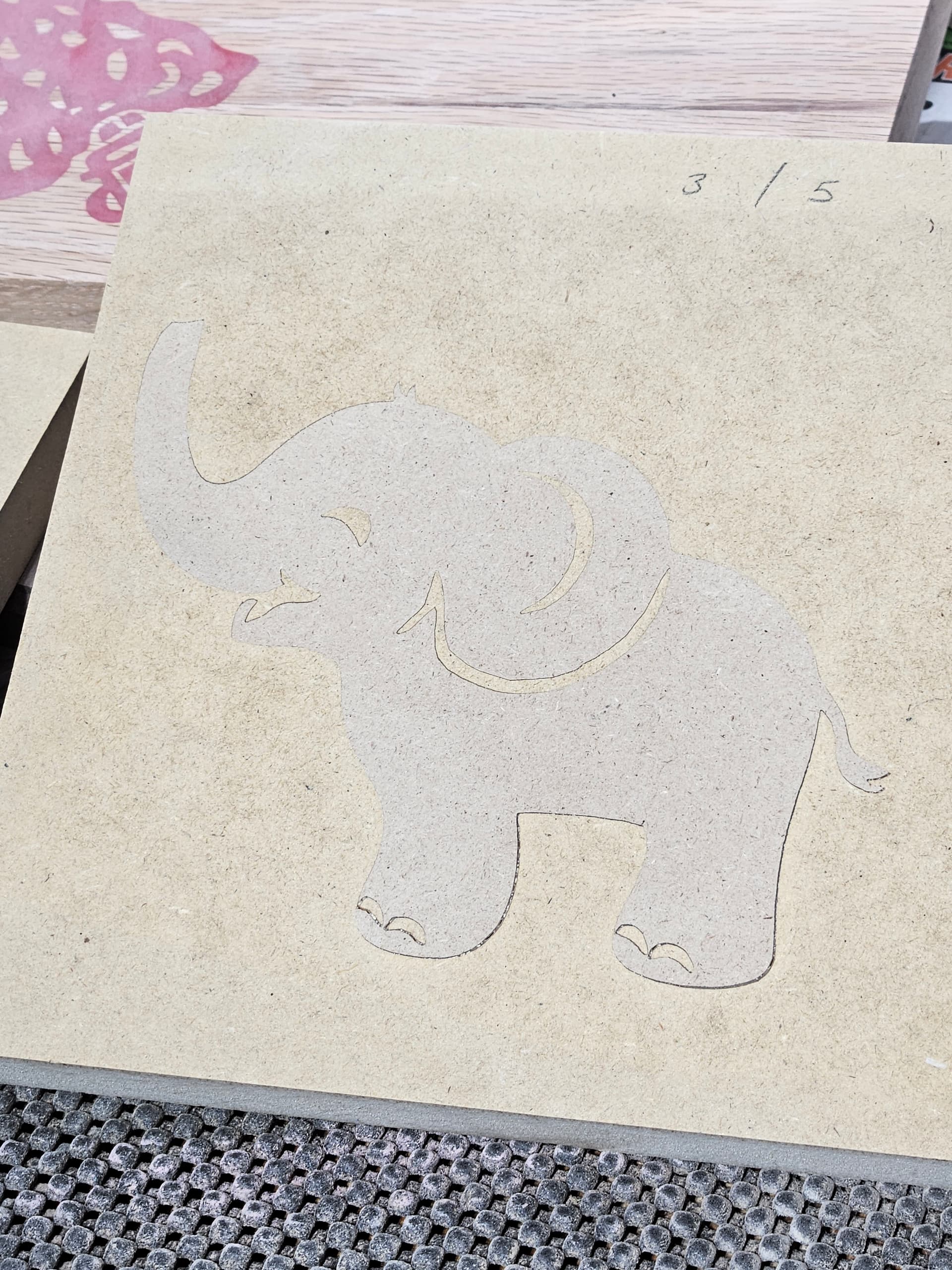

Using a Shapeoko 5.1 with a 60 degree vbit. I think my description was confusing. My gaps are along the edges on the bottom of the design. The photo of the maple and walnut was my first attempt at this design and I am pretty sure that the plug bottomed out, as I got a gap on the edges, all the way around the design. Other pictures are of test cuts I made after that in MDF and still get the gaps around the legs. I have since spent some frustrating time trying to tram the gantry on the machine, but again, I don’t think it was out much to start with. I had also surfaced the wasteboard after assembly and before doing any projects. I’m curious about the possibility that a different bit may help. I can also include the program, but I’m not sure that’s where my problem is. Thank you for the replies so far and the advice. Very helpful.

I’m using carbide create (free - that may have to change). Using information off of vidoes from others. The Maple/Walnut was 4.5mm on the plug and 5mm on the pocket. The MDF test pieces are 3mm plug/5mm pocket and 3.5mm plug and 5.5mm pocket. Based on those tests, I landed on the 3mm/mm which is the top picture, cut at full size (the others were smaller versions).

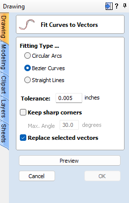

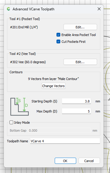

I "adjusted’ the elephant. All I did was remove the Sharp Corners.
Elephant inlay bezier curves

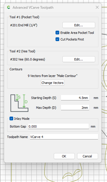

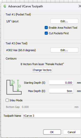

I looked at your file. I see a mistake on the Male plug. The way you input the numbers is based on the Vectric Advanced V-carve toolpath model, which is different than how CC does it.
Try these setting;
Male Plug:
Female Pocket:
Also test these setting with MDF before you work on hardwood.
Thank you for the help. Since I don’t have the pro version, I don’t have the advanced Vcarve. Does it help, or make a difference? I figured if I couldn’t figure out the basic version, I wasn’t ready for the pro version. Did you take out the sharp edges by applying a fillet? Or, did you do it another way? The vectric inlay setup seems weird to me. The terminology seems backwards to me for some reason. In the screenshot you sent for the CC numbers, should I leave a bottom gap for a glue gap? I see you set that as zero. In fact, I see that I don’t have that option in the basic version. Again thank you very much for the help. Trying to make this for my first grandchild’s nursery.

As noted in the announcement for v8:
https://carbide3d.com/blog/create-v8/
There’s now just V-carve (previously Advanced V-carve). If you load an existing file that has a basic V-carve toolpath from V7, it will be converted to the new V-carve without a pocketing toolpath.
The difference between the old way, Start depth & Max depth, vs the Inlay mode Plug depth & Top Gap, is just putting the numbers in a different place.
The old start depth is now the plug depth. And the old Max depth is now the plug depth plus the top gap.
The one thing you don’t specify is the glue gap. That is the difference between the pocket (female) depth & the plug depth.
The main thing you gain with the new system is it honors the depth per cut, whereas on the old system you had to specify a start depth, and it started there.
If it helps, I use this cheatsheet to make sense of it. Of course you have to imagine the male/top side flipped over on the machine.
