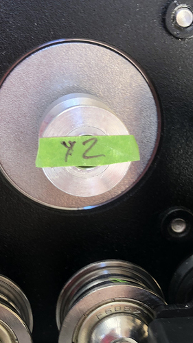

Best test is to remove the belts, put a bit of tape on the pulleys, then try initializing — do the pulleys rotate evenly and in synch?

Thank you for response. Just did tape test.
As suspected, Y1 a bit faster then Y2.

Can you get a video of the Y2 with a sharpie line (in place of your tape) across the pulley and shaft?

Yes sir, That same Y2 side is slow. I too believe it is the motor. Support reached out today so i hope they come to conclusion on the issue and help me. I hope to start my 1st project soon🤷🏻‍♂️. I hope
It was the controller board. Thanks to Will and the fellas on the carbide team for all the help. And everyone else who gave input on here. Really appreciate you all and am thankfull. So i was sent a new control board and wallah problem fixed. Hope this thread will help someone else with this issue in the future.
