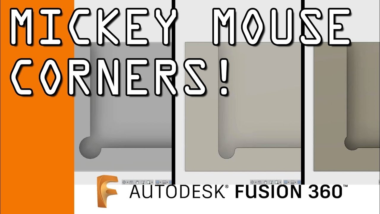

There is a plugin that is free on f360 called Mickymouse that I used before and it is good as it does 99% of the mouse ears for you.
About to got to bed will give you link tomorrow night
Jon

@spinner this is what i use More elegant CNC dogbones
