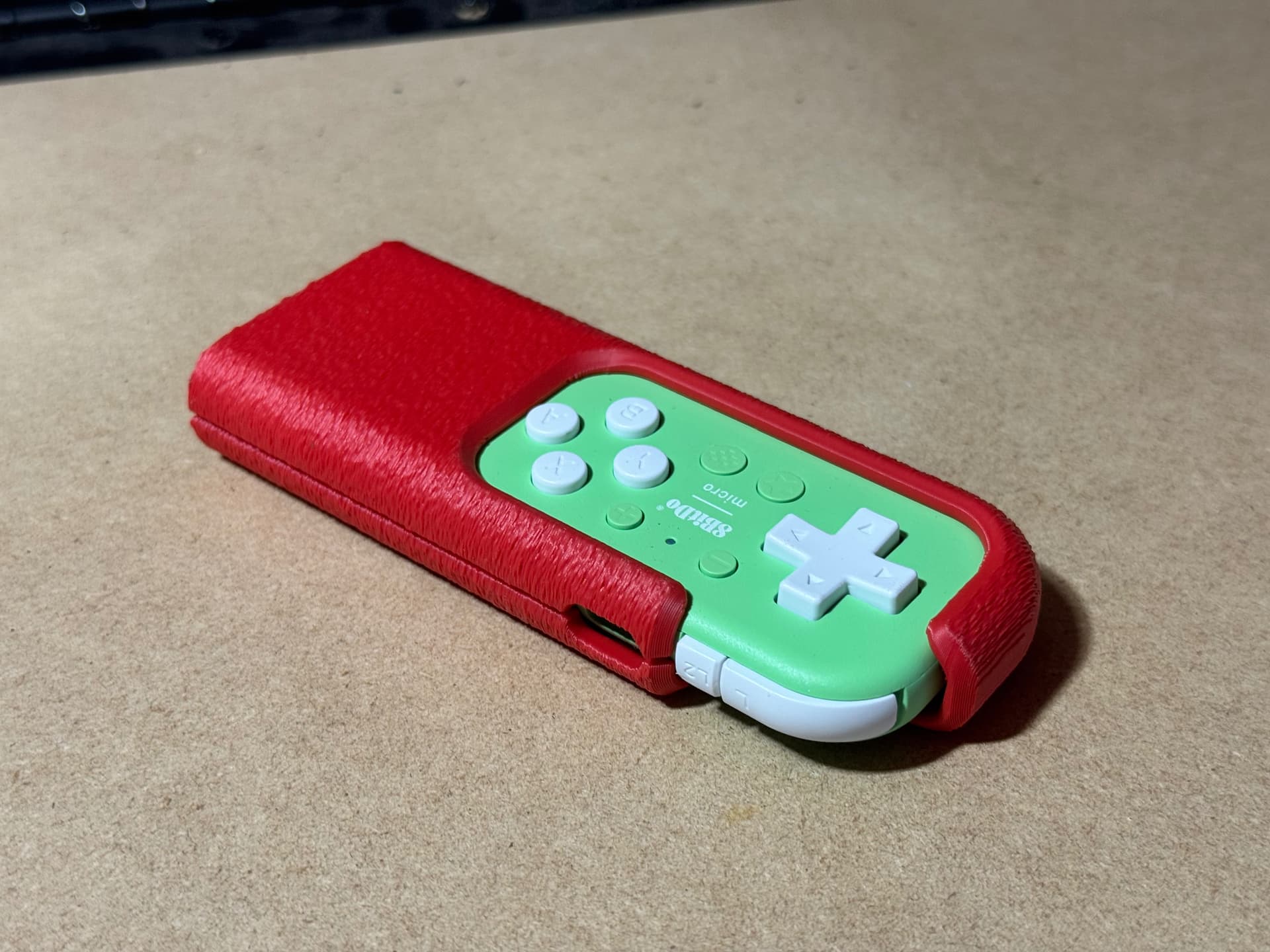

I wanted a jog pendant, and naively dusted off a xbox series controller and tried it with my windows tablet. After two nights of troubleshooting and trying key mappers (AntiMicrox) and device hiding software (HidHide) I finally gave up and decided to just use a keyboard. I ordered a bluetooth partial keyboard w/ numpad/arrows, and as I was setting it up I stumbled on the 8BitDo Micro…which had a keyboard mode! Looks like it’s the last device in 8BitDo lineup to ship with the old firmware that allows keyboard mapping. I was 50/50 if the keyboard mapping app would still work, but $25 was worth the risk.
Lo and behold, it worked! I now have a bluetooth jog controller.
I designed a grip cover for its ridiculously small size, and so far so good! Currently, printing it in another color to look less chistmas-y, but thought I would share.
Model file is available on Printables - 8BitDo Micro - Cabide Motion Pendant Grip

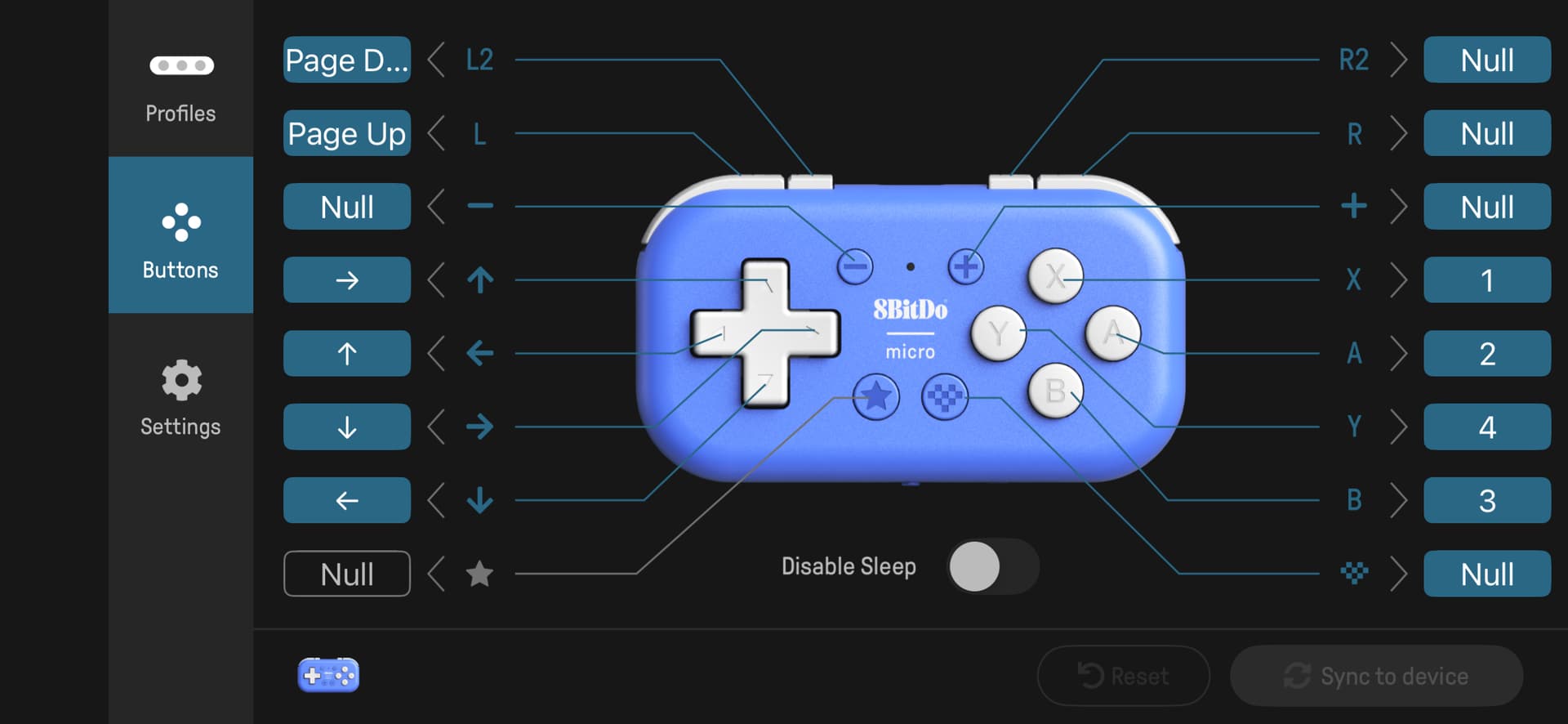

Can you also diagram the button mapping you used?

Thats the right controller! It has 3 modes, one of which is “keyboard” mode.
No need to actively run key mapping software, Carbide Motion supports keyboard shortcuts. I pulled the shortcuts from this post
You should only need to sync key mappings once to the controller.
  1. Download the iOS/Android app “Ultimate Software V1” (https://app.8bitdo.com)
  2. Launch app and connect the controller
  3. set key mapping in the UI
  4. click sync
Key mapping I used
  • D Up - Arrow Right
  • D Right - Arrow Down
  • D Down - Arrow Left
  • D Left - Arrow Up
  • L - Page Up
  • L2 - Page Down
  • X - 1
  • A - 2
  • B - 3
  • Y - 4
  • All others - Null (to avoid unexpected key presses)
From then on you just connect the controller over bluetooth to the Mac/Windows machine running Carbide Motion. It will look like it’s a bluetooth keyboard to the Mac/Windows machine, and Carbide Motion happily accepts the buttons on the controller as keyboard inputs.
