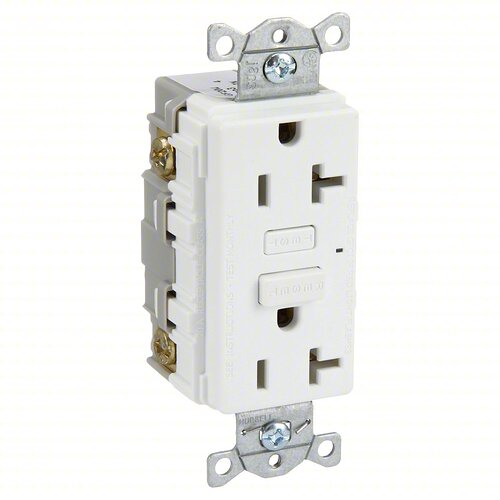

So go to the big box store and buy a 15/20 AMP GCFI.
15 AMP GCFI Plug
20 AMP GCFI Plug
The 20 AMP one has the little sideways socket and the 15 AMP does not.
Plug up a lamp in that plug and turn the breakers off until the lamp goes off. Then just transfer the wires just as they are on the back of your plug. A GCFI has the wires coming in and maybe wires going out to other outlets that the GCFI protects. Usually they are line (line in from breaker) and load (line out to other outlets if you have any others). Make sure the wires are poiinted in a clockwise direction for the loop so when you tighten the screws it tightens around the wire. Really easy.

I replaced the 15 AMP GFCI with a brand new 20 AMP GFCI and it still popped after turning on the controller. Just like before, it waited about 10 seconds before it popped. The blue lights on the PCB all came on as usual and I could hear a slight humming from the steppers. I can’t say that I remember always hearing a hum from the motors but I’ll admit that I haven’t really paid attention to it in the past. Regardless, it still popped the GFCI after being powered on for about 10 seconds.
I replaced the brand new GFCI with a standard outlet. Plugged it in and everything seemed fine. I started up Carbide Motion, initialized the machine and it homed out like normal. This current rev (Version 636?) brings the machine towards the front automatically after it homes out. The weird thing this time is that as it was traversing forward, it stuttered a bit just before it got all the way to its forward position. As it was sitting still, I could here the motors still trying to move it and slightly stuttering. Before I could turn it off, I heard it “quit”…rather it stopped humming and trying to move.

As far as the GFCI is concerned, I’m simply going to remove the outlet in that location altogether. That location is next to a water source so it has to be a GFCI for code reasons so I’ll just rewire that circuit so that the outlet isn’t in that vicinity.
